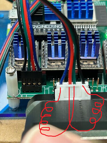

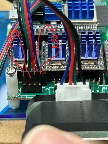

Pins 1 and 4 on the 6-pin connector is not correct, based on the image of how your wires are set up.
The jackpot board (and every 3D printer board I have ever seen) expects adjacent wires to be connected to a coil, like this:
What you have described, the first and 4th pin left-to-right and also 1st and 4th pin right to left, is this:
That will make the motors not turn.

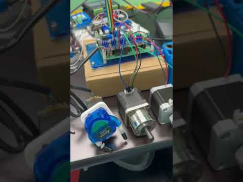

Ok major new development.
So the questions about which stepper motors caused some thought.
It’s true that I have used only standard pinned motors without deviation from that to remove as many variables as possible so my thought was ok so why not try some oddball steppers just to see what happens.
So one of them was a mini Nema 11 attached to a small peristaltic pump.
It works! Why? Dunno??? It’s actually pinned the same now that I put my meter on it.
However I did notice it move slower than expected even at 5000 or even 7000mm/min which is faster than I’ve ever tried any stepper before. But it is a tiny little thing.
Is it possible somehow that my driver are running low voltage? It would have to be seriously low to not move a little Nema 17.
I only ask first before trying to adjust the drivers because a. I don’t know how (yeah I’ll google it lol no big deal) 2: I’d rather not mess with them if you guys seem to think they are generally set correct from factory and III. Does it make any sense at all that I would get the only five 2209s all set to the same low voltage from the factory?

@Bret_Martineau asked me to post this video. He sent the following comment with it:
Ok this better than nothing but I’m not sure for what :joy:

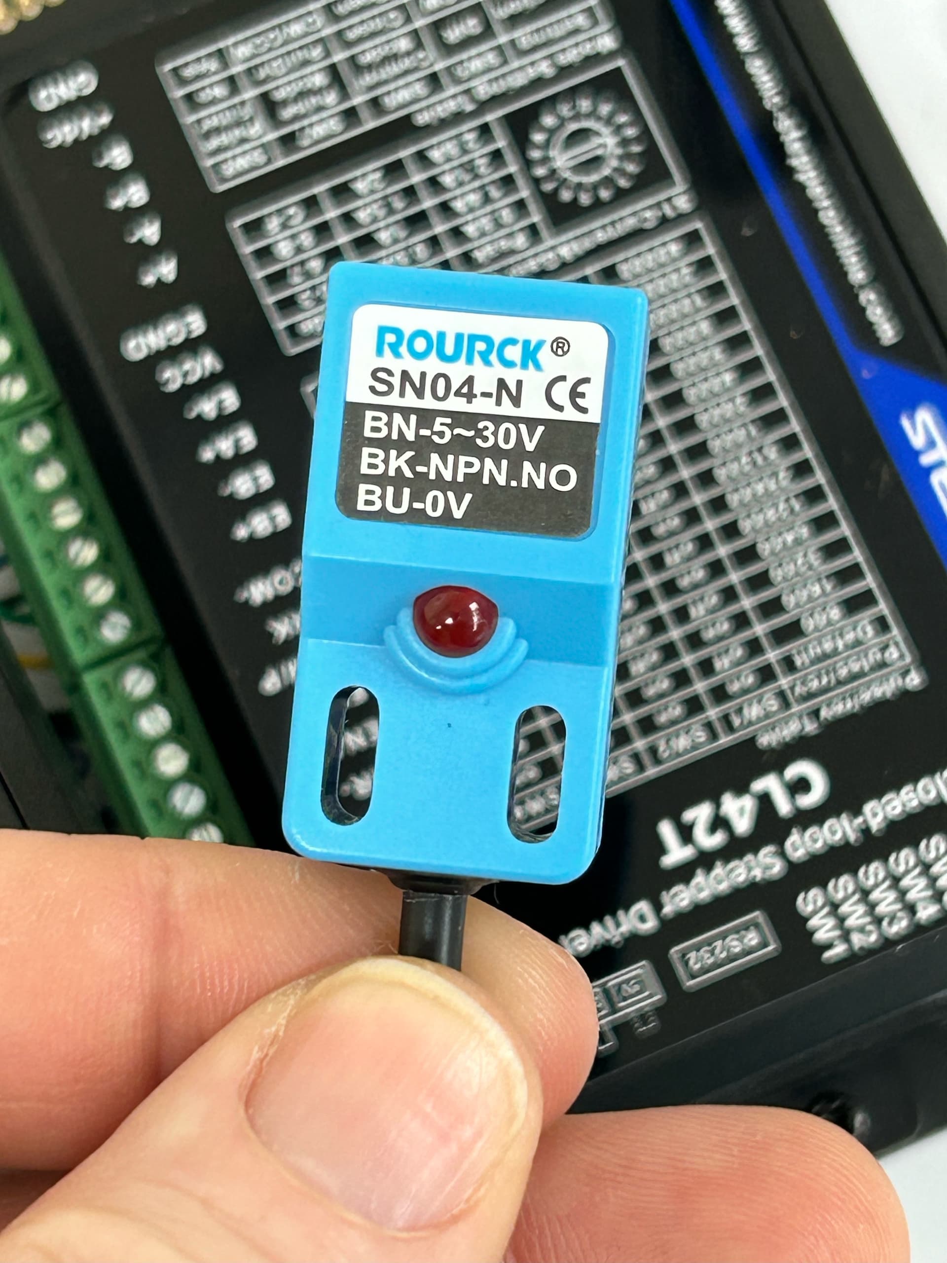

I’ll make your day, Jim. Behold the proximity switch part number is now before you kind sir.
ROURCK Ā®
SNO4-N CE
BN-5-30V
BK-NPN.NO
BU-OV

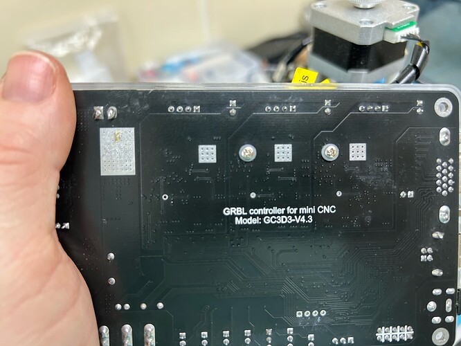

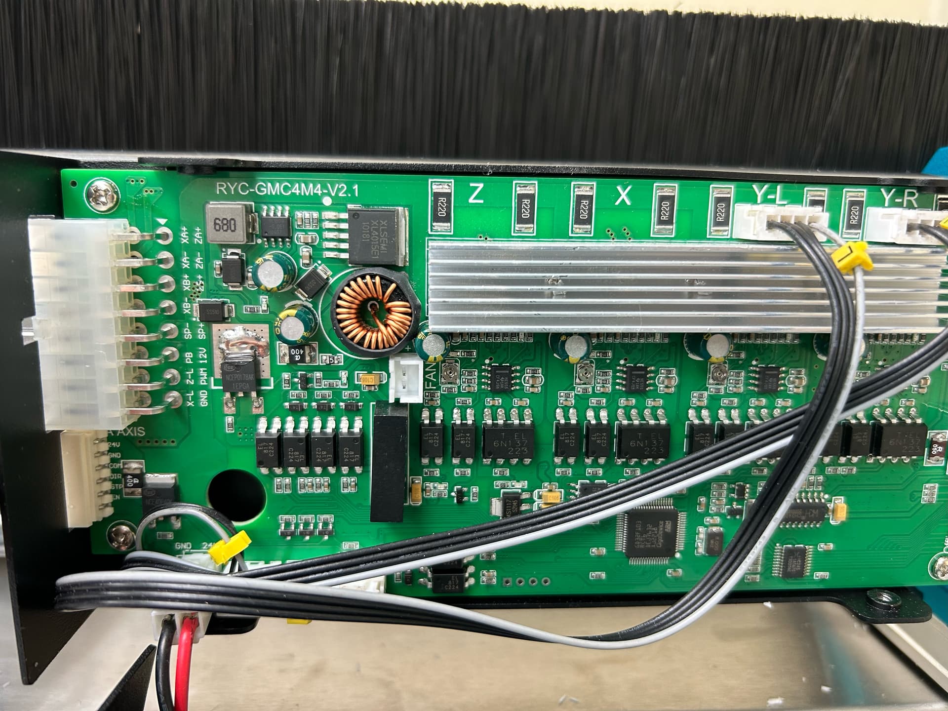

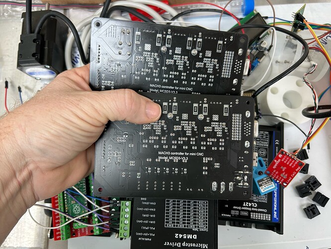

Here’s the Grbl board info for Jamie
Grbl GC3D3-V4.3
Grbl RYC-GMC4M4-V2.1

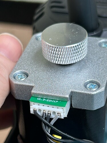

And I have several of the same stepper that works on these boards that I would like to use. The only number on them is as follows: V01.3-221117
That number is on the chip board that protrudes from the side and it’s the only number on them. It’s probably not a part number for the motor but it’s all that’s there.

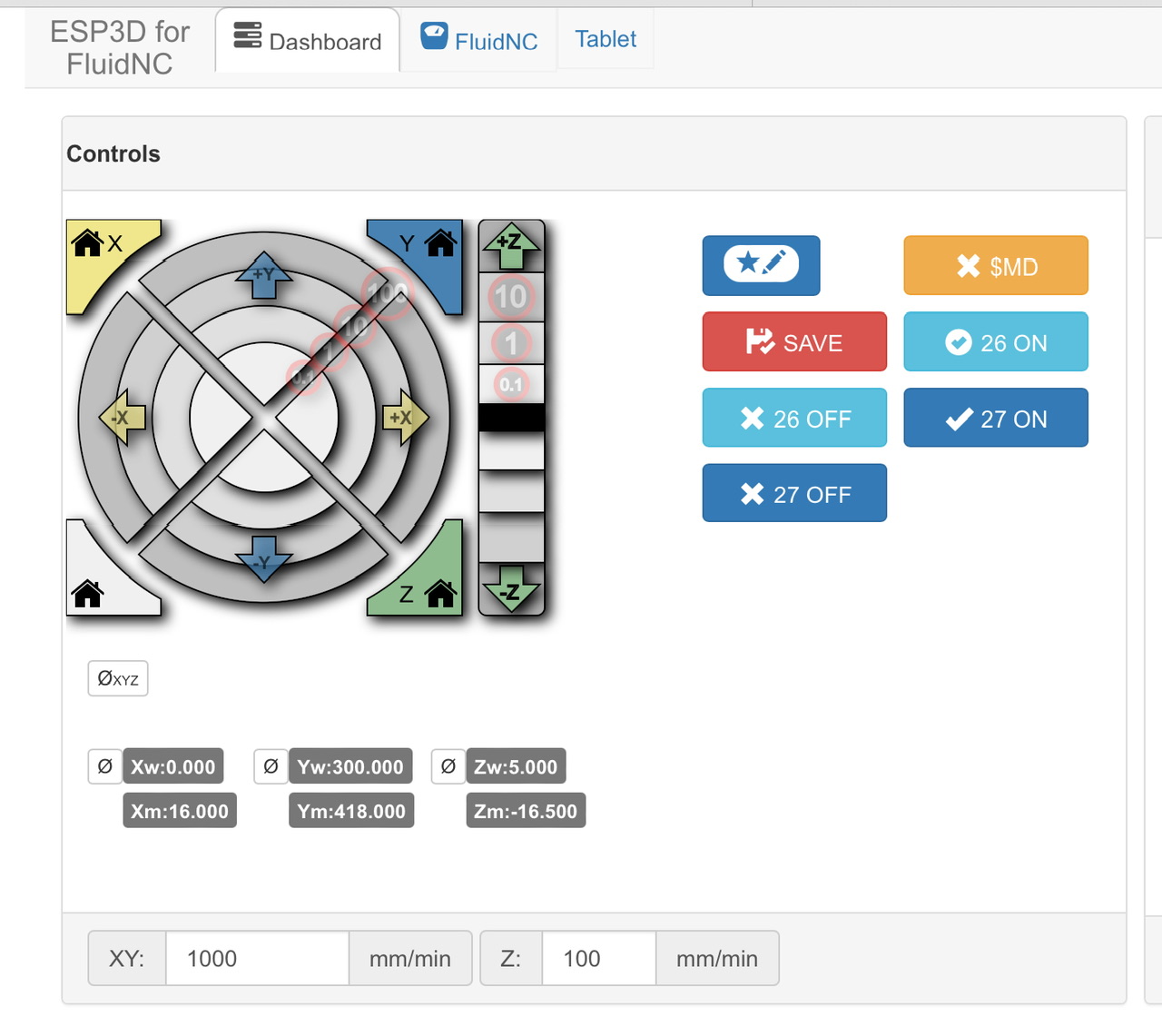

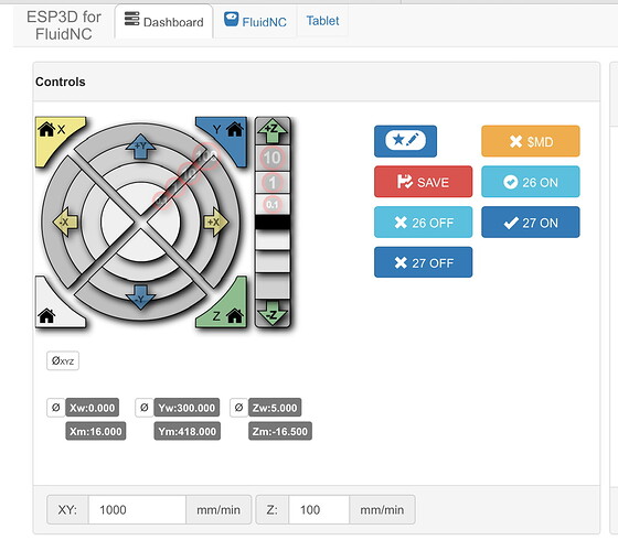

Reading back through I don’t think I see it anywhere: HOW are you testing the movement of the steppers?
Please confirm you are testing each time using the fluidNC user interface in a browser - it looks like this
Just trying to eliminate assumptions and variables.

One of the guys from the forum (Jamie?) was asking for the info on the known to work Grbl boards.
I sent the part numbers but here’s pics of the stamp.

Yeah I’m using the interface in your picture. With an ohm meter to find the pairs.
