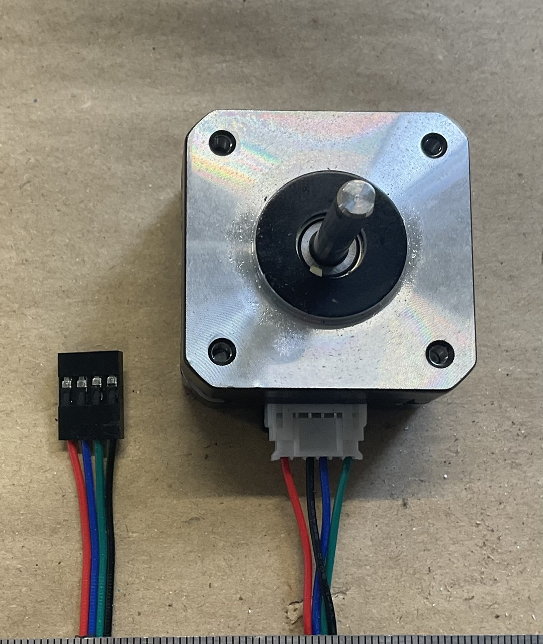

New Jackpot board that will not move the machine even though it will run the code through FluidNc as if it is executing it in the autoscroll

He tried first using the pre-flashed config, and got no movement. He’s brand new to FluidNC / Jackpot and still working to get some movement other than a strange grumbling stutter.
I think your stepper wiring is wrong
Ok I’ll try it with that wiring pinout. I think that’s one of the wiring configs I tried yesterday but it can’t hurt to be sure.
Do you have a model number on those motors?
I’m thinking motors too, not config, because it should at least move a little bit, even if briefly or in the wrong direction.
Then do not edit the file, figure out why it does not work as is. This is a know good file on a tested board.
Any 4-6 wire stepper will work, if it does not move but makes funny noises the coils are wired wrong, not a bad firmware edit.
Ok I tried the standard wiring that works for all the other machines and got nothing but what it is in the video above.
It just tried the wiring in the picture sent of that small pancake stepper in the pic above that someone sent. It locked the stepper and if reversed entirely it produces heat in the driver.
If you don’t have a model number, you can determine the motor coils this way:

I checked the stepper pinout with my meter and the pairs are going to the correct pins and all of my steppers have the same pinout. Basically on the 6 pin side starting from the left I would put one side of a pair and move four pins over to where the other side of that pair goes and then repeat but opposite starting from the right.
No movement.
I tried on a grbl board and a Mach3 and the steppers all worked fine.
