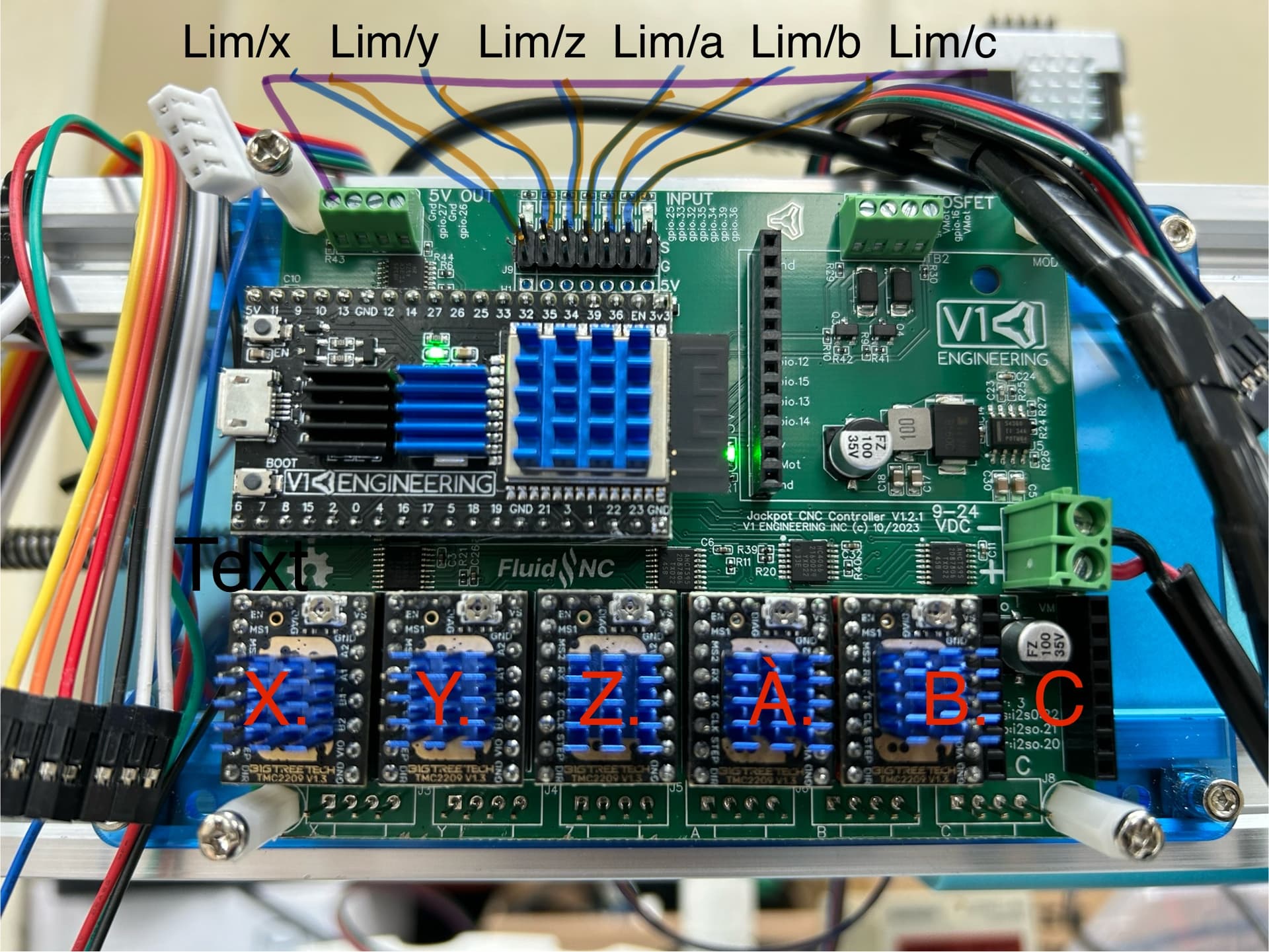

New Jackpot board that will not move the machine even though it will run the code through FluidNc as if it is executing it in the autoscroll

The pins you have labelled as ā€œLim/Xā€ (and Lim/Y, etc) are typically used for end stop switches and the last one typically used for a probe. I don’t know what ā€œLimā€ stands for. ???
EDIT: well, I feel sheepish. ā€œLimā€ probably stands for ā€œLimit switchā€ which is just another name for what we call end stop switches.

yeah. limit switches.
I highly suggest you start over and use our standard yaml, nothing should be changed. From there when everything works we can help you add a driver.
Something as little as an extra space will ruin the config.

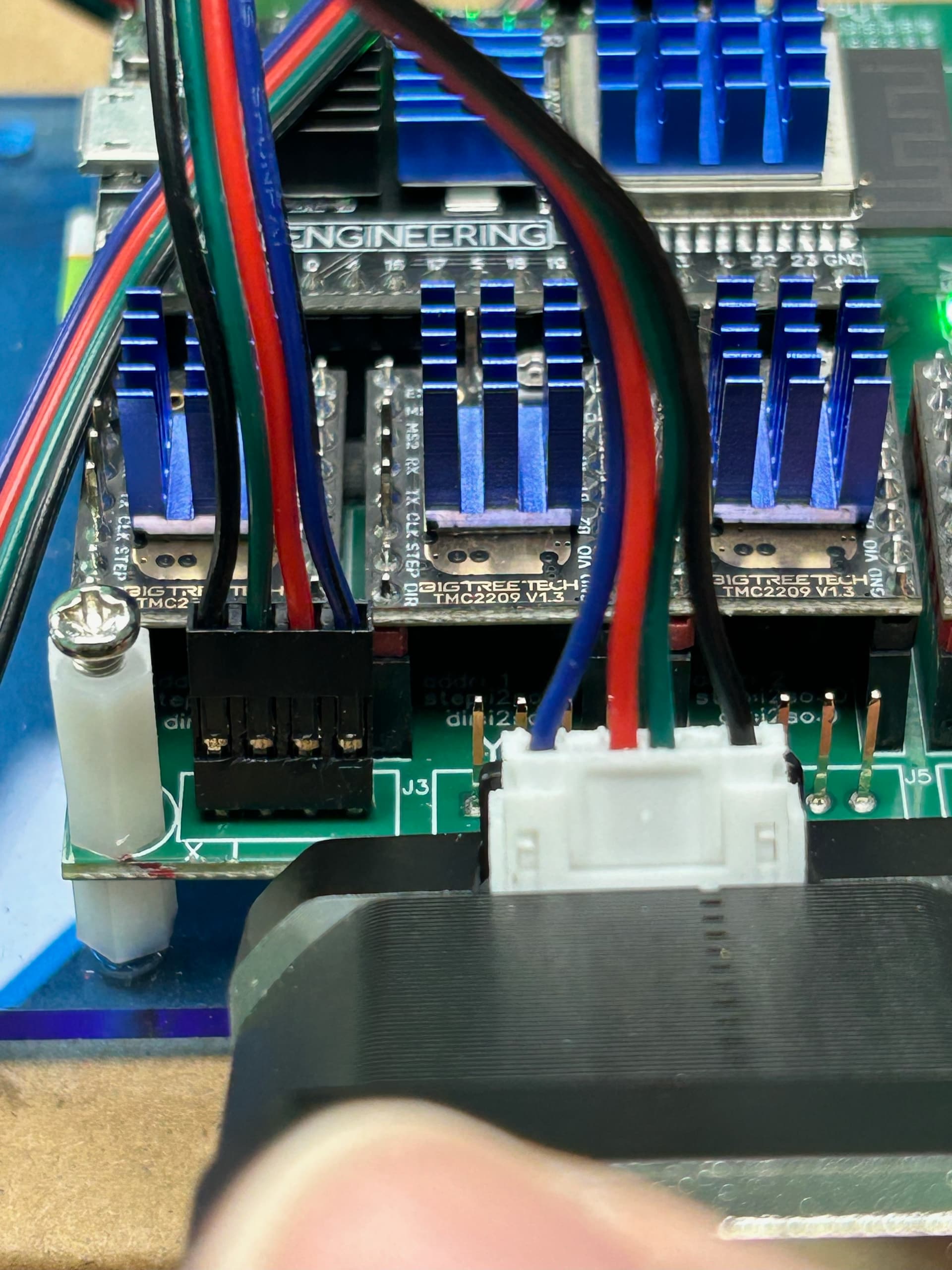

Also I guess I should ask if these boards have a different pin out for the stepper cables. or are the wired like every other controller board?
He’s using the Jackpot for some factory type automation machinery, and he needs one driver per axis. When he ordered the board, he got the firmware for MPCNC, which as you know has two steppers per axis for two of the axes. I edited a config file to put one stepper per axis. At first I made the mistake of basing it on my older LR3 Jackpot config file, but I just now edited another one based on your much more recent Jackpot config for MPCNC that you sent him pre-flashed. He’s not trying to add a 6th driver right now, so the newest one I uploaded does not have a 6th stepper section yet. I edited the post above to switch in the newer config file. Hopefully this newest one works for him.

Same pinout on Jackpot as most 3D printer controllers.
But not all steppers are wired the same, so it’s always worth doing a motion test with at least one stepper on a bench before wiring up the whole machine.

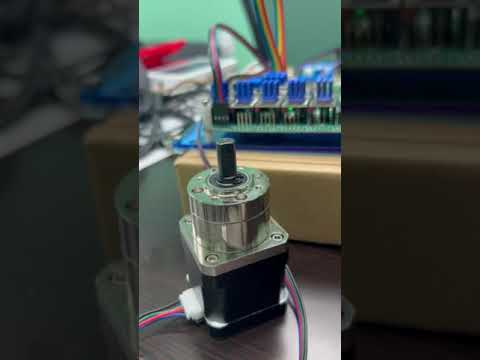

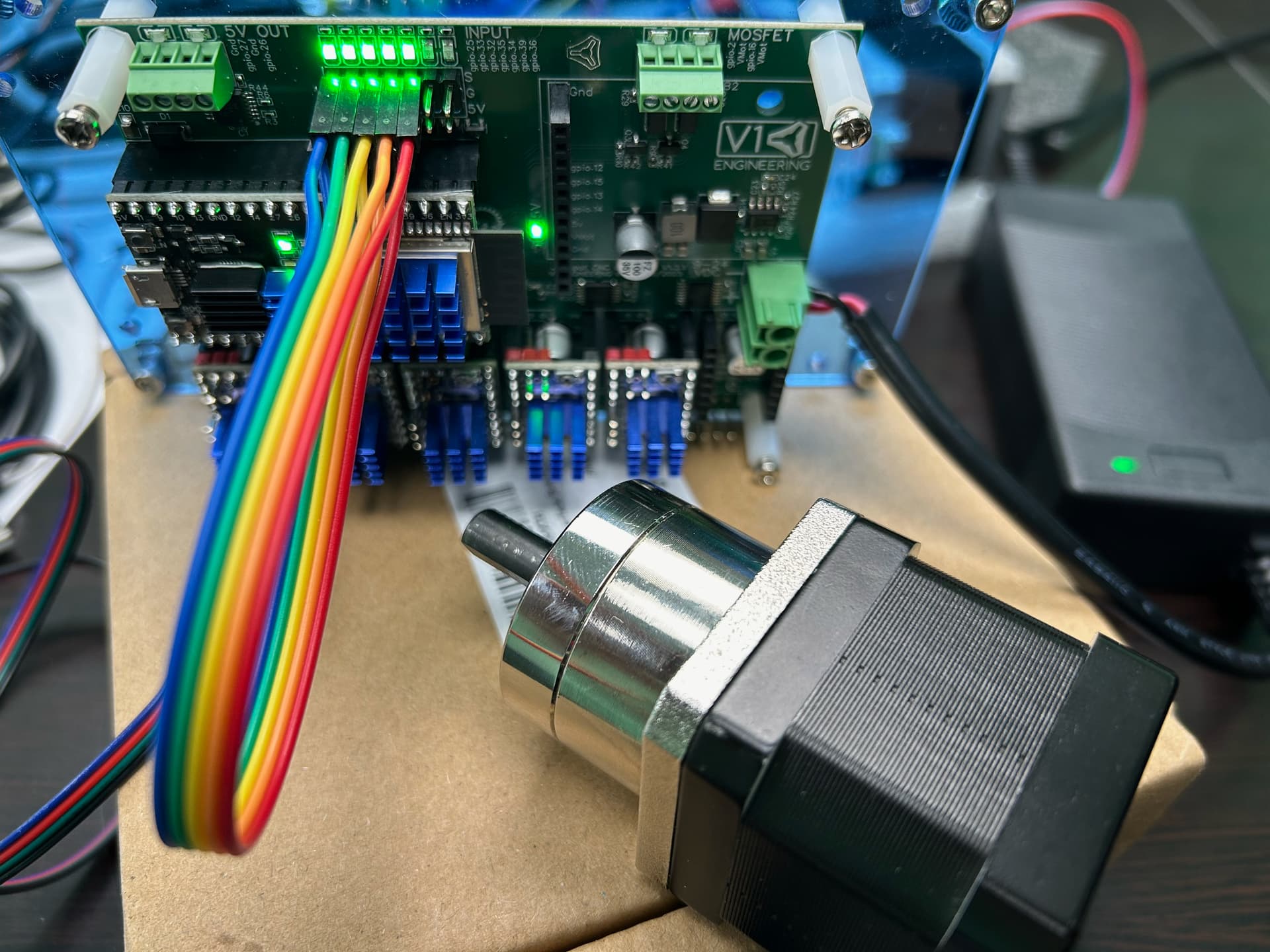

@Bret_Martineau is saying via email that his account here is too new to be allowed to post the media that he is trying to post, so I am going to post it for him. He’s got a Jackpot and he temporarily jumped the end stop pins, and he has tried various stepper motors, but has not gotten movement, except for strange stutter.
Here are his pics and video:

X -/+ gantry movement
Y + turret rotation
Z -/+ up/down cap holder
A - capper rotation
B + liquid pump
C -/+ bottle clamp. keeps them from spinning as the capper spins the cap on.
The limit switches will be used as such. And keep in mind the switches will be used more for an ā€œout of toleranceā€ alarm than an end stop. They will be 2.5mm from activation at all times to keep the machine from wondering slightly and missing the bottle etc.
X switch for the x end stops
Y switch for the y end stops
Z switch for the z end stops
A front doors
B side door and rear door
During testing I have all limit switches jumped so they are staying closed. I also tried pressing home for each individual axis and activating each limit switch/jumper so the machine assumes it has a positive. That didn’t change things. Still no movement.
The board is sitting on my desk for these tests. I have several different stepper motors I’ve tried and they each work fine pinned how they are in three other boards (2 running mach3 and one grbl) and I’ve checked the pin out in a couple of them with my meter as well. Nothing different between them.

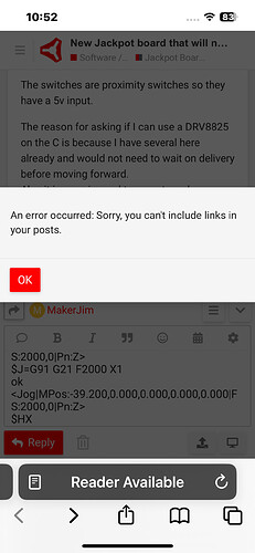

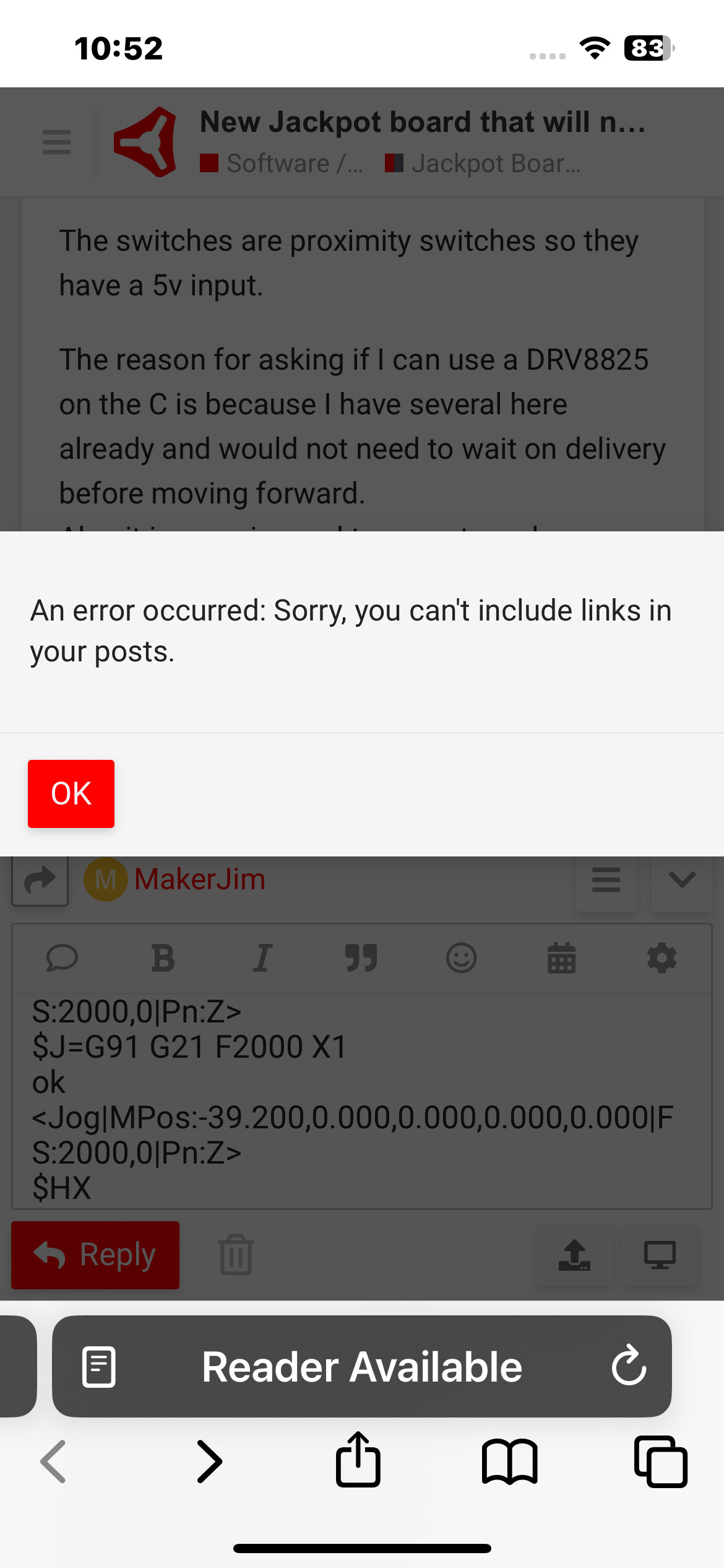

When I attempt to post the $SS I get a warning that it will not post because it contains a link. I removed what seemed to be the issue from the $SS and got the same notification.
So I sent the $SS to Doug who didn’t see anything unusual in it.
I’d rather do all this on the forum but it won’t allow me to post videos, links etc because I’m a new user it it says. Which is true but that certainly is making it a little more difficult. I do under It’s to keep spammers out etc so not complaining just stating what’s going on.

We really cannot do this via email, so someone saying they ā€œdidn’t see anything wrong with itā€ is no help because we can’t view it with our own eyes. Even a seasoned user like @DougJoseph.
They likely are- but it means we need to be able to troubleshoot in the open.
Hopefully we can get your new user restrictions lifted to make that possible.
Since we know Bret’s a real person and not a spammer, is it possible to waive the spam protections for him?
He mentioned that he’s blocked when attempting to post his $SS outcome - site thinks it has links.
