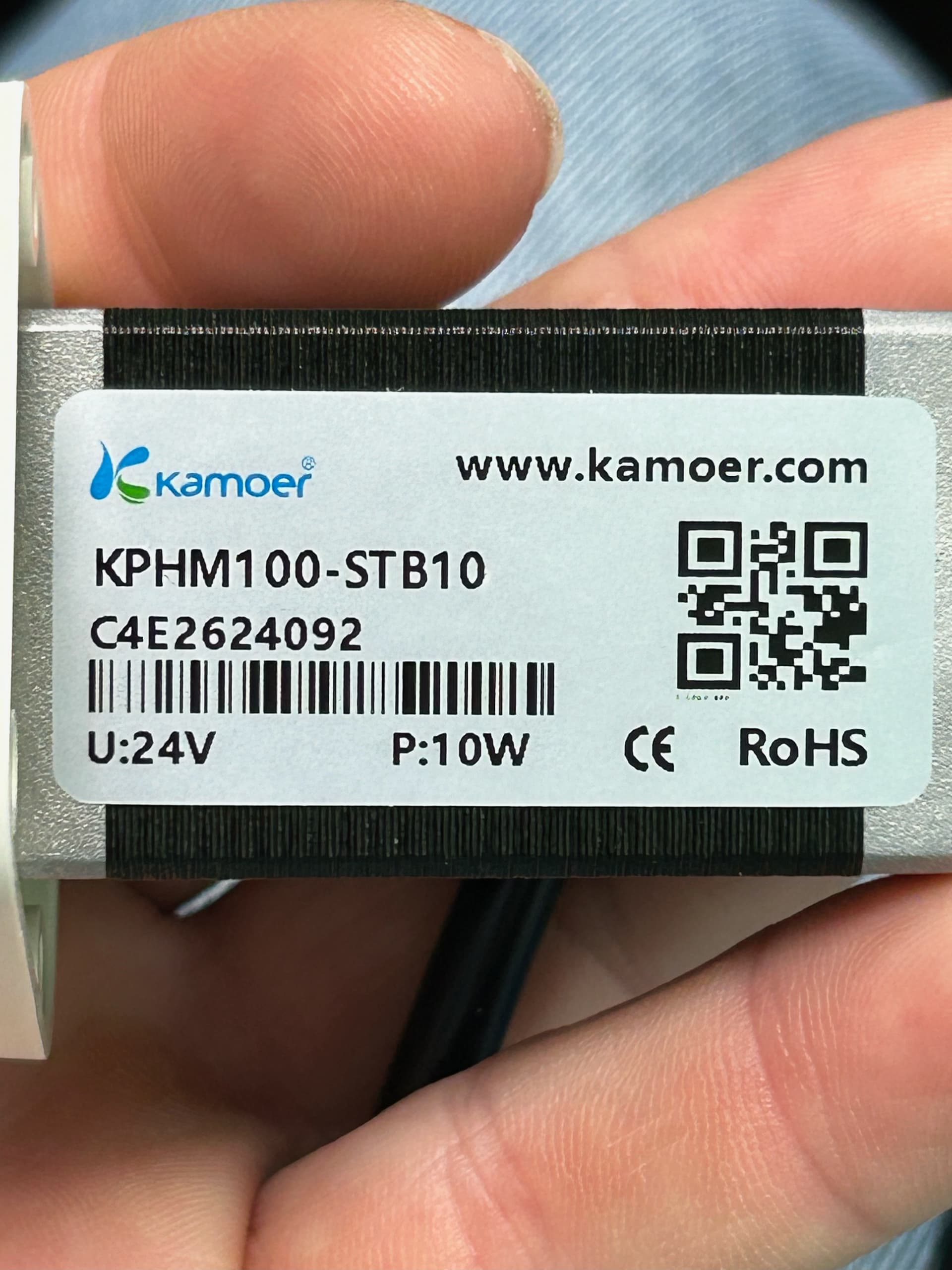

Whatever axis that stepper is on, I think you should try bring this down to a safer value. Like 0.200000 perhaps. If it won’t turn, you can up it but those steppers seem to be rated to 0.4.
I can’t find a spec for the pump stepper. But I’m sure its a lower power application that driving a cnc axis, unless you are pumping mercury or something. Maybe experiment with much lower current settings on the pump stepper too and monitor the temperature.
Edit
24v at 10w ~ 0.4A
So defo try a lower current setting on the pump too.

One more thing, just a note that a stepper motor will consume current and heat up even when it’s not rotating. Something to keep in mind.

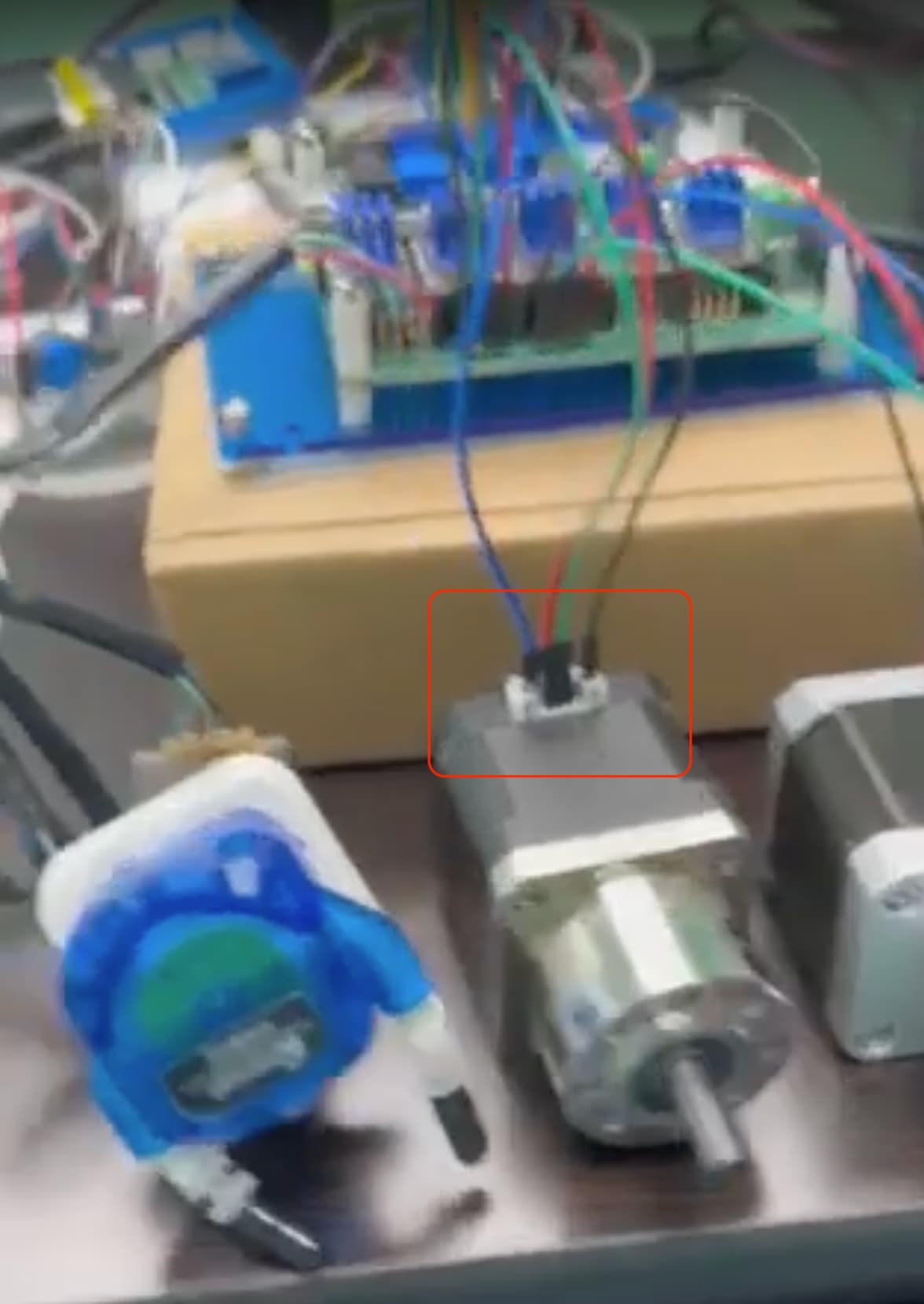

Why so much focus on wiring? Because it isn’t clear you’ve got it correct, and from the evidence it appears that some connections are questionable.
Note the setup below doesn’t have the correct connector plugged into the stepper, and if you have an open on either coil or a miswire this won’t work; exactly as you’re reporting.
I’d recommend making the resistance measurements and doing motion tests using the correct white connector in the stepper motor rather than the test leads pictured bove.

Just skimming this as others are on things more in depth. However I picked up an new extruder/stepper set for my printer and it was running backwards in relation to the code. Looking at all the instructions I could find to reverse a stepper by wiring ended up with 2 coils in opposition of each other (thanks youtube! You’re NEEEEEVER (we need a sarcasm font) wrong!) and it was very unhappy and made similar noises to the video. Swapping the wires correctly and it’s in business.
Just thinking out loud (actually typing in silence…)
Seeing mention of the end stops, they don’t matter. The board only pays attention to them during homing.
If we do basic troubleshooting flow, start with where you know it’s right and work to where it’s wrong…
You’ve connected the motors to other boards and they worked so motors are good. Your computer is apparently talking to the board, and it appears to be feeding the code, so that’s good.
The board appears to be talking to the steppers, they’re at least powering up, so that’s good. I’m assuming when powered up they’re locked so you can’t turn them by hand.
That leaves us in the middle with either all the drivers being bad, or just the wiring being bad. If all the wires were made at the same place, it would not be unreasonable to assume that if 1 has an error in order, they all share the same error.
Since every driver is independent of the others, there would have to be multiple identical failures. Not impossible but not super likely either.
It could be completely perfect hardware, which would push towards a software/programming issue. But if you’re using bone stock in that regard, it shouldn’t be an issue.
If you had an identical board the easy test then is to just swap the boards and do a wire for wire move and see if the problem persists (not the board) or is cured (is the board). But if you have other boards which are apparently working with you setup, why not just change boards to complete the project and worry about the jackpot on another day?
