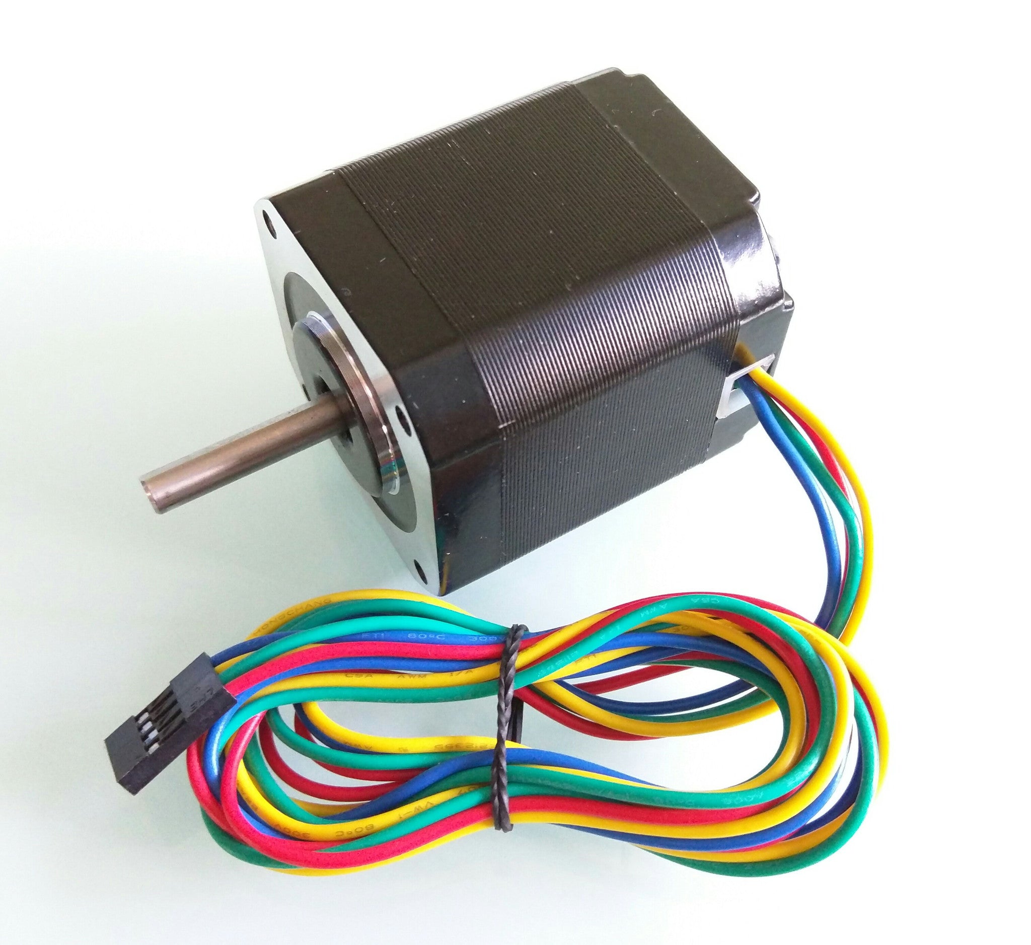

I don’t have access to everything in my shop of course while I’m gone, but I did throw the jackpot, power supply, some wires and a couple of steppers in my bag. I probably won’t have time to fool with It until I get back up north but I think that’s a great idea Riley. Who has a step for motor Nema 17 that they are certain works with the jackpot and also has A part number I can order it from Amazon with. if one of you guys has such a thing, and you know the pin out, then we can do away with human error and or misunderstanding on my part by using the known pin out and known stepper with the known jackpot board.

I have multiple Jackpot boards, and 15 of those steppers that ryan sells. I just got through testing every single V1 stepper in every port on three different jackpot boards. All worked, 100%, no issue.
No need to frantic order from Amazon, find a craigslist/marketplace cheapie used printer.
I’ve also run steppers that came out the following applications interchangeably on Jackpot, SKR Pro 1.2, RAMPS, and Rambo boards:
  • NEMA 17s from two different generations of Lulzbot printers (AO-10x series and TAZ series).
  • NEMA 17s out of a Colido X3045 printer.
  • NEMA 17s out of many Flashforge, Qidi, Creality, and no-name bedslinger printers.
  • NEMA 17s out of a Anycubic Chiron.
  • NEMA 17s out of a Rigidbot Big printer.
  • NEMA 17s out of two generations of Solidoodle printer (Solidoodle 2, Solidoodle workbench dual)
  • NEMA 17s on a JL-1 laser.
The only thing I’ve ever had to do in order to make these work is to ensure that there was good continuity and isolation to the coils. E.g. pins 1/2 and pins 3/4 are correct coil resistance and there is an open circuit between the two coil pair pins.
Of the collection above, three or four of the motor sets needed to be re-pinned as they did not match the 1,2 and 3,4 pin pairing for coils, and in every case those were 6-pin connector steppers.

Thanks Riley. It’s on order from V1. I’m not certain but I think it’s coming from California so I should have it here in Florida within a week. Does anyone have info on A stepper that they are using with the jackpot that I can order from Amazon so it can be overnighted?
I have a box full of steppers from old disassembled CNC machines to choose from at the stop and the only ones that I can get to work with this board are the two that I’ve mentioned in the previous posts. The reason for ordering in From Amazon would be the ability to overnight, but more importantly, being one that specifically one of you guys knows the pin out of.
You could go with the one that Ryan links from the V1 documentation. The caveat with any Amazon link is that it often times get silently swapped out on the Amazon end with a different product.

  • It seems that you know the steppers you want to use work as confirmed on other control boards, and
  • you know the jackpot works as confirmed by using other steppers.
  • But the combination of a certain stepper and the jackpot doesn’t work. There seems to be nothing particularly unusual about the steppers you are using, so that points to either a connection issue or a setting issue.
  • I don’t think you have yet confirmed the wiring measurements as requested by @jamiek and @MakerJim or perhaps you have but I missed it.
  • Also I suggested you change the settings to reduce the power to those motors. The change in angle per step seems like it will affect accuracy but not operation. You seem reluctant to change any settings on the jackpot, but I’m not sure what is to be achieved by trying even more steppers - you already know the board works.

I found this board on Amazon, and saw this in the picture:
The ā€œB- B+ A- A+ā€ indicates it is expecting adjacent wires 1, 2 and 3, 4 to be the coils.
So if all the motors (not just the pump) work with this board then those motors are also wired this way at the 4-pin plug. This should also work on the Jackpot board and I think it can rule out ABAB wiring (or BAAB).

Jaime, what do you think what I circled is? is this maybe a closed loop stepper motor?
It’s a planetary gearbox.
Yes and all instances of this model number (17HS13-0404S-PG27) I can find online show it to be directly wired, rather than a 6-pin connector, but all the sellers I found have ā€œstepper onlineā€ convention where green and black are one coil and red and blue are another coil.
So that further supports that the wiring is probably correct, although the 6-pin connector does raise some doubt.
