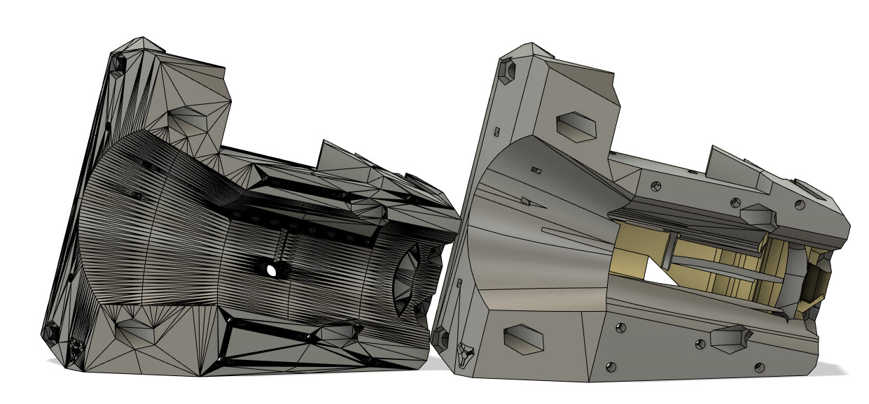

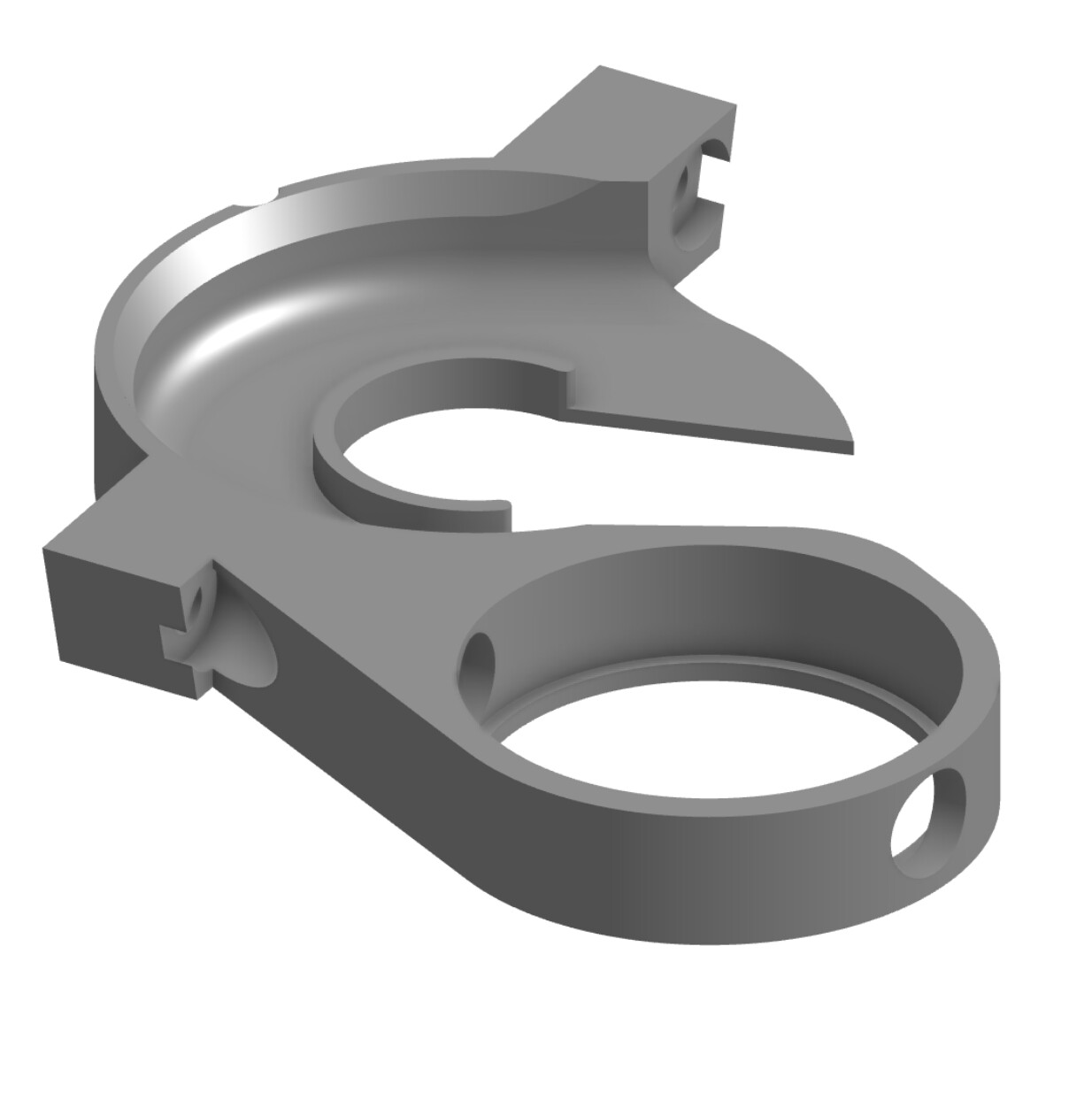

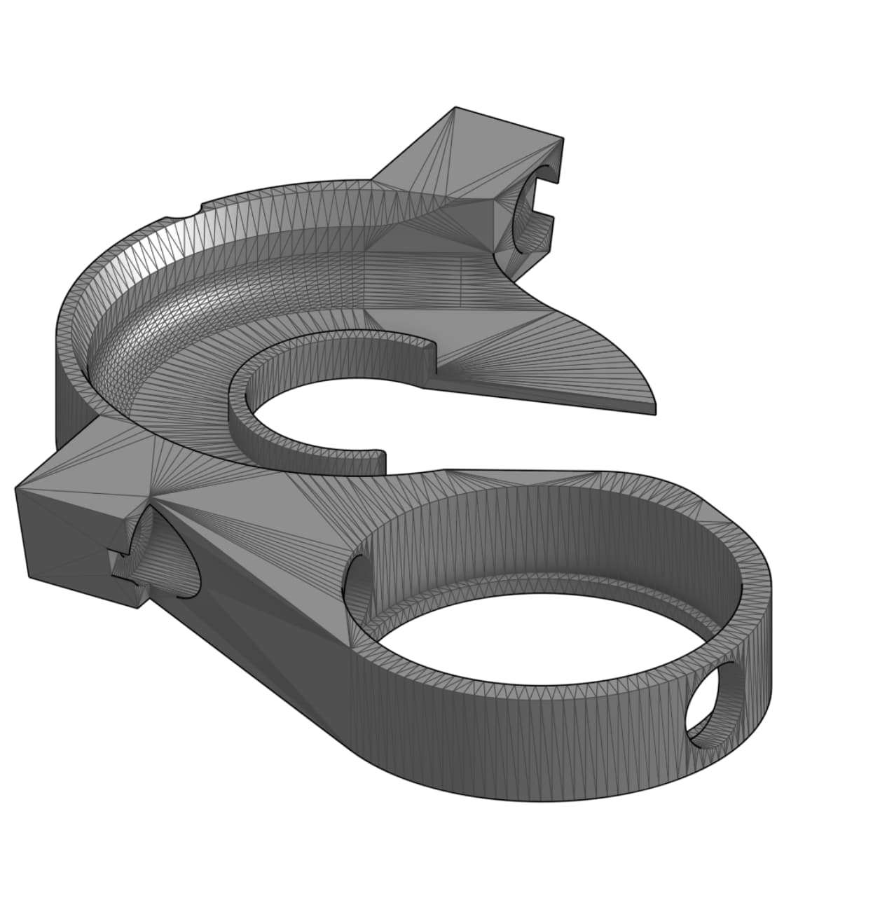

At the moment, these are the results of the 2 different Fusion “auto mesh to body” conversions
When the preparation step by creating face groups has created separate colored areas within a single arcing section, then, if you don’t manually combine the disparate face groups together into one face group, the resulting effort by the prismatic convert will separate those areas, and there will be a line slicing the arc area apart. Carefully checking and combining face groups can help get a better result.
I find myself often in need of an ability to break apart face groups that span across areas where a single face group should not have been that big. I noticed that face groups of small tiny details can get totally missed by the prismatic feature. I think their (Autodesk’s) assumption is that the tool is going to get you part of the way and you need to do some modeling to finish up, but that is very frustrating.
I did play with the face groups a little bit, but didn’t really spend a ton of time with it yet.
Some of the conversions were even worse.
The reality is, I know I’m not going to have the paid version long term, so I’d much prefer to learn some tricks and efficient ways to re-model these things correctly in the spots that I need.
