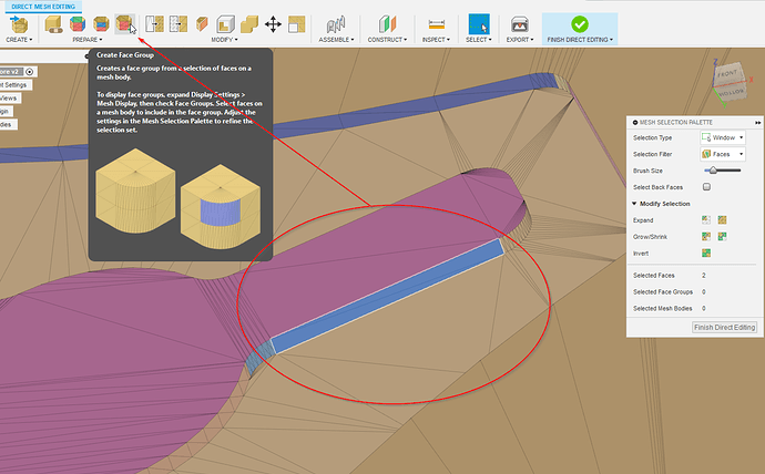

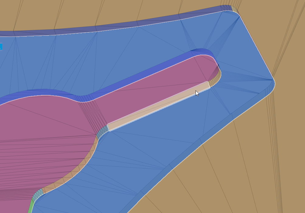

You can see here this face group goes up the side of the V1 logo, where it shouldn’t.
On the mesh tab, you want to select “Direct Edit”
Being careful with the selection process and making sure only the faces you want to separate are selected, click “Create Face Group” on the ribbon:
Click ok on the next popup to confirm you want to create the face group.
After exiting direct edit mode, you should see that you have a new face group that has been separated out.

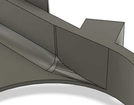

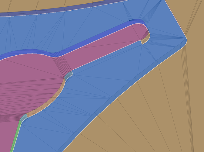

Even with the Face Groups pretty well defined, the Prismatic option can still do some funky stuff.
The logo also got completely skewed and has a hole, which is also hit and miss where it works on some conversions and not others.
What I haven’t figured out too well now though, is where to go from here.
I tried using the surface tools to patch that hole, but it fails.
And then some of the holes, are right in the middle of what was a single face group on the same plane.

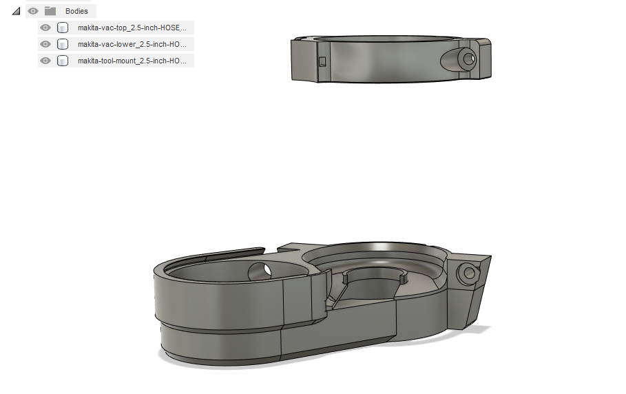

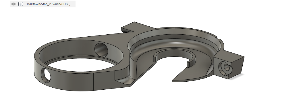

After many iterations of Manually edit face group, convert, undo, fix face group, convert, undo, etc.
I got the 2.5" Makita mount to convert perfectly into a closed body.

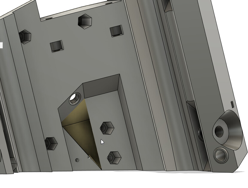

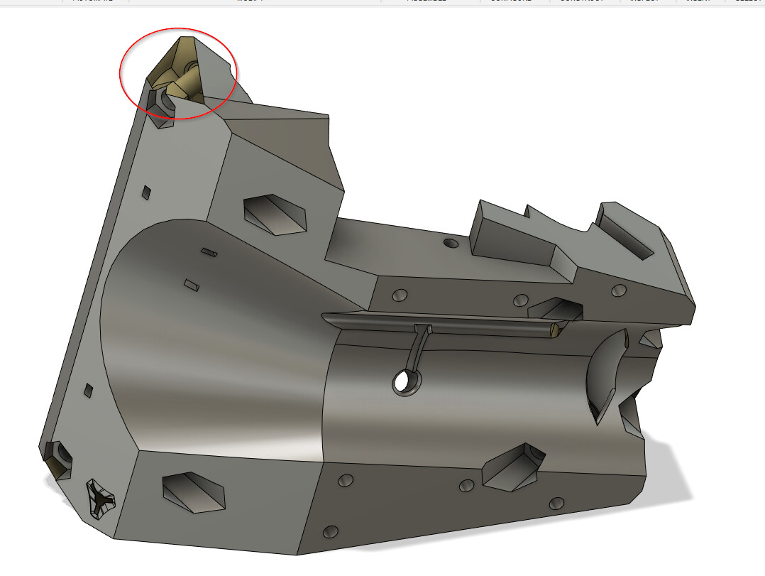

I was able to get Doug’s 2.5" remix converted almost completely correctly.
There was one spot that I just don’t know enough about Fusion to fix, and didn’t feel like bringing it into Blender since it’s not really a spot of the model I expect to have to change.

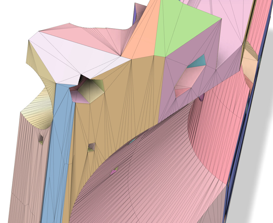

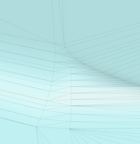

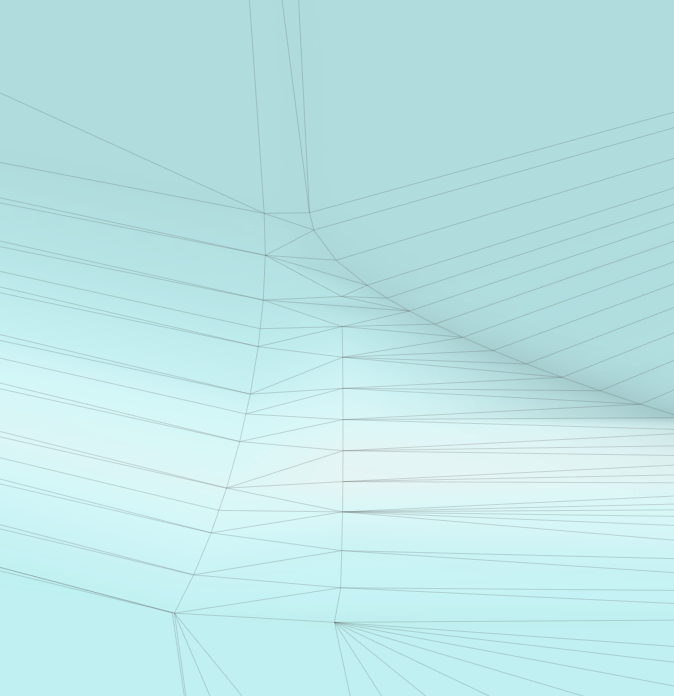

This curved area of the the lower section has a bad mesh topology in the STL:
I guess the curve got gradual enough that the tesselation decided it could span the entire thing with one triangle, but Fusion struggled to patch it at all unless I made a bunch of face groups in that area.
This is easy for me in a tool like Blender to repair if I ever need, but at that point I’ll probably be beyond my trial and looking more at the redrawing side.

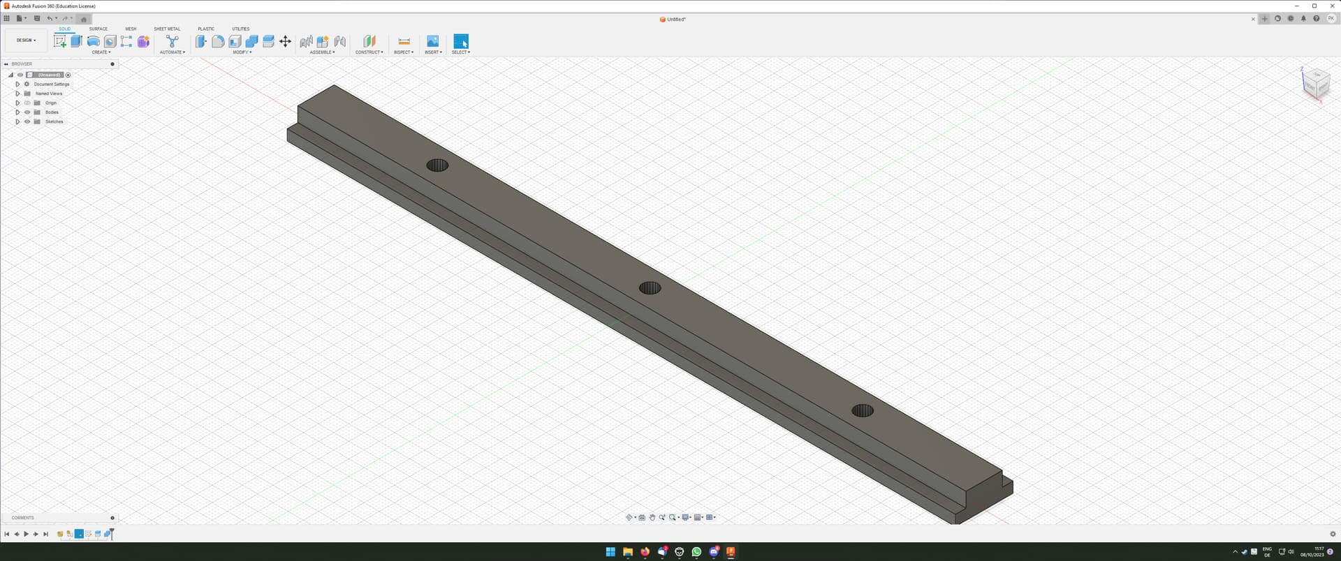

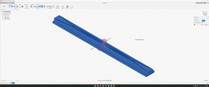

The way I do it:
Create a line on one of the surfaces as a sketch. Use this line to split the imported object. It miraculously changes all those stupid little pieces.
Combine the two halves again.
Done.

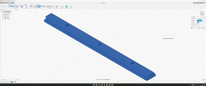

Just tried that with the Core, didn’t work. :frowning:

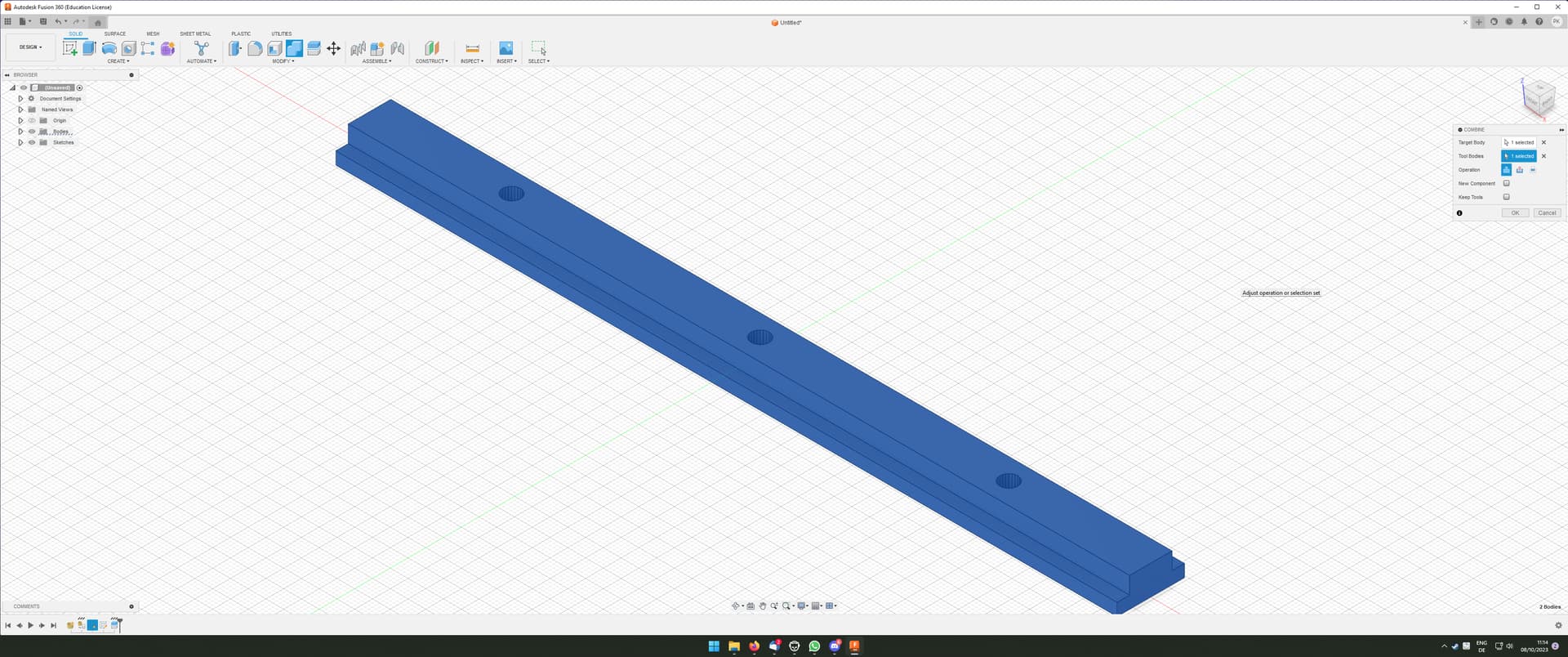

Yep, likely there you are benefitting from the auto-repair feature in Fusion. Without drawing a line, you can usually just stay in Solid mode, select one of the small triangle faces and hit delete.
Fusion will auto-repair it by joining all planar faces.
This works great for relatively simple geometry, but Fusion gets worse and worse at it the more fillets, holes, and general changes of planes it has.
I have found that most of Ryan’s parts it doesn’t deal with very well.
