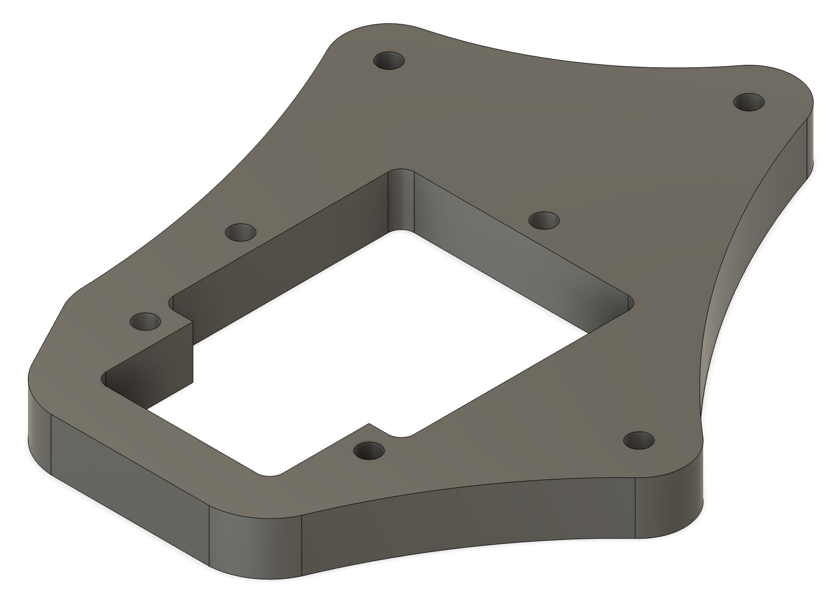

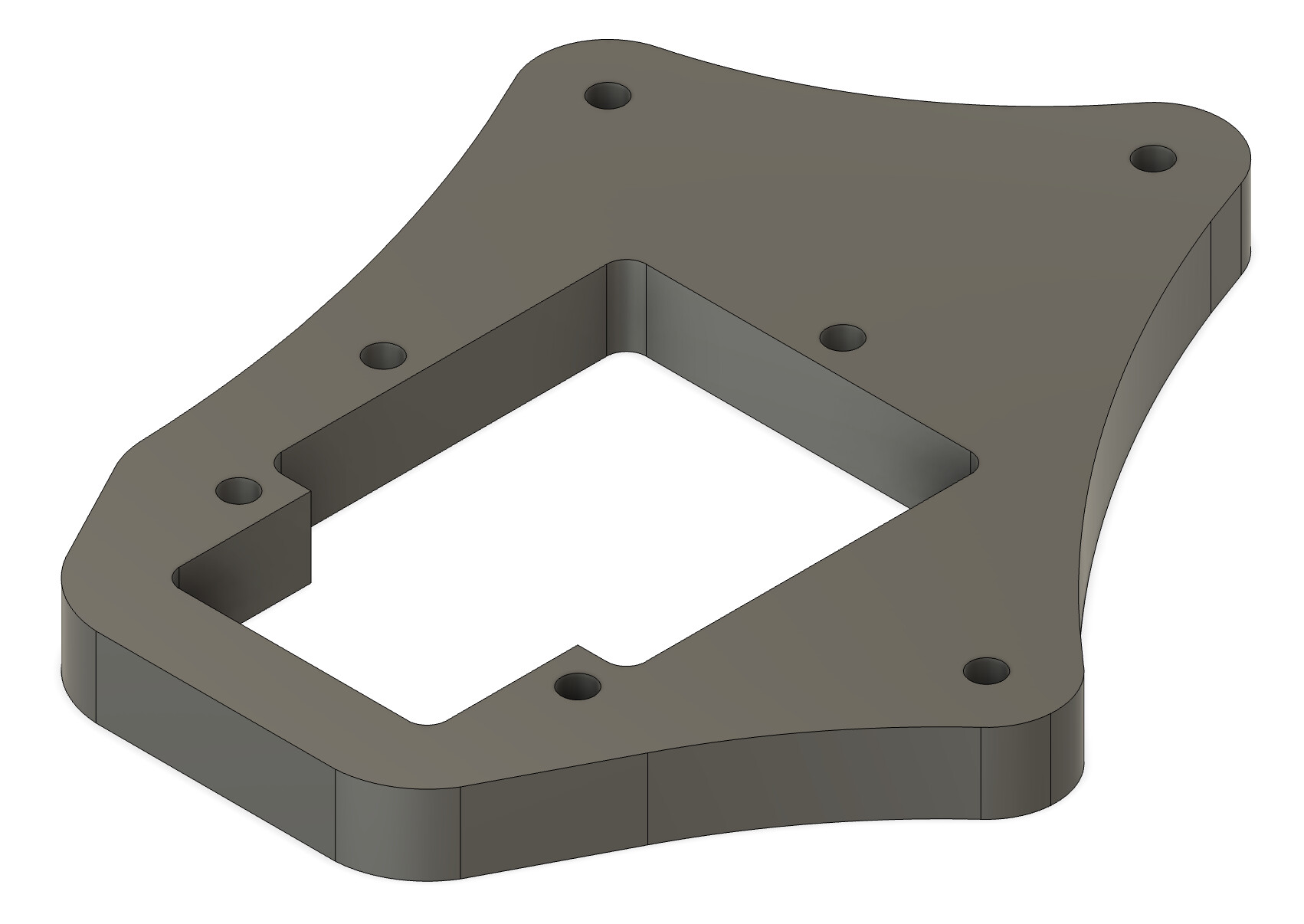

The problem is the SVG is formed with a lot of arc, creating the chatter. I attached the FS360 view below.
Y-extend Plate STL - Chatter
Any ideas will be welcome.
Thanks!
Did you try trochoidal milling? This looks rather a problem with the CNC than with the CAD.
CAD problem. By The way, using CO2 laser for cutting this and the chatter creates an on/off laser. If I was using wood then it would not really matter.

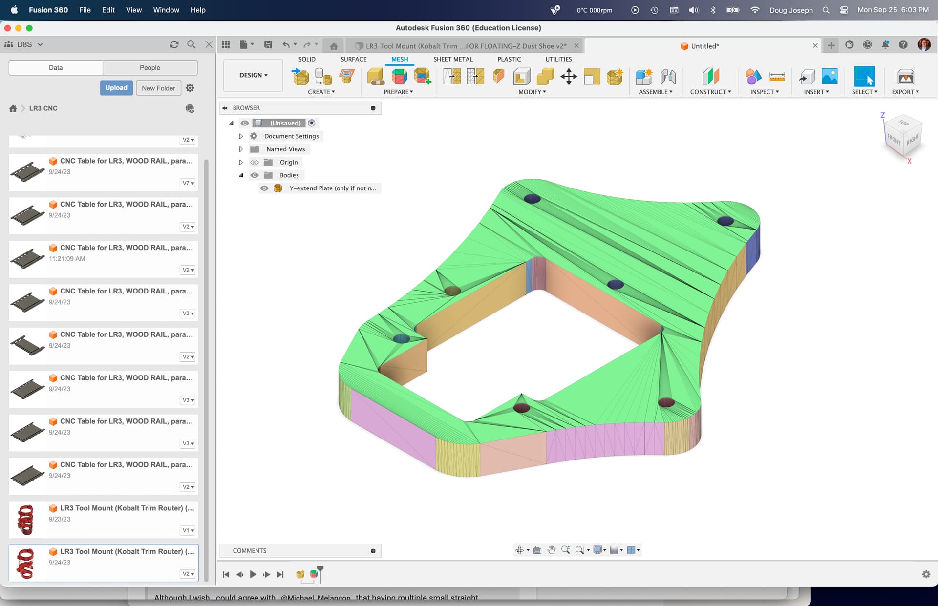

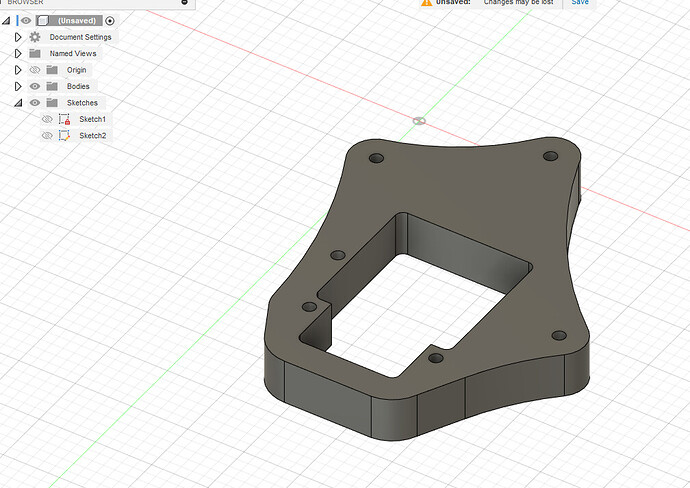

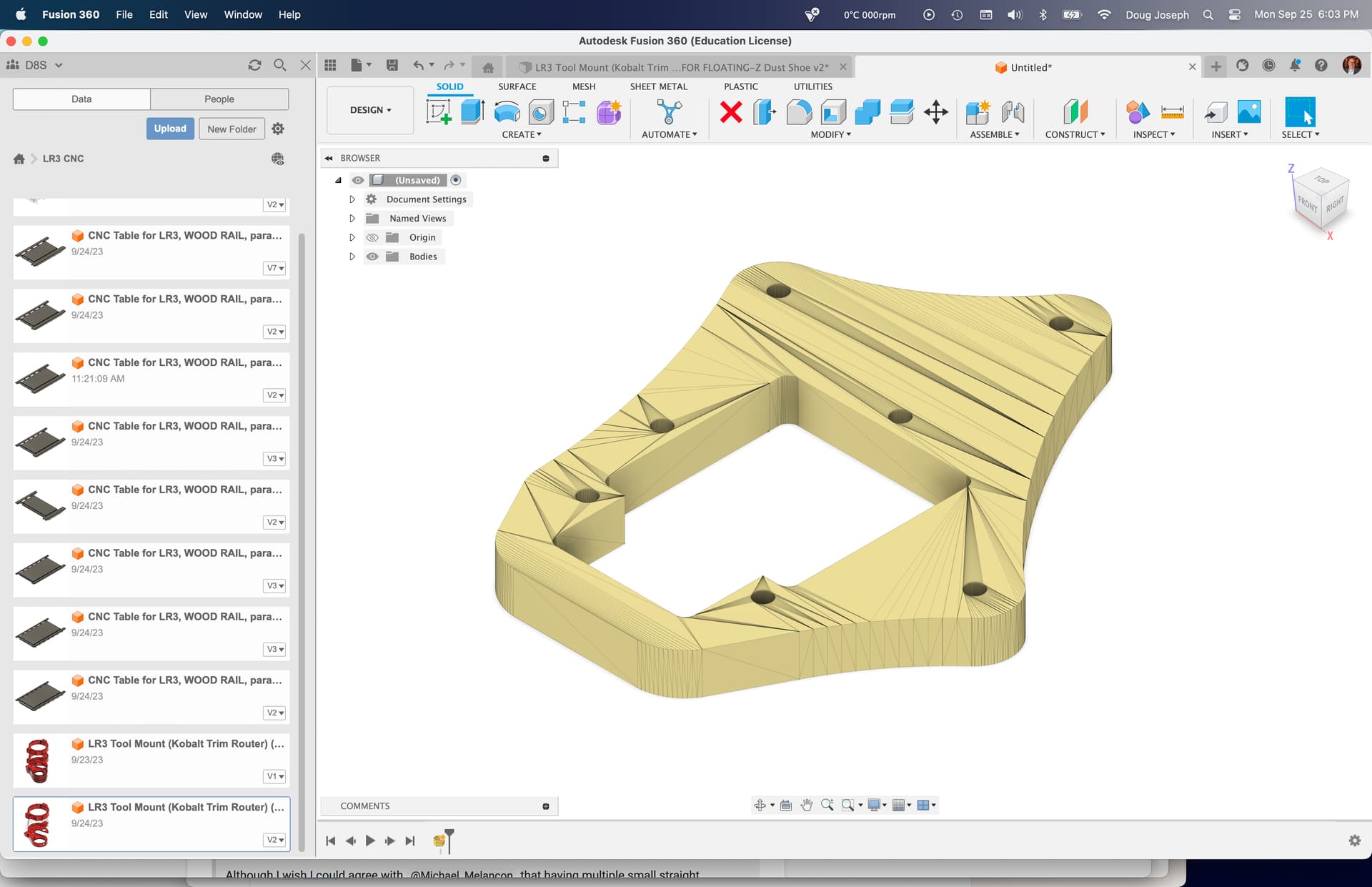

Now, two days, and still not done, so not so easy. The Net is full of articles talking about this, but no join lines feature. Looks like this:
These nodes act like starting and stopping points for our laser during cutting, and rather than cutting along a smooth path, this will cause an effect that looks similar to “chatter” when machining the part.

That looks like you just extruded the SVG directly. You have to create a new sketch and use the reference points to redraw it so you have proper geometry
The number of points that are there make it pretty easy to redraw the model on top. The extrusion will then not have all the breaks.

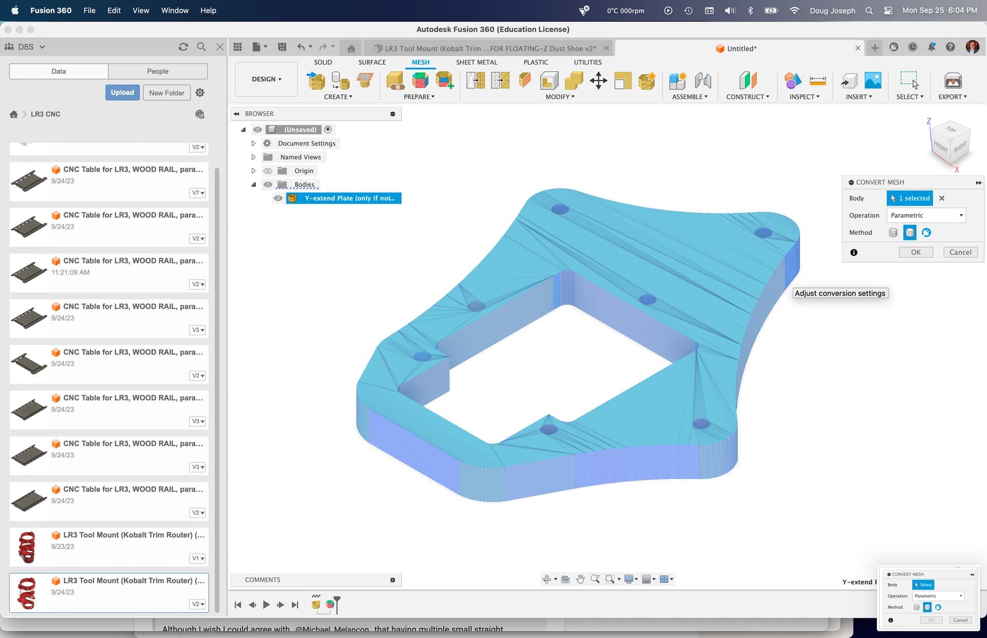

Here is what I am getting when I follow a process that I will outline with screen shots:

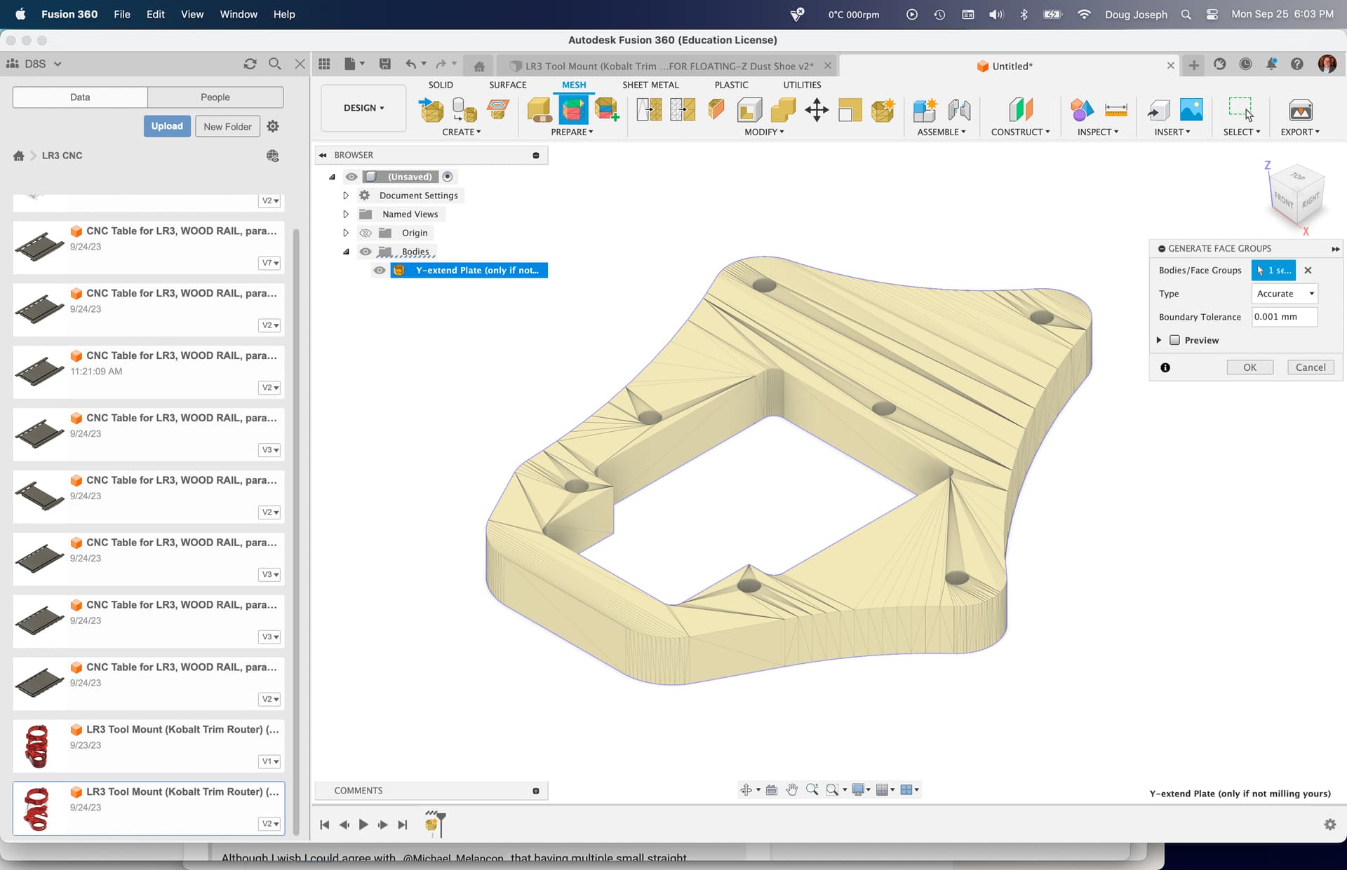

Here’s the progression, from importing the mesh, to selecting the Mesh tab, to preparing by Generate Face Groups, to Modify > Convert Mesh, and using the settings shown in the screen grabs coming up…

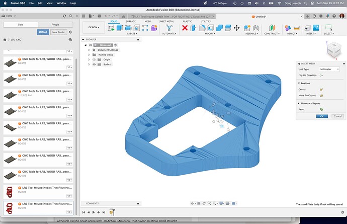

Insert > Mesh:
Comes in like this:

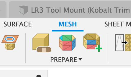

Click into the Mesh tab:

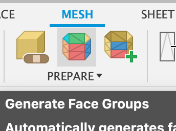

Under “Prepare” click “Generate Face Groups”:
Select the mesh you just imported, set to Accurate, and I used “0.001mm” for Tolerance:
Yields this prepared result with generated face groups:

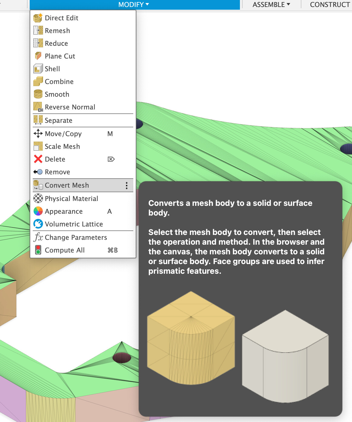

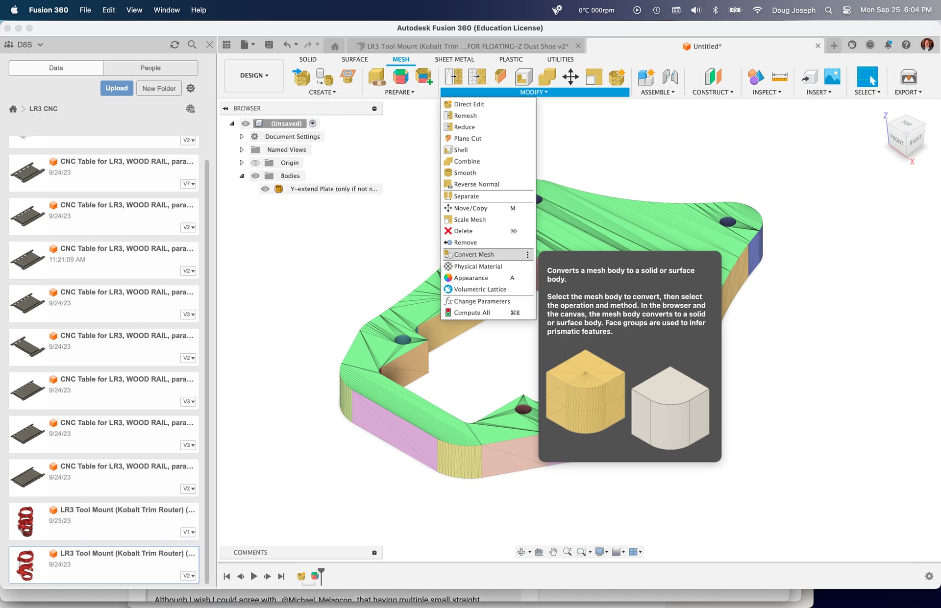

Under Modify, choose Convert Mesh:
Select the mesh you imported:

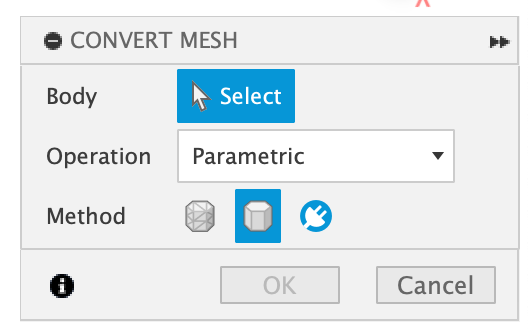

Set to “Parametric” and choose “Prismatic” —
Note: Prismatic may not be present in free Hobby license version. If not and that’s an issue, I’m glad I was able to do this for you.

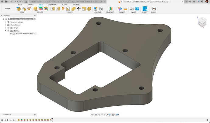

Results in this:
@jcassar :
Attached is the F360 file resulting from the conversion I illustrated above. Mine does not have the segment lines that yours has. Again, I outlined how in the previous post!
Y-extend Plate (as F360 Solid Body with ‘parametric’ base features).f3d.zip (1.3 MB)
Here’s a “close up” of my result as contained in this file:
This method is certainly the easiest way if you have the paid version of Fusion.
For those of us the Free version, the Parametric conversion method is not available.
In that case, you have to retrace it, or manually repair the mesh.

Let me correct this… Parametric is there for the Free users, it’s the “Method” option that is restricted.

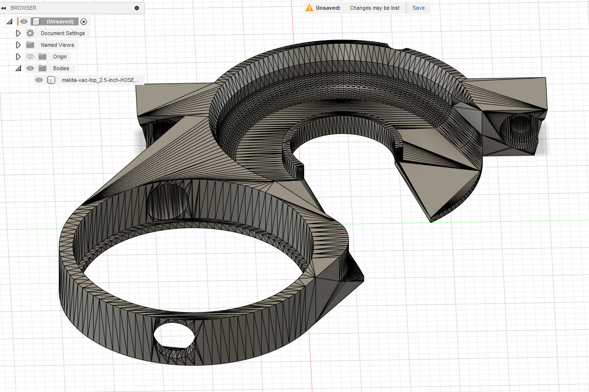

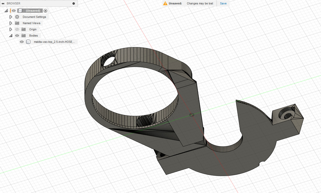

We don’t get the 2nd option which is “Prismatic”, we only get “Faceted”, so the result looks more like this:
Sometimes, you can click Delete on a few faces on flat areas and it will auto-repair and get you a better looking Body in some flat areas:
But sometimes, especially from Sketchup, Fusion just can’t handle it, and you end up with stuff like this:
At this point, this is where I struggle to manually get it to something that even remotely resembles what would come out of that Prismatic option.
