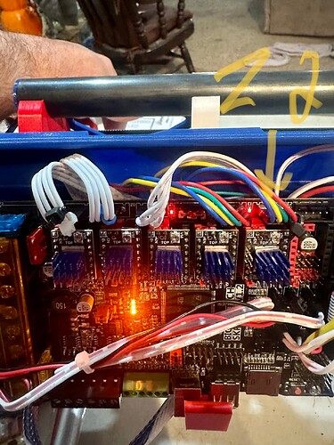

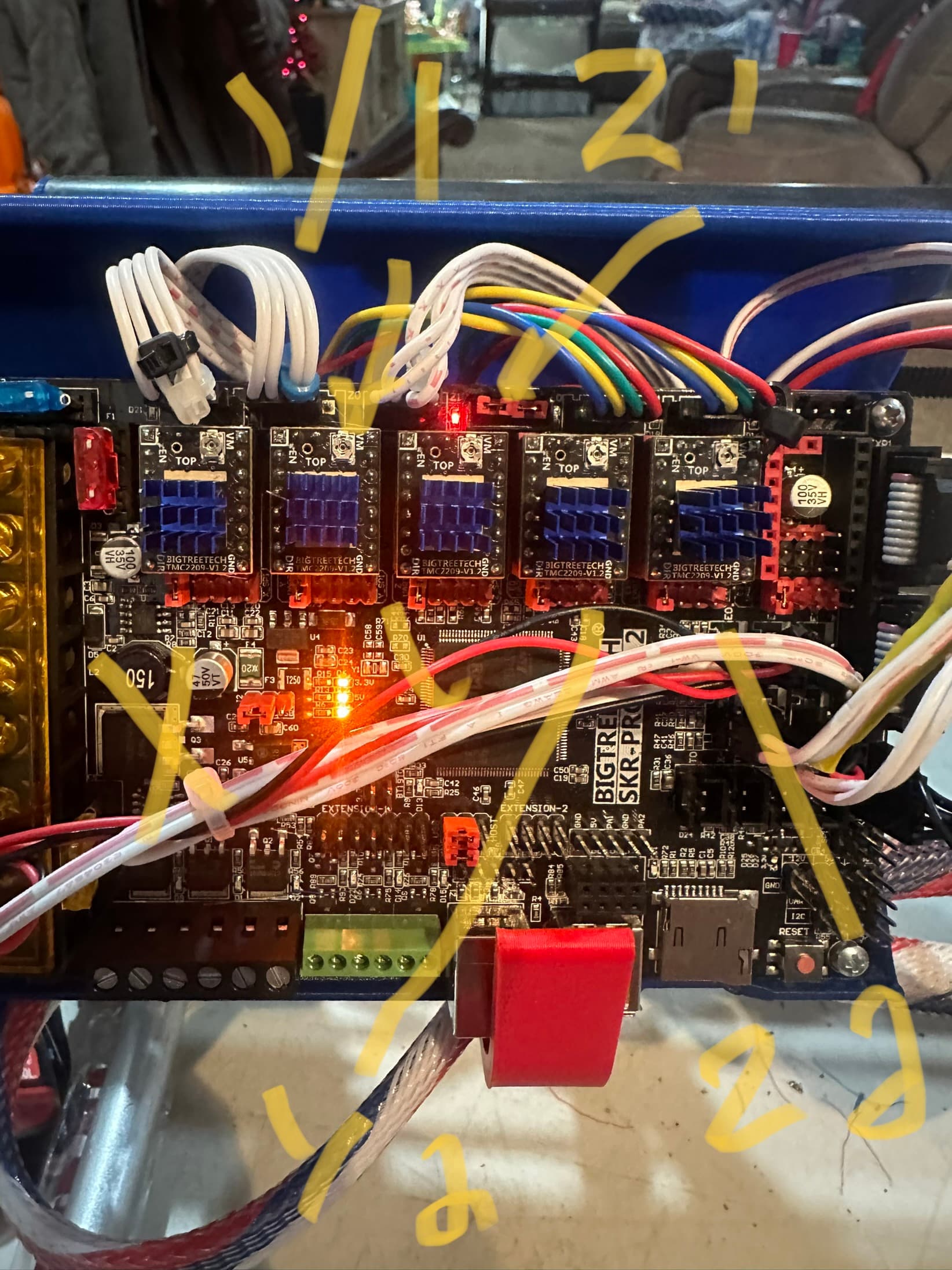

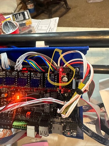

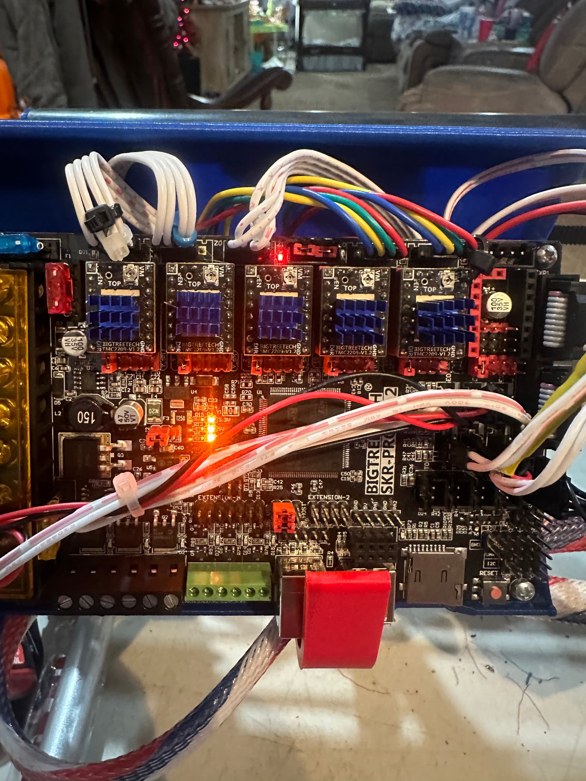

I will try to explain this without getting overly confusing. Basically I tried to home the z axis first the non rail side stepper was going down, flipped the stepper wire and that is working properly. The Z steppers do not stop they make a clicking noise and seem to be trying to keep going. I have tested all my limit switches and everything makes the lights come on BUT the Z stepper on the non rail side which I have labeled as Z1 it lights the control board port E1 which does not have a driver installed, yet does plug into the limit switch port labeled E2. Also with out any limit switches triggered there is a light on beside the jumpers port Z1. For reference I have used Y1 and Z1 for the non rail side and Y2 and Z2 for the rail side.
Port E2 light on when limit switch for Z1 triggered
Z2 light comes on when limit switch for Z2 triggered
How I have it wired
light on with no limit switches triggered

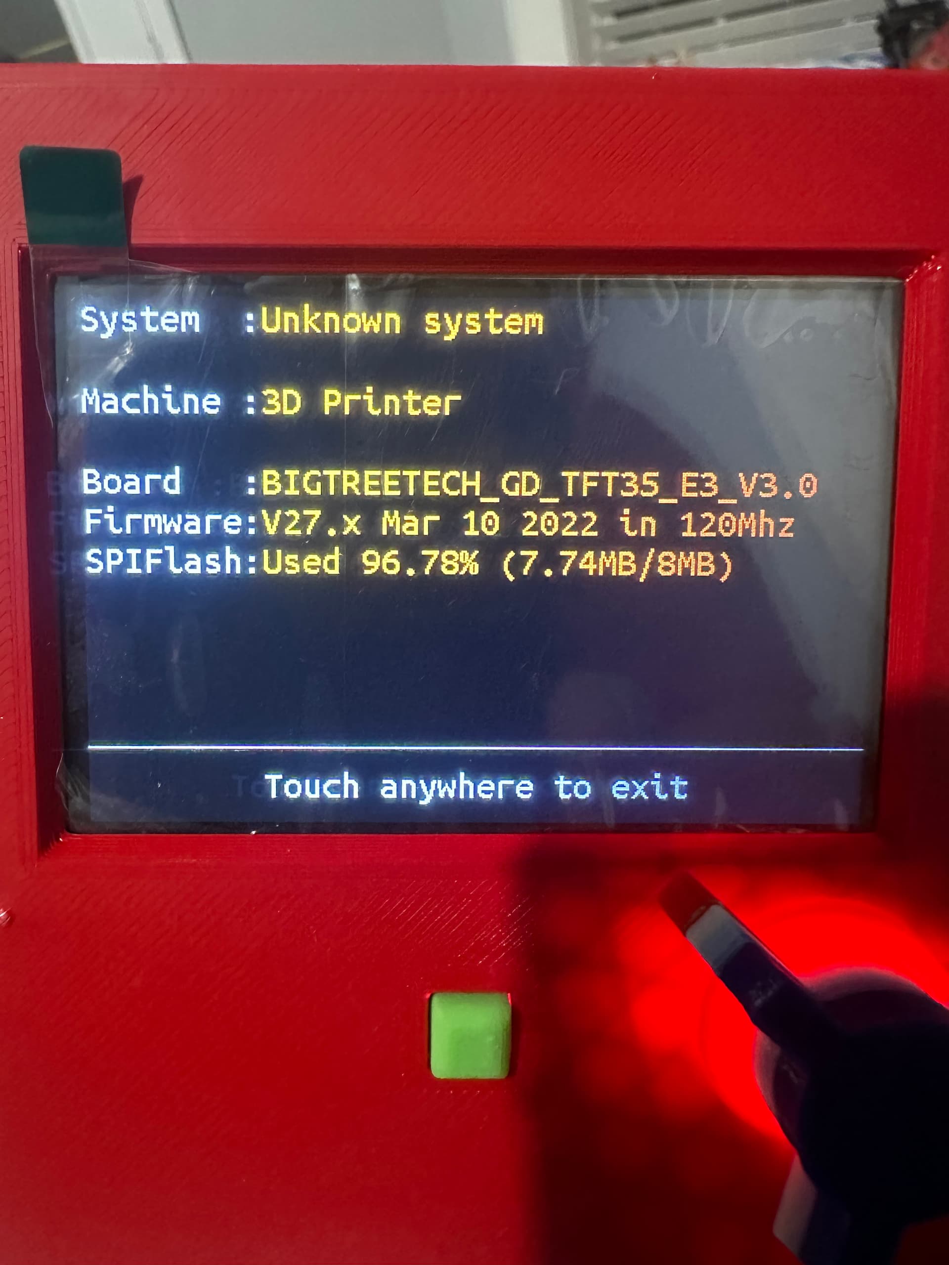

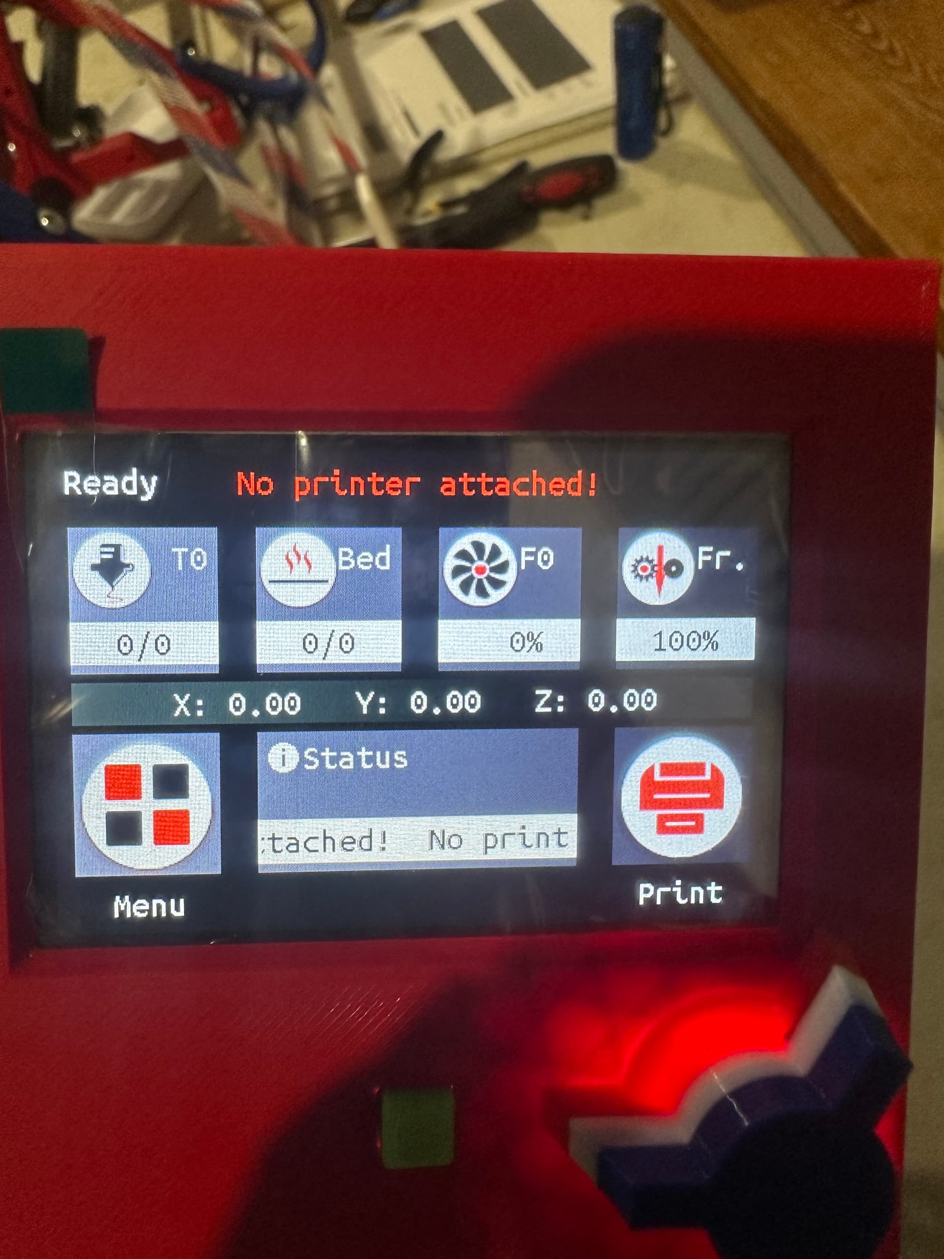

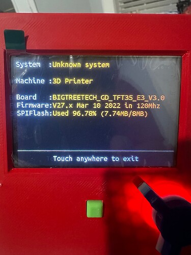

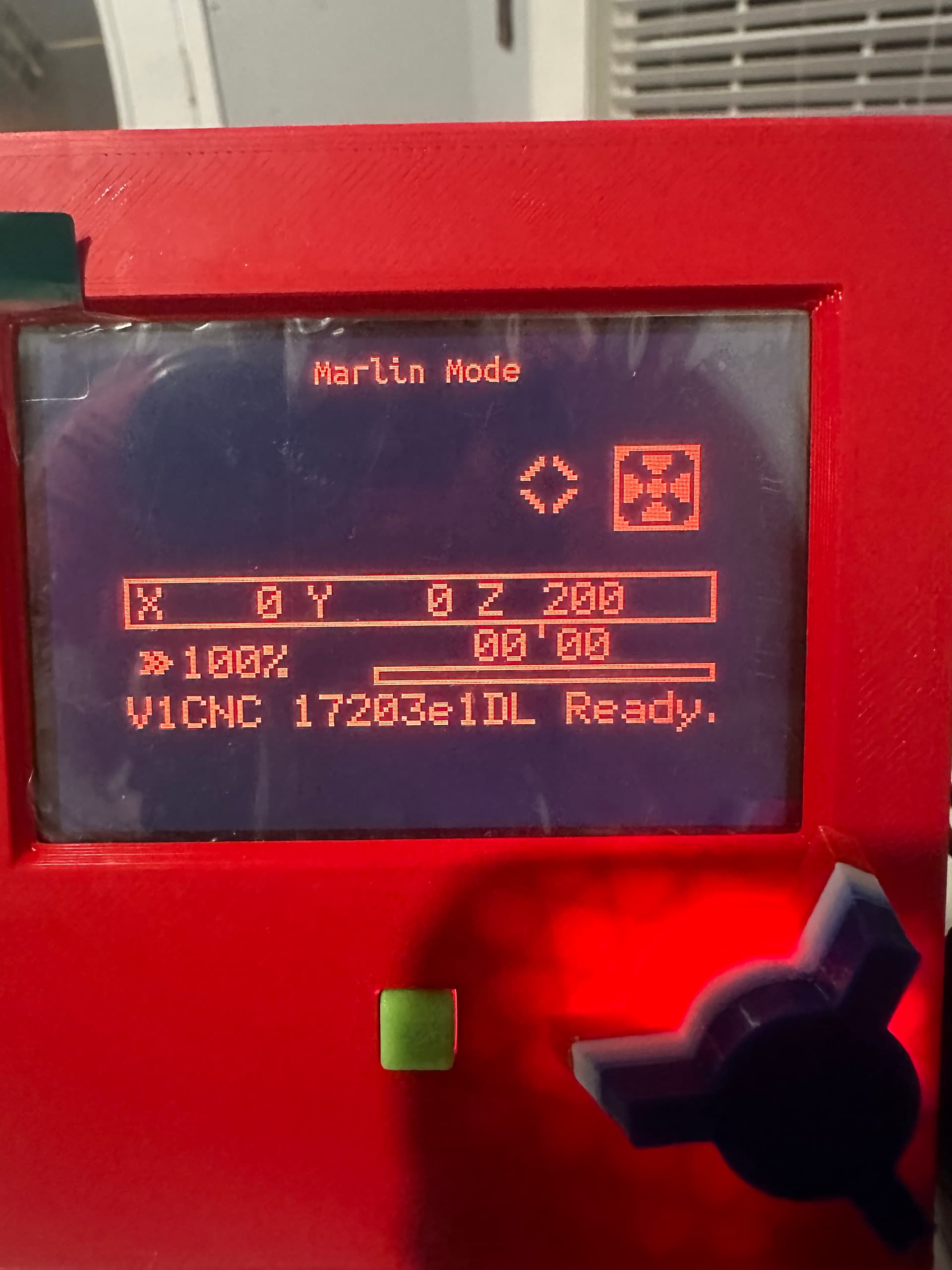

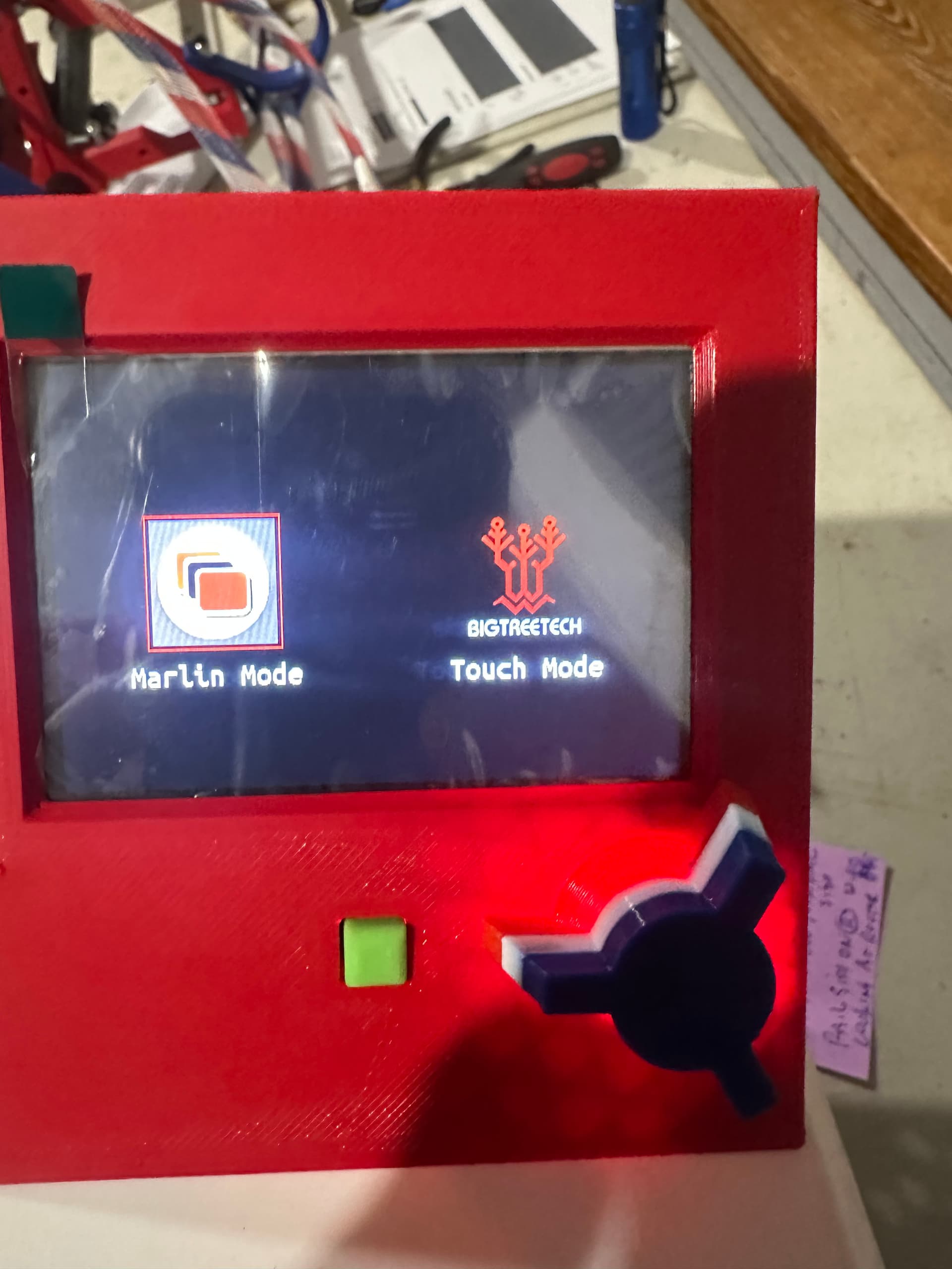

Trying to figure out what software version I have installed I found that the software shows 3d printer is that right? I have also attached the versions and info screens I found. This was supposed to be flashed when I bought it for the lowrider3. Do I need to update the firmware? If so do I have to do it in order or will the latest release simply take care of the missed updates?
From touch screen
From Marlin mode
Check your end stop wiring.

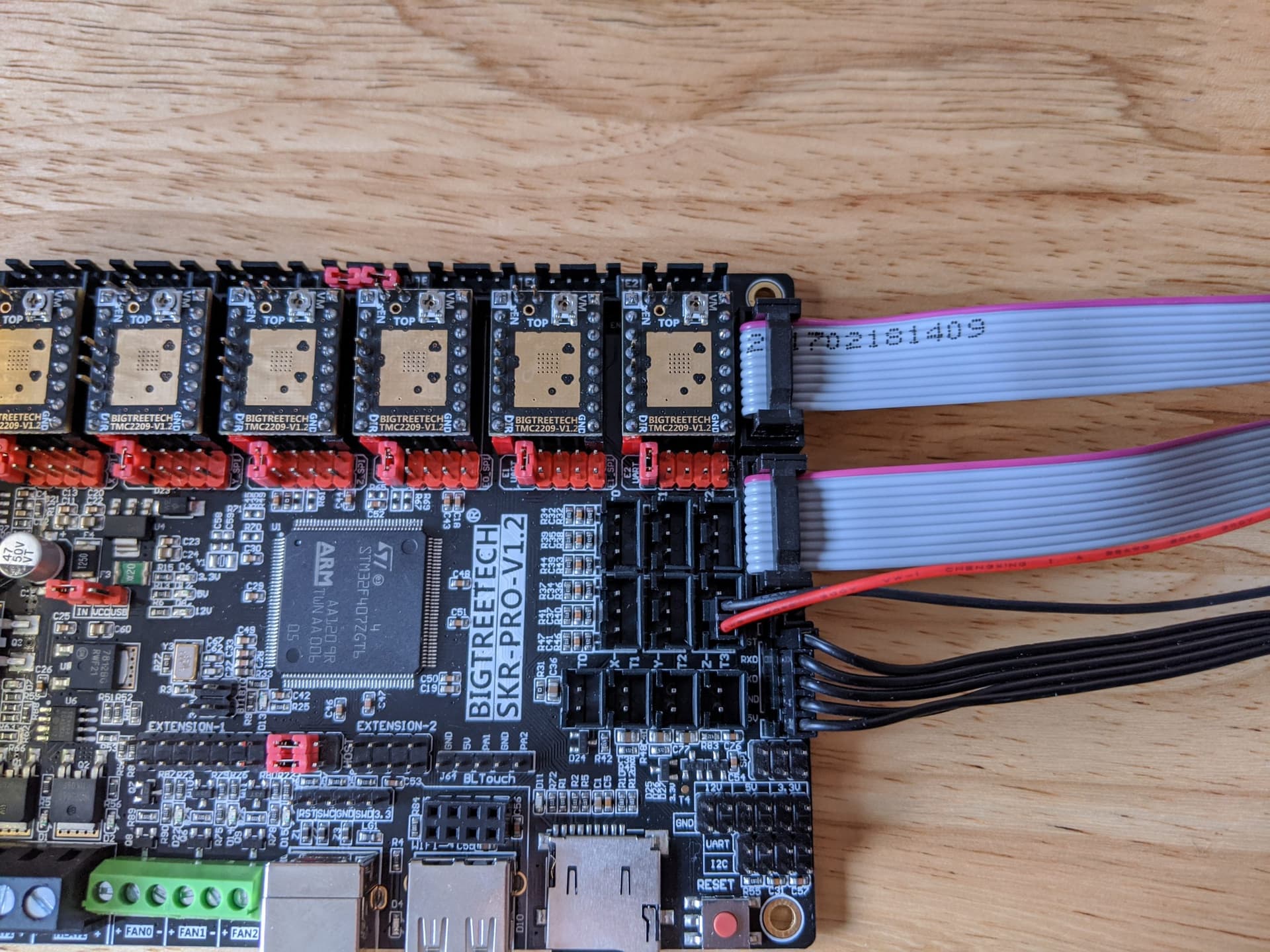

As per the SKR documentation wiki:
LowRider Dual endstops¶
!LR3 endstops
X1 (only X) goes to X (bottom left of picture), Z2 goes to E0 (top left), Y1 goes to Y (bottom middle), Y2 goes to E1 (top middle), Touch Plate goes to Z (bottom right), Z1 goes to E2 (top right). The lights for the end stops don’t exactly match the drivers used for that axis. Not intuitive, for sure!
So E2 on when Z1 triggered is correct. There is no Z1 light activated by the endstops (always on?), but if E0 comes on when Z2 is triggered, then that is correct. (I think you may have Z2 wired to E1)
I think that is the display firmware (not the control board), it looks normal from what I recall. Hold the knob for a few seconds to get to the touch screen (you are currently in Marlin mode, can only enter gcode commands from there).
I edited the pics to help. The top one is from the touch screen mode then went to info. The bottom one is is marlin mode and could not find any firmware version there.
I don’t recall how to view the controller firmware, but if you bought it from Ryan, there is a 99.99999% probability that it is correct.

So the light for Z1 should or should not be always on? I am going to have to get the multi meter out over the weekend and find out which end stop wire is which for sure. I did not label them thinking it should be simple enough and they should be connected to its stepper. But now I am in an electrical nightmare, or I am overcomplicating it. One or the other.

Or you could just activate the switches in sequence and follow which lights come on.
Z driver (3rd in line) light is activated by the touch plate., E0 driver (4th in line) is activated by Z2 switch, E2 driver (6th in line, not populated) is activated by Z1 switch.
I don’t have my machine powered up right now, so I can’t verify, but I think that there may be a light beside the Z1 connector (which has jumpers installed and doesn’t have a driver associated with it). It is showing lit in all of your photos, so it may be always on.
Yes and when I go to the main screen it has 3d printer info on it. Hold on I will go get a pic.
Sorry, that is confusing. The drivers are labelled X, Y, Z0, E0, E1 & E2, while the motors and endstops are labelled X, Y1, Y2, Z1 and Z2. To add to the confusion, there is a Z1 connector that is unused (jumpered with no corresponding driver).
I meant to say that the Z1 connector light may be on, and that it is not activated by any switches. It shows lit on all of your photos. (earlier post edited for clarity)
