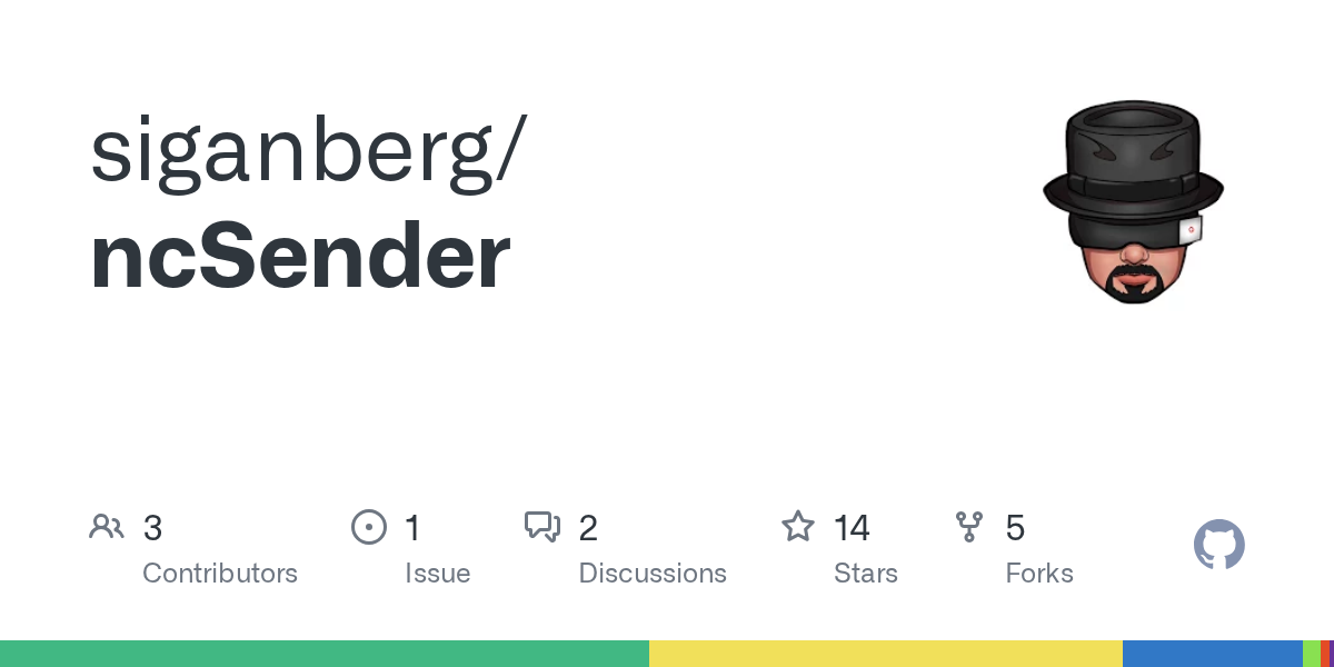

NCSender

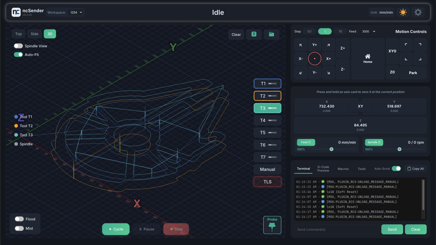

Looks really good, he is working on getting it to work with FluidNC. It’s a fork of Gsender he tries to make a lot better with plugins etc. It looks fantastic, if you ask me. :slight_smile:
this image alone makes me want it. There was alot to digest in this one pic, but when I saw 3 tools in different colors for their paths WOW! Now i see grblhal, but nothing about fluidnc.

So is this a replacement for the fluidnc web interface?
No, this is a desktop app and you need to run a long USB cable from the computer to the CNC controller. Instead of the gcode running off the SD card, this is sending individual lines from the gcode file.

This is a desktop interface. You connect a computer and keep it awake while cutting and each gcode command is streamed over USB.
More reliable in some ways and less reliable in others.
You can also use pi 5 as headless server that connect to your controller. ncSender is pure hub-spoke or client-server architecture, so you can have many client remote to the server.
Streaming of g-code is from server to the controller, client only provide UI to interact to the server.

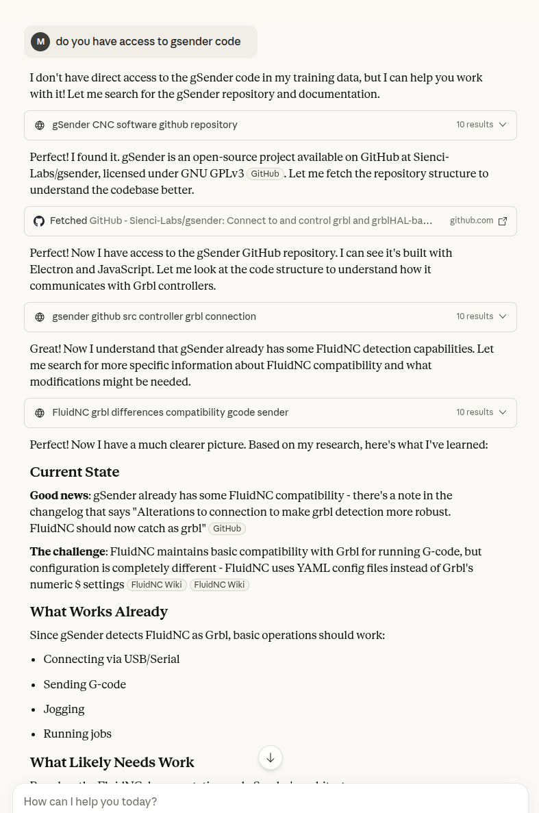

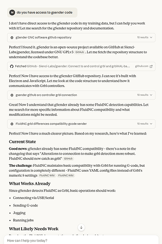

o.k. so I decided to give claude a try for free. This is kinda cool. I asked claude for help making gsender fluidnc compatible. It then asked me a bunch of quetions, (lol, i did not answer, instead i asked if it had acceess to gsender code, and it gave me this
kinda cool.
hee, hee, it then saw that it works with usb/serial, but not with telnet and recommended I try a virtual com port. I may be trying that! If I can get a wireless connection for Gsender, that would be cool
