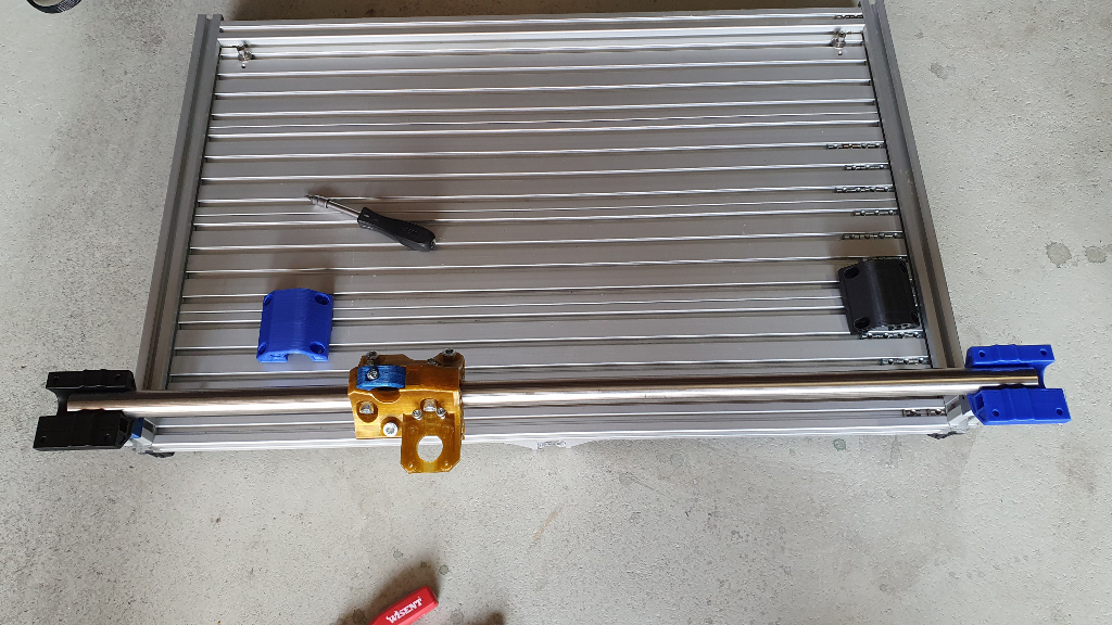

First I have dismantled my initial MPCNC. I have also built that MPCNC on a Alu Frame 30x30 as you can see. So I wanted to use most of the parts but also to modify some things for optimization … mostly especially for higher stability (for working with aloy).
After dismantling I have tested the dimensions of the Primo and had to recognize, that you can only use the non-printed parts like pipes, Alu-Frame etc, in decreasing the overall dimensions (from MPCNC to Primo). Otherwise you can’t use the pipes etc. of your earlier MPCNC.
For the fact, that I wanted to decrease the width, I could use some of the pipes (Y-axis), but the X-axis pipes I have to replace. That will be done in the next days.
Next imge: cutting the Alu-Frame parts. Oh, I love(!) that “monster-machine”. It is really scary in cutting steel, aloy etc.
Building the base (bed) of my CNC. Dimensions are 860x540mm, the inner bed is 800x480mm. I have realized a grid construction under to place the bed parts on top. In this way it is later easier to place the nuts within the bed for fixing working material or clamps. The legs are also based on Alu-Fram 30x30 and directly attached to the bed construction. Of course it is very important to work very precise and to adjust the frame parts really orthogonal. This base is - in my opinion - a huge advantage compared to the standard MPCNC.
Cutting with my monster it is very precise so that all parts are really(!) orthogonal to each other. I measured it electronically and got on all corners exactly 90° (not even 89.9°)!
Next image show the first structures of the pipes with trucks and also the core is just equiped with the bearings and clamps.
After the bed had to be prepared to be bolt together with the base construction.

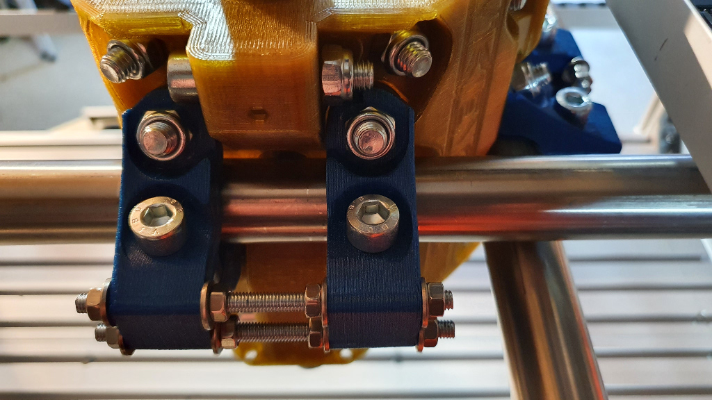

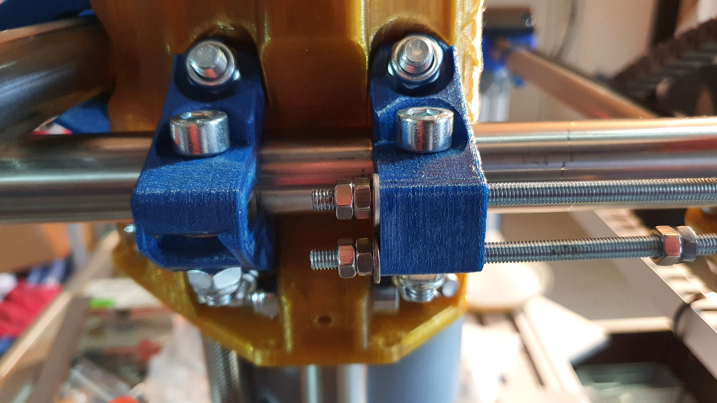

Getting a higher stability in the core clamps I have added/changed some small things .
I have installed some thread rods in the core clamps (5 mm - 90 mm length) to stabalize the position of the clamps.
For the fact that 1 clamp does not have the possibility to install the thread rod I have replaced that clamp.
This increases stability really much!!
1 disadvantage: I have seen, that you can not adjust the angle of the X- and Y-Pipe with it. Therefore I will create a part that will allow that and supports the possibility to adjust the angle. Currently I have an angle between 89° and 90° and this - for me - is not acceptable! :flushed:

  • the core clamp could be a little bit more stable. To get it done I have connected them via threat rod, so that it got much more stability!

@DJPicasso Nice build! I noticed you used Socket Head Cap Screws for most of your build. Did you have any issues with the smaller head sizes providing a reduced clamping area vs hex bolts?
Also was there a reason that you placed the lower z coupler so low? It was my understanding that it should be positioned such that it supports the lead screw coupler.
I look forward to seeing what you can do with it and to see how close you get to your tolerance target.
Wow. Just wow.
Good that some guy helped you with your pulleys. :smiley:
To be honest, I am used to use only socket head cap screws. I do not like other ones :stuck_out_tongue_winking_eye:
The only place where I could not use them was the lower part of the core. But this was based on my Makita holder. You can see it on the fotos that the remaining place was too less.
Yes there is a reason! You can’t see it very well in the fotos, probably only in the intermediate state foto.
But on the foto you used it was still too far. I decrease the distance to ca. 80 mm.
The distance I checked more or less with the deepth of my Makita and to not run - per case/incident - into the bed I have positioned the Z-coupler in a way that it would block the Z-axis to touch the bed. Generally I also use some tools to hold the working piece and so the pieces are minimum 5 - 10 mm over the bed.
From my point of view there is no need to support the lead screw coupler. It is only to strengthen the pipes of the Z-axis and to stabilize the threat rod for the movement (up/down) of the Z-axis.
