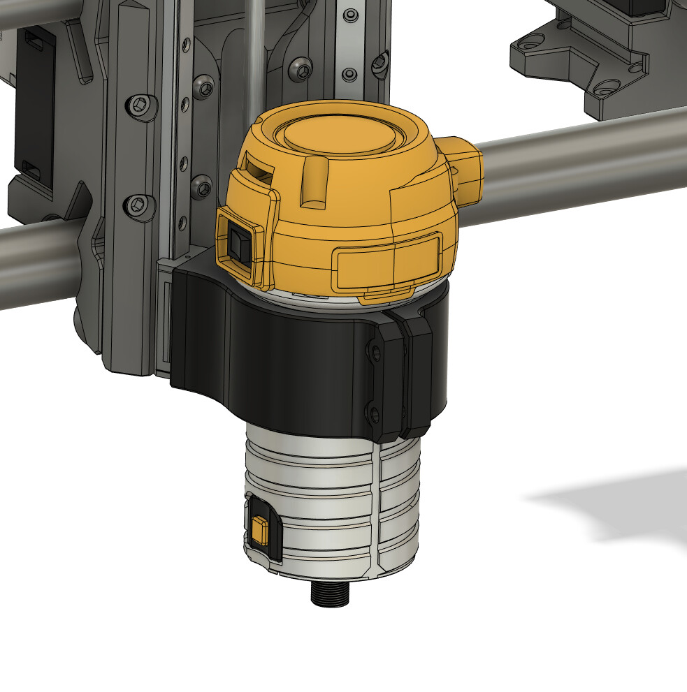

And now a mount for the Dewalt DWP611!

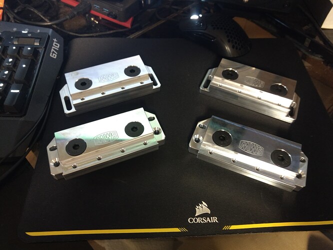

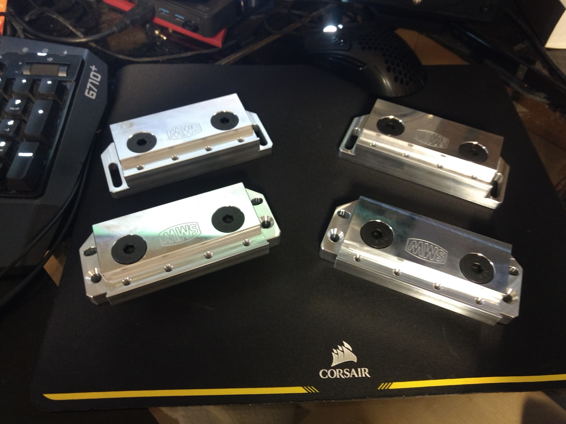

Almost don’t want to use these SMW mod vises with how good they look! Oh well, hopefully will get to sling some aluminum chips this weekend!

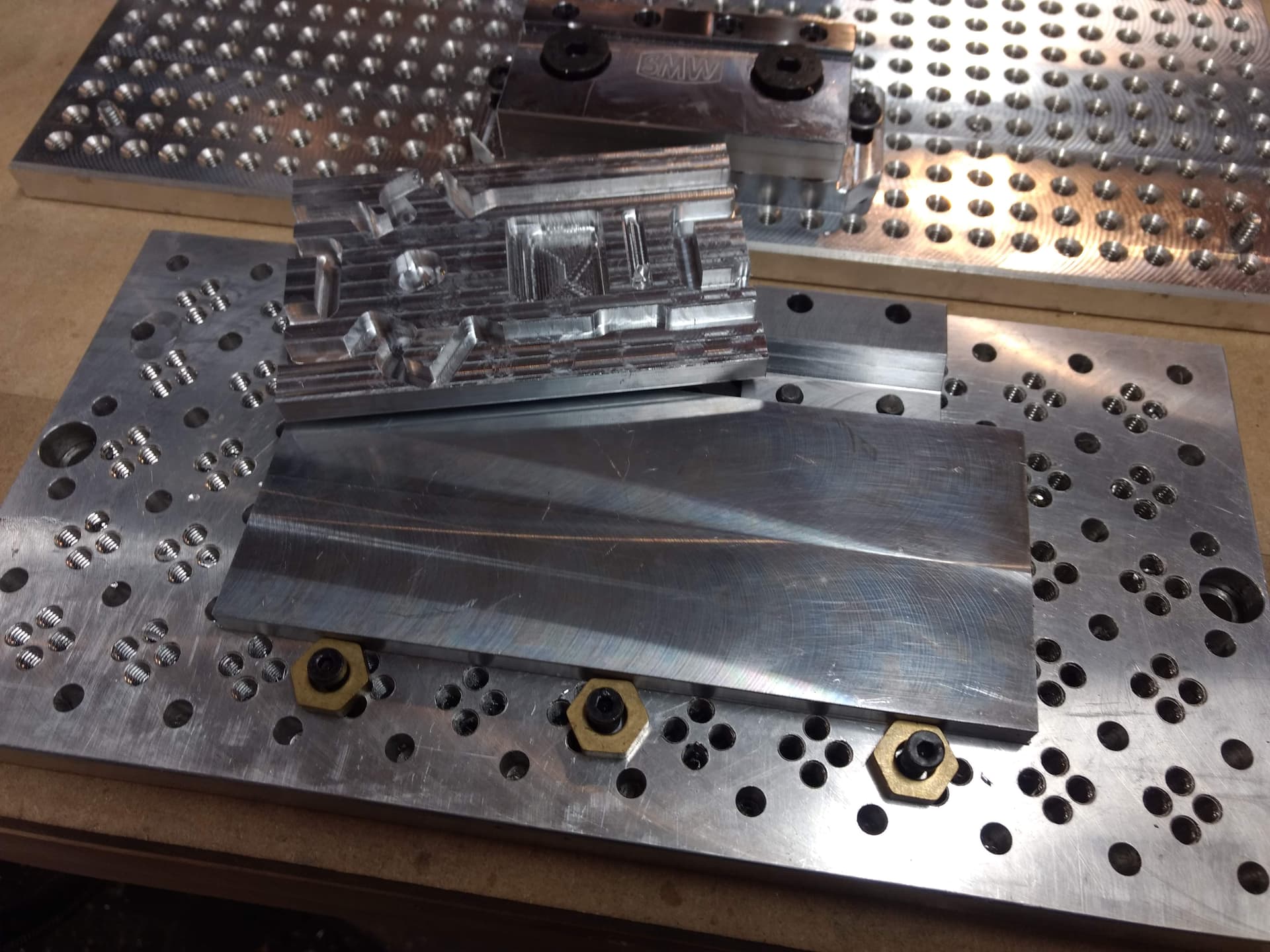

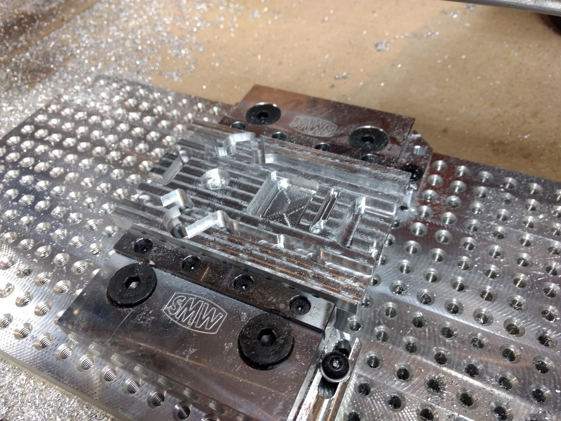

Made some chips and definitely learned some things, the last thing you will run out of is rigidity! Super happy with the 1/4" settings so far after some initial tweaks, 1/8" does need a little more work before I am happy with them. I think I am going to relinquish facing duties to the mill however, hard to beat the finish of a 2" face mill. Sorry, no video this time! Was too concerned with settings and the e-stop to worry about a camera. Starting to get a handle on this CAM thing!
