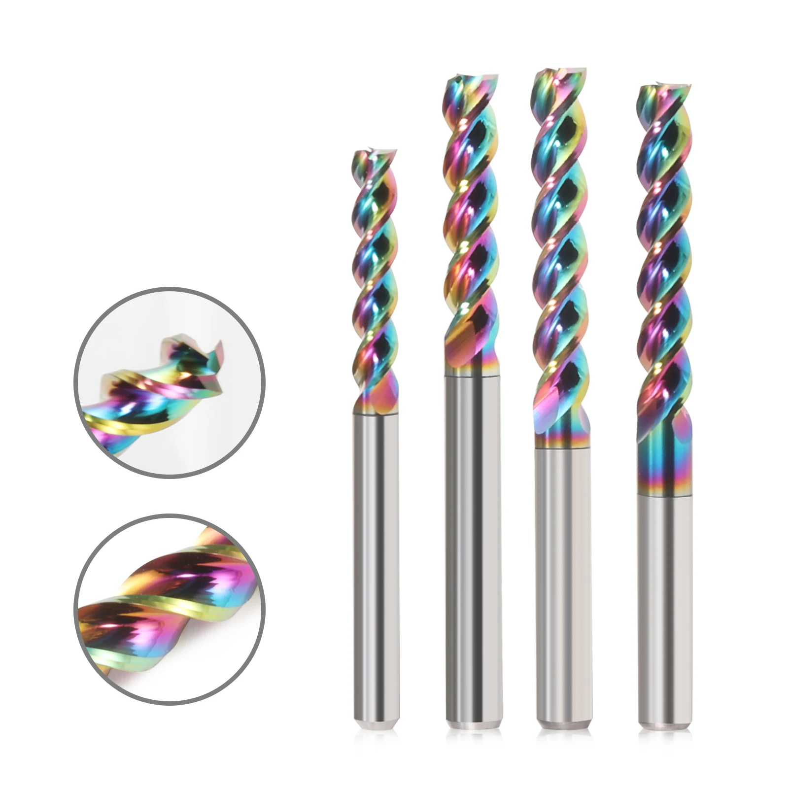

I also came across these bits;
Cheap, but really seem to chew through aluminium - I thought I might be pushing it with 3 flutes, but it seems to work great - 3mmDOC 1000m/m

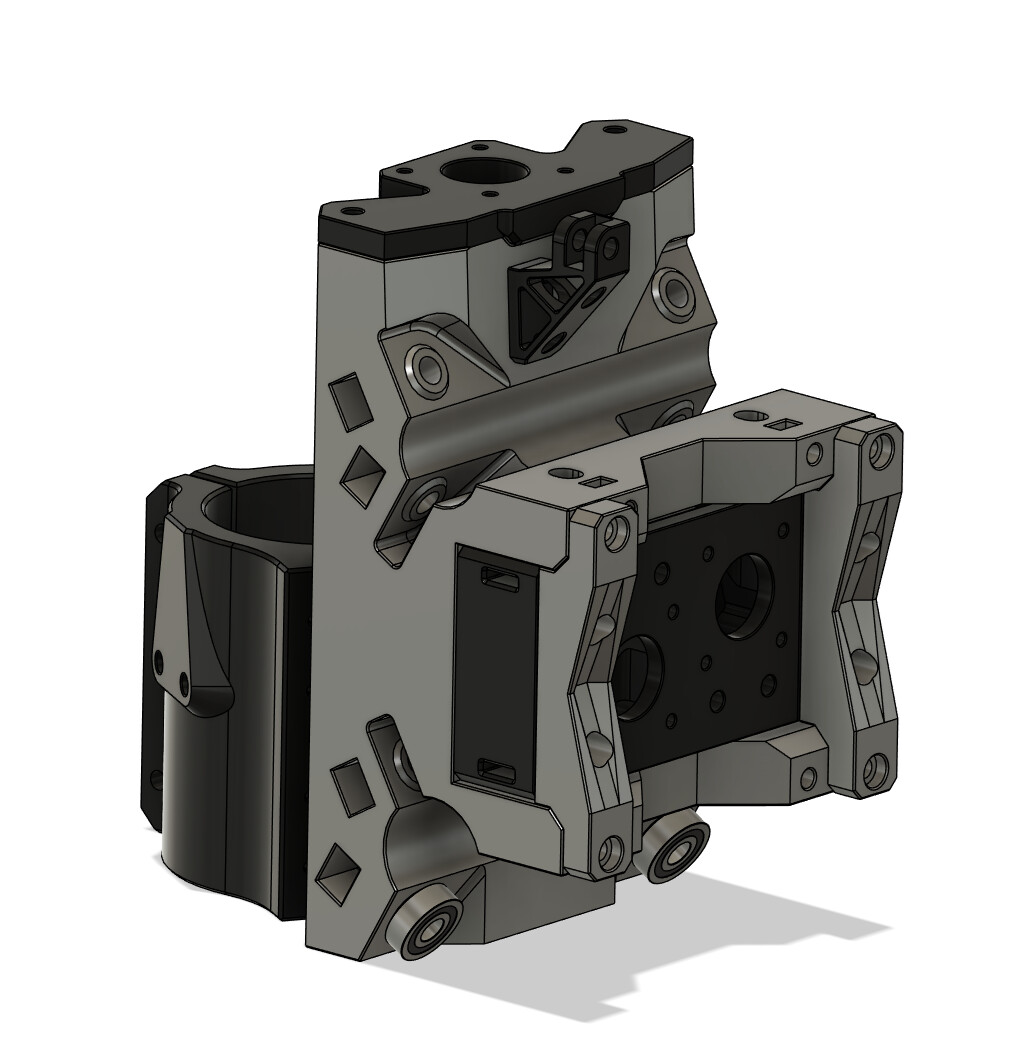

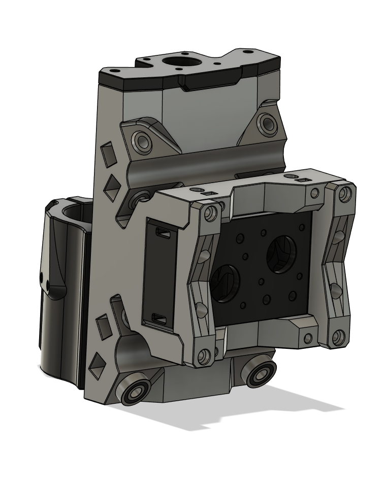

In other news, I have started back in on the carriage revision!
I’ve upped the perimeters this time, hopefully it holds up - when it’s running nicely it’s such a dream to use. This has come at a bad time as I’ve just sorted my tooling
I will say, I am not looking forward to the manual revision :rofl:
It’s happening!
Little by little! I still need to work out a generic mount for dust collection, a mount for the z-end stop that works with the makita/dewalt mounts, and an idea from Keiz to give an option to have the y-end stops on the uprights vs on the “corner tops”.
It’s looking epic. I’d better invest in some filament to reprint this core.

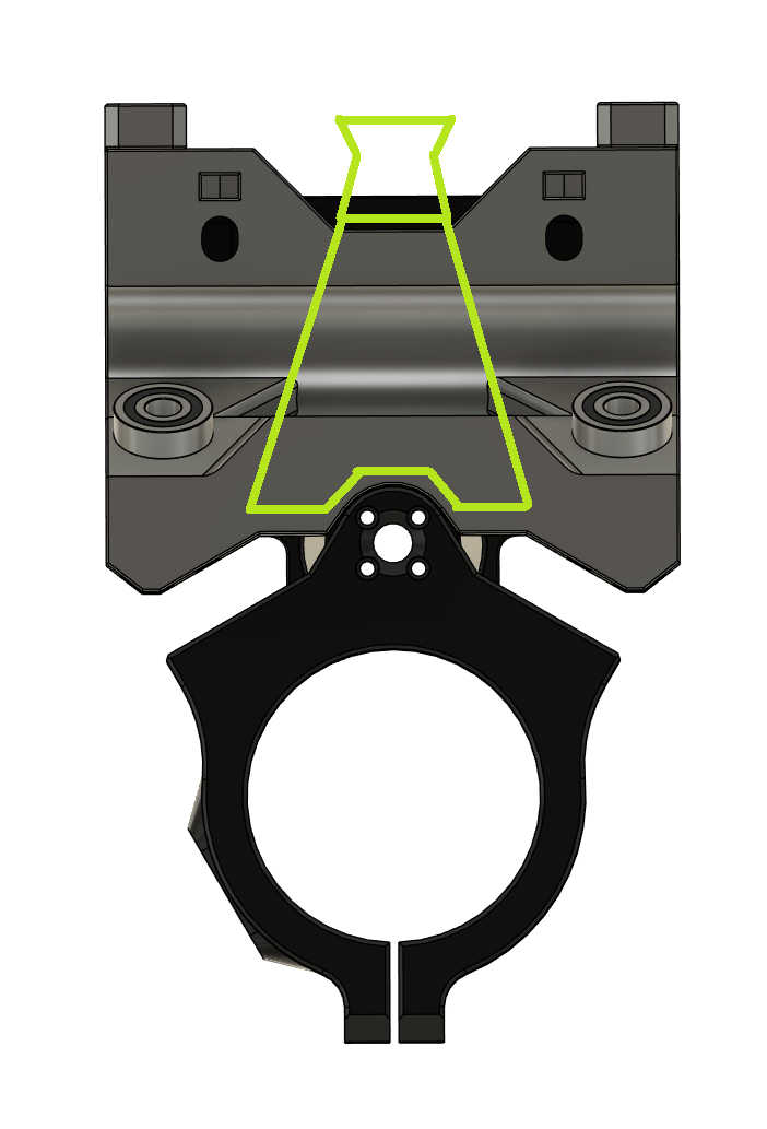

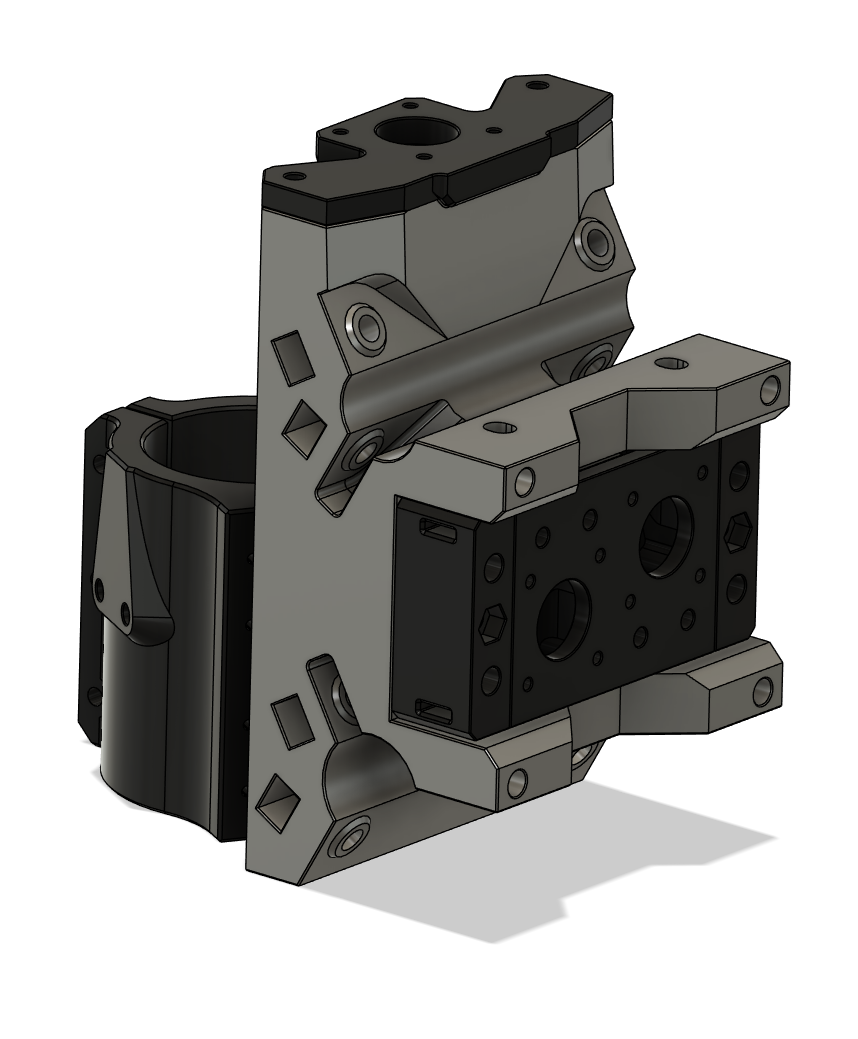

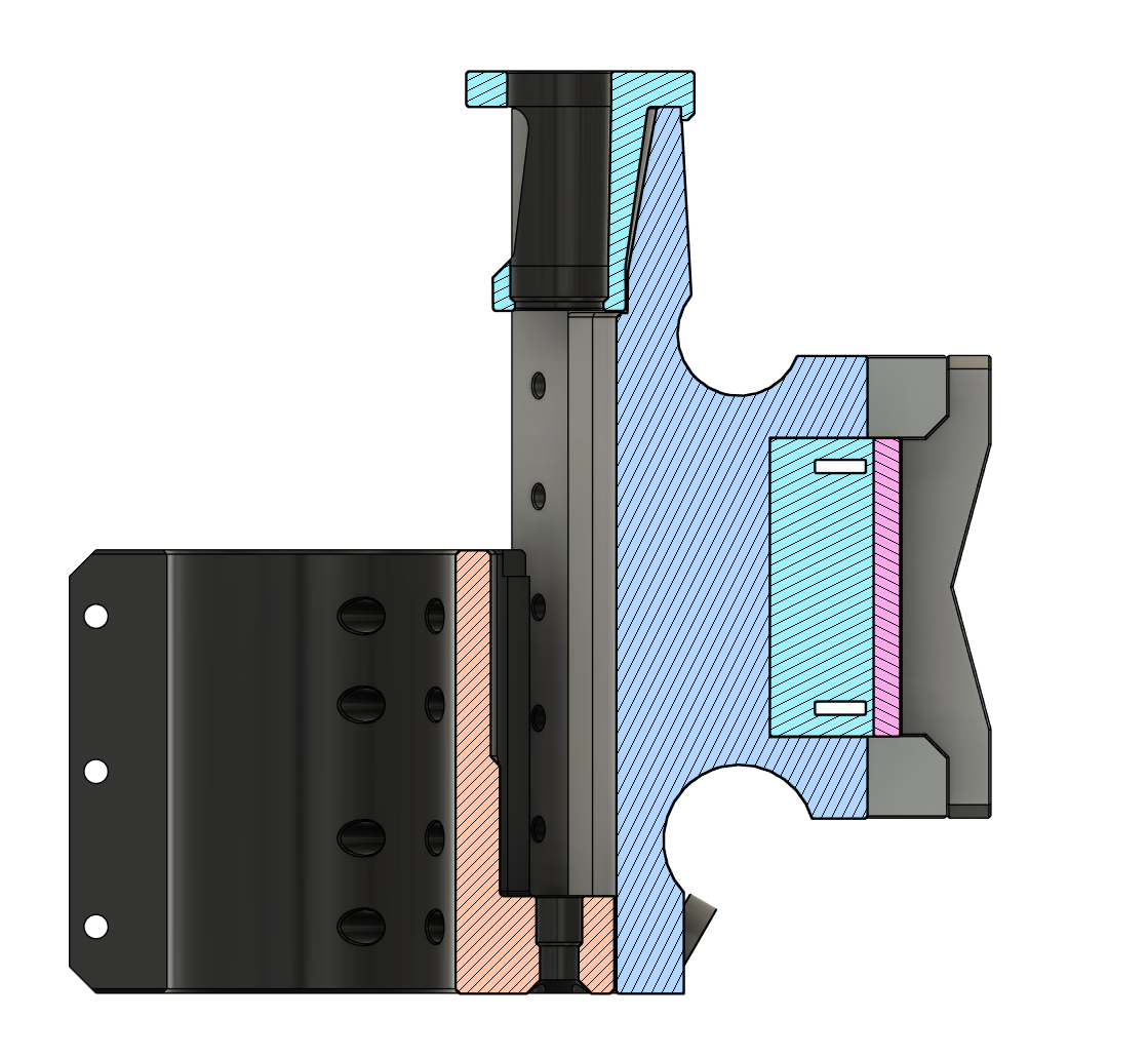

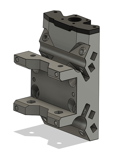

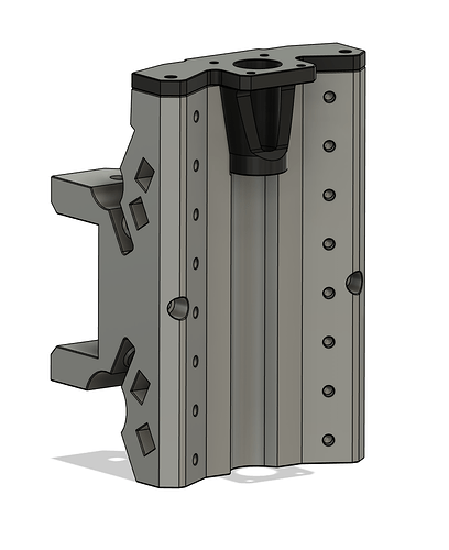

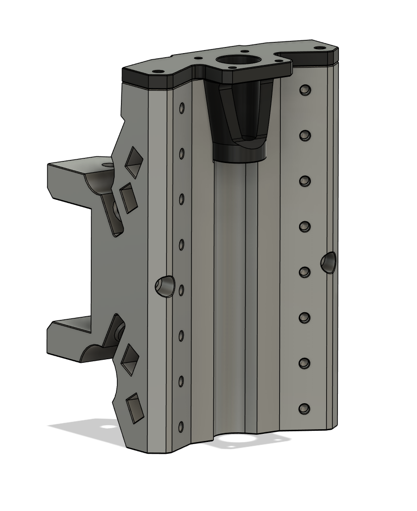

Down to the last thing before I print the parts for my initial testing, the mount for attaching a fixed dust collector. Initial idea is a bracket with a dove tail setup you can attach to but I would love to hear some thoughts on it.
And here are some blank pics if doodles work best for you for explaining:
And lastly, the cable guide mount that took me way too long to figure out one that I liked :rofl:

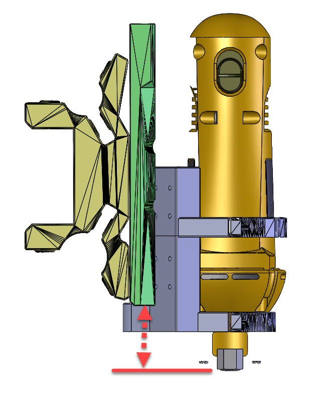

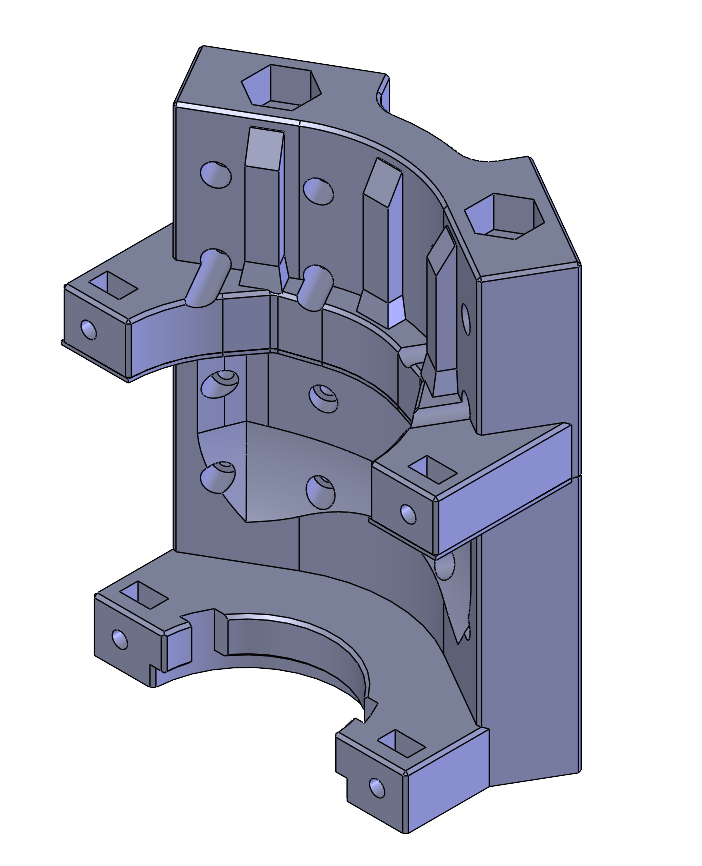

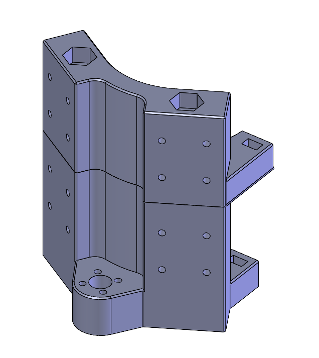

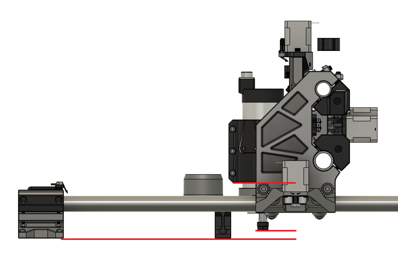

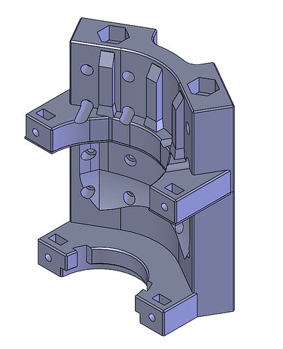

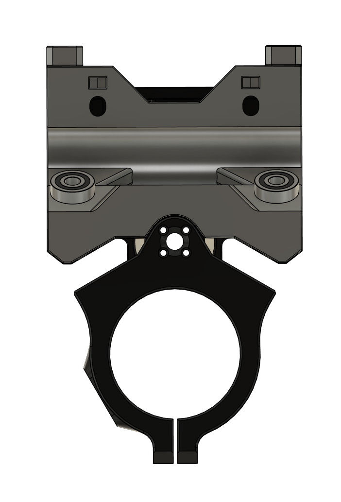

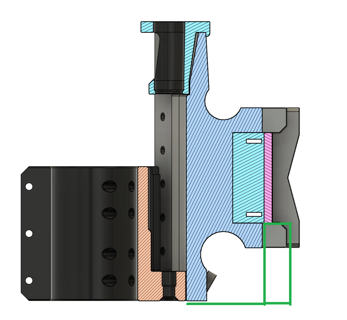

I am working on my build but have not decided to convert to a spindle yet and am trying to use my existing DeWalt DW660. I have started modeling a new mount and am not sure where the chuck should be positioned in the Z. For a spindle it sticks out below the mount clamp. Can’t really do that with this model). Does anyone have a good reference dimension for where the face of the chuck should be relative to say the bottom surface of the left or right rail mount (green)? Below is what I have so far (will print in two pieces and bolt together).
Ideally that spacing should be 2.5~3" if working off the plane the bottom of the feet form, gives 1"~.5" of clearance from the collet to the work surface then when at the bottom of the travel. Can reduce it if you bring your work surface above that plane .
