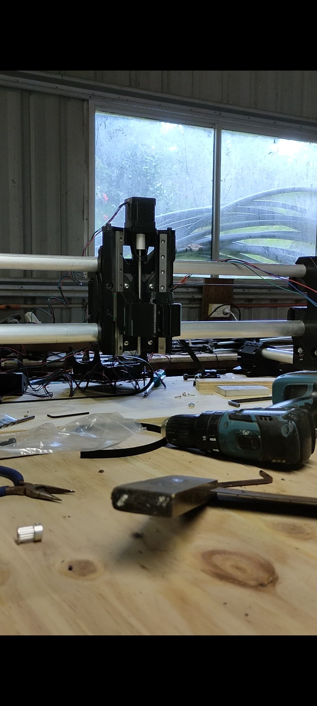

That’s an impressive operation mate - did you find the brace significantly reduced the ‘twisting’ for lack of a better word?
It improved it but didnt out right eliminate it, may poke at it a bit more but the belts are the next limiting factor with steppers directly behind them. The spindle has been the one thing that hasn’t been pushed to its limit.

At the moment the machine is still running, but not cutting as well, holes are generally coming out a little oval, I’ve had to pull down my cutting speeds…
I’ll report back with how it goes with the new parts, I can see the router teetering a little when it cuts on the Y axis.

Printing now… I think it’s just the X carriage and rail mounts that need to be reprinted - the router holder too - but I made a brace up with steel when it cracked, which i think I prefer.
Anyways, printing the X Carriage in PETG with 4 perimeters, 65% infill…
I figured I’d go 4 perimeters to be cautious and try negate any loss in rigidity I’m getting from using PETG - I only just read about Carbon Fibre PETG and kinda wish I went that direction.

New parts are working well, I keep finding more cracked parts which is a little upsetting. The router clamp is currently just some straps of 2mm steel.
Turns out the big issue wasn’t the cracked parts, instead it was that one stepper motor wasn’t holding torque (or working at all? It’s hard to figure out with my rather short X Axis)

It turned out to be the driver - I keep poaching the drivers from this machine for other projects, replaced the TMC2209 and its now happy as Larry.
Well my test didnt pan out as well as I hoped. I shimmed the gap between the x stepper mount and the carriage, it made a small difference but not to the amount I would be happy with. I have another idea on deck, just gonna take a bit if time to draw up and print/assemble.

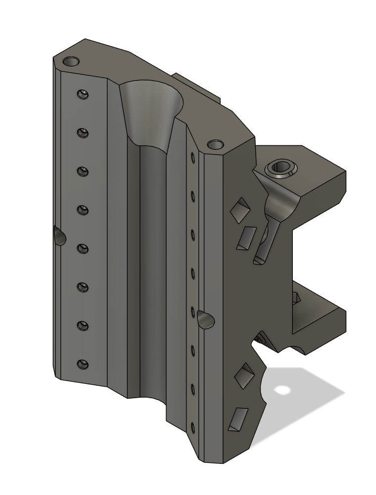

So I have started with the new x carriage design and figured now would be a good time to get some ideas for how you guys would like to mount dust shoes to it. Current idea is some heatset inserts on a flat portion on the bottom of it to bolt to, I would provide either a drawing or step file to work off of so you guys can design your own dust shoes.

Chipping away at it between other projects, carriage is mostly done, just need to redo a couple bits that attach to it.

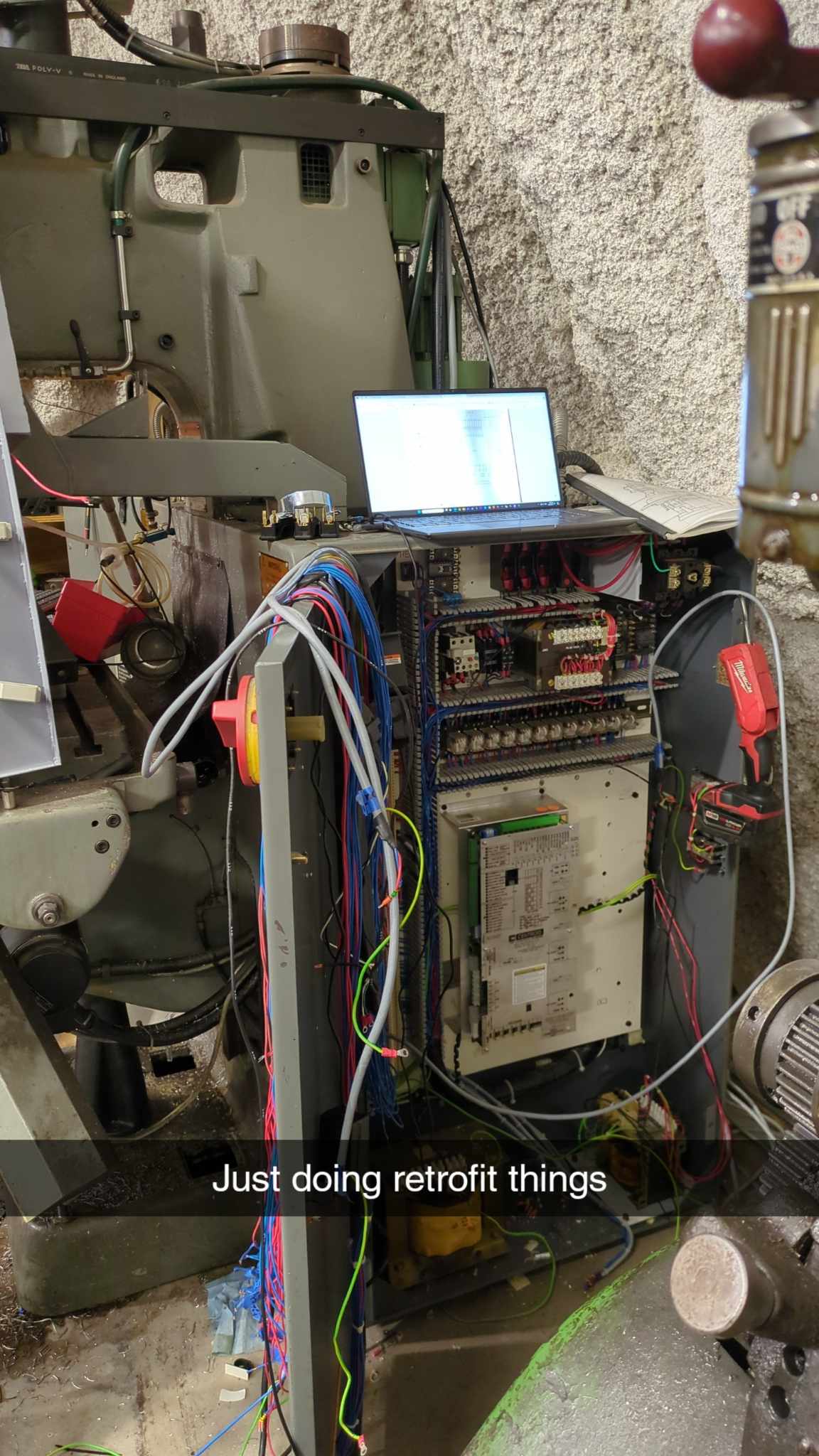

One of said projects is doing a controller retrofit on an older bridgeport cnc for a friend.
Epic mate, this was as far as I got with the build before other projects overtook it. I’m sorry to say this was nearly 12 months ago.
