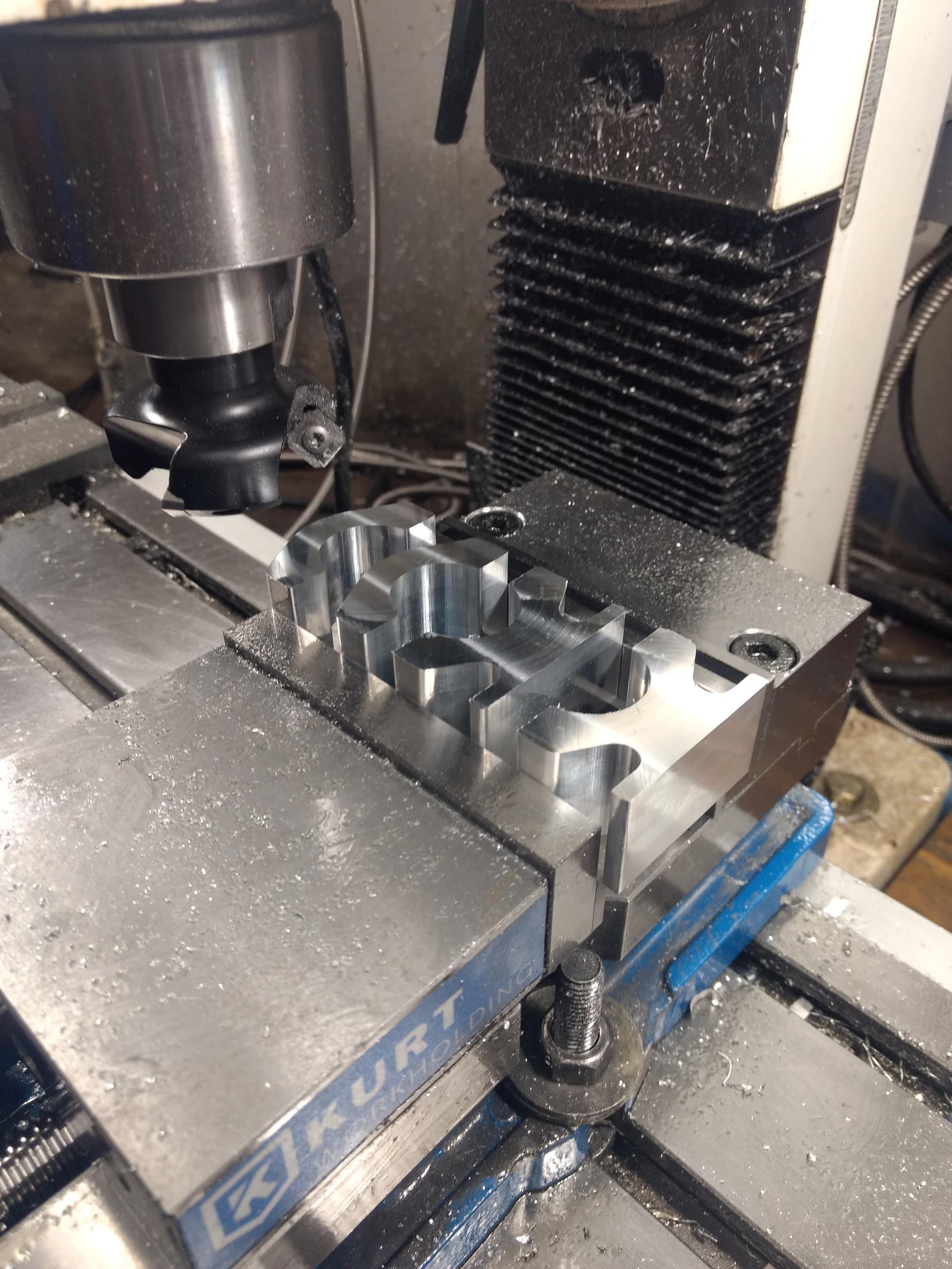

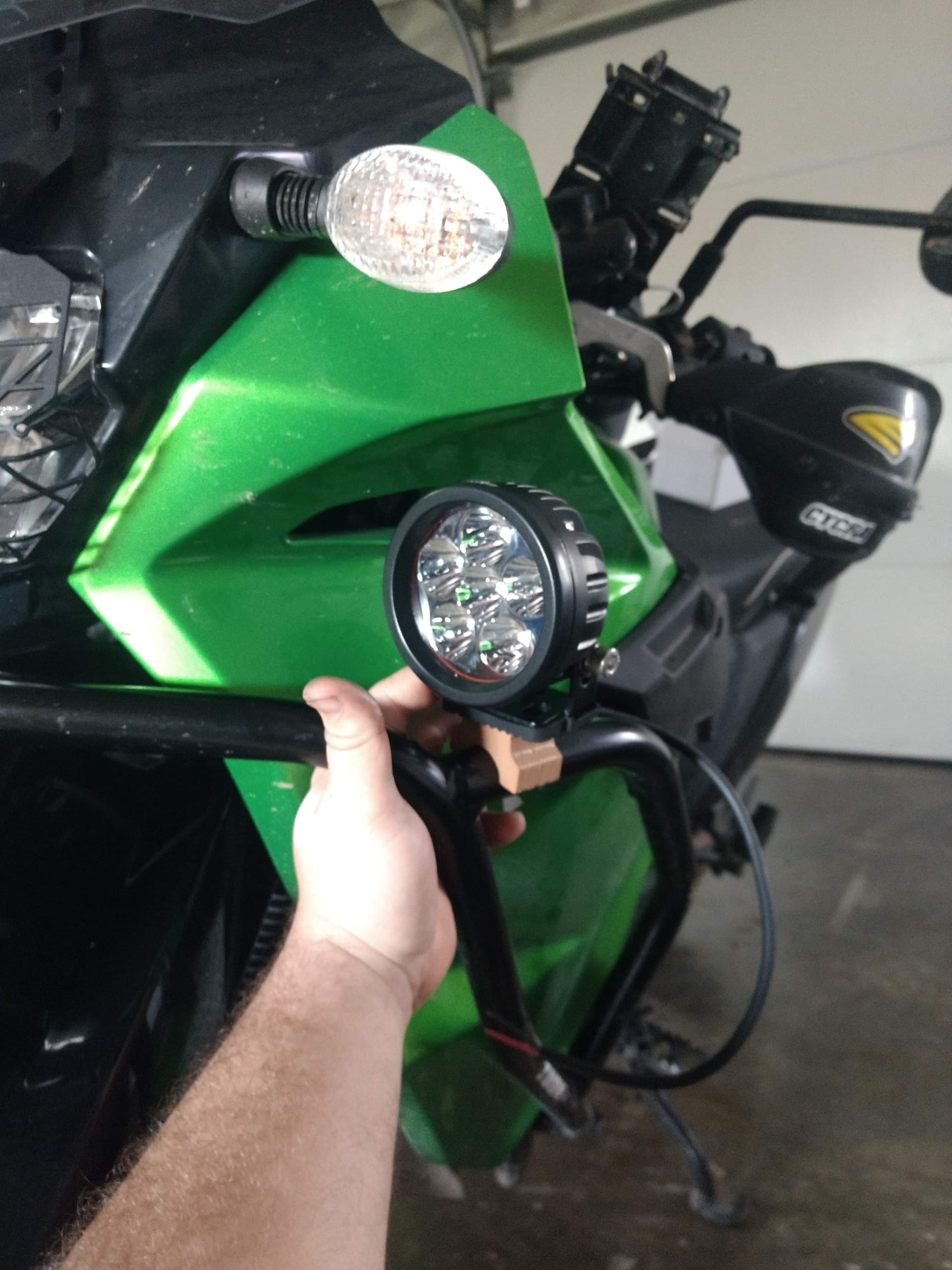

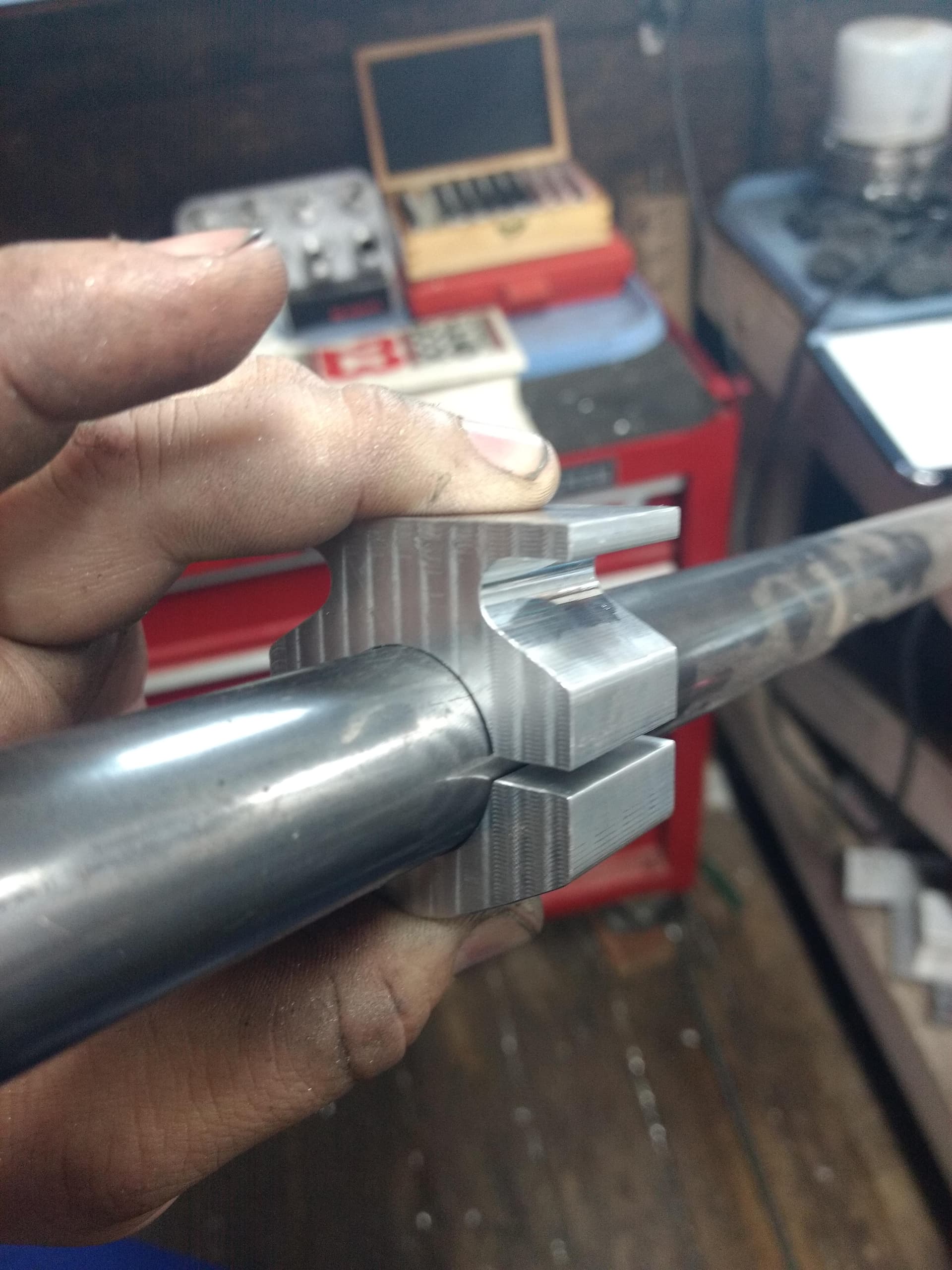

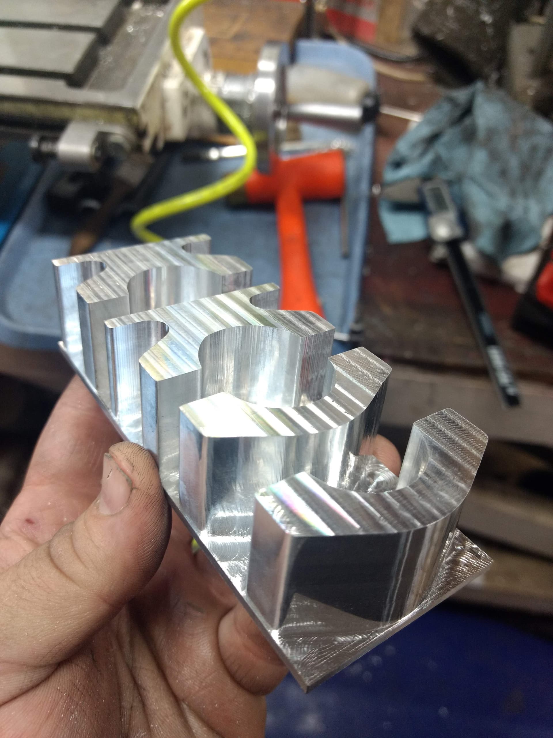

Ran the Brutus through its longest op yet with the longest end mill I have used in it with a sprinkle of full flute engagement for the finish passes. Took a little under 90 min to turn a lump of aluminum in to the 4 parts to mount some new lights to my KLR. Used a YG1 1/4" end mill with 1 1/4" loc, used 25mm of that loc on the finish passes. YG1 may have just taken my top spot for favorite aluminum end mills.
This fall/winter I will work out some kind of mount you guys can work with for dust shoes and actually finish the instructions for the brace install. From there I will be focusing on a bench top cnc for my smaller part needs.
