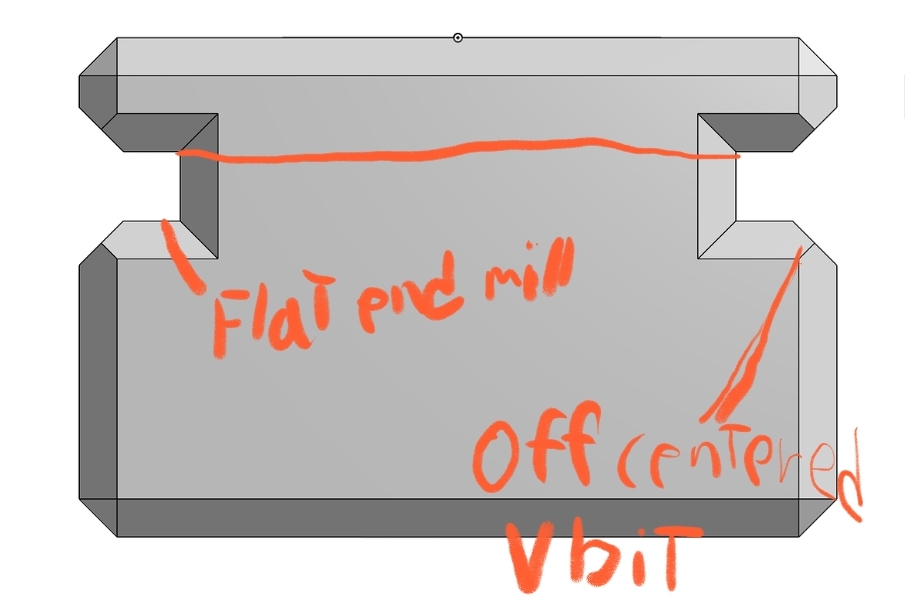

Again new at milling so please explain why this wouldn’t work; What if we did like @turbomacncheese said where we used 2 pieces bolted together and milled like shown below?
That might work… the only problem I see (I have done a ton of 3D printing but i’m a noob at milling) is that the top piece would be. Difficult to bolt down. Not impossible but difficult. We would need low profile blots.
We could split it at the bottom of the groove rather than the top, not sure if that gives us enough clearance for bolts or not though.

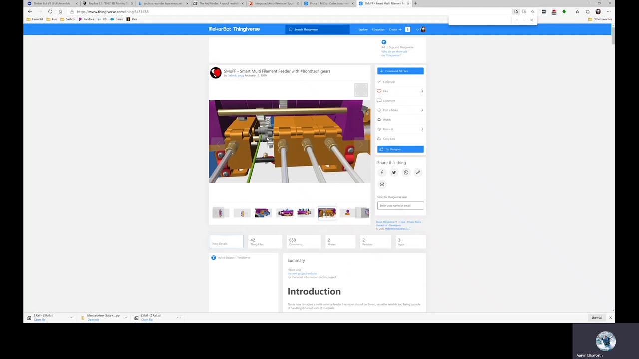

Onto the next topic. I mentioned that when I rebuild my TAZ 5 (300x300 print bed) as a Timber Bot that I might try to build a tool changer. Well here are my current thoughts on the subject. Too many words to type so I explained it in a video.
Here is the link to the SMuFF I showed. he has video demos. SMuFF - Smart Multi Filament Feeder with #Bondtech gears by technik_gegg - Thingiverse
I think the issue with converting that to purely bowden would come down to the amount of slack you have in that assembly. If you have another motor on the hot end with the same gear ratio, you could run them from the same driver.

That is a clever idea. But my experience with the Prusa MK3s with the MMU2s has taught me that there is a LOT that can go wrong with a filament feeder and a direct drive extruder. I won’t list all the issues I have run into. I have tested about seven different configurations of a direct drive extruder. I finally settled on one that eliminated most of the problems. But I still get filament load failures about 1 out of 20 attempts. With softer filaments like TPU the failure rate is closer to 19 out of 20.
That is why I am willing to remove the direct drive variable all together. I have already exhausted most of my ideas for making that more reliable.
Now with that said. I have done some more research on the SMuFF over my lunch break. In the FAQ they claim that is does seem to work best when used in a bowden configuration. So that’s promising.
When you say slack are you referring to the length of the bowden tube? That is a concern for me. Bowden tubes work better the shorter they are. I don’t have any great ideas. I just know that I plan to keep the tube as short as I reasonably can.
