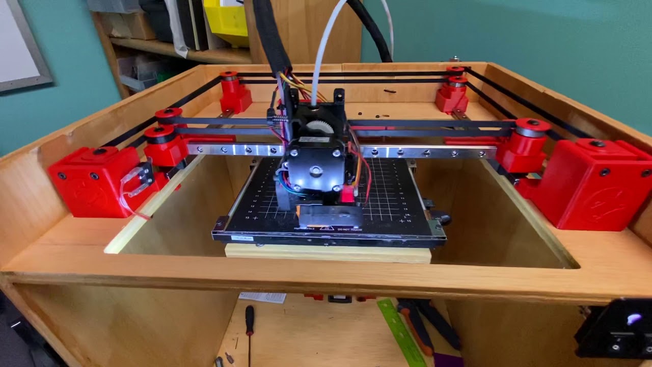

Today I was testing the sock that goes over the 608 bearings. First version works but I want to tweak it a bit. Good news is this one is compatible with the rest of the CoreXY parts.
In the video I can see the belts might be a little tight.
Perfect is the enemy of good. There are a lot of people who could use stls, dxfs and a bom without instructions. Just my $0.02. instructions are tough.
What gcode are you running there? Is it just movements to test out the xy?
Yeah it just moves one motor the the other then both. Then repeats faster and faster. Good test for this.
I am notorious for chasing that last 5% of the project. I’ll try to avoid that trap and just get something out.

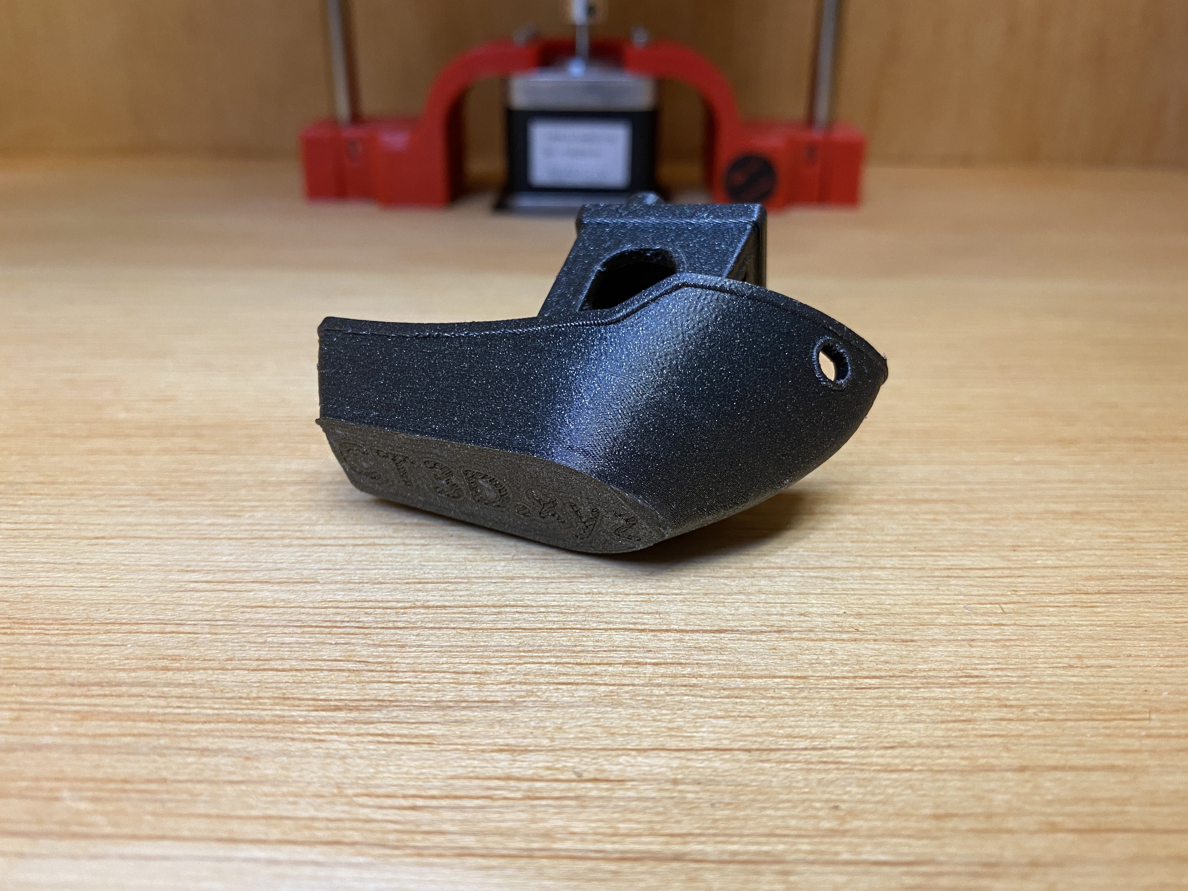

I am VERY happy with how this Benchy turned out. PLA 0.1 mm layer height. Prusa Slicer.

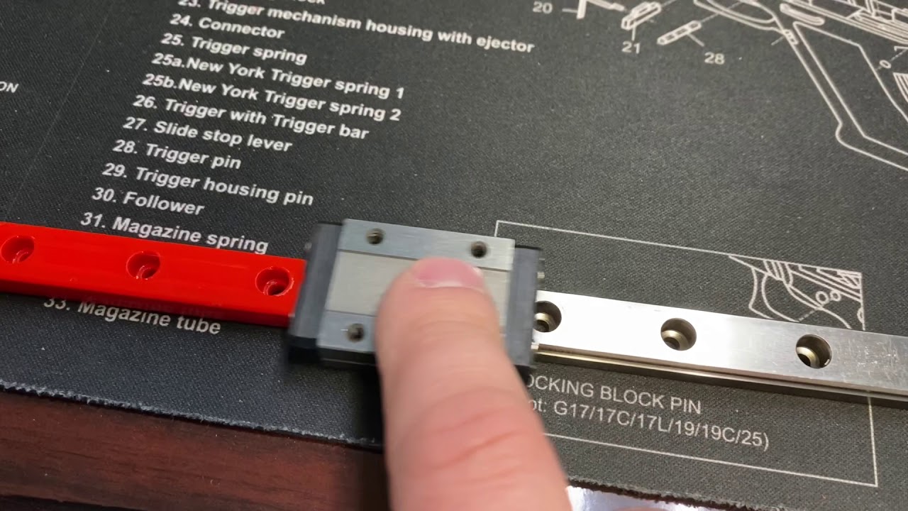

When I take apart my TAZ 5 and rebuild it as a Timber Bot I want to see if I can make it use two print heads. Dual print heads are bulky, heavy and prone to oozing. I thought about building it like an IDEX where the two print heads have their own X belt and stepper but that wouldn’t work with the CoreXY setup I just spent so long building. So my brain moved to a tool changer. That sounds like fun so I want to give it a shot. I remember the one I saw for the MPCNC and thought that was super cool. Anyway… my problem is the rails I already bought are too short. The ones I bought for my TAZ are 350 mm long. The tool carriage uses up about 45 mm of that and the bed is 300x300. So I don’t have any extra room for a tool changer. Or do I?
Well I was thinking about the BB bearing rails @dkj4linux made for his laser engraver linked earlier in this thread. I was wondering if I could use that concept to “Extend” the steel rails. Build it to use the steel rails for the printable area but then make a plastic 3D printable rail that could extend the movement into another area that is only used when the machine is changing tools.
So here is the first proof of concept. It works pretty well. I’ll bet If I post process the print a little with some sanding of the flat top surface and clean up the end It will move even better. I should probably use a PLA + rather than the PETG I tested with.

As for the profile. The MGN12 rails have a profile that might be difficult to mill. Here is a picture of the profile.
The angled grooves are where the ball bearings make contact. The deeper channel is for the thin metal wire that helps to hold the ball bearings in place. Both of these are slightly exaggerated in this picture because of 3D printed plastic tolerances.
So while I like the MGN 12 rails because they are easy to find and relatively cheap. It may be difficult to mill a matching rail. It would be cool if we could though.
