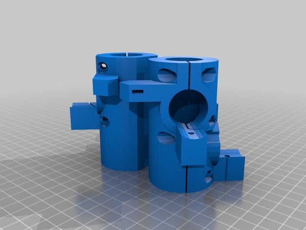

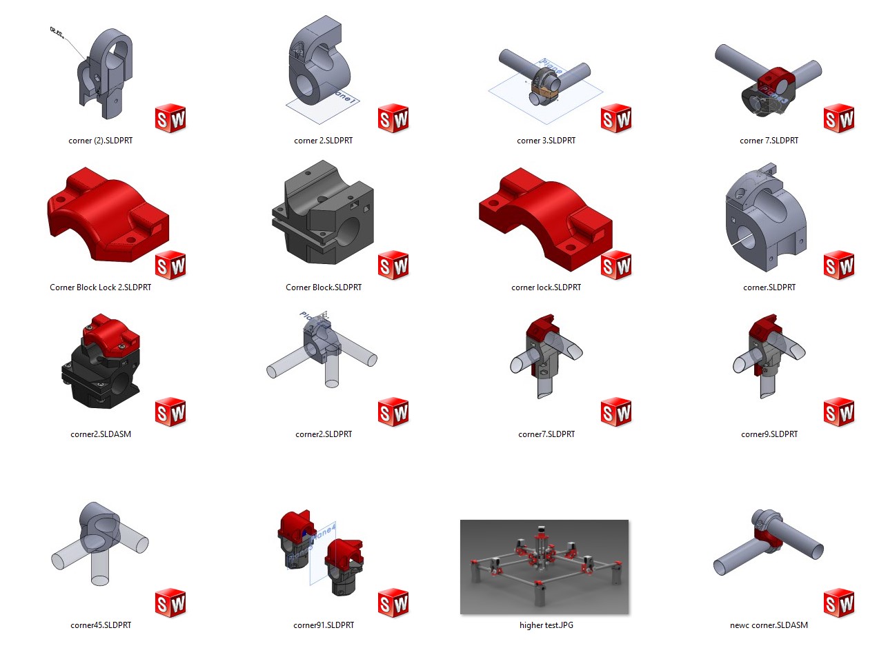

The biggest hurdle that seems to be left is the corner. So a quick look at the past…
And now revisit the sketchbook…and jump in to CAD and try to make a new one. (heard somewhere there was only one way to make a corner and my current idea was not unique…)
I printed yet another revision of the center and I see it needs a tiny bit of work even without testing it, but I have yet to see if I solved the one major issue I was having. (in my attempt to solve one I created a tiny new issue easily fix-able)
One little idea for the corners, maybe allow the leg to pass through and up out the top vertically. This makes it possible to easily change height. An alternative to a drop table or propping up the workpiece, so it is that much easier to build small (short) and increase height if necessary.
This was mandatory for my double-decker, you are free to copy or derive from that
I like that, it is stronger, but it increases the foot print. The new belt path makes that a little difficult. Sketching furiously to come up with something.
I have something super basic, moving to CAD to see if it actually works.
Well…we have a big maybe. It looks promising, like really promising. Just a rough guess is it would add 4" to the footprint, and each outer rail. Doesn’t seem like much but…that is not something I prefer to do, but it might be worth it for a few reasons yet to be revealed…(whispers)“magic”
