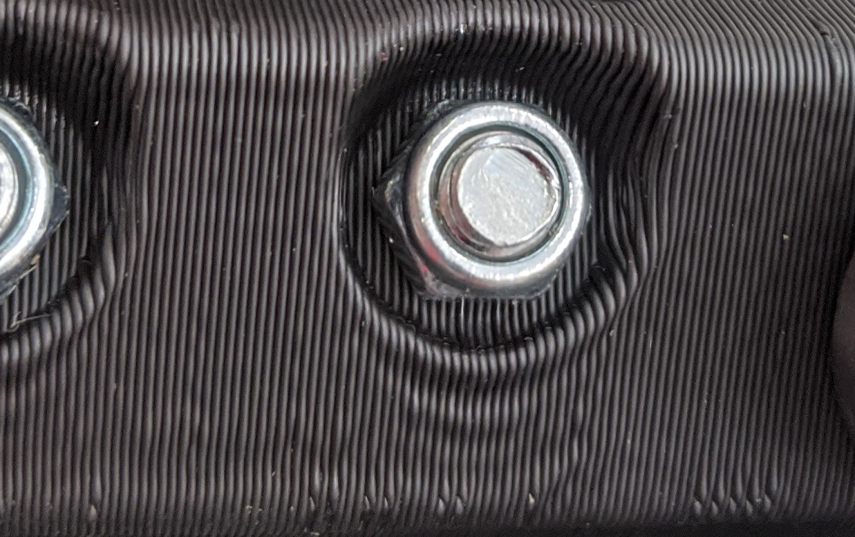

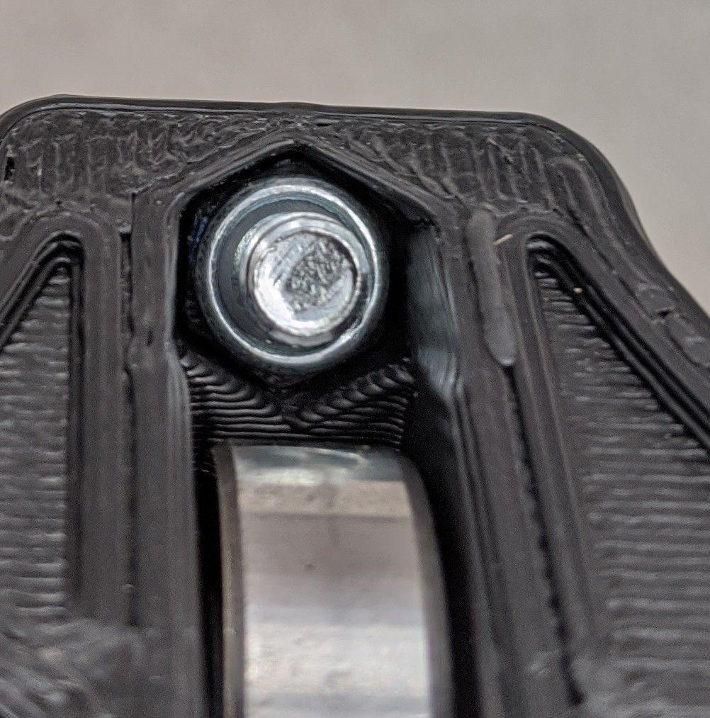

If all the parts use the same sized, M5 locknuts (and they standard seems to be valid 8mm across the flats) are well all on board for captured nuts for these or do I make room for people to use a small socket?
My perspective, captured is simple to assemble, and less obtrusive to the overall look, slightly stronger parts as I do not have to keep such a large area open to fit a tool. These should in no way require a flat head screwdriver to hold them since I can capture more sides, they are also slightly larger than an #6 (7.8mm flat to flat)…but who knows… I do not trust people using a socket, but unfortunately all the larger bolts will require it this time.
Examples
This is actually not large enough, it needs a bit more room.
This one is well fitting.

Okay so maybe I stick to what I am doing, open where it is easy and tight spot gets captured. We’ll see how many others have an opinion on this.

I like captured nuts - with one caveat - ALL (6) sides must be captured… I have had issues with partially captured nuts, basically being not-captured and do not trust them anymore…
From the pic it looks like you were only planning to capture 4 sides, if that’s the case - I would prefer not trying to capture them at all. And instead allowing them to sit flush on the surface so they can captured with an open ended wrench.
Just another perspective/opinion…
That is all 6 at least 3mm past the top of the nut at the least. 1.5 degree draft so bad prints should still be able to get them started and crank 'em in.
