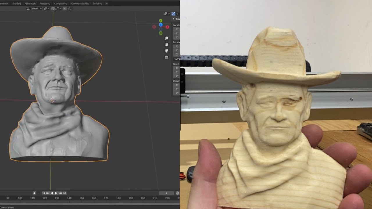

I’ll be creating several sections of this discussion to avoid excessive length, but, as a bit of a “teaser”, here’s an original creation that was carved on the LR4 of a cabin in the mountains.

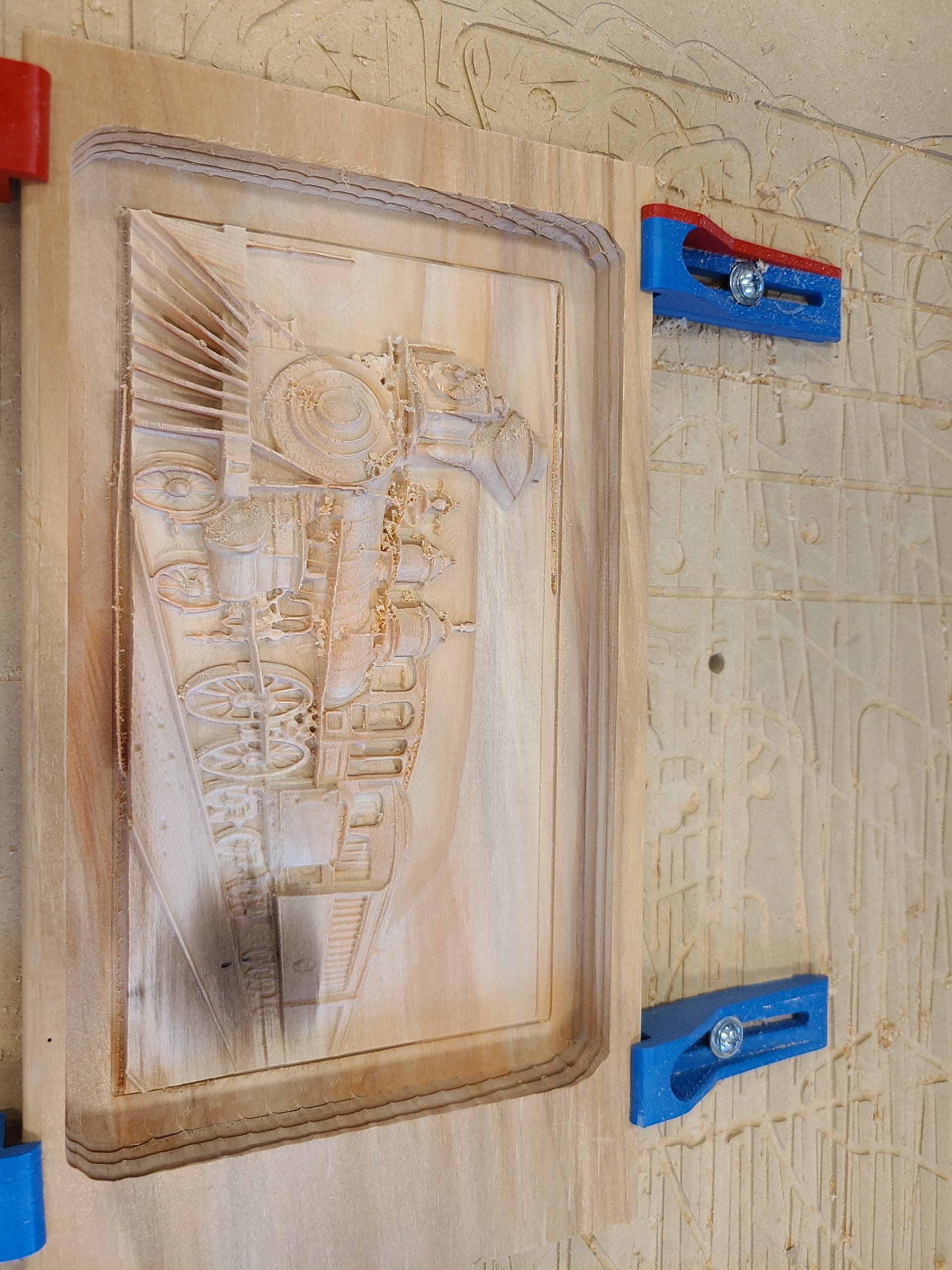

In the meantime, here’s an image in the midst of being carved on the LR4. This is the finish pass, and the top half of the roughing pass is visible.
And, finally the completed carving. Note that there are some AI artifacts which I plan to discuss. The dark spot is in the wood. This is a piece of redwoo scrap.

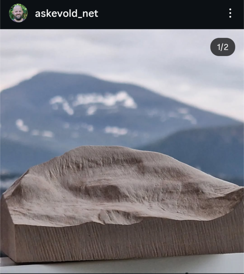

10*10cm. Carve took 4 hours…

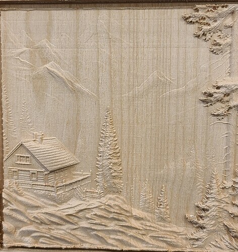

Considering Depth-R first, here is the results of processing our mountain cabin photo:
Now, the darkest regions are those that are further away from the viewer, while the cabin and other foreground components are lighter, which is consistent with the actual depth information. (I am not skilled enough to adjust the greyscale within Depth R). An STL file can also be directly downloaded from Depth-R, which can then be fed into EstlCam or other CAM tool.

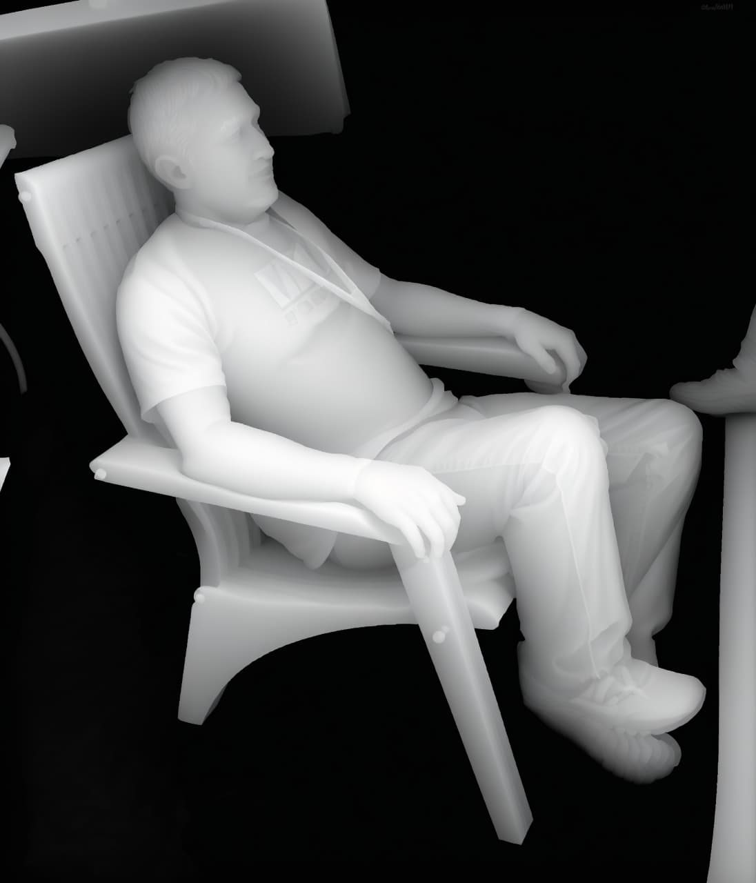

The second software tool, also using AI, is Sculptok. With this software, the image is just directly uploaded and can then be process using an AI engine to determine the depth information. Although this software must be rented, one can obtain “tokens” to run this analysis in various ways at little or no cost. The first step of the process is to “Draw” the image, which costs 2 tokens and generates three greyscale depth maps with varying degrees of detail and include watermarks which can be eliminated with tokens:
Again, the depth information now accurately reflects the original photo.

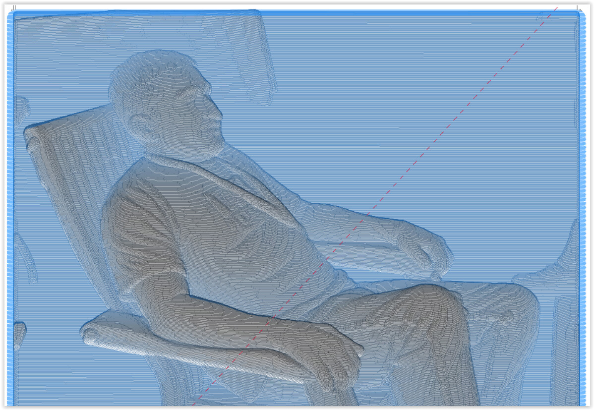

An STL file can then be exported which can be used for the CAM. Here is a tool path for the finishing cut generated by Estlcam:
The result is similar to the one that was posted in the first message of this discussion. However, in that case, I didn’t use as much detail as in this version, but, they are both produced from the same image.

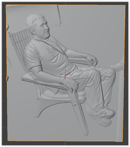

Ryan at the RMRRF sitting in the Simba chair.

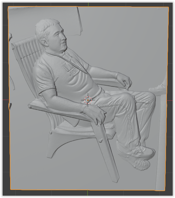

Sculptok image in Blender. Note that this is NOT the grey scale depth map. Rather, it is the actual 3D image that Blender has generated using the GSDM that was imported from SculptOK. The actual GSDM looks much different. Here is one of the three that was generated:
Partial finishing toolpath for the fearless leader at RMRRF

Oh my, Jeff! No need to apologize at all! I started this discussion because over the last couple of years I’ve come to realize this is a REALLY HARD problem to automate. While the tools are getting better and better, there are still artifacts or down right errors that creep in.
In addition, I find it difficult to mentally anticipate exactly what the greyscale will result in when machined. The tablecloth is an interesting case, of course. Ideally, I would have just removed the background but didn’t take the time for this image.
There are also some AI artifacts on the locomotive in the other post if you look close. I think that part of the problem occurs when the depth of field is large. The AI seems to have problems with this, but I don’t yet know the limits.

Jeff, Your comments got me to thinking about this some more, and, I realized that my quick “Ryan” example was misleading at best. In fact, the grey scale image is NOT the Grey scale depth map, but rather the 3D rendering that Blender generated from the input from SculptOK. I have edited the previous posting and brought in the greyscale depth map. There you can see the lanyard nearly blending into Ryan’s shirt.
