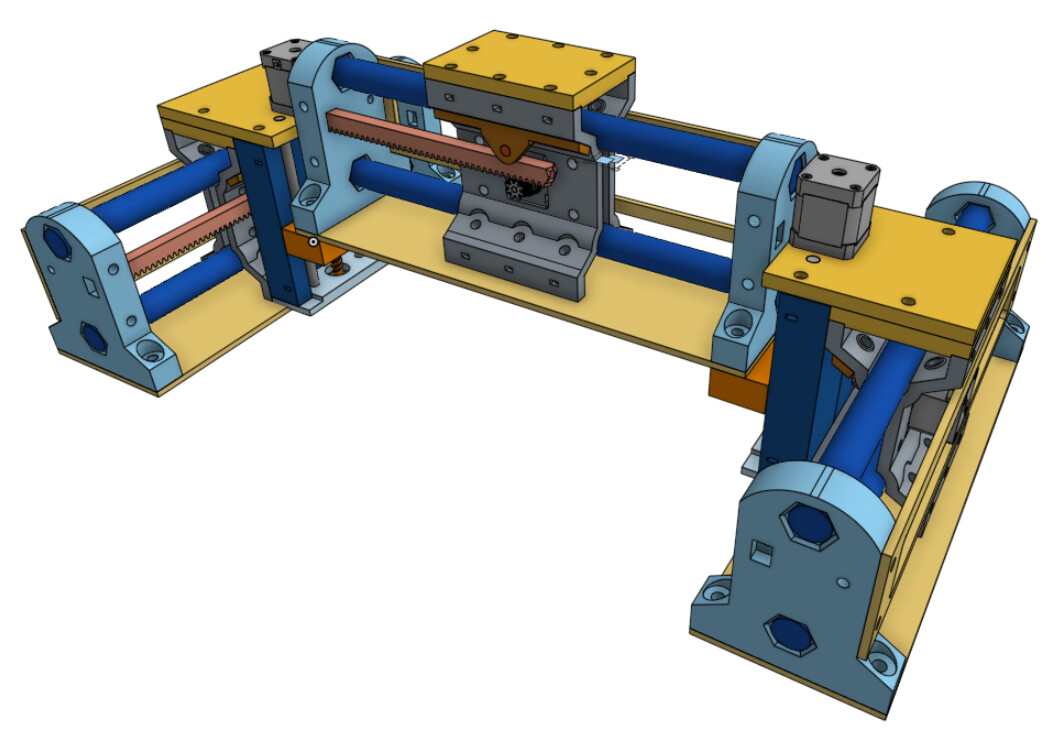

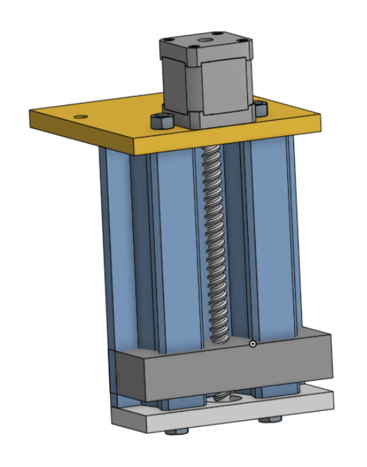

I must admit, it was the Z-axis on the original MPR&P that I was never really happy with. And seeing how the LR4 has such a great reputation for rigidity and power and a low COG with the Z-lift function split out to the ends of the gantry⦠thatās what set the direction for this project. IIRC it was something @MakerJim and I mused about during the first build⦠what if we stacked a LR4 beam on a couple of MPR&P linear stages?

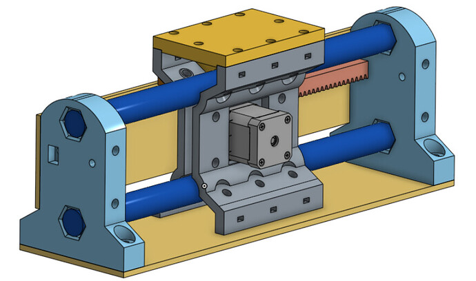

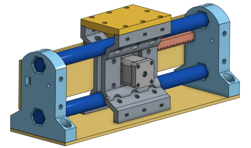

So, take 3 of theseā¦
and add 2 of theseā¦
and stack it up to look something like thisā¦
Iām having fun with itā¦

I canāt keep my mouth shut. If that printed leadscrew and nut is working that smooth, think you can make the rails and rack one modular printed part? ?Take out the bearings and bolts and just have some sliding surfaces?

Maybe, that leadscrew seems smoother than I thought. Just wondering if a slide of some sort is feasible or best to just stick with the cheap emt and bearings

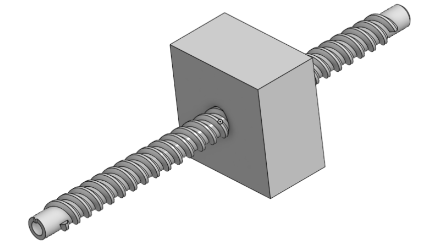

The leadscrew is easily made in Onshape⦠and the one for MPR&P is a 2-start, 10mm per revolution, trapezoidal thread. Itās easy to change starts and pitch with helix and sweep ops⦠with any thread profile.

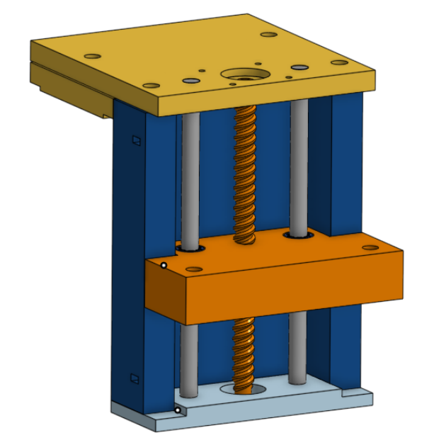

Iām not sure if you guys are just looking at the Z-lift assembly or, somehow, the whole machine. I been going on the assumption that the MPR&P linear stages are in pretty good shape, needing only minor tweaks⦠and that the Z-lift setup is what Iām focusing on now. Where are all the ābearings and boltsā that could potentially be sliding surfaces⦠other than in the Z-lift; i.e. like a scaled-up version of the little laser engraver Z-axis design from a few posts back?

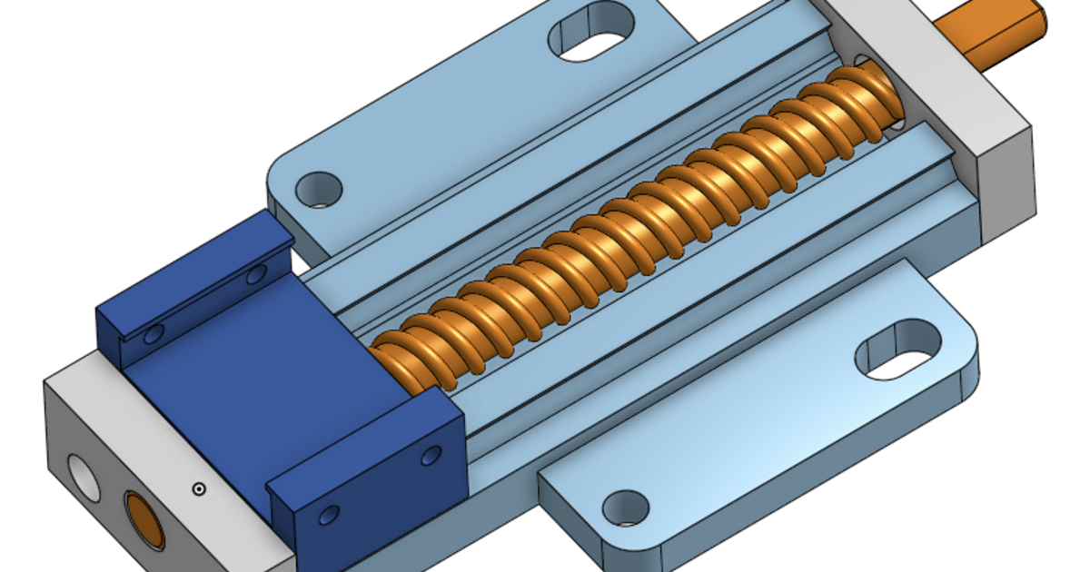

Pretty sure this would be easily printable and last for at least a whileā¦
The previous guide rods now become simple fasteners to strengthen and hold the whole assembly together. The sliding carriage and leadscrew can be printed in place as before. The slider rails easily printed with no supports.
Still no idea of lube requirements. I really donāt think in this application they should be running dry. Iāve thought of petroleum jelly and white lithium grease⦠others?

I had good luck with PLA-on-metal bearings, but never PLA-on-PLA.
Stiction or something.

Iāve done a number of plastic-on-plastic slides but always for slow and/or intermittent movement and light loads⦠as with laser engravers, where you most often set focus and then leave it there. Here is a note I wrote from one of those engraver Z-axis modelsā¦
An observation about printed sliding surfaces⦠it helps if the mating surfaces are NOT printed at the same resolution and with layer lines running in the same direction.
To test I printed two sliding mechanismsā¦printed vertically-oriented, the set hardly slides at all without considerable force applied, printed horizontally-oriented, that set slides better but feels a bit āstickyā⦠but mismatch either set and it is ājust rightā.
For the āthreadedā parts ā the leadscrew and carriage ā I felt both needed to be printed oriented vertically to insure their cross-section is as round as possible. In this case, I found that if I printed one at 0.3mm layer height and the other at 0.2mm to āmismatchā the layers⦠I got smoother operating threads than if both were printed at the same resolution.
Iāll go ahead an build a all-plastic lift unit just to see what I can get away with. I still think a light layer of petroleum jelly or lithium grease might be is order as well. I always try to put that off until Iām done assembling/disassembling during testingā¦
