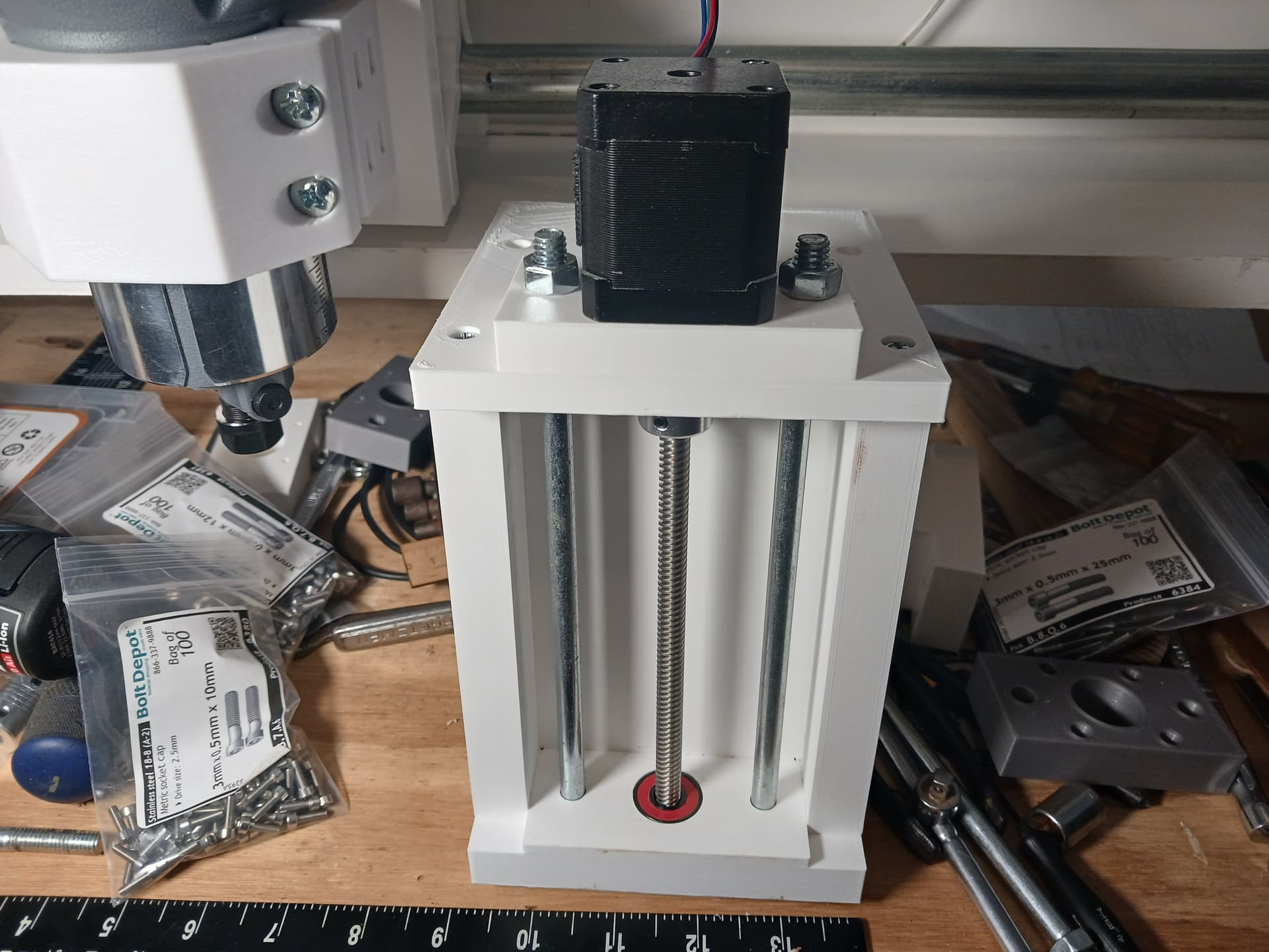

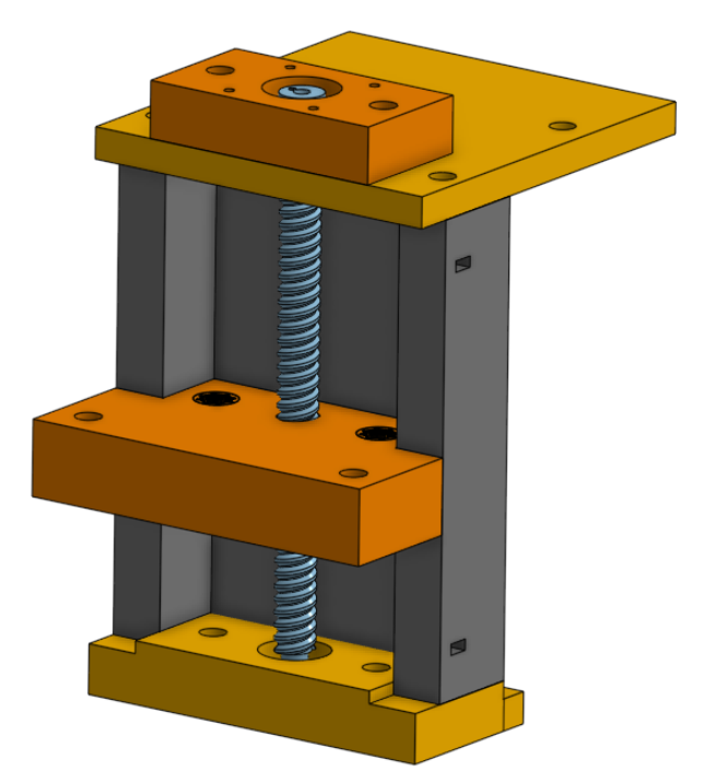

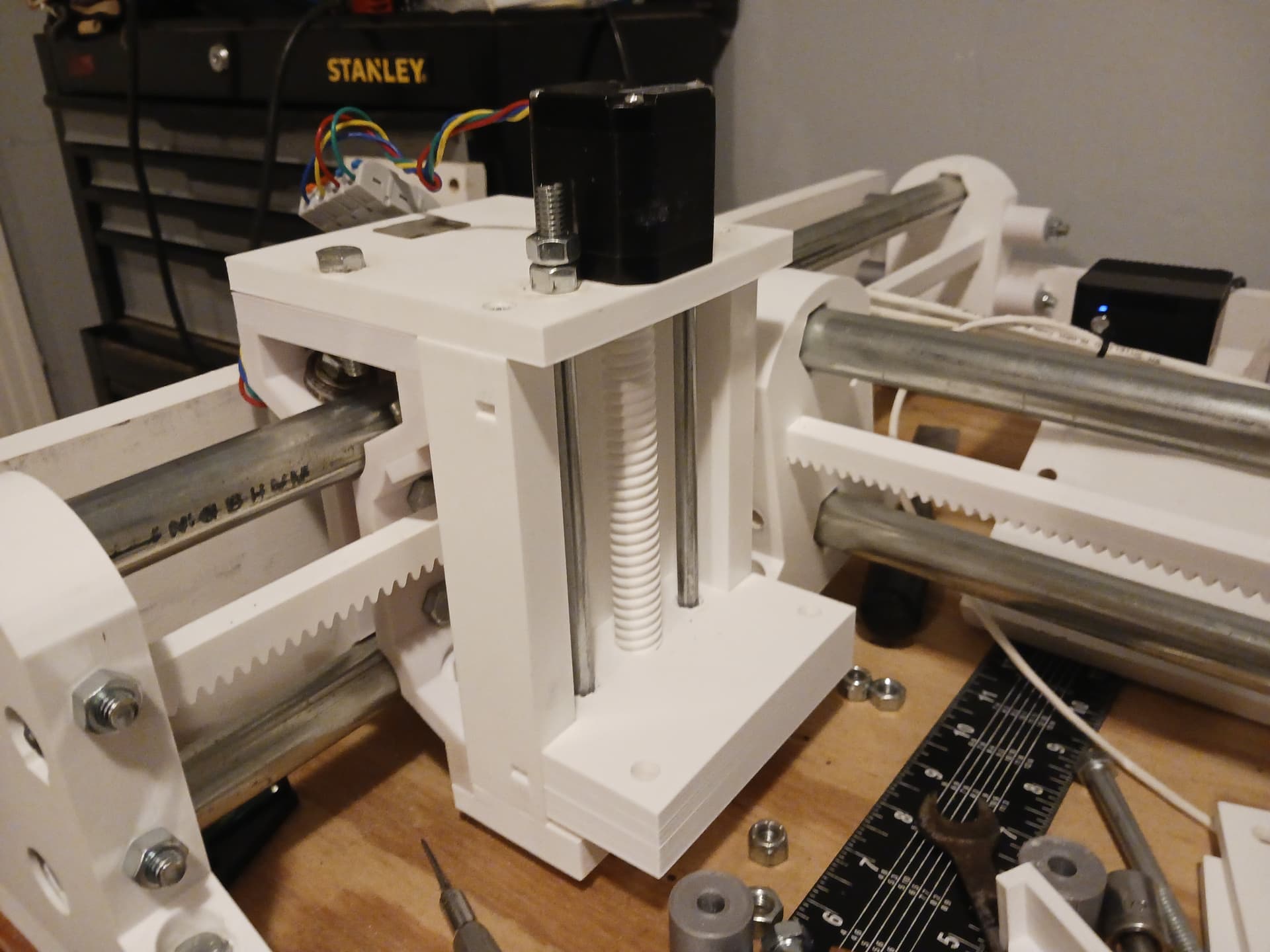

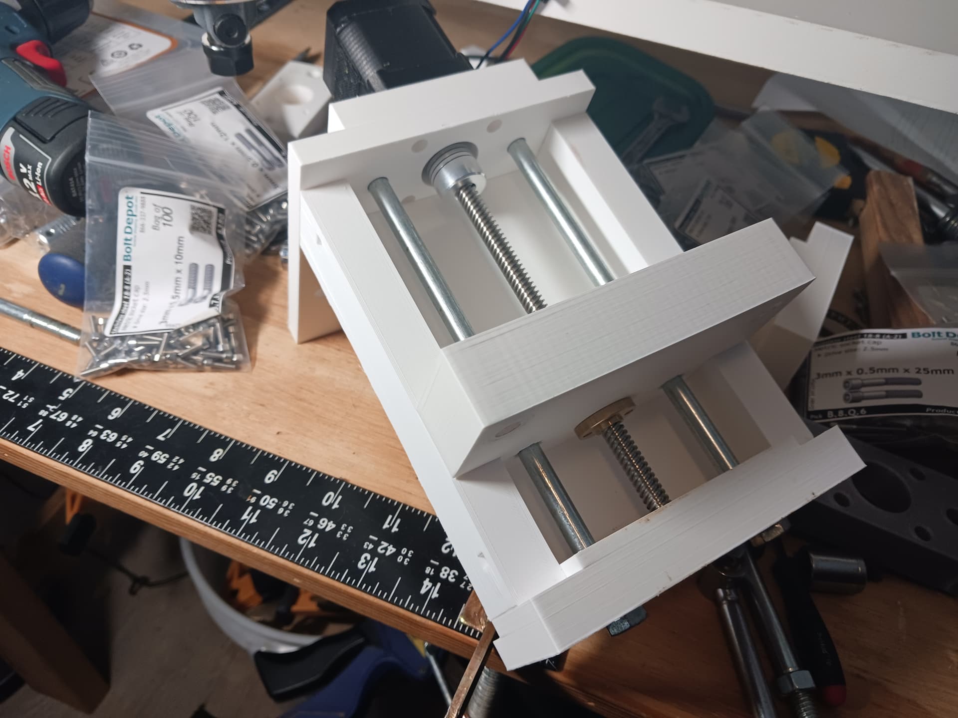

Went into Onshape and increased the minor diameter of the leadscrews to 14mm… and created new lift blocks to match. New 14mm screws and 10mm for comparison…

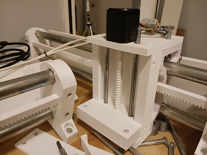

Disassembling the left lift assembly…
and new one installed. Tighten the guide rod bolts carefully while manually rotating the screw to find where it still rotates freely without binding or excessive slop… and put jam nuts to lock them into position.
One to go…
Later.

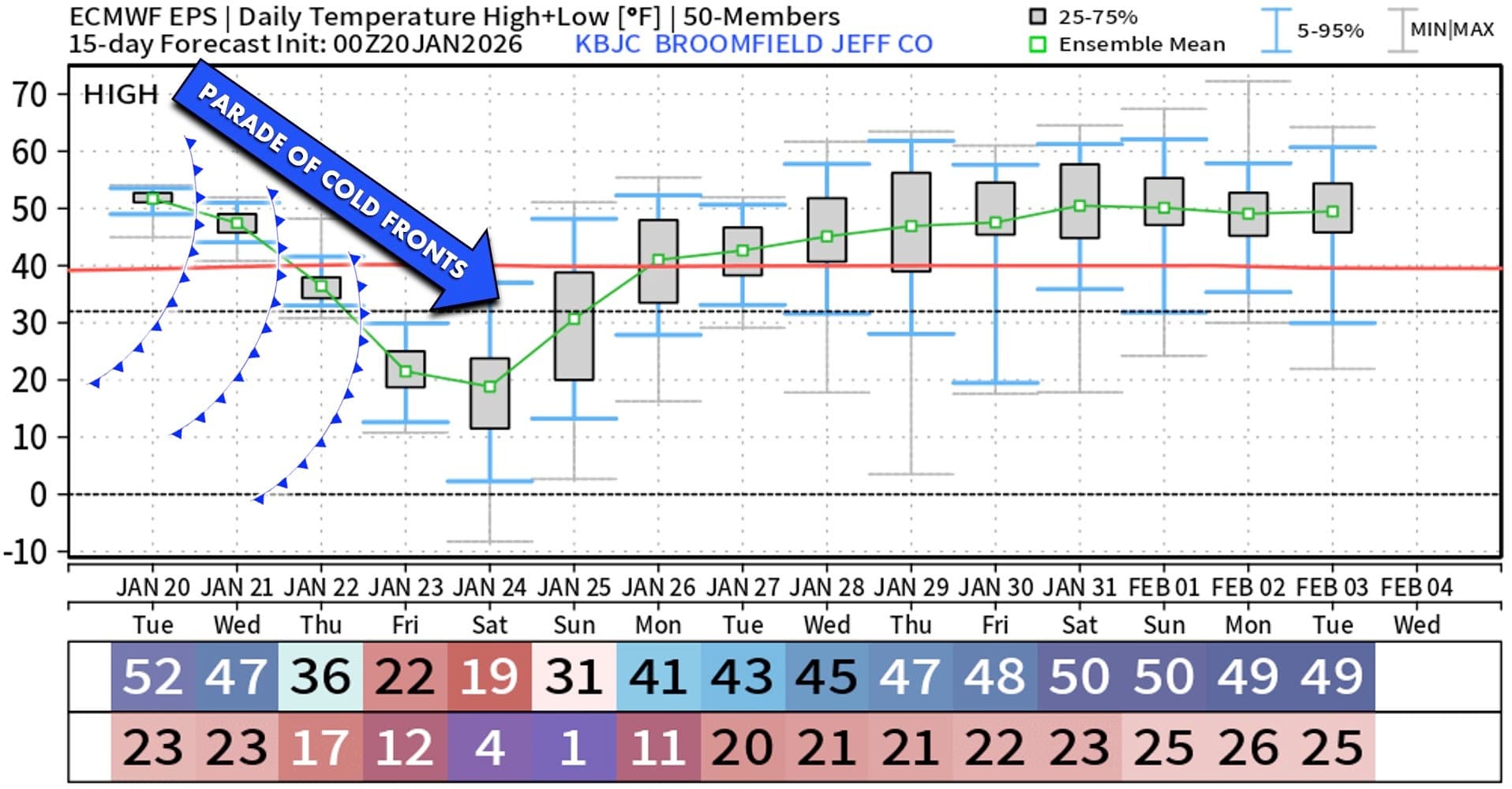

I may not make much progress the rest of this week on MPR&P as we have a ā€œParade of cold fronts.ā€

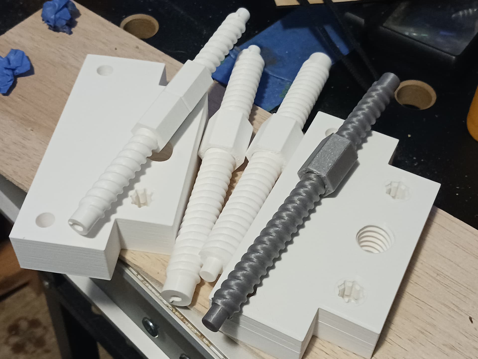

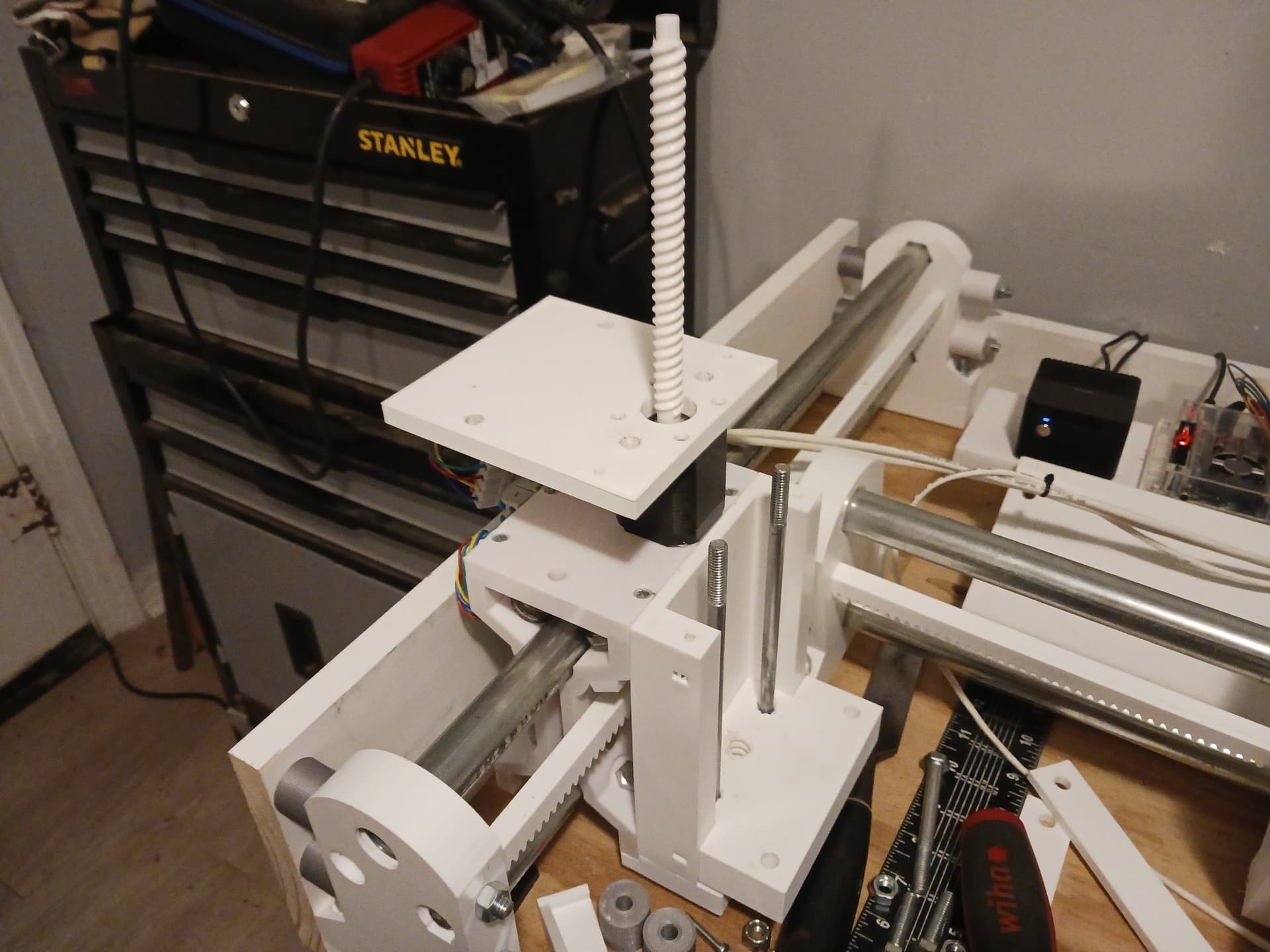

I’m not altogether sure I’m gonna go with the 14mm leadscrews anyway. I’ve seen some weird binding at times especially on one side that leads to lost steps. I know that Ryan said ā€œgo hugeā€ but I had far less trouble and far better performance with the 10mm screws… until one broke. I don’t know whether it was just ā€œmistreatedā€ or it really wasn’t up to the task. But I’m pretty sure driving a thinner screw compared to a thicker screw requires less torque out of the motor… and the printed leadscrew is definitely a higher rotational friction ā€œbeastā€ relative to a metal leadscrew to begin with anyway.

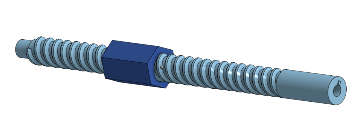

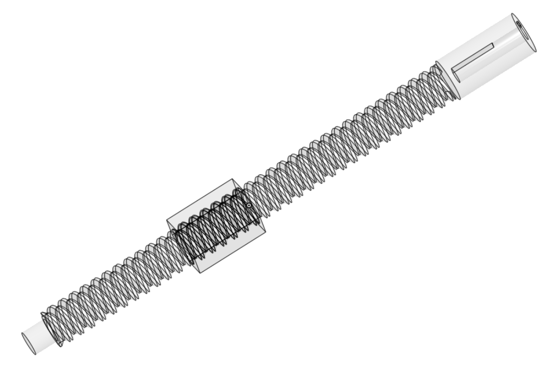

So I’m currently playing in CAD to see if I can stick with the smaller 10mm minor diameter of the thread vs ā€œgoing hugeā€ and simply finding a way to beef up the motor shaft recess area. Simplest would be simply to increase the overall length of the leadscrew, take the D-shaft recess out of the threaded area into a beefier, larger diameter extended area, and then raise the motor on standoffs or a custom spacer. Something maybe similar to this…

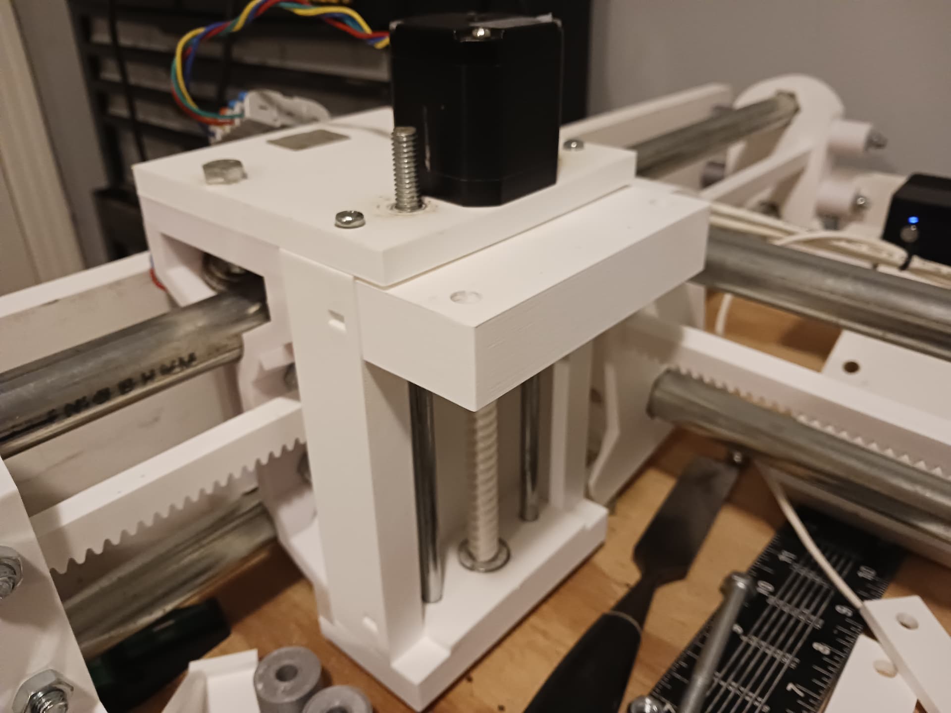

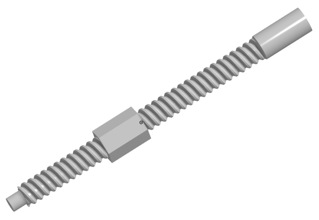

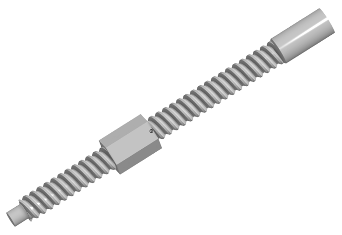

Printing now… a 10mm screw with 14mm diameter extended section enclosing the motor’s D-shaft recess. Also changed the pitch from 10mm to 8mm to mimic LR4… per Ryan’s request.
The longer leadscrew necessitates raising the motor by 18mm or so. But there is an added advantage that the new riser block – with motor permanently attached – is held in place with the guide rod bolts… and the motor and riser – and [broken] leadscrew – can be removed, repaired, and replaced as a unit from top-side. With no change in screw pitch or diameter, the lift-block can stay in place, trapped by the guide rods, and be reused with the new leadscrew.
So, hopefully this will be the last time I totally dismantle to upper portion of the Z-lift assemblies. Any future leadscrew repairs should require only the guide rod nuts be removed and the riser/motor/leadscrew assembly lifted out as a unit.
I’ll print the new parts – leadscrew, lift blocks, and riser blocks – and install and test before I update Printables. If anyone (Jim?) wants to give this a try before I update Printables, let me know and I can drop them here in a .zip file.

Looks good!
If this doesn’t fix it, it occurs to me that when you zero by running into the top plate you have both a torsional force and a perpendicular force trying to pull the screw’s layers apart.
You could avoid (well, reverse) the perpendicular force by zeroing in the opposite direction. You could place blocks between the bottom and travelling plates (for zeroing only) to facilitate that (assuming that you can’t run the travelling plate all the way down to the bottom plate with a tool attached).
I guess this would necessitate no up/down play in the screw, motor, etc. connections, though.
I think you may be right about the top-plate ā€œimpact driverā€ action… trying to separate the layers. The bottom plate would be better and I do have uniform spacers that rest on the bottom plate to de-skew with a tool in place. Thanks!
I’ll test with the updated files. Send them over when you’re feeling good about them.

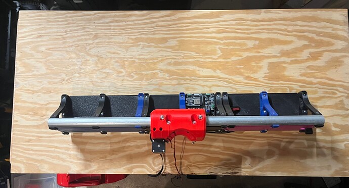

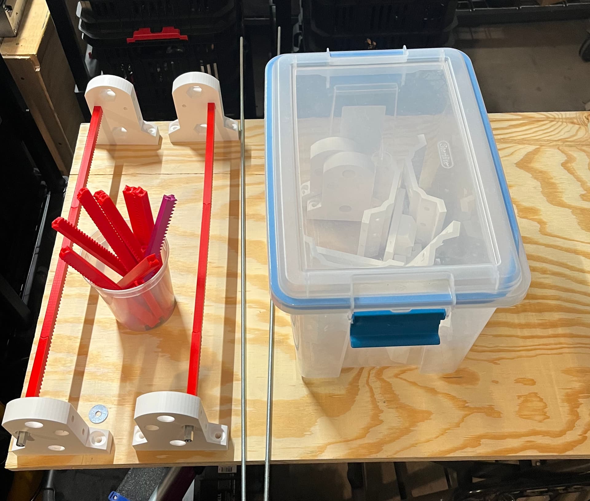

Cleared off most of the last of the MPR&P V1 from the old table. There’s an early LR4 beam build with fully printed strut plates. Surprisingly stout.

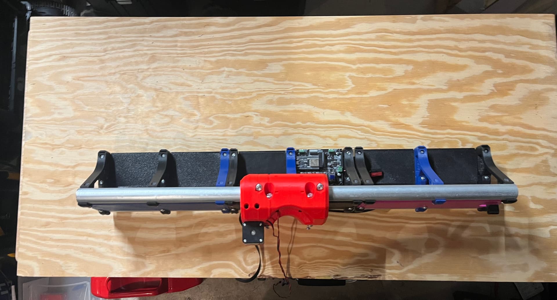

Here’s what the top of that infernal Ryobi bench looks like. I’m tempted to remove that surface, but then my plan for potentially making a larger MPR&P for RMRRF gets more work, so I’ll likely leave it.
Back on with the slightly thicker 3/4" by 2’x4’ project panel, mocking up the new stubby Y axis.
That is two 40 tooth segments and one 20 tooth segment. So, 100 teeth of rack.
I have extras, for the larger build I may attempt.
I had been using fender washers and coupler nuts on the MPR&P V1 build, these look to expect just standard washers. I’ll come back to that.
Since the EMT is captured by the ends, I’ll need to measure and cut those, which I’ll do some other day. My feet got cold, and that’s when I stop :slight_smile:

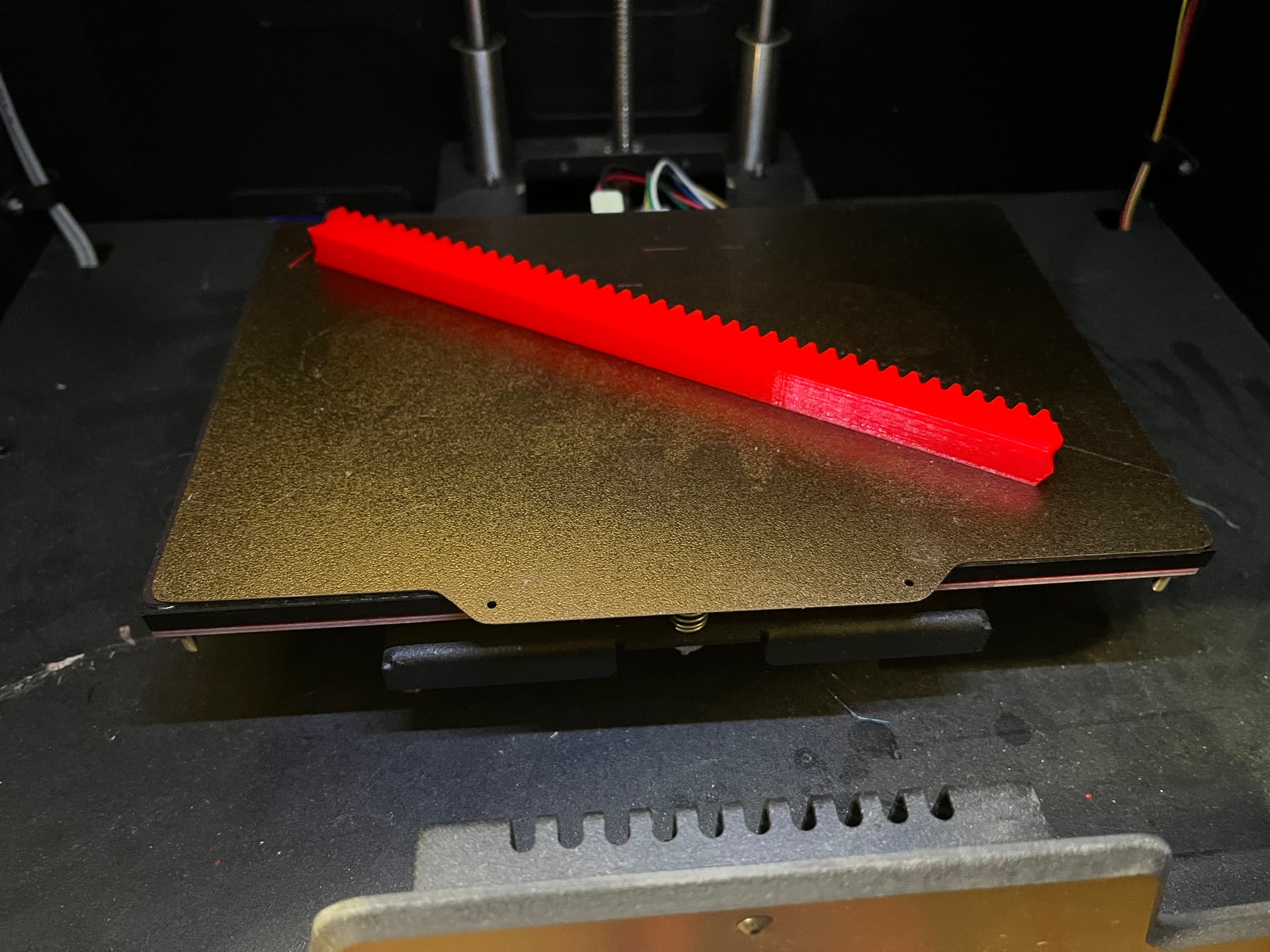

The printed-in-the cold rack segment turned out fine:
I fired off another one which is almost done.

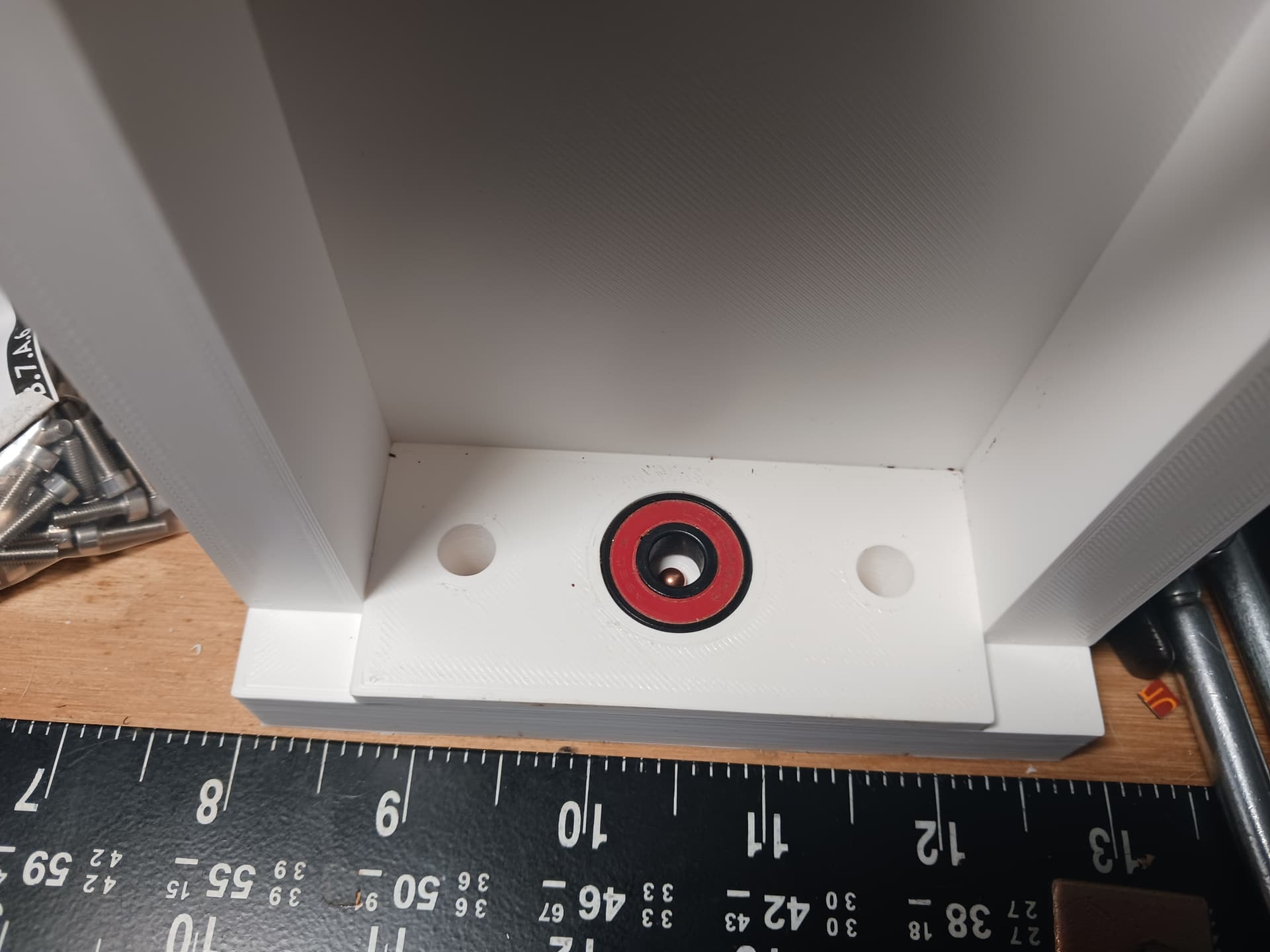

While I’ve been fiddle-farting around with the design of these printed leadscrews, I decided I need to show that a QUITE MOST PROBABLY BETTER lift assembly could be had using the LR4’s T8 leadscrews (and linear guides)… if you happen to have them and/or want to help support Ryan by buying new ones.
This modified T8 leadscrew driven lift assembly is quite similar to the printed screw lift assemblies I’ve been playing with but a couple of minor changes are required. I enclosed the bottom plate and added a BB-ā€œbearingā€ surface for the bottom-end of the leadscrew to rest on.
And, for now, I’ve stayed with the guide rods…
Here it is in action. It’s really noisy with no lube of any kind for now but I want to do a bit more testing if I should decide to get serious about using it.
