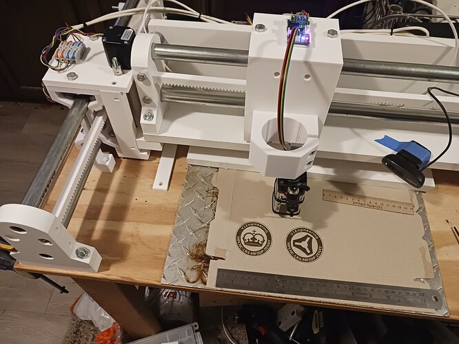

David, well, it looks like you’re ready for some files to test it out. I will have them sent over today for you to try. I’m really impressed with that machine; it’s super cool!
I’ve continued printing parts, and ocasionally making random robot noises :slight_smile:
I printed a 65mm tool mount, and remembered that it has a cutout for a laser module as well. I’m off scrounging to see if I have one in that form factor.

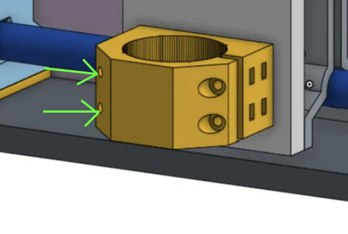

I do have a question- on the right side (clamp side), there are a pair of nut traps for attaching to the tool plate from behind, and another pair for retaining the nuts for the tightening screws.
On the left side, there’s a pair of nut traps again at the rear and then the screw holes go all the way through the part (see below).
Is there a reason the screw holes go all the way through the part?
I’m considering adding heat set inserts in the meaty part where those screw holes emerge, and can’t figure out a reason those holes are full through holes…

Actually, no. And my printed part doesn’t have them… I stole this one from the original MPR&P.
I guess I accidentally captured an early CAD version when i was adding the nut traps. I’ll update Printables. Meanwhile here’s the proper version, I think…

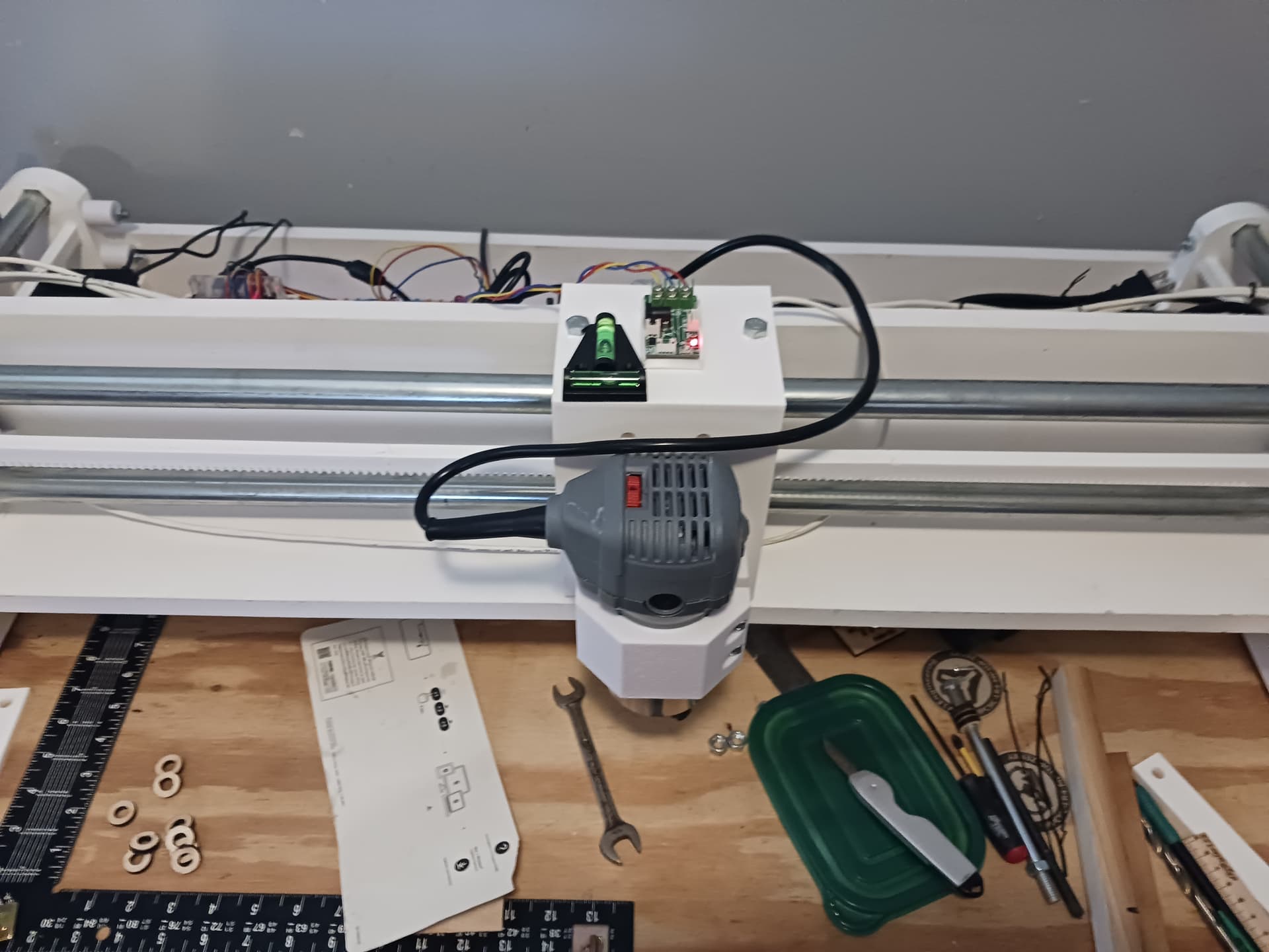

I’ve been doing a fair bit of air-milling and have noticed that sometimes one or the other Z-lift loses a few steps and the gantry beam will be slightly off ā€œlevelā€ from where it started. It doesn’t always do it for relatively short runs but it’s usually off on a 40 minute vcarve job. I’m thinking of upping the Vref a touch to give the Z motors a bit more current… but also thinking maybe I need to slow the plunge rates and possibly lower the acceleration on that axis. Thoughts? What are the typical plunge rates and accelerations on LR4? I’ve only guessed for MPR&P to this point.

Not a snafu. I spent a bunch of time trying to figure out what those holes were for :slight_smile:
Which led me to some other ideas.

Here is the unique view I have from my recliner while air-milling these vcarve files…

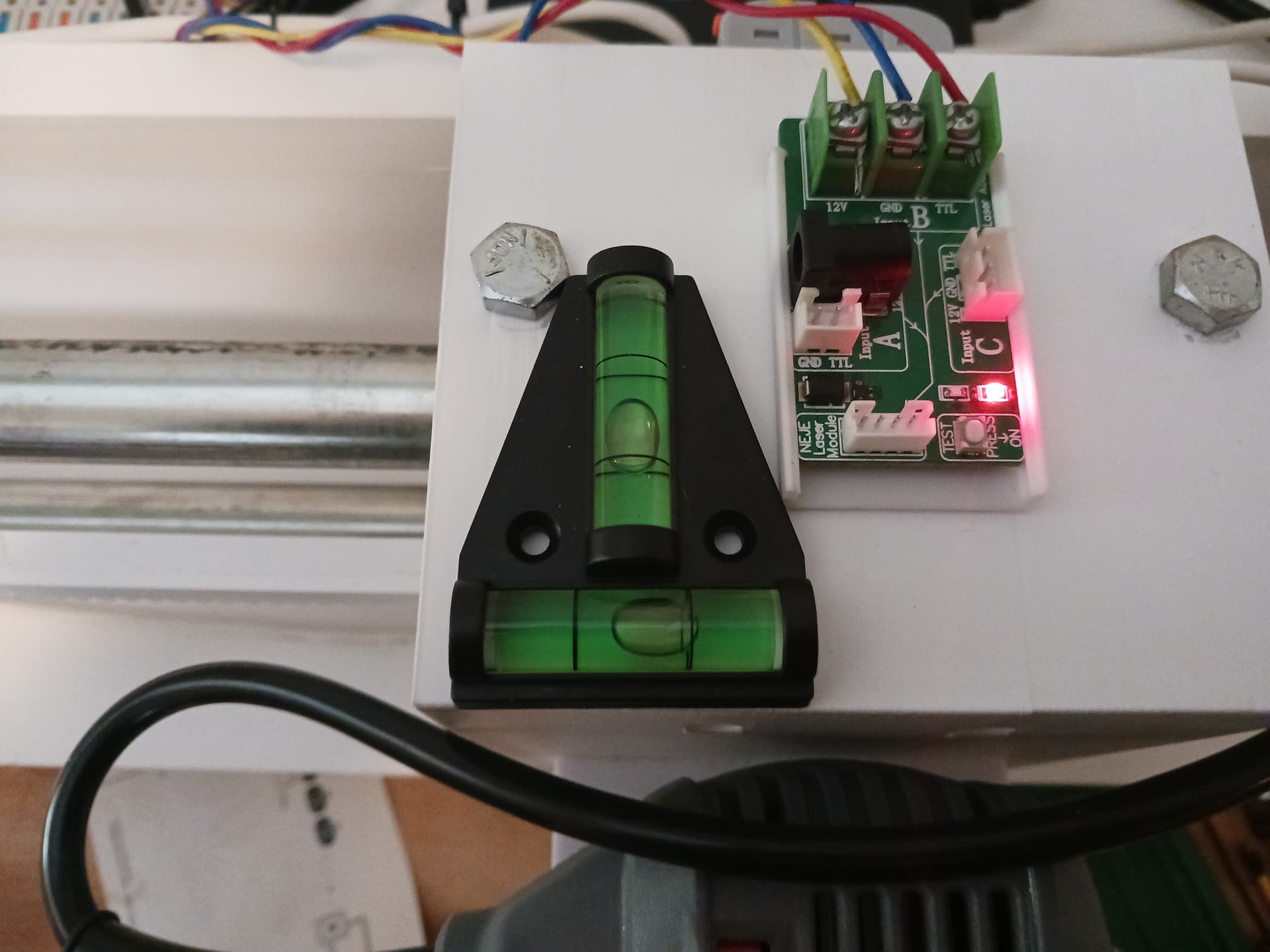

and periodically I hear an odd ā€œgruntā€ in all the ā€œrobot noisesā€ (as @MakerJim calls them). When I got up to go look closer I can see what appears a small skew from ā€œlevelā€ā€¦ the bottom bubble was near centered at the start of the job. That’s what I’m trying to track down… why?
[An observation: AFAICT the bubble always(?) moves right, which would seem to indicate the LEFT lift assembly might be the one losing the steps and ends up lower than the right lift.] The motors are wired in series. I’m leaning toward upping the Vref to increase the Z motor current a bit. Since it seems okay MOST of the time, with ONLY occasional ā€œgruntsā€ā€¦ maybe the motor current is just ā€œmarginalā€.

I think I’ve confirmed that the Z motor current needs to be increased just a bit more.

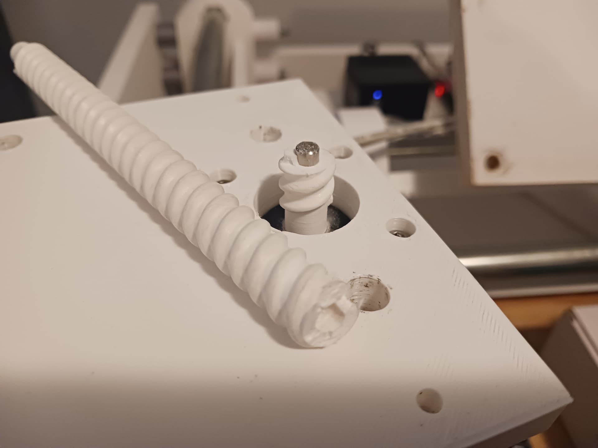

While air-milling a ~420mm X ~280mm carve, I had been setting the job origin (0,0,0) in the front left corner… and losing steps during a 40 minute carve job… and always to the same side. So I moved the job origin 200 mm in X toward the middle of the machine and ran the next four consecutive 40 minute runs without losing a discernible step.
Apparently, the weight of the router, biased toward one end of the gantry during most of the run, was enough to cause an occasional loss of steps at that end. Keeping the weight of the router more in the middle seems to have ā€œcuredā€ the loss of steps problem.
Having just done the currrent calculation for Vref in a previous post… it appears that pushing 0.8 VDC on Vref would set the motor current to ~1 amp.
Alternatively, you can lower the accel and get a lot more power out of it.
That’s good to know. ā€œA lot more powerā€¦ā€ would be nice. I’ve not yet increased the Vref but also really didn’t know the effect of the acceleration on motor torque. I really didn’t want to make the motors and controller run hotter than they are now, if I don’t have to.
However, I just broke another leadscrew… a 10mm one this time. And just about in the same spot…
To its credit, it’s been running beautifully for the last day and a half or so… ever since I start running jobs more in the middle of the machine rather than at one end. And I had run that 40-minute badge job at least 6 or 8 times with no discernible loss of steps… until it decided to break while demo-ing it for my SIL.
But it’s also the one that was taking a beating when I was trying to figure out why I was losing steps on that side. And, maybe I’m just underestimating the torque of those little motors when I was running them against the hard stops to square it all back up. I suspect it may be the ā€œimpact driverā€/hammer-effect of running briefly against the hard stops that’s killing the leadscrews.
I’ve got a couple of extra leadscrews printed up so will probably just go ahead and replace it. Now that I know why the gantry was losing steps on one end, I should be able to not torture a replacement screw quite so badly while I continue testing and playing with the machine.
I really don’t want to go to metal leadscrews and a coupler… though it could be done easily enough by raising the Z-motors up on standoffs to make room for the coupler. I bought a set of LR4 leadscrews initially thinking I would probably use them and the linear guides. I’m sure that would actually be the best, though more costly, setup anyway.
But I’m still not ready to give up on the printed parts. I might increase the diameter of the printed screws one more time… to put even more meat at the spot these others have broken. I could make them much larger in diameter, of course… but just don’t know the effect on the motors of the increase in friction; i.e. they may be a lot stronger than I’m giving them credit for, judging from the broken leadscrews I’ve had.
But hopefully I’m learning enough to stop torture-testing the machine so badly… and maybe the printed parts will prove to be good enough under normal use.

Do you really need threads in the leadscrew around the motor shaft? If you deleted the threads and had the full diameter of the leadscrew for about 1/2 a diameter or more above (well, below since it’s inverted) the internal shaft void it’d be a lot stronger.
Just so I know for sure… my 2-start printed screw moves 10mm in one revolution; i.e. each of the 2 helix are 145mm long (the length of the actual threads) with 14.5 turns. I’ve assumed that is a pitch of 10mm. If so, then for the same 145mm thread lenth, I could get a pitch of 8mm with 18.125 turns. Am I computing the pitch properly?
Does the T8 threaded rod move the nut 8mm per revolution?
Yes and yes.
I bet just playing with the accelerations you will make what you have work, once you beef them up a bit more.
My reasoning was that I wanted the top plate to which the motor is mounted… to be a hard stop for correcting for any possible skew between the lift assemblies due to lost steps at either end. Same at the bottom end of the leadscrew. Also having the threads themselves not terminate in the full diameter of the screw allows the leadscrew to be replaced from either above or below.
However, since Ryan has blessed a diameter increase even more significant than I might have ā€œsnuck up on itā€ (I was concerned about the friction increase with longer thread area spiraling around the shaft… ), I should be able to put ā€œmore beefā€ in that area without really changing the design goals I had for it. I started with a minor diameter of 8mm, then went to 10mm and the motor shaft is of course 5mm. Going to 12mm or 14mm would be easy enough and give significantly more ā€œbeefā€ than in the screws that ā€œalmost workedā€ anyway.
By ā€œhugeā€, Ryan… is a 12mm or 14mm ā€œminor diameterā€ on the leadscrew (it’s 10mm now…) huge enough? Any thoughts/worries about ā€œthread frictionā€ with same thread profile but longer circumferential length? Are these little NEMA17 motors, properly operating in their curve, more 'torquey" than I’ve been giving them credit for?

You could also try printing slower (in that section) to increase layer adhesion so that it might better resist the torsional forces.
