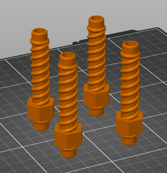

Here are the project, part, and bgcode files I used for the 10mm leadscrew and lift blocks…
MPR&P-Z_lift_block.zip (7.9 MB)
MPR&P-10mm_leadscrew.zip (6.3 MB)
Have fun!

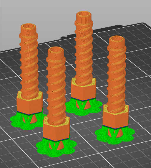

I’ve considered that but since I’ve increased the diameter of the leadscrew to add material where the first one broke, I’m gonna install and test with what I’ve got until I know otherwise. I also shudder at the thought of cleaning the support material off the threads if printed at 45 degrees…
I have more confidence in the XY accuracy of the motor D-shaft bore and leadscrew diameter printed vertically. The layers are horizontal of course but I’m believing/hoping most of the forces on the leadscrew are compressive, rather than side or twist. The guide rods have a closer fit in their bearing surfaces than the necessary ā€œslopā€ in the screw/nut interface… so hoping they take the brunt of any side forces.

I’ve updated MPR&P out on Printables with the latest parts. I think whats out there should pretty well match the prototype machine I have and am now testing.

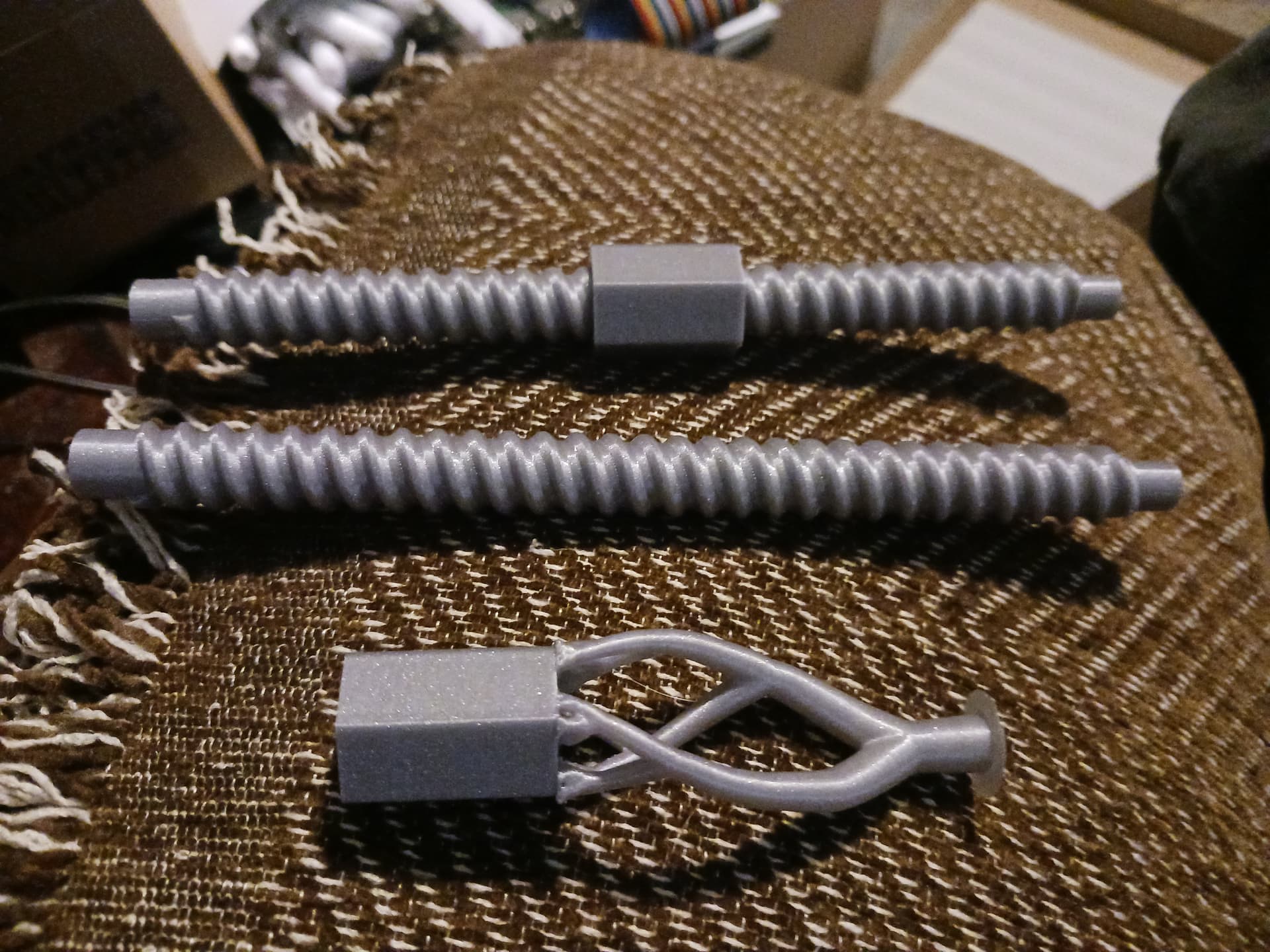

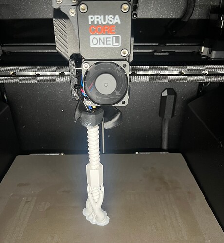

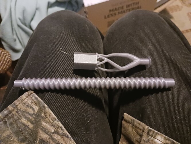

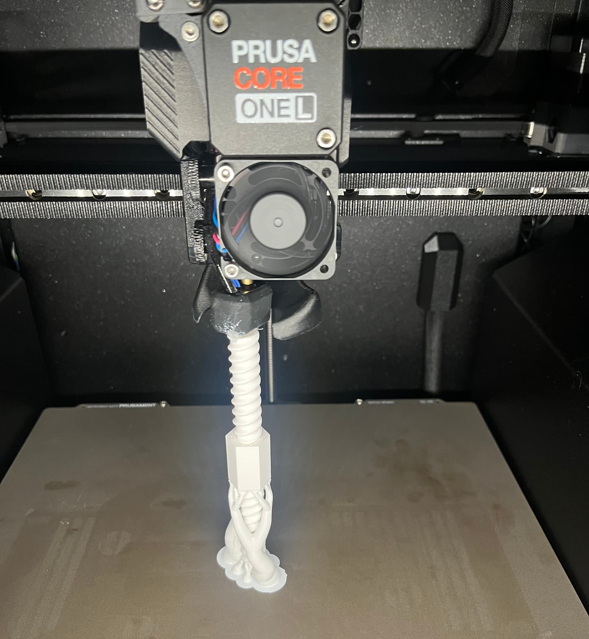

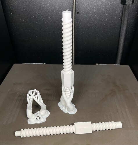

Threw the .bgcode onto the Core One L and kicked off a print.
Will see how it turns out.

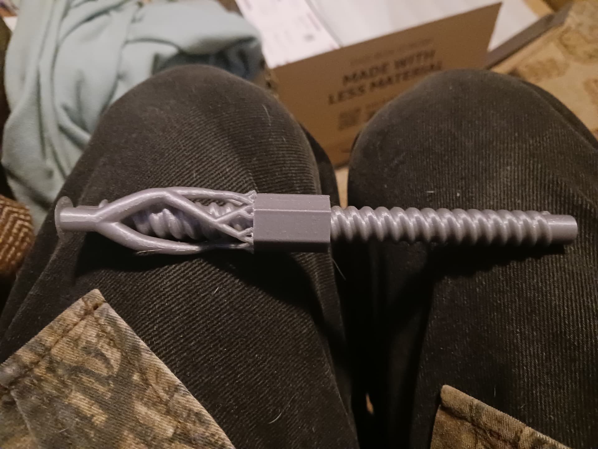

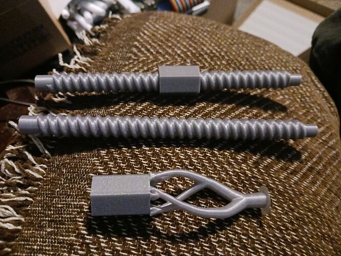

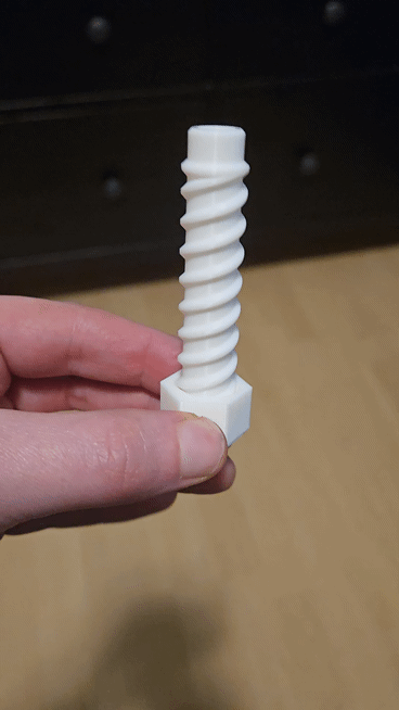

First copy from the .bgcode started off great, as expected.
The organic supports broke off beautifully, and the print-in-place nut / print stabalizer threaded off perfectly.
2nd print also came out great.
I’m going to need to print more, the grandkids love the rod/nut for figitibility, plus the organic supports are quite a curiosity.

Funny the ā€œfigitabilityā€ā€¦ I designed these for my 7 grandkids since I was playing with the print in place leadscrews at the time. Stuffed their gift money inside for family Christmas… both the money and fidgit/figit toys seemed to go over quite well.

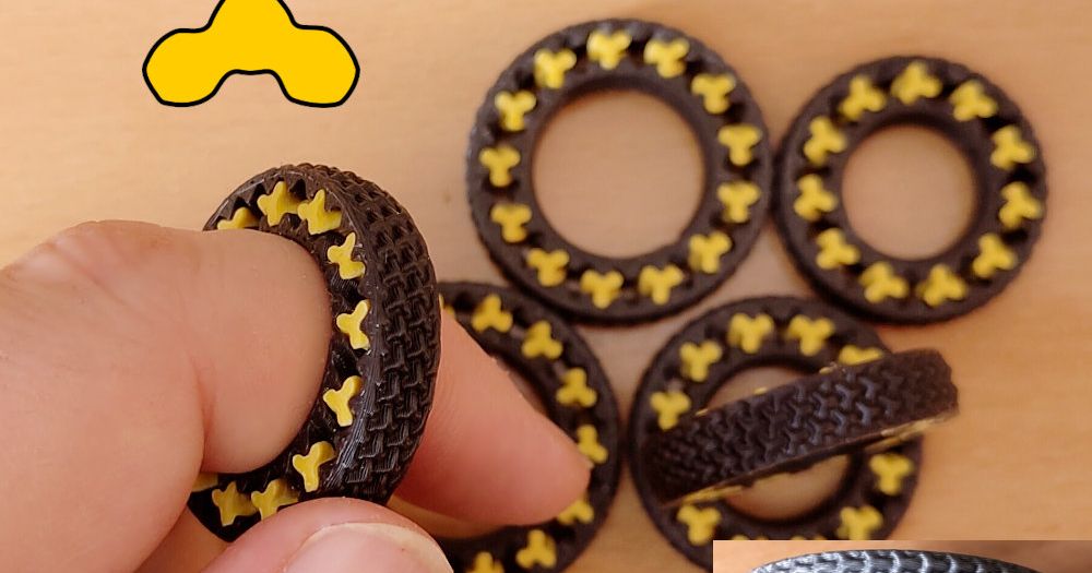

So, did this one (not my design)…
Bet your grandkids will like them. BTW I enjoyed fidgiting with them while we all sat around, too.
:wink:

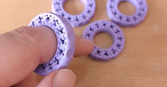

Neat! Am printing one of your fidget rod/nuts.
Fidget gears designer has bunch of interesting variants. Am printing this one…
Cool. My daughter likes it too.

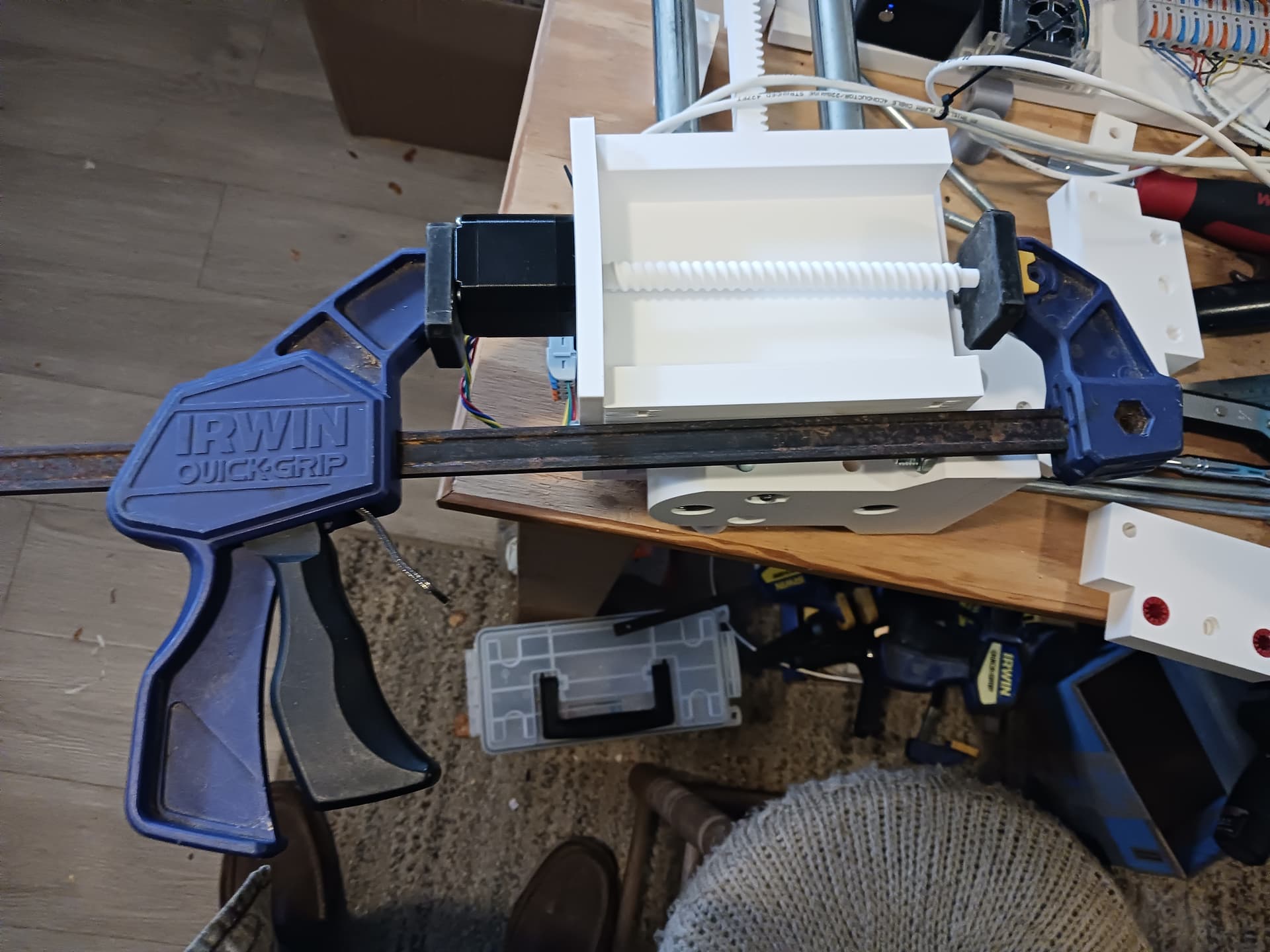

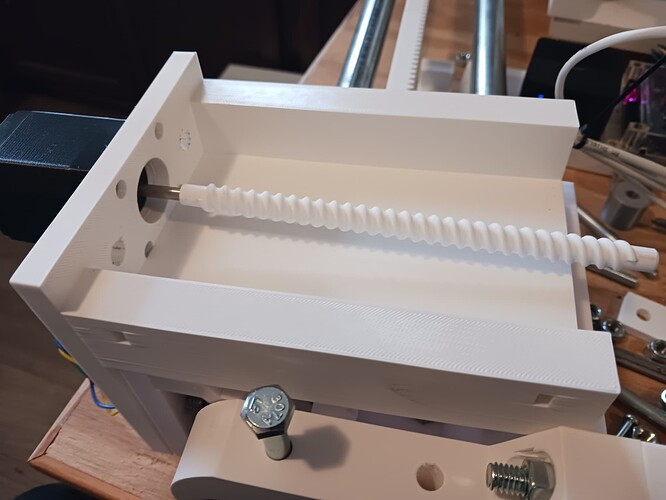

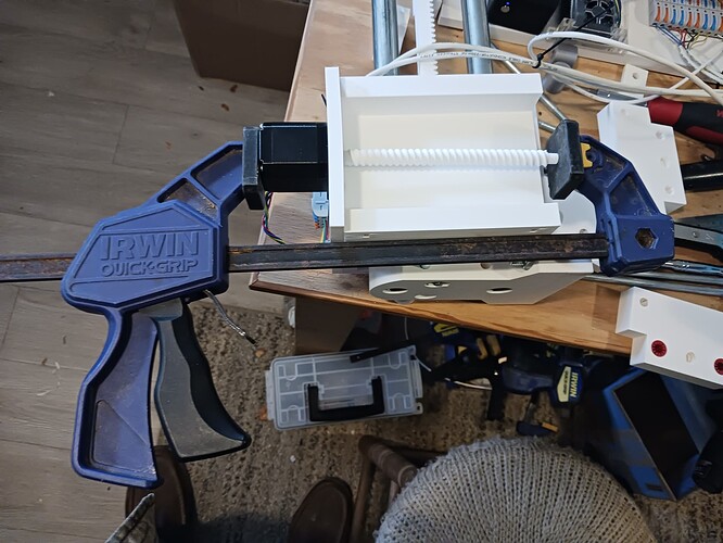

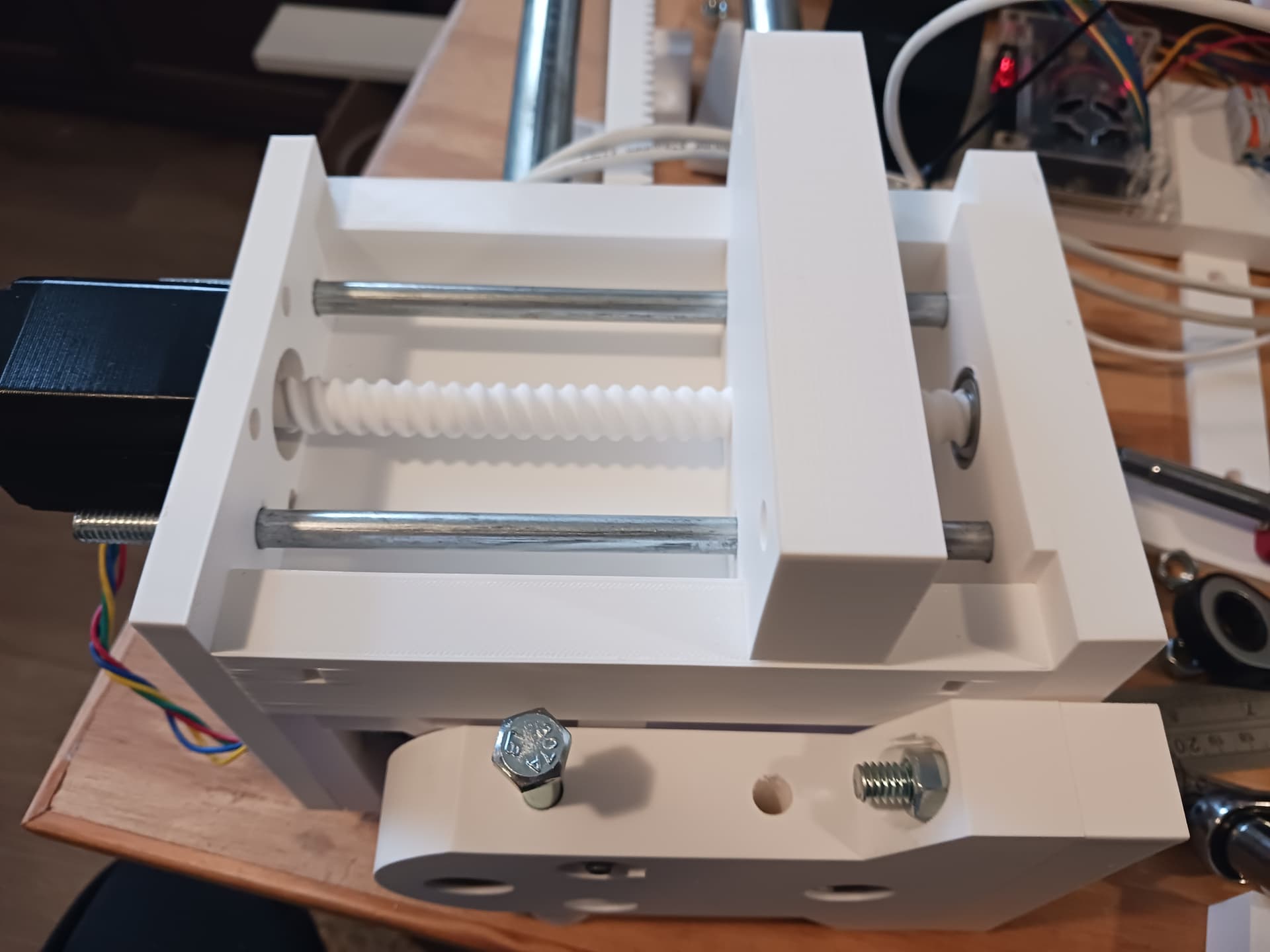

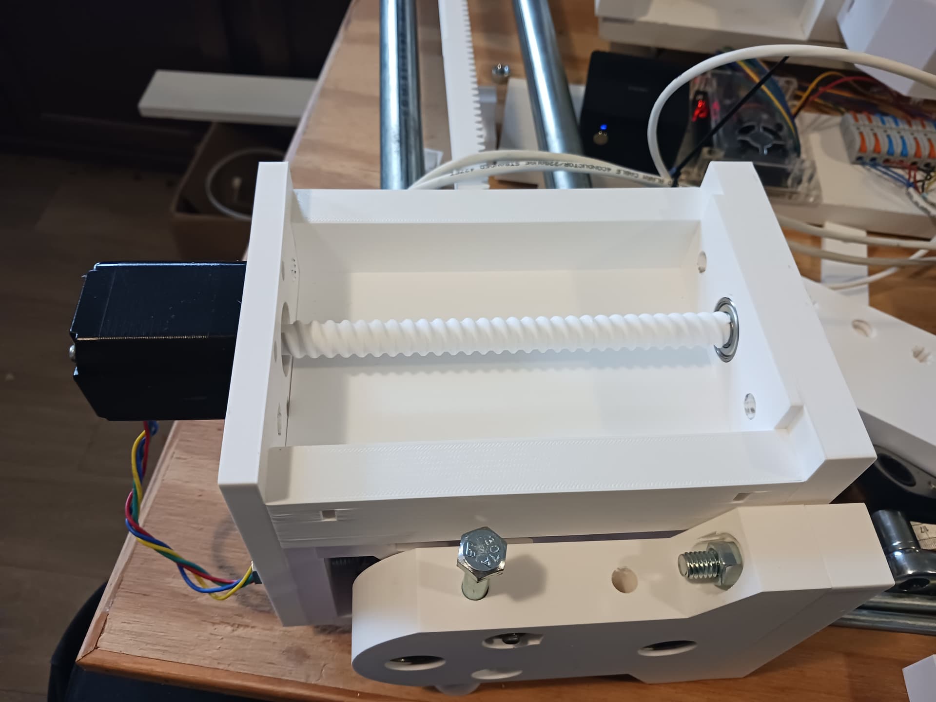

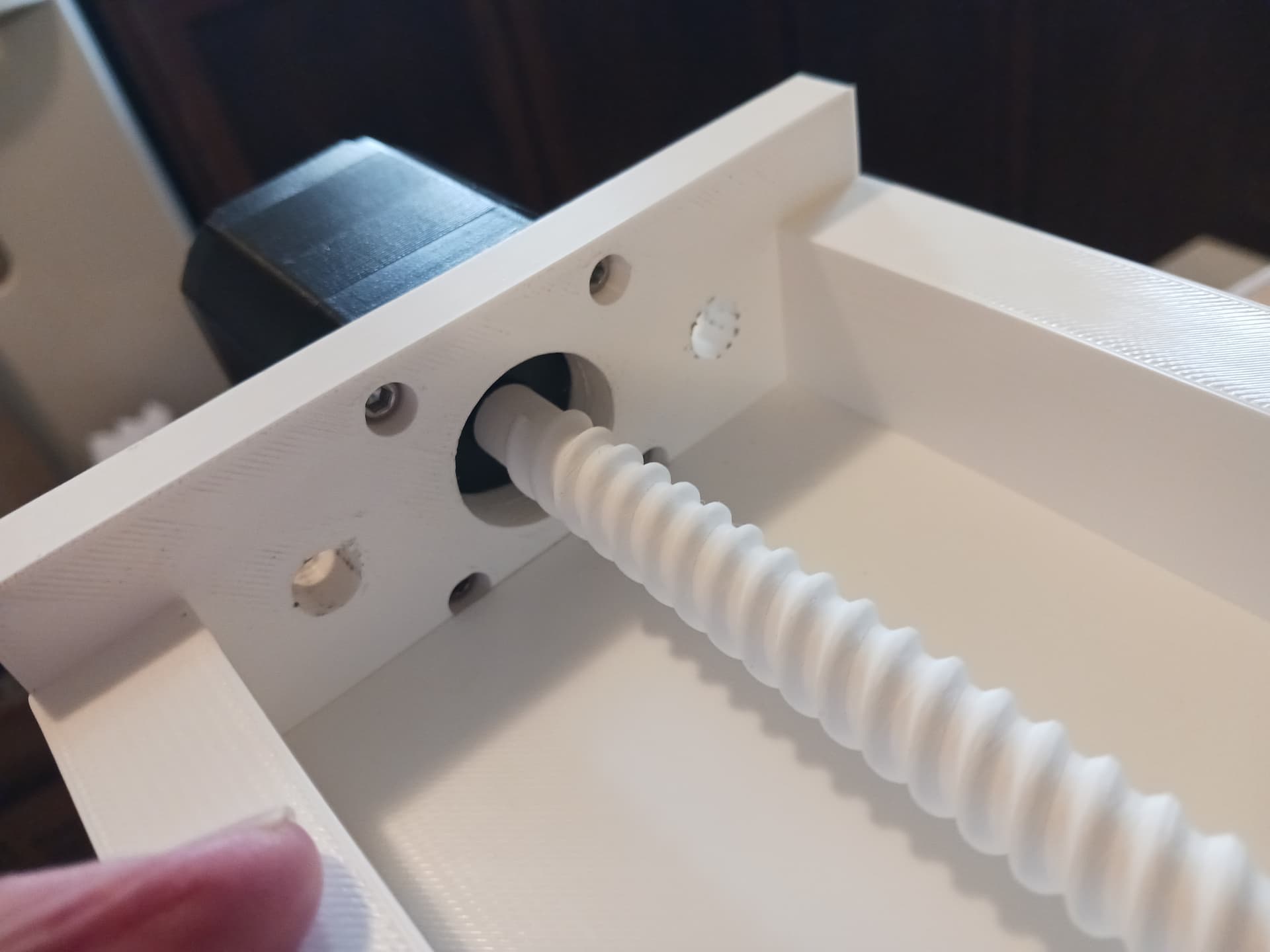

Thought I would show how I think best to assemble the Z-lift assembly. Assuming the lift chassis and motor are already assembled (less the bottom capture plate), which in this case they are…
Remove the old 8mm leadscrew…

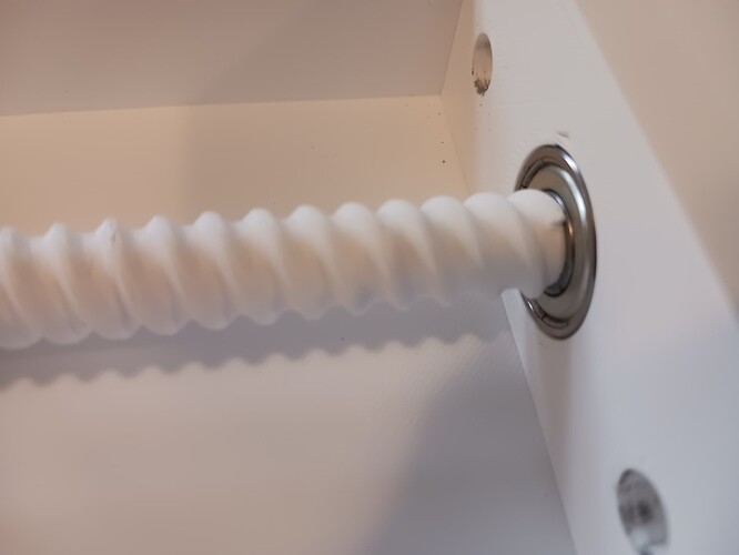

After aligning the flat and starting the new 10mm leadscrew on the motor’s D-shaft, I use a clamp to carefully slide the leadscrew up the shaft until the 8mm bearing shoulder just clears the bottom of the chassis by about 3mm or so…
Fit the capture plate with 608 bearing on to bottom end of leadscrew and then use the 4mm screws to attach the capture plate, seat the leadscrew shoulder, and slide the leadscrew into its final position on the motor shaft.
Pull the capture plate back off the assembly, manually screw the lift block into place somewhere up the leadscrew, and replace the capture plate. Slide the guide rod bolts into place and use plain hex nuts to just snug them up. Not shown I run Nyloc nuts down to the hex nuts to lightly lock the guide rods into place…
and then test under power…
Have fun.

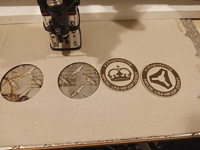

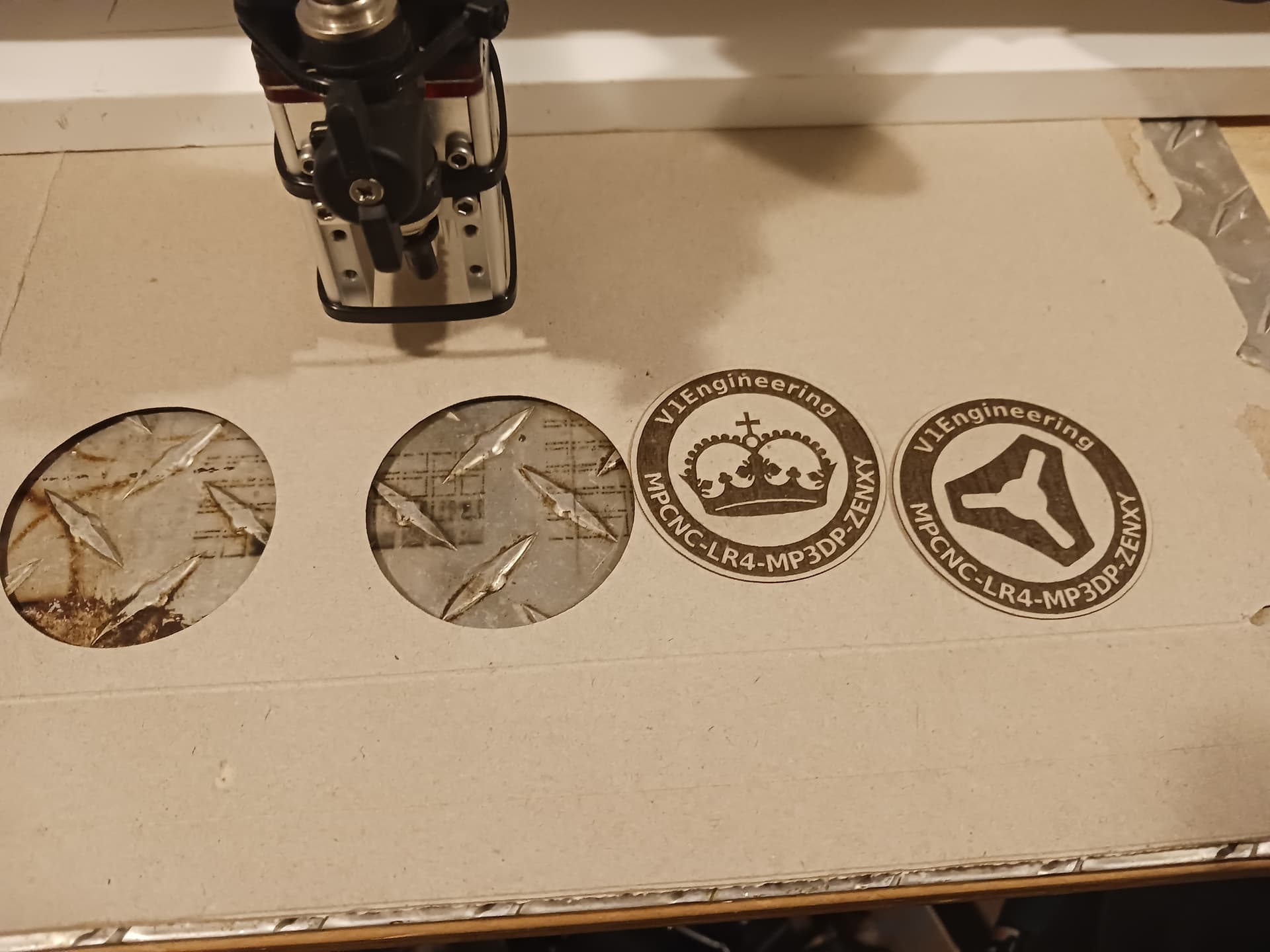

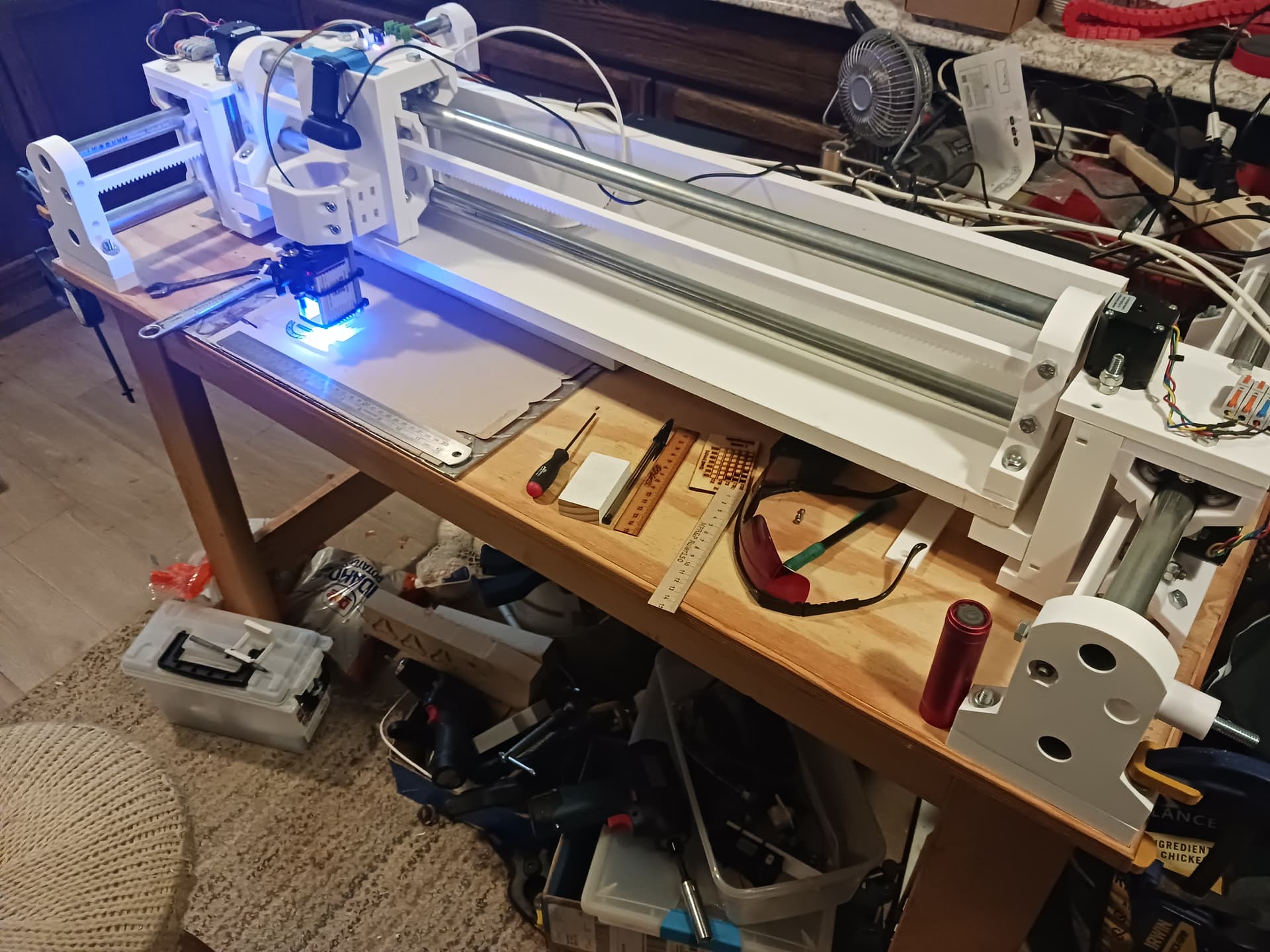

Switched the power supply from 12V to 24V and MPR&P runs much better. Been revisiting the laser, Lightburn, and Neje A40640 again… and, of course, just trying to get familiar with the machine.
Just hanging the laser from the clamp section of the 65mm router mount…

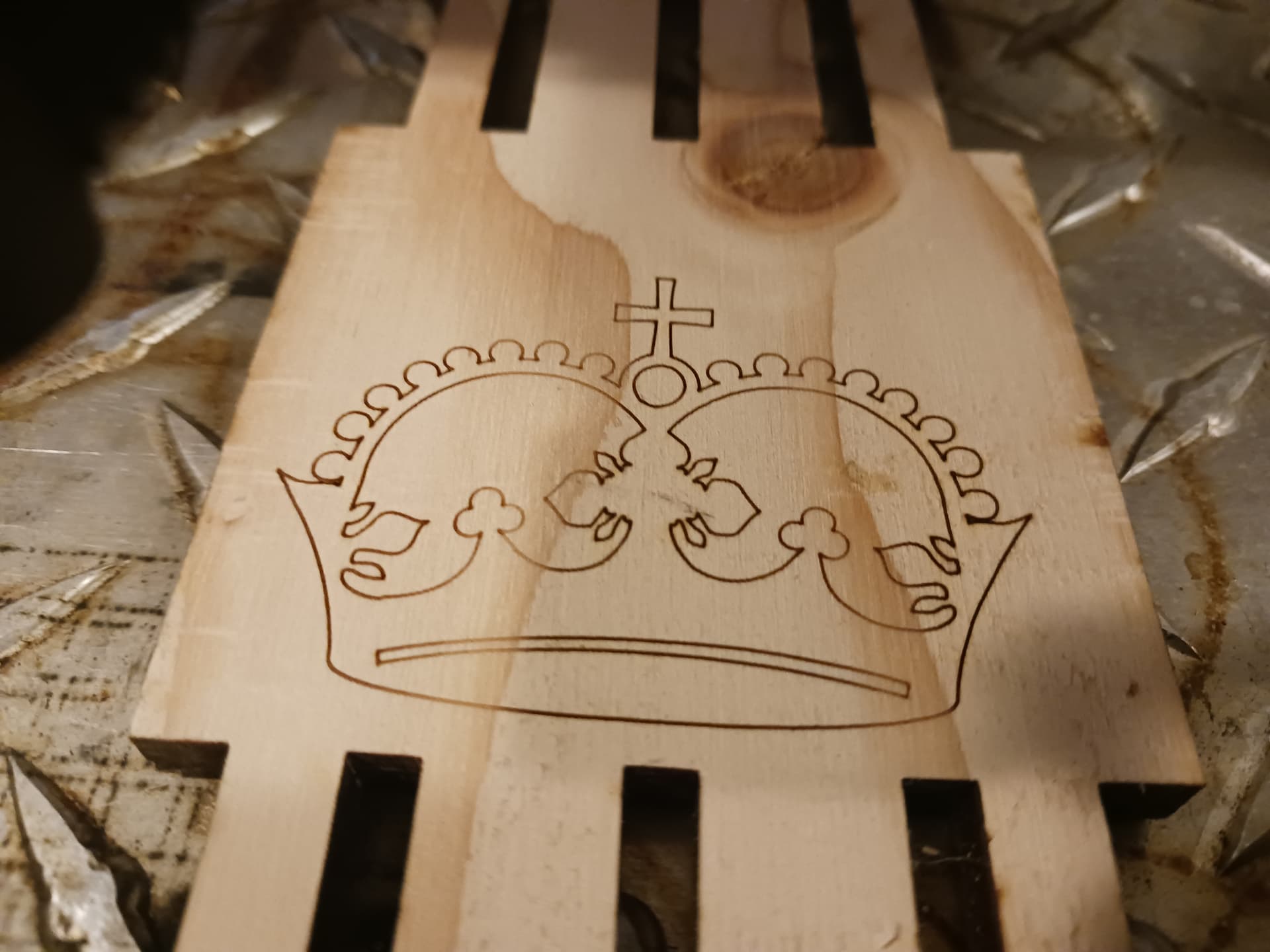

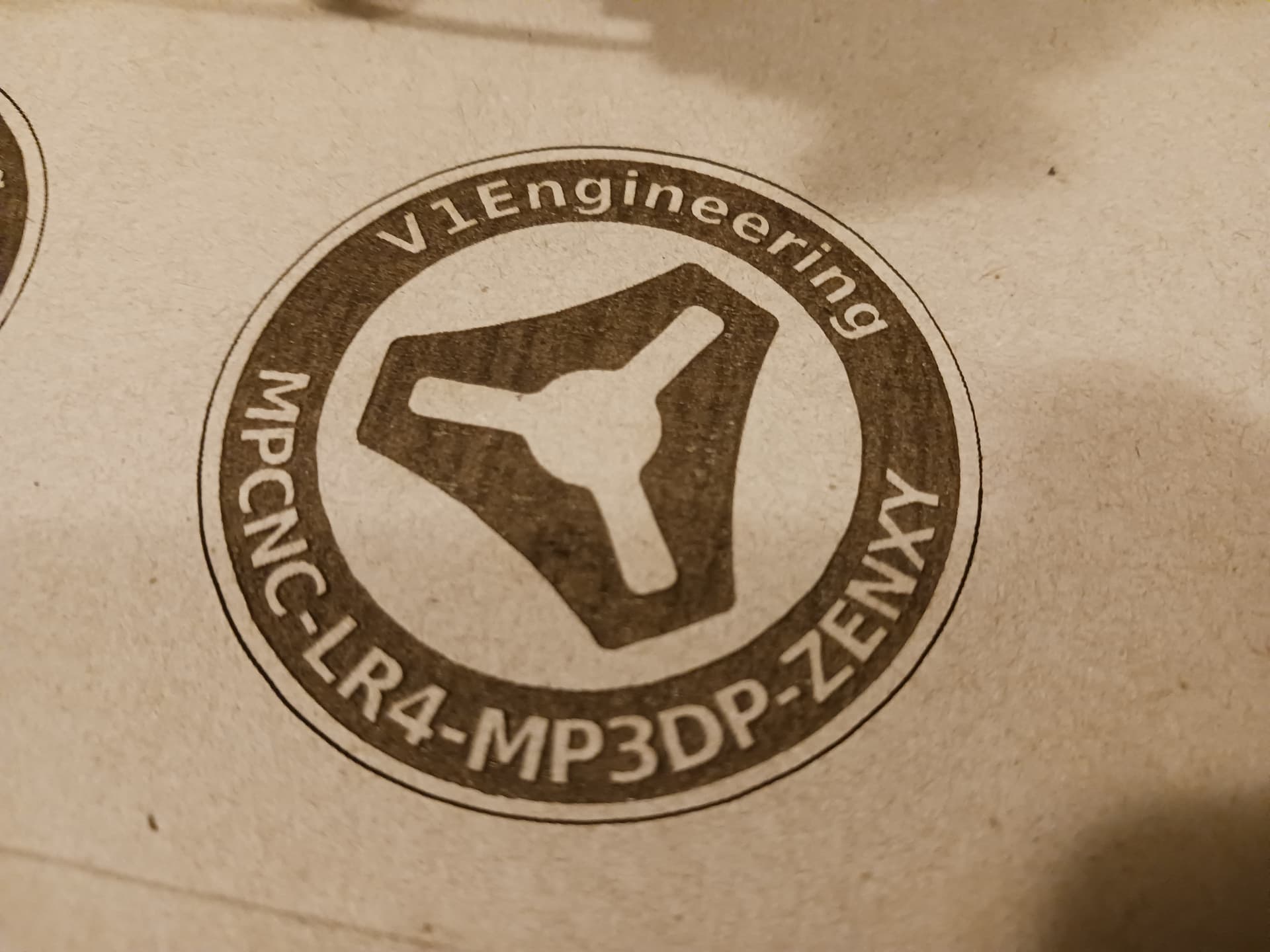

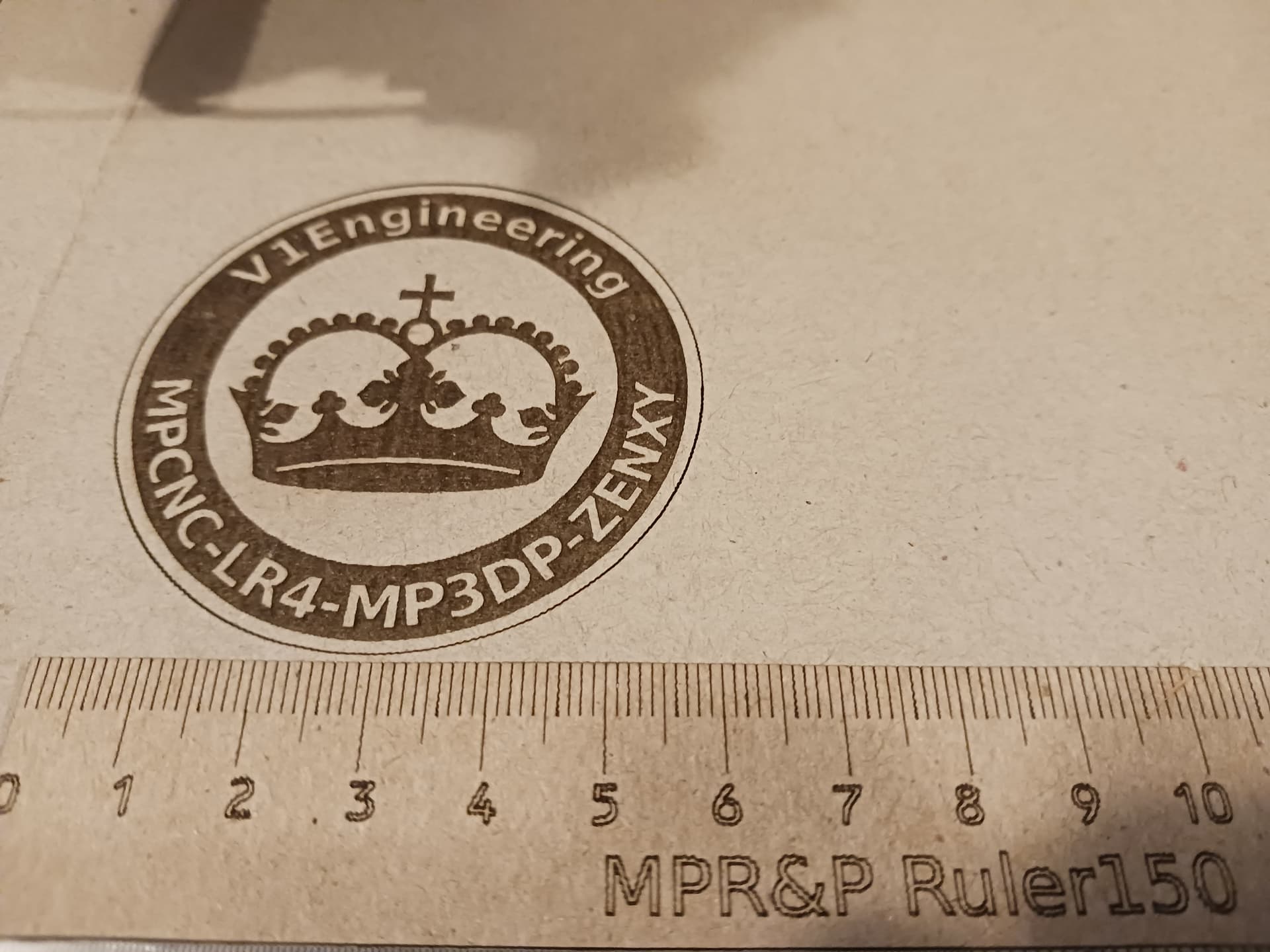

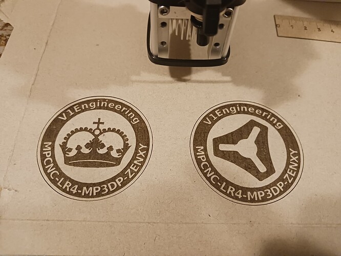

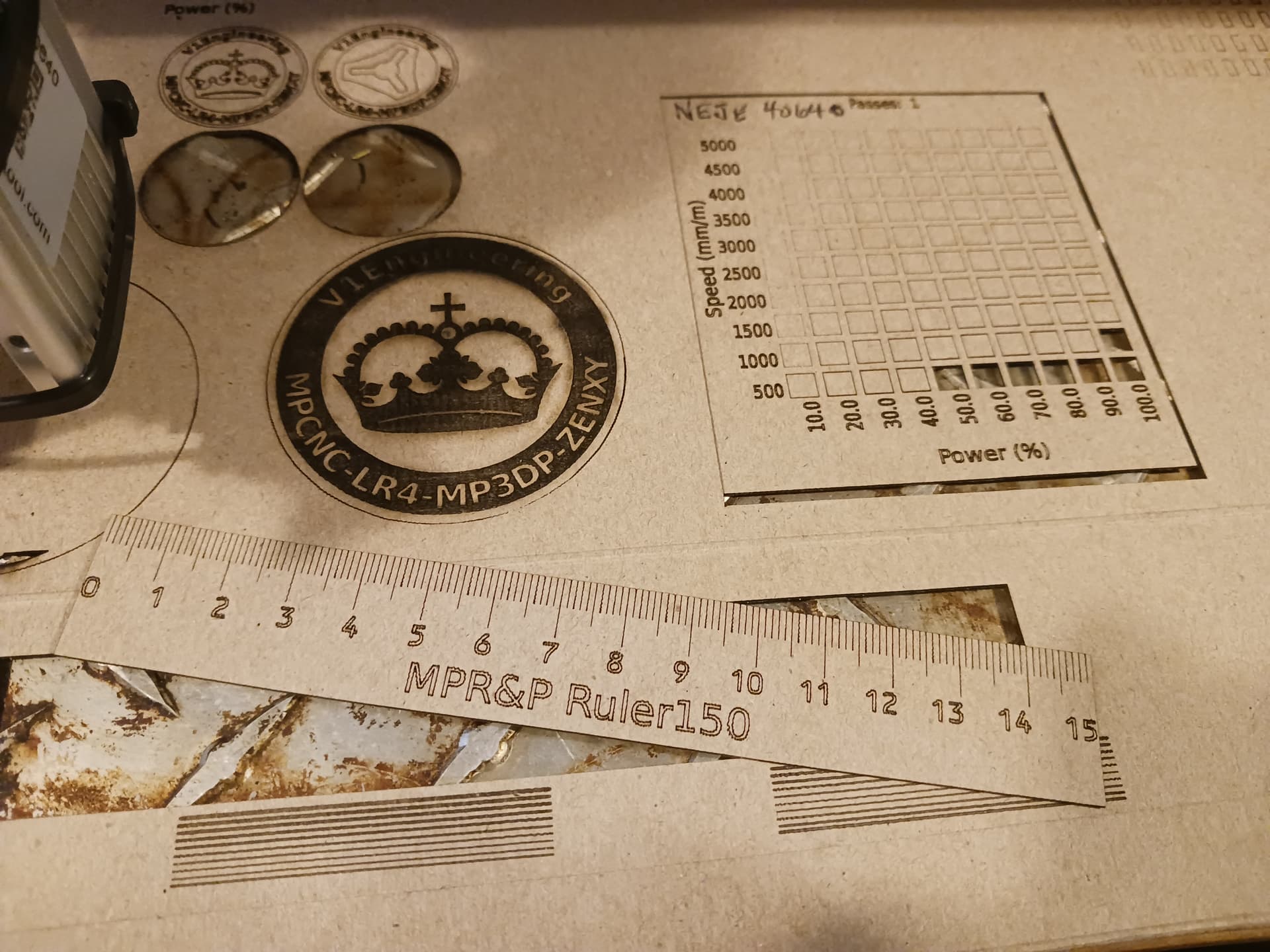

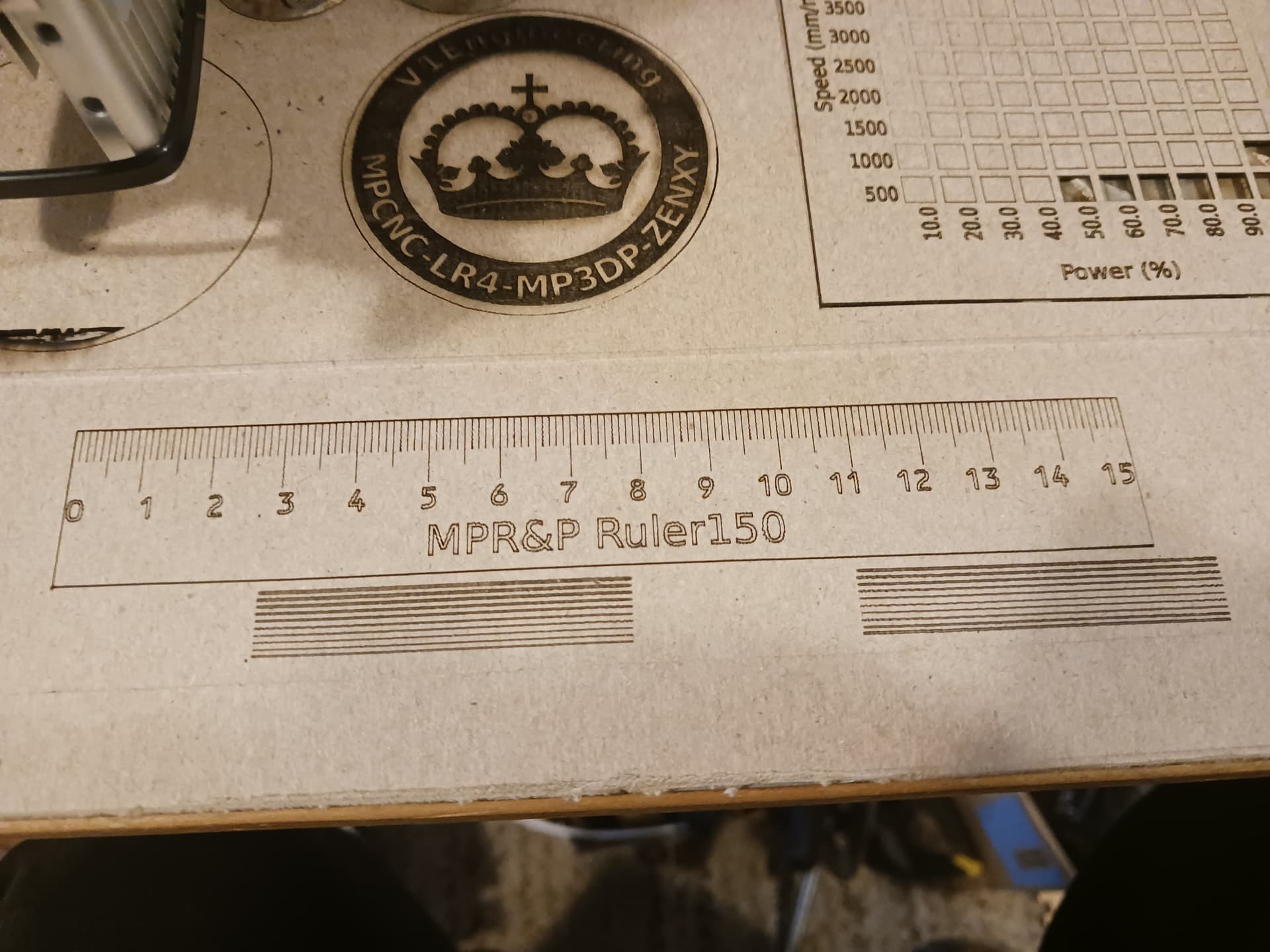

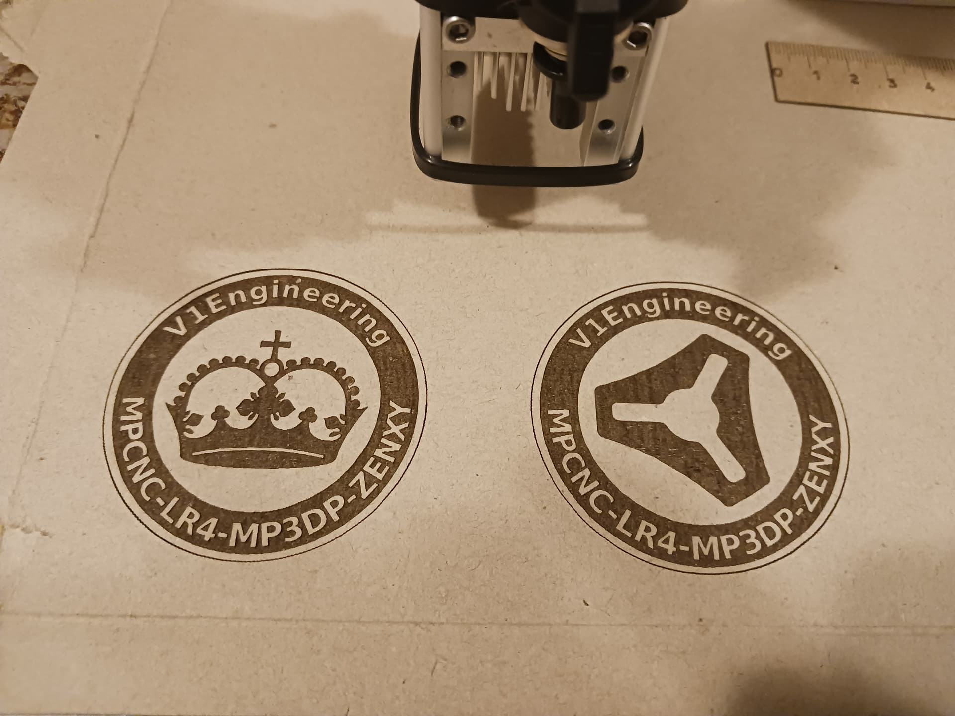

Anybody recognize Ryan’s laser focus gradient pattern? I rewrote the script to be bidirectional but it does the same thing. Also MPR&P had to personalize a ruler…
A couple of the ā€œcoinsā€ I once did… updated LR3 to LR4.
Also, printed off a couple more 10mm leadscrews… this time on my MK3S, to see if a ā€œbedslingerā€ can do it as well. It did.
Later.

You are a laser pro but dang, those look perfect! You designed a hell of a machine.
Oh, how I would like to take some of those samples to SMRRF if I manage to make it, and show them at this years’ RMRRF if my work travel schedule lets me go.
No freaking kidding. Man, David- those things are GREAT!
If we get a LR from someone else to RMRRF, I think I’m bringing my MPR&P V2 to show. I need to finish it. Snap snap! gotta get busy
Thank you, Ryan. Coming from you, that really means a lot. I still haven’t really put the Z-axis through its paces… but it started acting a lot better when I went to 24V on the power supply. I’m hoping someone out there will build one and put a router on it someday… to see if it really is the machine I/we hope it is. Router/noise/debris-averse, I am.

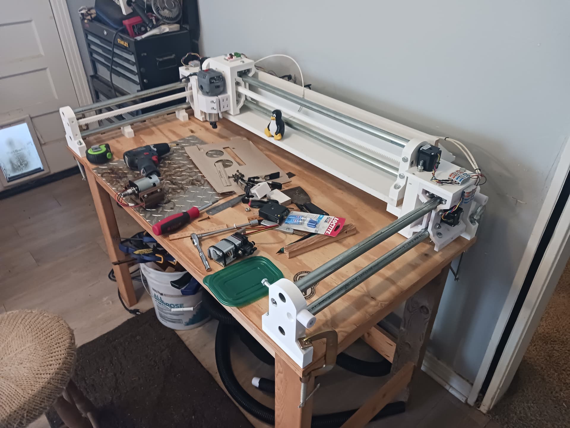

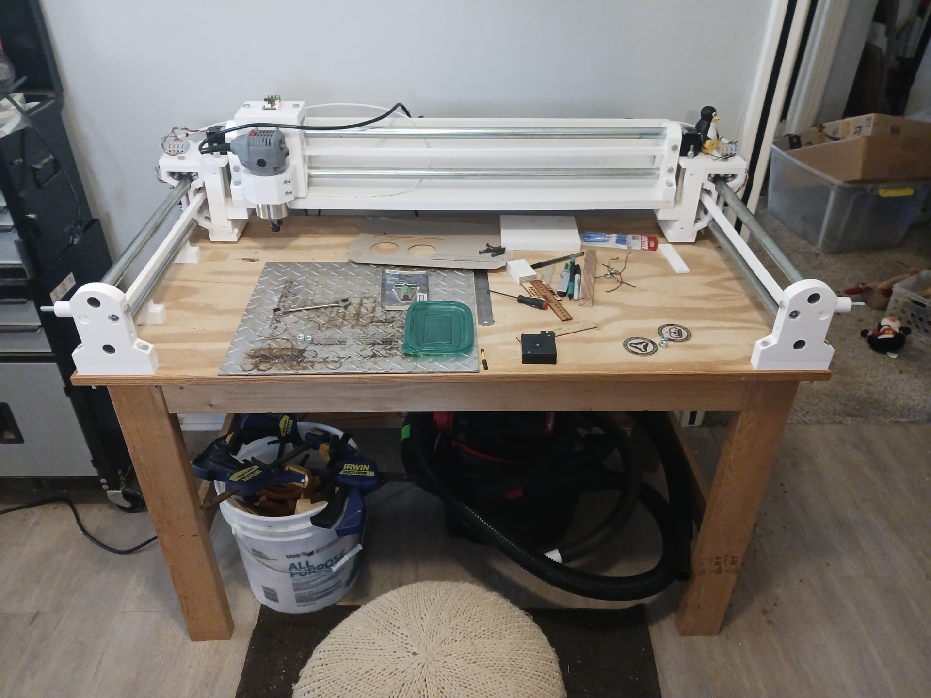

A somewhat pleasant surprise…

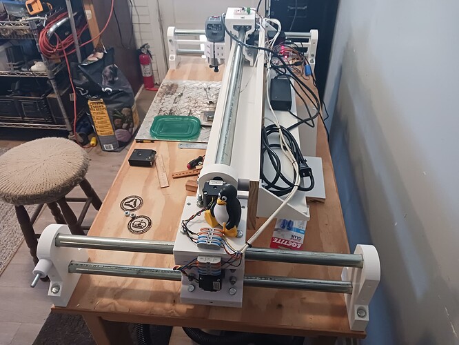

I have the two front supports aligned and clamped with a 4’ ā€œfactory edgeā€ on the 2’ x 4’ plywood table top. Then one side is aligned with the ā€œfactory edge at 90 degreesā€ and fixed with a clamp. The fourth corner is just allowed to float and adjust on its own. I have absolutely no limits switches on the machine. My dual-motor axis (Y and Z) are series-connected, with the X-axis the only single motor axis. My little ~$30 GRBL controller board only has the single XYZ ports and no others… but it does have laser and small 775 ā€œspindleā€ outputs.
Because the front supports are ā€œeye-ball alignedā€ and fixed, I can run the Y-axis to the front and bump the flat end-supports on both sides. I run up close and then make small moves to make contact… when one hits and the other hasn’t, you hear the brief grind on the side that hit while the other side continues to move. Within a small move or two, both sides will be in contact and I’m calling that ā€œsquareā€. For the life of me that seems a valid way to ā€œsquareā€ the machine without limit switches or 5-6 drivers on the controller board. I can do similar on the Z-axis… the identical-as-I-can-print-it Z-lifts have flat surfaces on both bottom and top travel limits and I should be able to closely square the machine in either direction. Am I missing something?
I’m really not trying to justify staying with a little 8-bit GRBL controller board… just making the observation that you can still have a nice, reasonably accurate machine, even if that’s all you’ve got to work with. I have a Jackpot board I got from Ryan… I really could/should use it, eventually. But I’m also interested in checking out GrblHAL… and maybe even LinuxCNC, again.
So, I guess I’m just playing now… not really working. I doubt I’ll ever really do anything useful with MPR&P… but the machine is fun to play with for the time being.
Thoughts? Suggestions?

I"m heading that way!
It’s completely legit to manually square and zero the machine. It’s just damned inconvenient for the inpatient folks like me.
I do still think mounting for endstops would be needed by many users. I’m going to epoxy on a printed mount to mine when I play with it.
If you’d want to… have at it. It’s always that 10% of ā€œuser friendlinessā€ at the end that takes 90% of the time. If Onshape is not your CAD of choice, I can provide STEP files for all the parts you need to add mounts for endstops. I’m happy to work with you on this. I just don’t have the heart to spend a great deal of time on making it ā€œuser friendlyā€, myself.
I’d be happy to throw any 2D stuff/samples into an envelope and send it to you, if it would help. Better, would be for you to get your machine up and running and do your own… but I’d be willing help if you can tell me what you need/want in the meantime.
I’d absolutely love to see you make it.

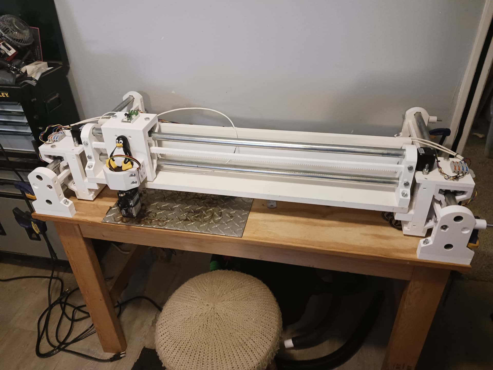

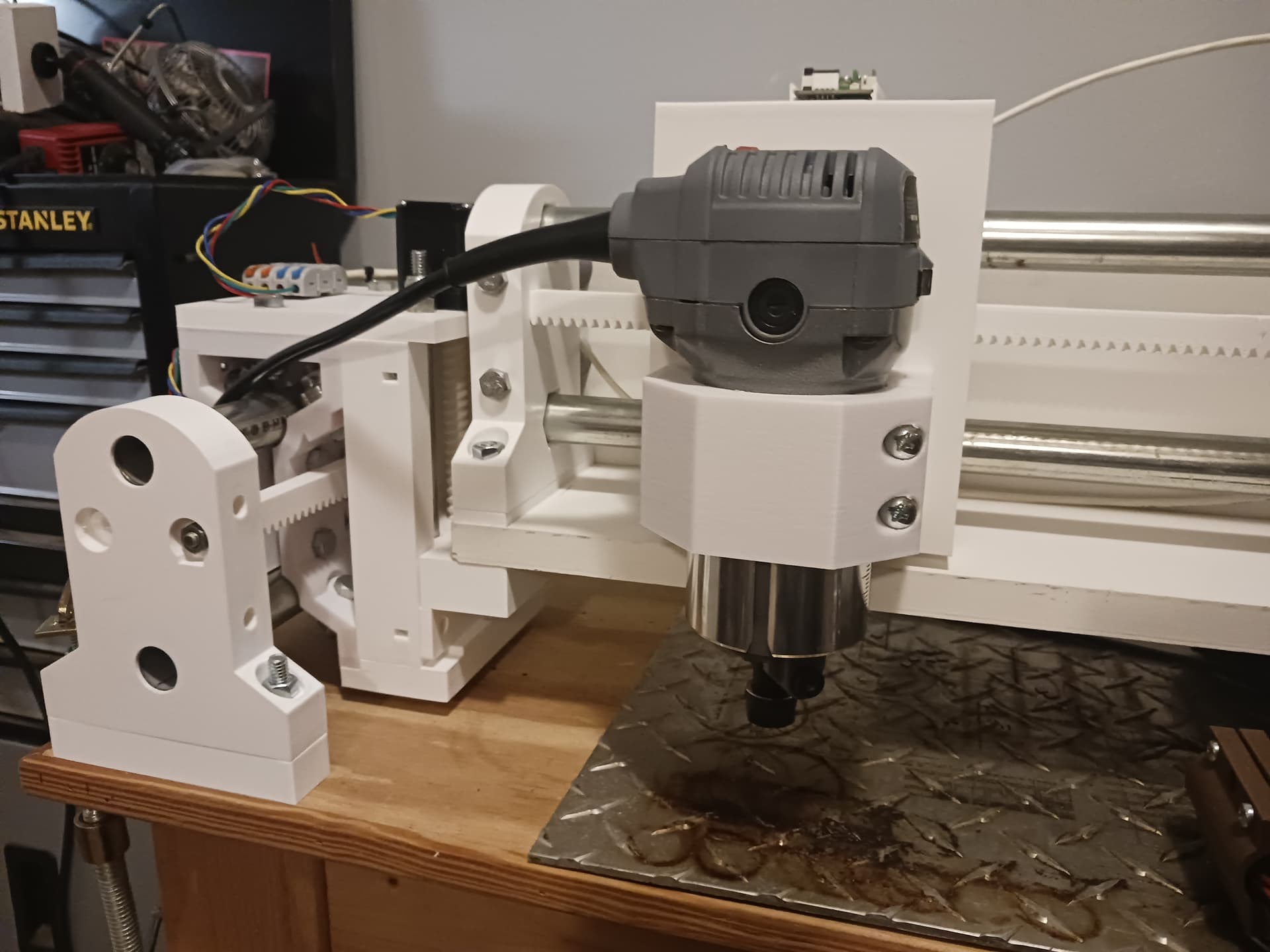

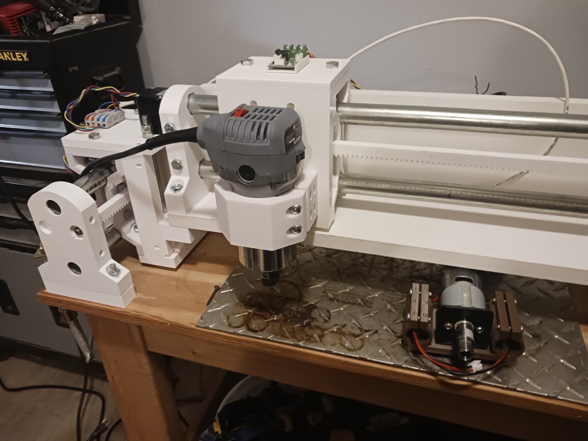

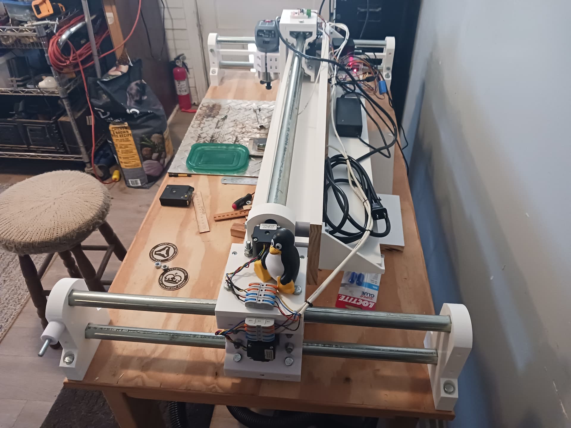

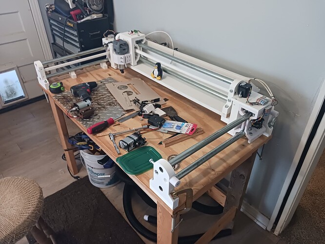

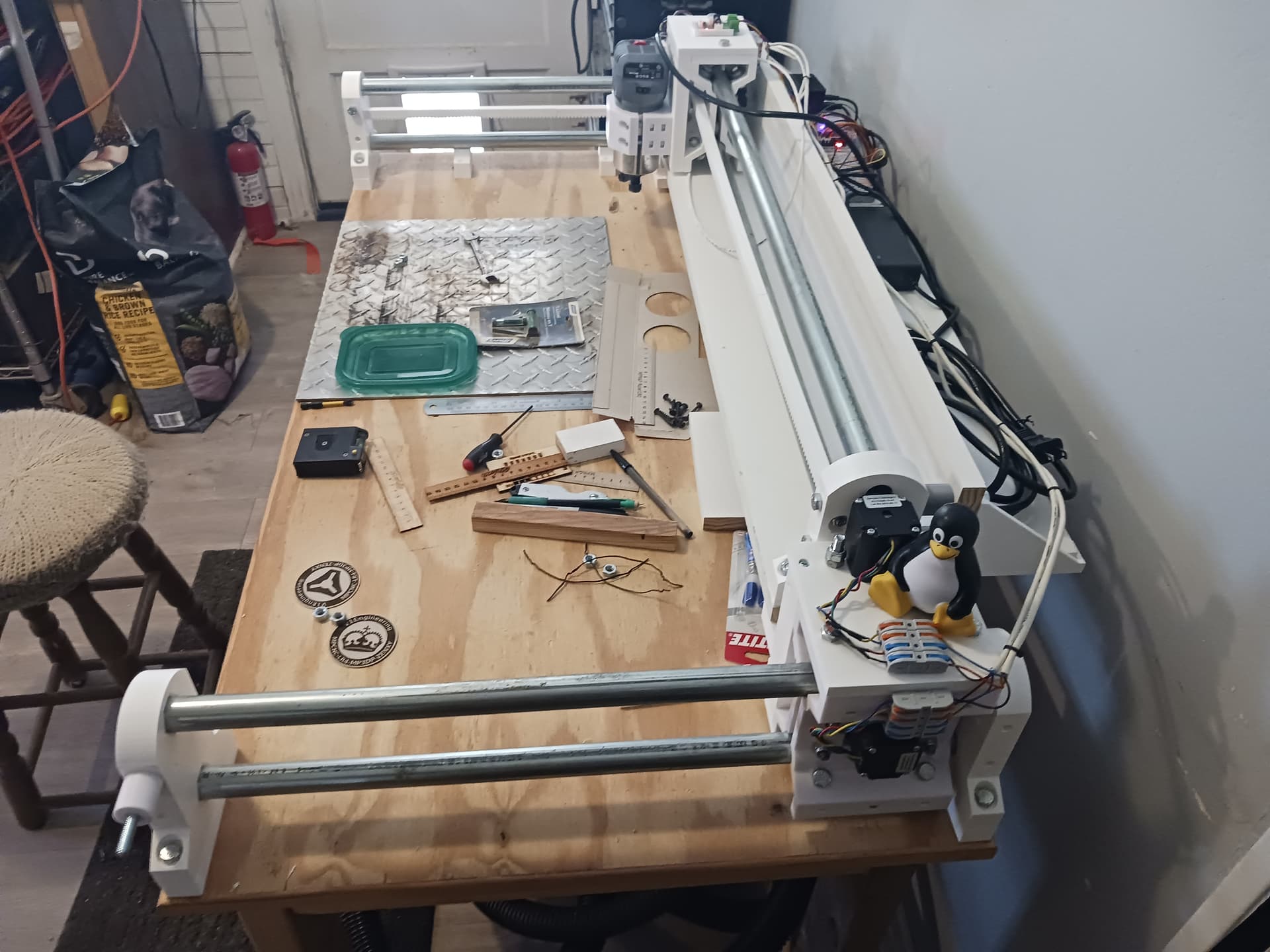

Some progress…

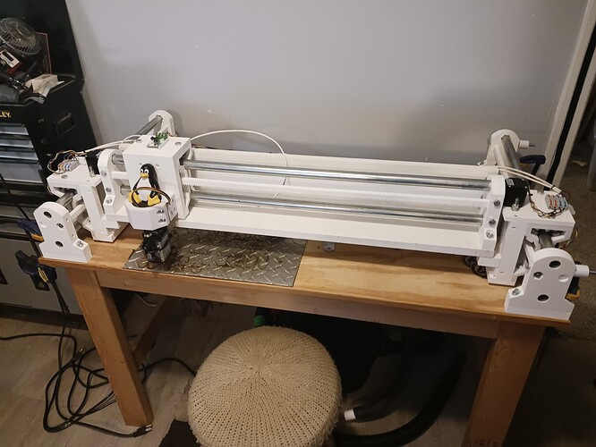

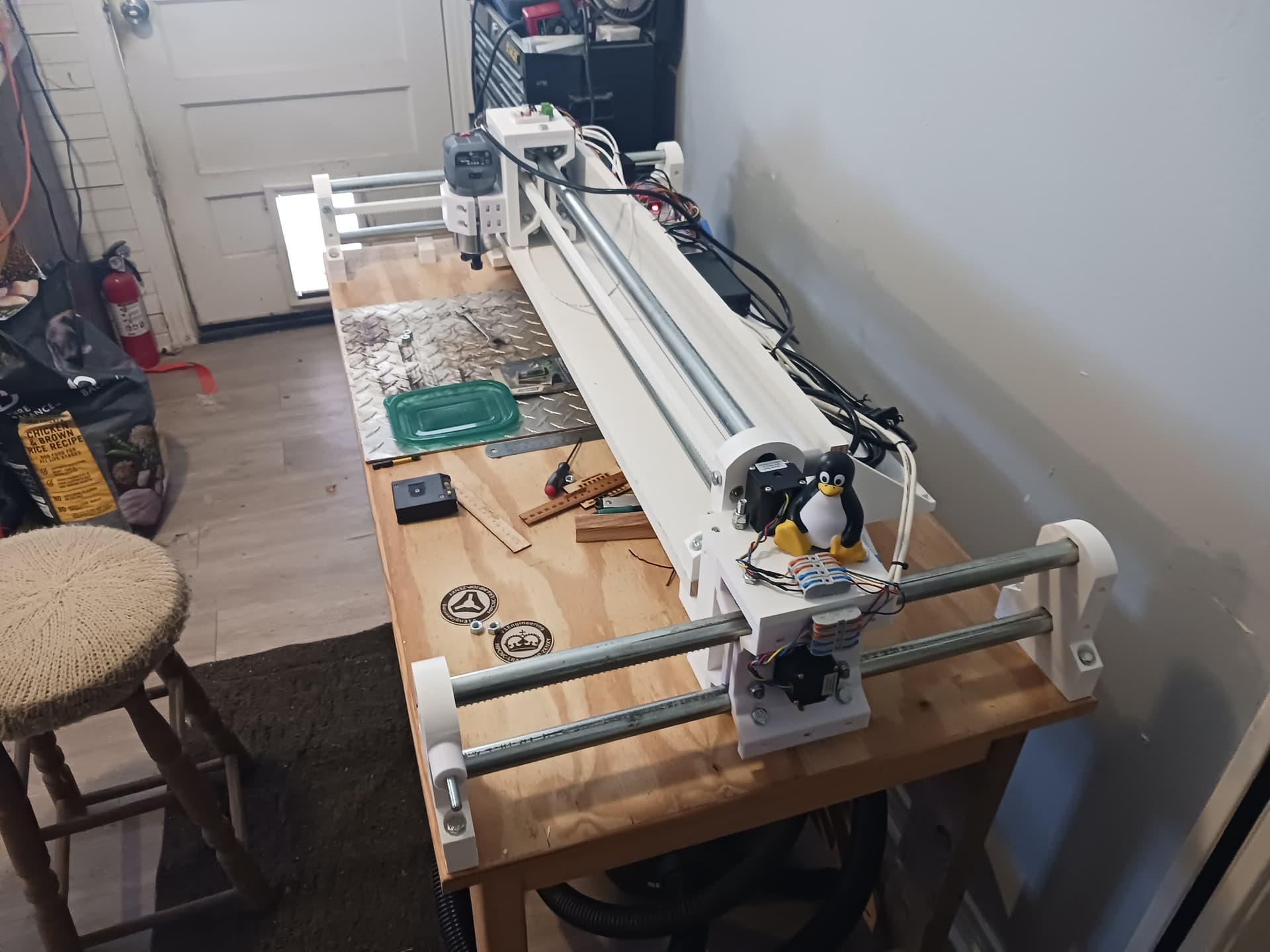

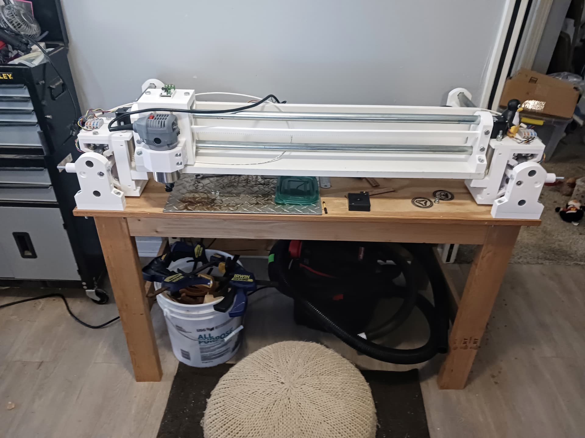

Finally decided it was time to relocate MPR&P-V2 to the spot the original machine sat…
Put the router in place for show…
and finally committed to drilling holes and bolting the MPR&P to the table top. No more clamps!
Started moving the gantry toward the rear of the machine…
and checked that I was clear of the wall in Ymax position…
Final XYZ max work area is about 730mm x 430mm x 120mm with a 24" x 48" (609mm x 1218mm) footprint.
Air-milling a small vcarve job…
I’m really leaning toward going ahead and putting side and back boards for debris containment. I watched Joe Gomez (@joegomez1479) last evening do a test vcarve with his new LR4 and I was encouraged to start thinking I could probably do the same with MPR&P… my hangups be danged.
