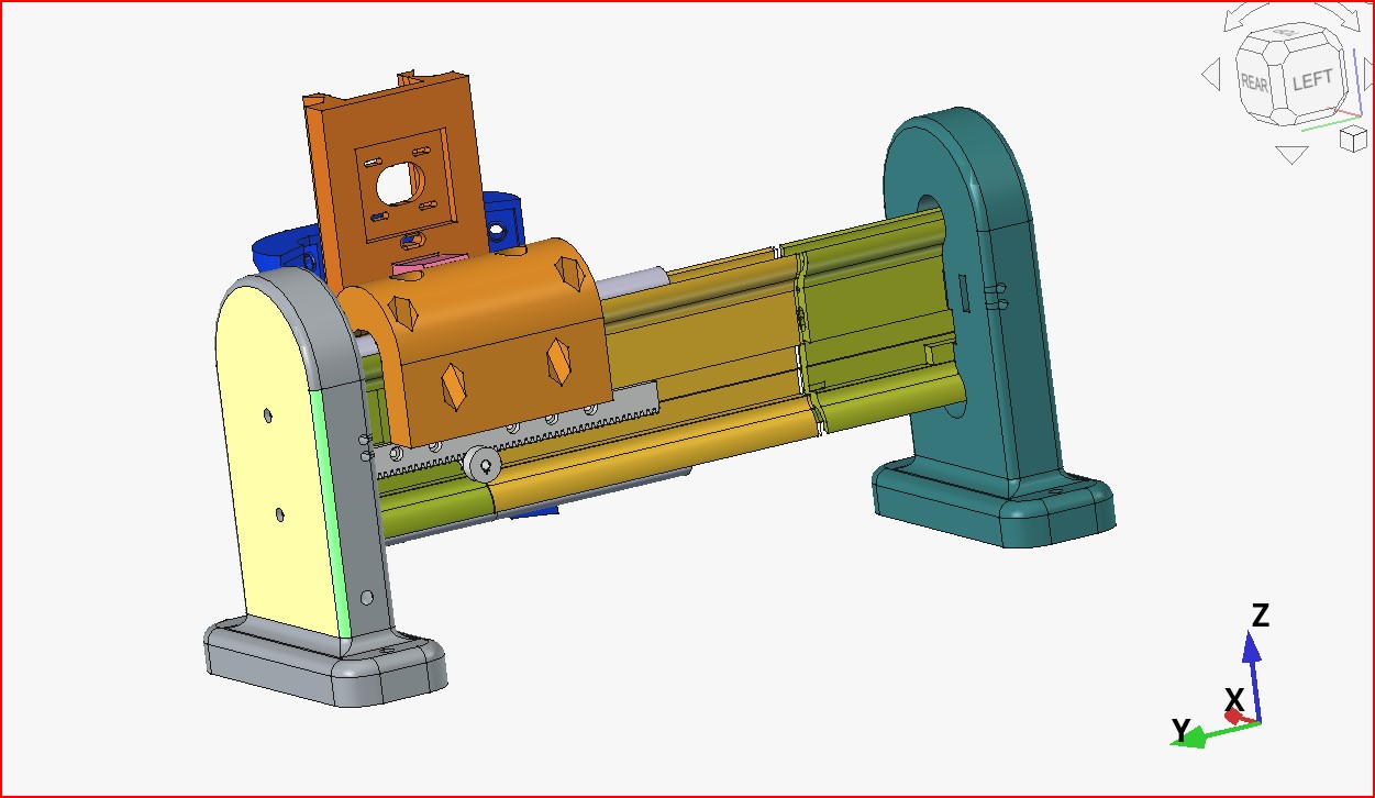

I finally found some time and motivation to re look at the MPR&P, couple weeks ago

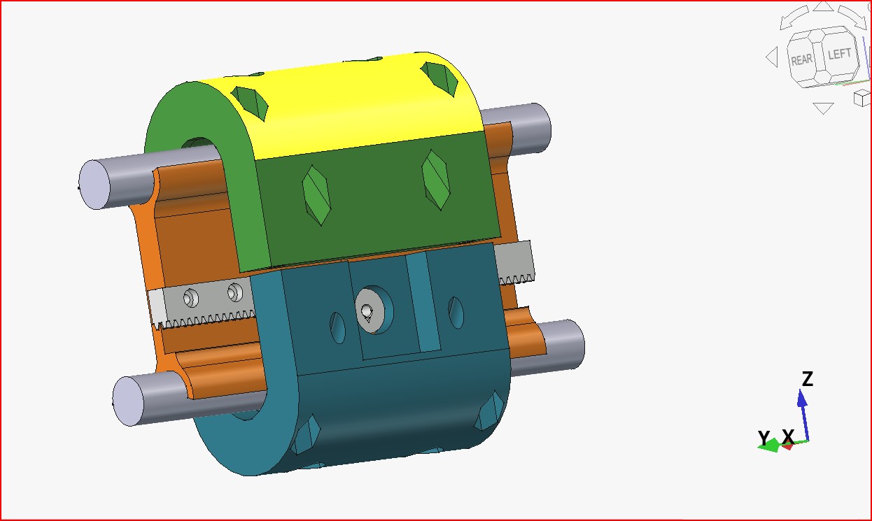

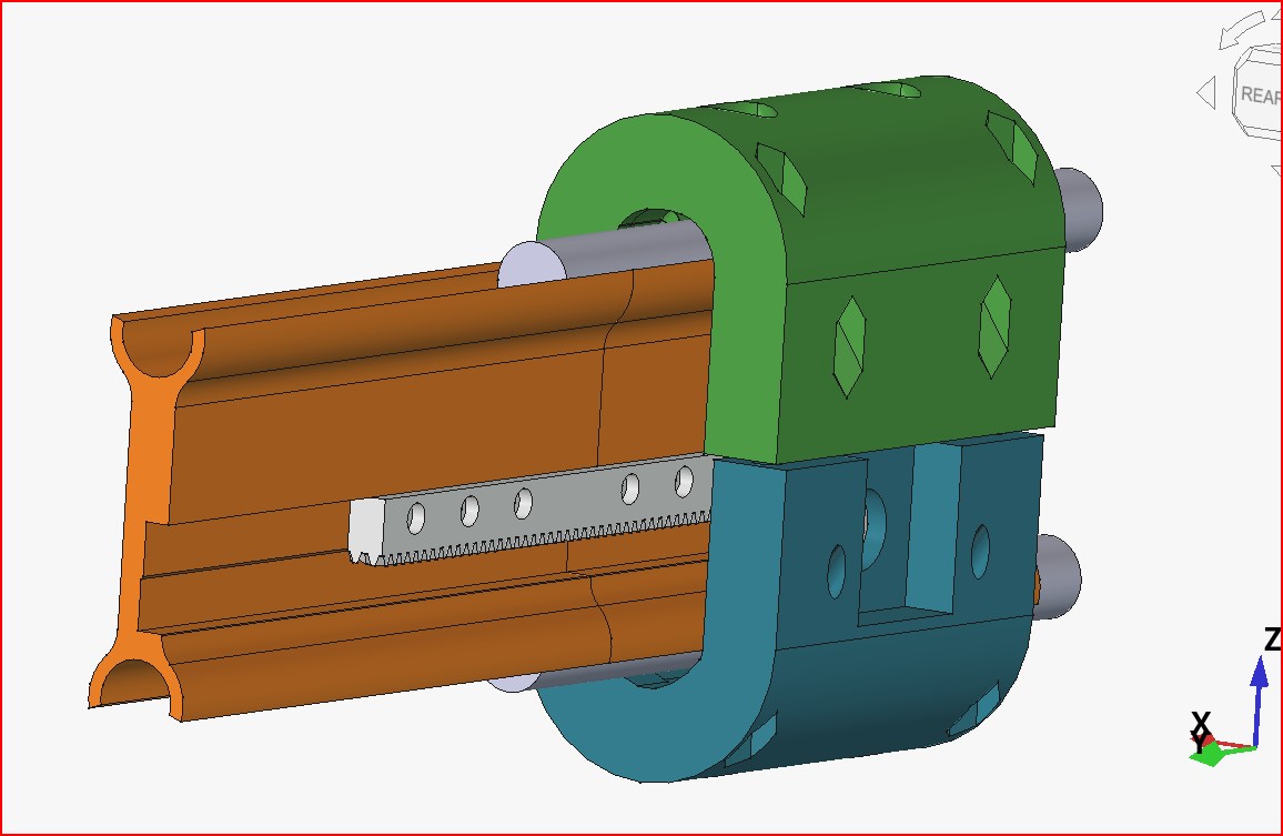

the only reason im not using @dkj4linux amazing tri design, is cant find pipe close to what he used in his design and build the closest pipe has to much slop when on tri bearings

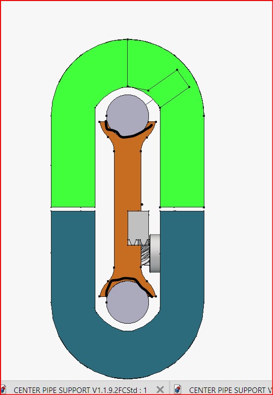

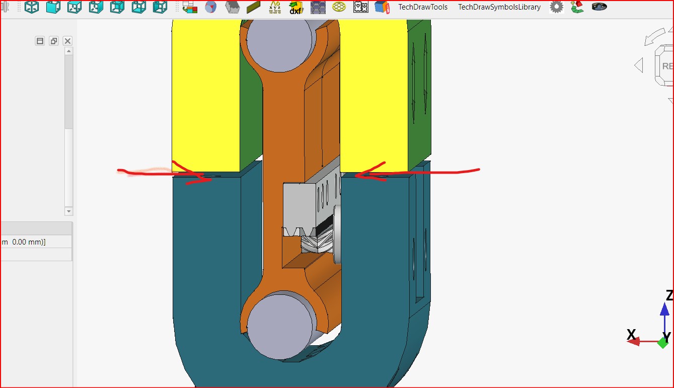

what ive designed so far i actually got some ideas from @dkj4linux using 2 rails
and allowing housing to fit + or- variable pipe sizing by leaving a gap between top and bottom housing that can be tightened or loosened for bearings to sit pipe better
red lines is adjustment gap
by recessing rack im thinking that offsetting it 50% will join the supports together
something like this
ignore the bottom housing being shorter , i just used earlier design for visual , green is correct

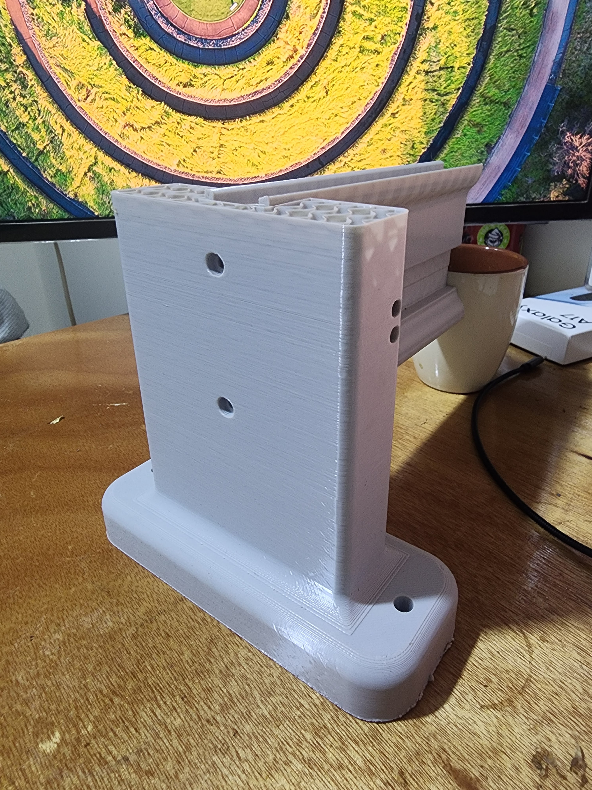

ive done a trial print of what in pic except bottom blue and it all fits pretty good so far
will it work , i have no idea. my bloody head injury has decided it wants to play up again, so may take while for me to reply , and if any of the above makes no scene thatss why

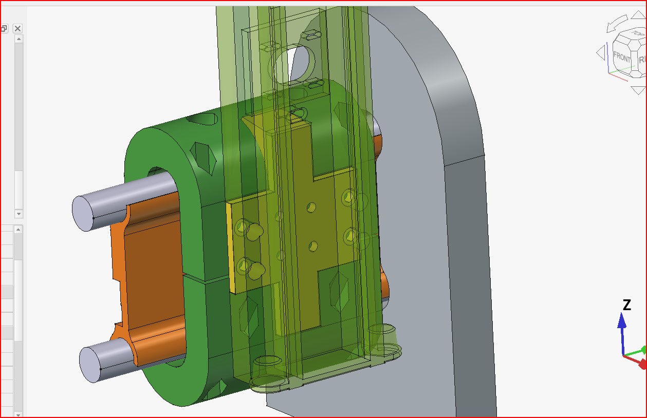

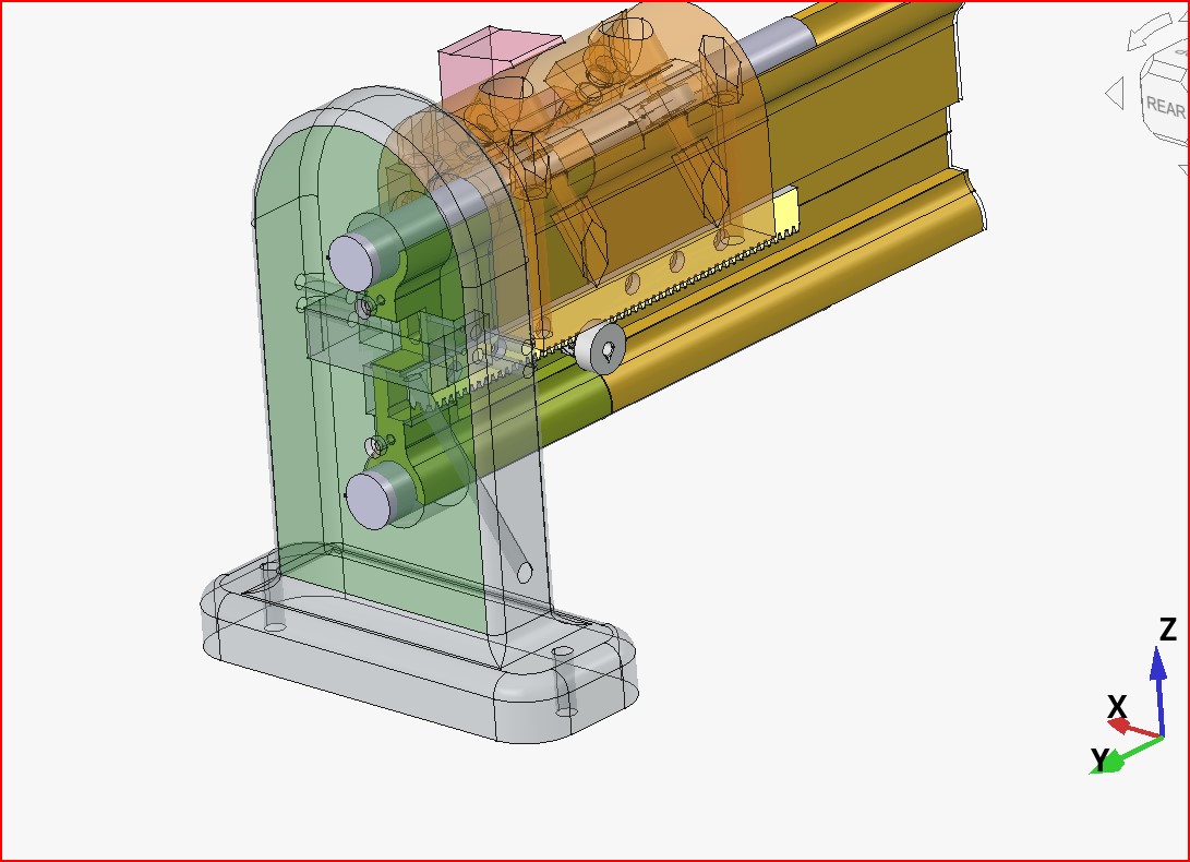

made some changes to connecting housing so it only attaches to top half of core, so still able to adjust bearing tightness on rails
rails and rail supports will slot into end upstands and be fastened together
red pockets for limit switches , black scrwes into ben of support to hold it all together

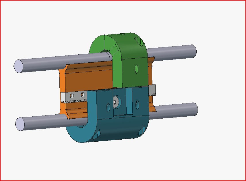

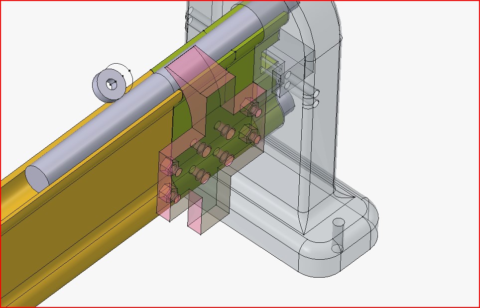

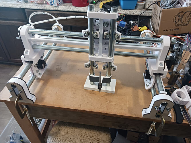

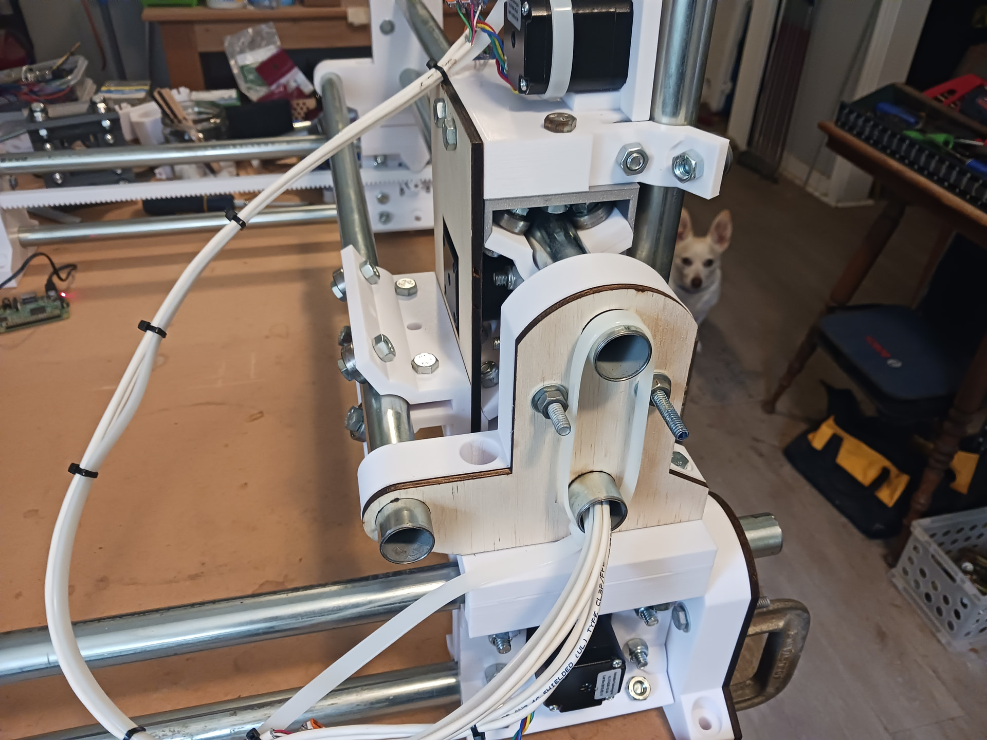

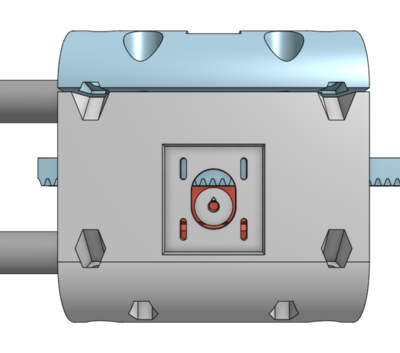

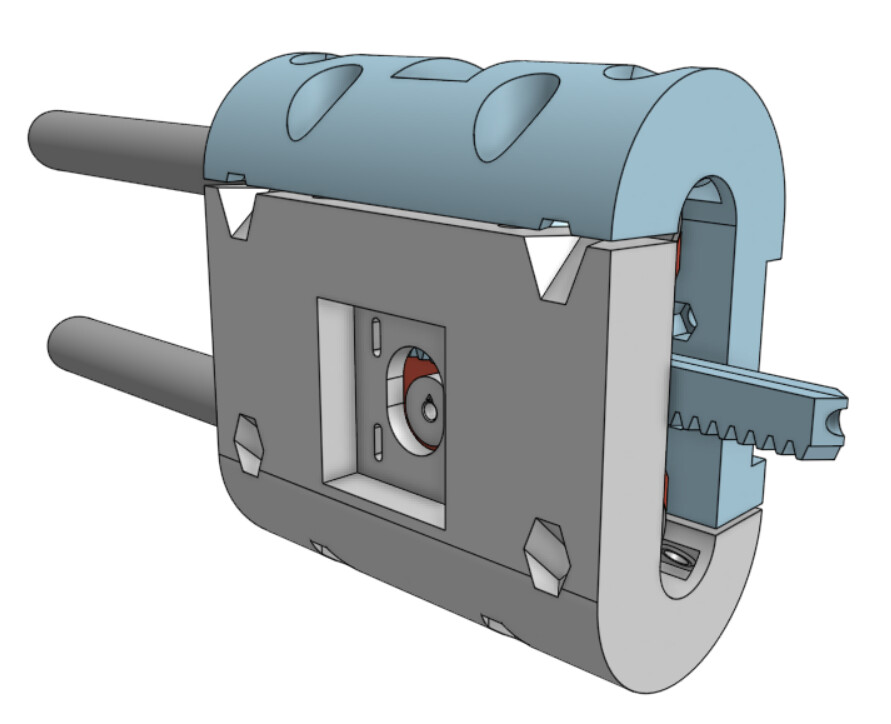

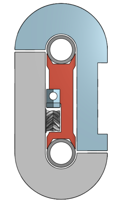

I really like this, Terry. It’s much better than my 2-rail setup on the original MPR&P. My biggest gripe about the V3 and V4 tri-beam setup I’ve been playing with is the overall “bulk” of the machine… and I think your 2-piece wrap-around core idea would work nicely in a rework of the original MPR&P machine. I had a lot of fun with that machine in the brief time I played with it and it actually seemed reasonably accurate in testing.
I also like the 2-rail conduit Z-lift from MPR&P-V3 (that shows transparent in your render) would be superior to the monstrosity of a Z-axis shown in that original machine.
Another thing that I incorporated in that original MPR&P machine – that I’m not really sure how effective it might be – is an “outrigger” 3rd rail on the gantry… which was an early attempt at moving toward a triangular gantry beam.
If deemed desirable/necessary, I think that might still be done with your wrap-around core with the “outrigger arm” bolted to the upper-half core backside , above the motor.
If you don’t mind I’d like to start looking at this. I’ll, of course, still use the 3/4" EMT I’ve got on hand… and I’m sorry that that was what pushed you go down an alternate path. BUT as a result… here we have another fun machine to play with. Also, I’m really sorry that you are having to deal with your head injury as well. You’re in my thoughts and prayers.
Questions: What tubing OD are you actually using for your machine? Also, is that FreeCAD that you are using? Do you mind sharing STEP files when you are comfortable doing so? If so, I’d love to duplicate your core and inner support as faithfully as possible to get started.
Thanks a ton… and take all the time you need, responding.
– David
Hi David
thank you,
I did contemplate one , but thought id just try the 2 and see how it goes
of course, be great for you to dissect it , and point out any concerns with what ive come up with and improve on it
tubing is 22.1mm OD so ends up nearly 3mm difference, I haven’t tested it , but i reckon inch/25mm pipe would work in my design 1.8mm wall so solid as, yip do everything in freecad, yes will share as STEP files

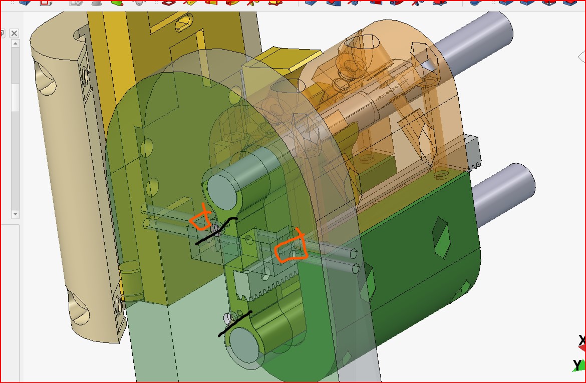

few more changes and improvements or disasters waiting to happen :rofl:

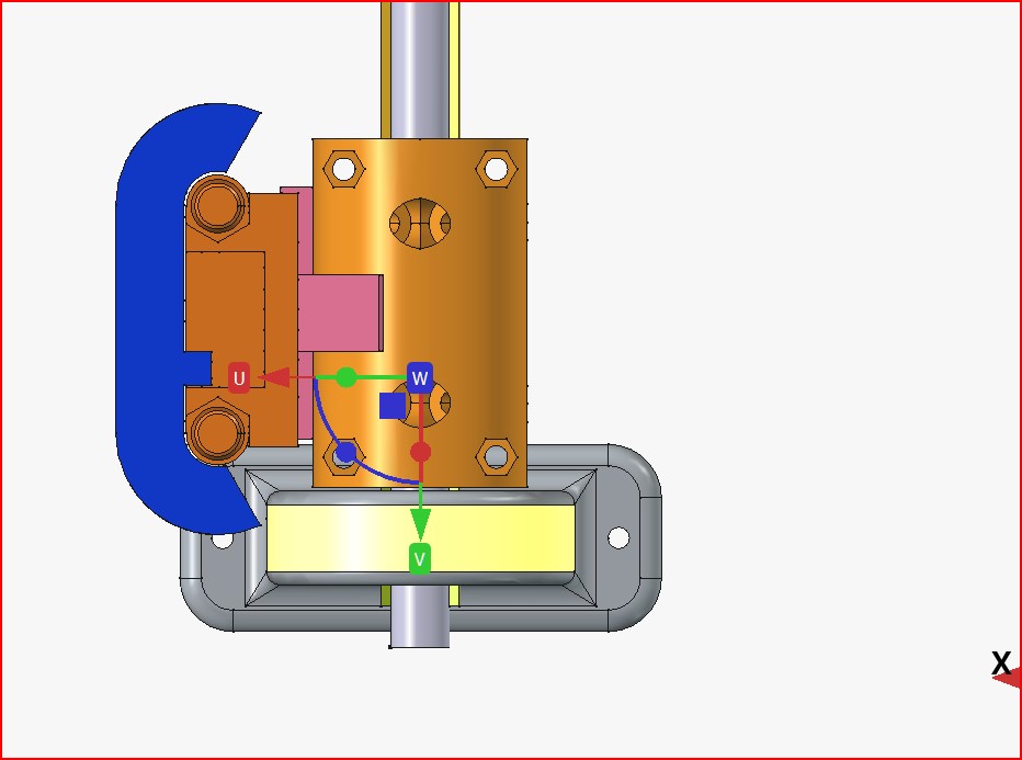

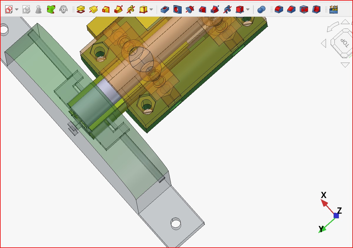

plan is to have jack pot at Y max end, limit switch cables and probe wires run through the oval in middle of rail supports
narrowed down with of end support, just looked to bulky and stupid , added wider base , angled hole on right is wheer probe wires will come out
few more changes to connector plate
after 3hrs of printing realissed i loaded wrong file , no recess for the rack to go into housing ::man_facepalming:
left and right ends , recess in middles is where wires come out step out in bottom is so connecting end screws have some meat to bite into , was thinking of trying out heat inserts in ends
another reason i narrowed upstand is so X core can slide past and Y limit switches can be activated,
just realised i put upstands at wrong ends lucky they fit any end
the recess in end upstands will be mirrored into the blue piece for X axis rails

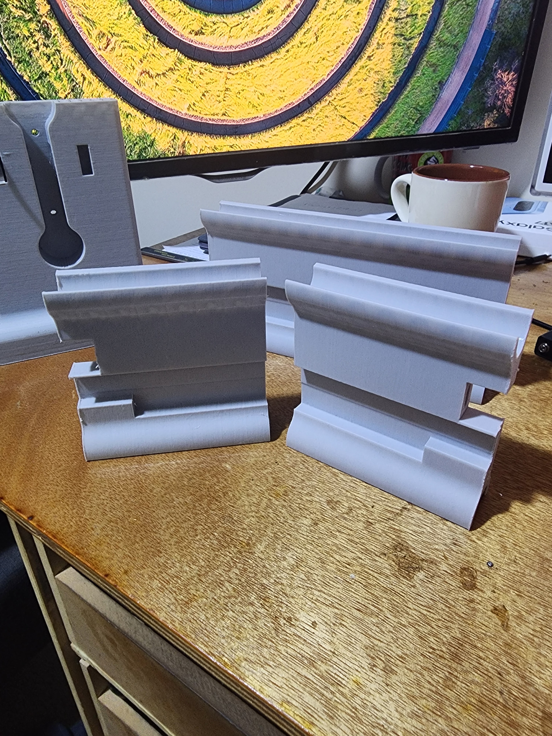

ive printed them in PLA 1 .6 nozzel, 1wall loop gyroid infill at 10% as my trials for upstand and rail supports, they are solid as , both print with no support or brims
core def going need more strength

As I will still be using 3/4" EMT and would have to make edits anyway… please don’t waste time making and posting STEP files for me. The renders you share here in the thread will be fine. And I will start a new thread if/when I actually start a build.

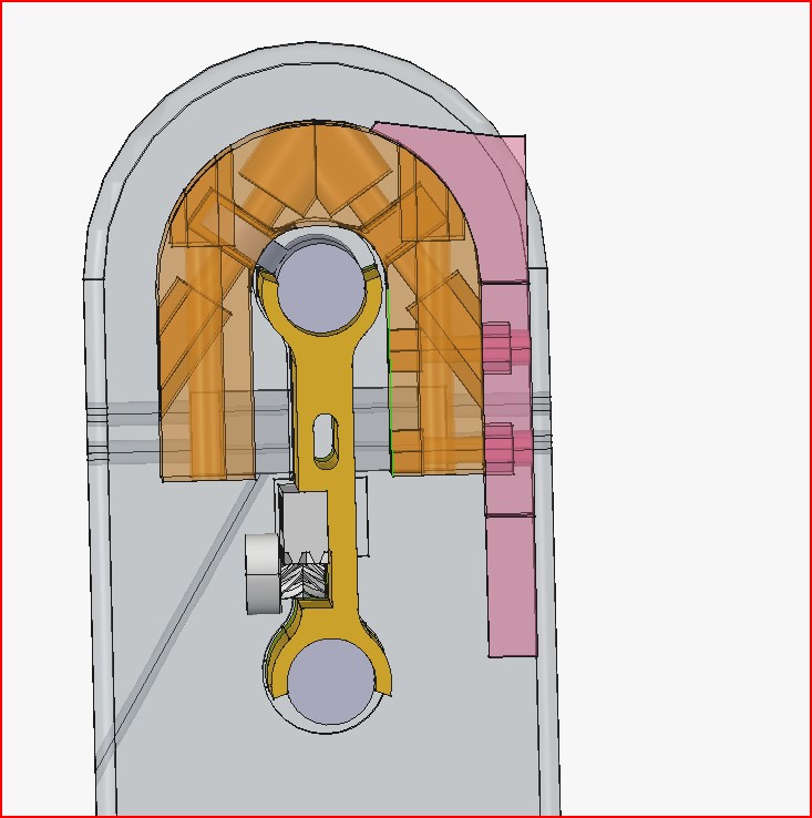

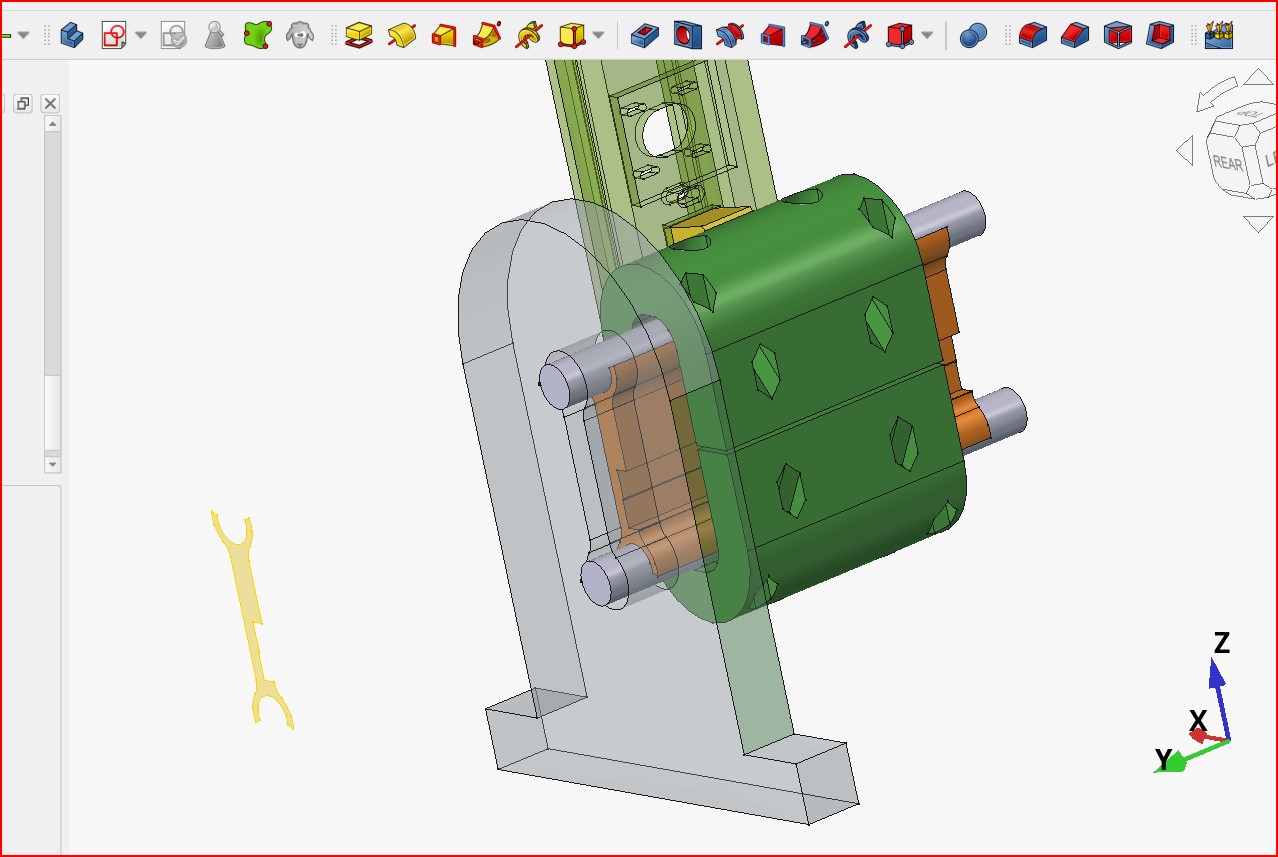

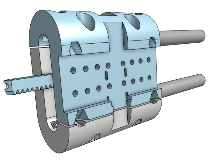

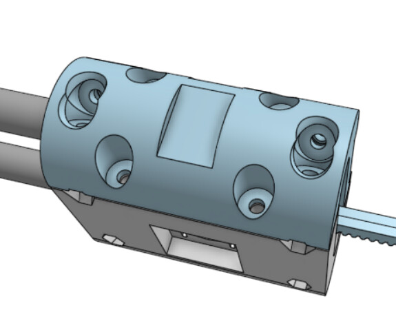

I took an initial look at modeling this in Onshape and started a 2-rail setup and 2-piece wrap-around core that was inspired by your renders in the first post. As I continued to play with it, it seemed advantageous to enlarge the front and back flat faces to make larger mounting surfaces for motors and tooling without the seam/gap between upper and lower core parts running through the middle of the face… so my upper and lower core pieces became more “J”-shaped rather then “U”-shaped.
These are just some initial thoughts and renders for a basic core and rail setup, inspired by what you showed in your first post. If this is of any use to you and/or you have questions/thoughts… just holler and I’ll do my best to help.

Funny my 1st drawings ended up looking almost the same as yours being two Js
the more i edited it the more things didn’t line up in my head so i scraped it
at this point i still dont know if my ideas will work , what looks ok on paper dosent always work in real life

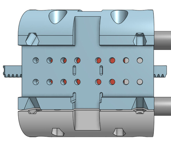

on your front face you have twice as many holes than in your tri version , why is this ?
re using 3/4 emt my thought was u would only need to edit the inner curve of pipe support from 22mm to 23.42 thats from what google says 3/4 is in mm
the below is one of my early screen shots of bottom section with motor housing , if i remember correctly there was enough room to move motor up and down by 2 or 3 mm
another thought which i havent tried yet. is have motor fixed increase height of centre support by 3-4 mm so there is bigger gap below pinion, and have slots in rack so rack can be adjusted to meet pinion , that way any mionr adjustments can be done with everything fully assembled and if say rack needs to be dropped 2mm , you print a 2mm filler to slot above rack to stop upper movement , that is also plan between the 2 U sshapes , once you get it set a spaver is inserted to keep everything tight ,hope this all makes sence
If you not stay positive , you keel over, its like pain , if you think its going to hurt it will , eg had nail shoot out side of timber one day from nail gun , it went into hand top of thumb , i pulled it out , said thiss aint going hurt i have job to finish, masking tape builders pencil as a splint and carried on , it didnt hurt , everyone else on site cringed at the though of it , what do they say no brain no pain :laughing: , yip 7 days a week prob not good , but its all ive ever know from a kid
I try to stay away from Ai and nut out things myself to keep brain active , that’s another reason i started this design, sso i dont become dormant
There was nothing sacred about the face of the tri-version… so with the nice big face on this design I simply to put an array of holes that should allow me to design mounts for lasers, pens, drag knife… whatever.

What I started in OnShape, I’ve now imported into FreeCAD… and I did absolutely no CAD work in FreeCAD myself. After setting all this Caude and FreeCAD-MCP stuff up just yesterday… I now just tell Claude what I want to do. I supplied only STEP files from Onshape and had Caude import the parts, make a few adjustments (he checks fits and clearances as he works) to the parts, go find hardware (stepper motor, hex bolts, Nyloc nuts, 608 skate bearings, etc.) online and install it onto the parts where it goes, create an assembly of everything, create and save STEP files for all parts and the “final” assembly, and save all the FreeCAD documents into its own directory on my laptop. It even created a bill of materials (BOM) of all the hardware and parts in the assembly.I didn’t draw a single line or shape or click buttons (except the View cube) in FreeCAD… Claude did it all and it didn’t even have to take breaks when I did.
Terry, I don’t want to convince you that this what you need to do or force my design work on you. I want you to work at your own pace and do only what you are comfortable doing. If you want to take a look at any of my design work and/or want the STEP files or FreeCAD documents… they are yours for the asking. But I want you to feel free to do your own work and exercise your brain at your leisure and as you feel comfortable doing. This stuff is fun!

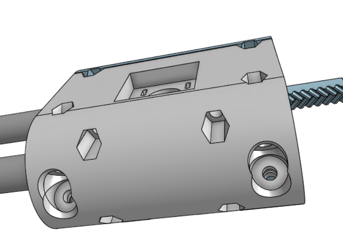

So, my first step… I had a STEP file for a part and simply told Claude to import the STEP file into FreeCAD. Nothing more. I had the same apprehensions as you at that time.
Then Claude came back and told me what it saw…
The STEP file imported into a new FreeCAD document called Lower_core. It came in as a single valid solid, with the object labelled Lower_core.
Size: 76 × 152 × 121 mm
Volume: about 489,495 mm³
The part is a half-cylindrical shell with a flat back wall. The wall has a rectangular recess with a round opening and two slots, plus some small wedge-shaped tabs and holes along the edges.
I can check dimensions, make a cross-section, run an FEM analysis, or modify the part if you want.
So I now had some of Claude’s terminology to use, FreeCAD open in front of me, and we just started having a conversation. I simply told Claude…
In the Front view, the rectangular recess with 5 slots is a mounting point for a NEMA 17 stepper motor. Find a stepper motor model online and place it on the Lower_core.
Claude came back with…
I found a manufacturer STEP file for the StepperOnline 17HS13-1334S: NEMA 17, 42×42×34 mm, 5 mm D-cut shaft. I'm downloading it on the FreeCAD machine now.
I placed a NEMA 17 stepper (the StepperOnline 17HS13-1334S, 42×42×34 mm) in the recess, colored blue in the Lower_core document. It sits flush on the pocket floor with no overlap with the part.
And we kept chatting with each other from there. We were looking at the same thing and talking hex and round recesses, slots, shapes, etc. I simply told Claude what hardware the recesses, holes, slots were to receive… and then go find it online for me and put it in position on the part. When we finally got something that I thought looked “workable” and Claude agreed… we’d go on to the next part and eventually we had completed an entire linear stage.
Another real benefit of this over me doing it all myself is that Claude was also checking alignment, fits, clearances, dimensions, etc. as it added parts to the model. As it found issues it would point the problem out to me and recommend possible fixes. If I chose to let Claude make the change… it would actually set up scratch area to make and test the modification, and then ask if I wanted to modify the real part. On a couple of occasions, I actually told Claude specifically how I wanted to fix it… and again a scratch area was set up, the modification applied and tested, and finally applied to the real part. I would never have been able to do this kind of stuff on my own.

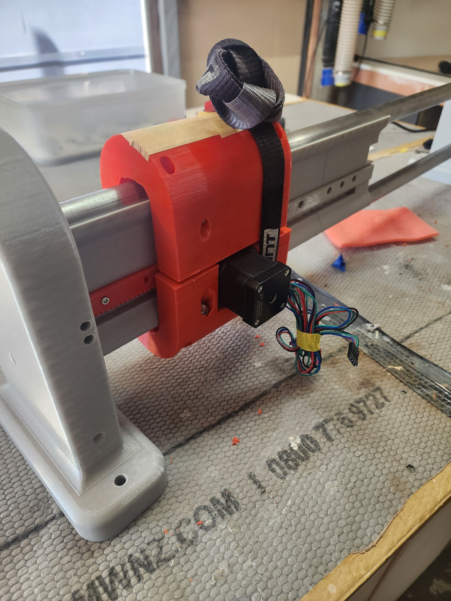

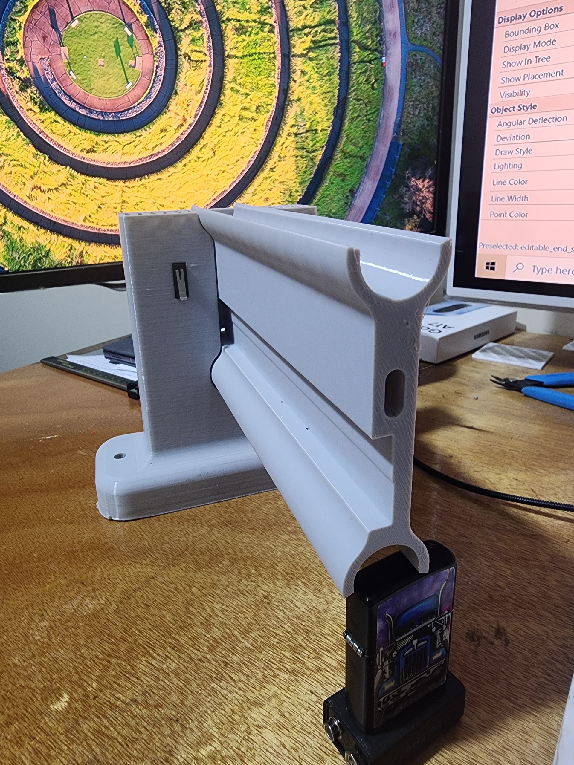

thought id do quick trial before printing any more pieces top half is one of my early trials , bit short thats why its strapped together , but it moves :partying_face:
There ya’ go!!! With R&P drive!!! WOOT!!!
now its at a grinding halt
,3d printer threw its toys out :frowning:
