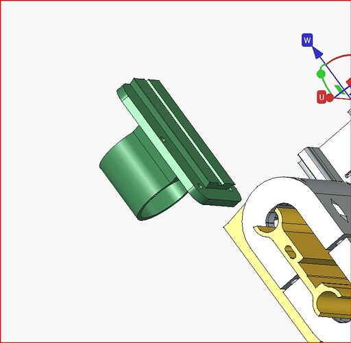

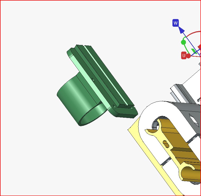

pushed out the Z core a bit to allow more depth for limit switches pipes etc

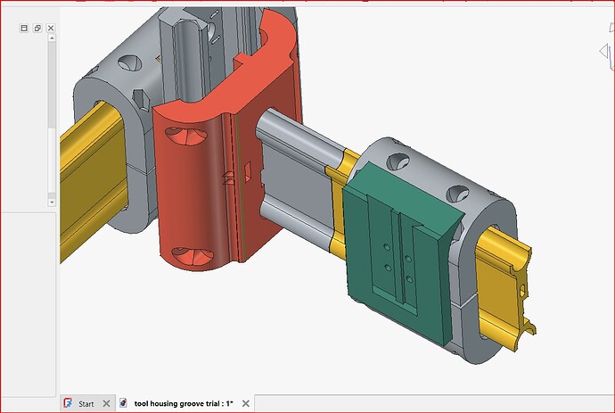

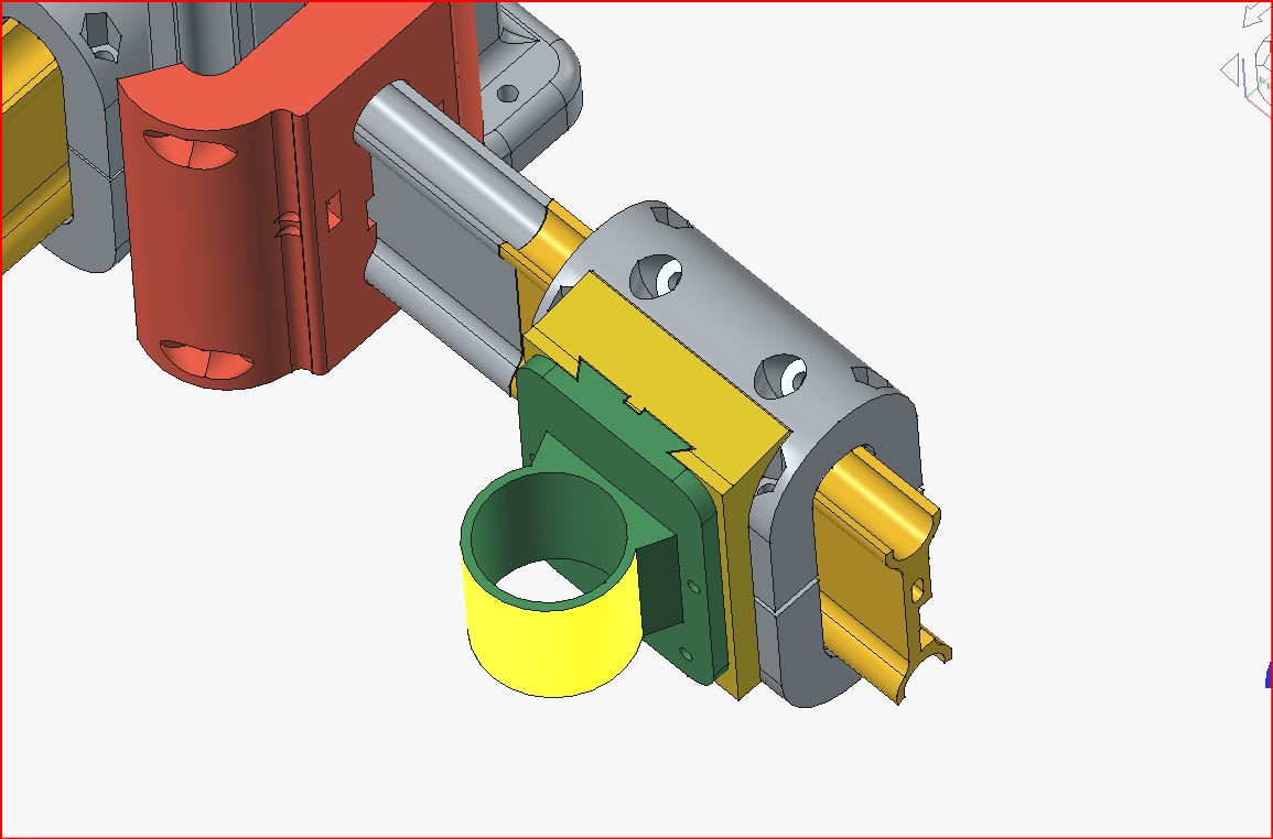

also playing around with a v slot for tool mounts to slide into, undo 2 screws and you can swap from router to laser or what ever and no offsets to change
just had crazy thought a mount for an orbital sander , cant see why it couldn’t work as a sander works more effectly with min down pressure , run it dial 2-3
cylinder is only for visual to see where the cap screws will fit , the new printers going be working 24/7 when it finally arrives :slight_smile:
