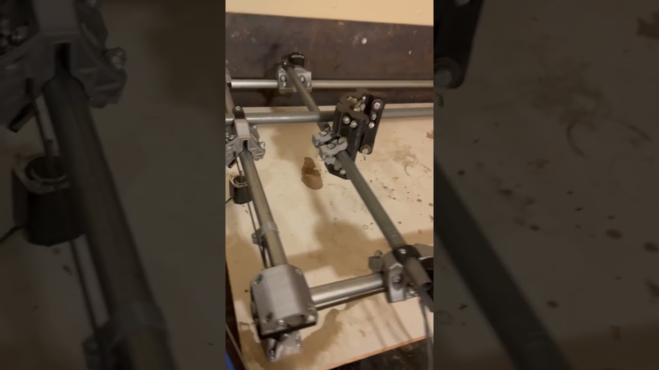

Mpcnc primo steppers movement
yes all 4 end stops work correctly
YES tats correct x-,x+ both moving right , y- both steppers moving down but y+ the y2 stepper is moving the opposite of y1 stepper tried to flip the plug no difference like i stated before if i plug all my steppers in my skr 1.2 pro board all works perfect

ok i took all the steppers of the build an plugged them in the board an the same thing [ x+,an x- both steppers going clock wise] [y+ both steppers going clock wise , y- y1 going counter clock wise y2 going clock wise
I did a reflash erased everything an started fresh 3.9.1 mpcnc config file v2 an still the same problem I’m lost now lol

Idk wer the problem is either I think it’s the board if I swap the 5 drivers an 5 steppers to skr board everything works the way it should
Okay so which port exactly?
so if everything has moved and been tested on another machine, steppers, wires, drivers. There are 5 ports on the jackpot board we use. I am assuming it is always the same port, which port is it X, Y Z A B?
x,y,a,b the z i can move both ways

in the video if u watch the computer < x+ moving right an the x- moving right aswell > < y+ both steppers moving down y- steppers going opposite direction >
I am still unclear what that means. I am asking what ports are not working correctly. Take one stepper, plug it into each port and try to move that axis both ways. Make a clear list and tell me what happens to each port.
