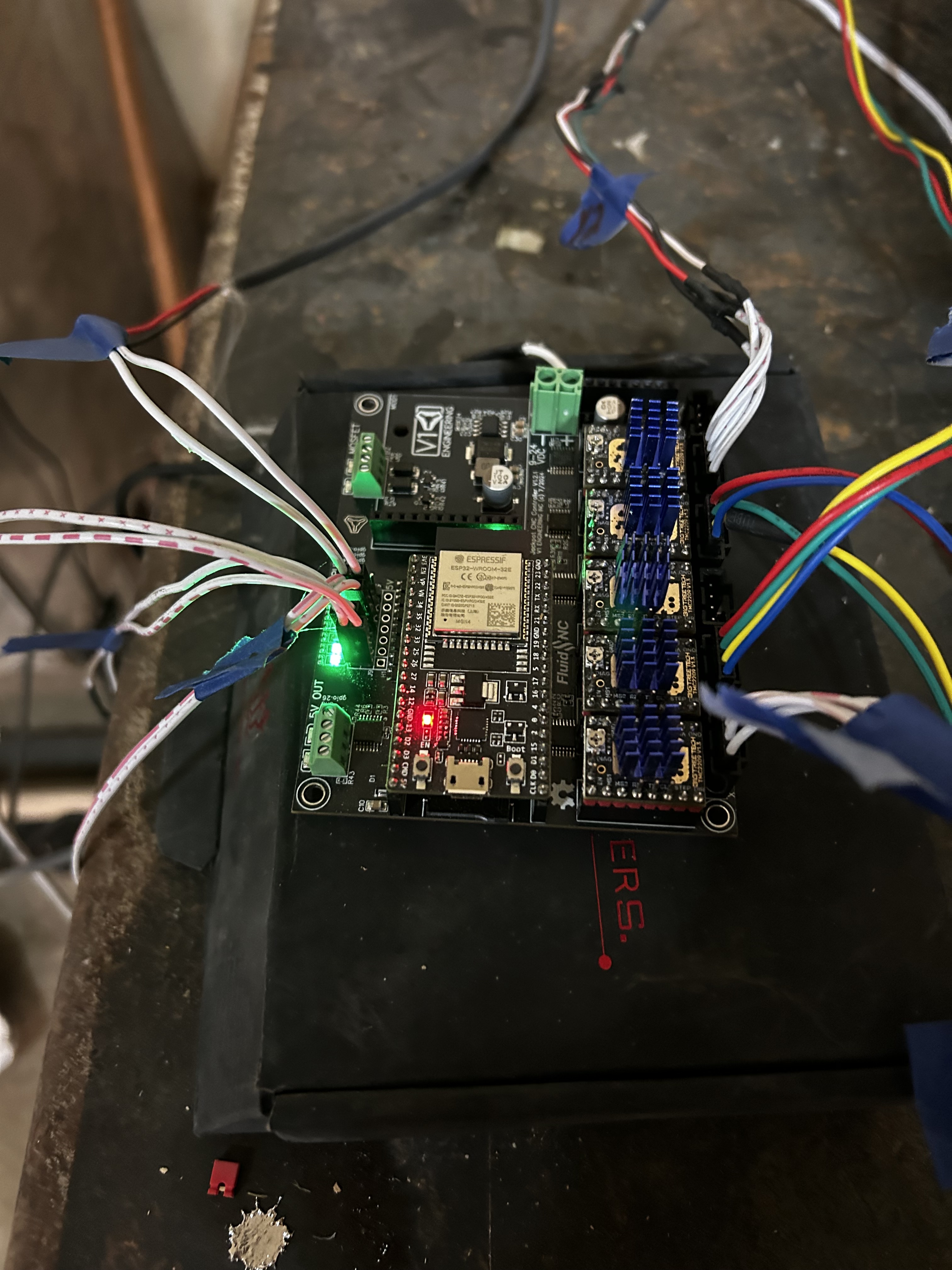

I have not tested this one, 99.9% chance I did not put that on your board.
Can we see a picture of how you have it wired up please.
what version is the correct one than i just installed the version from the site britt put in the link i used the latest version
https://youtube.com/shorts/QCNgvZyDTaI?si=nkOxKTp0QFfHo8aG an I switched it back 3.9.1
Looks like at least two of your end stops are triggered.
ter r 4 lights on i dont have the z stop plugged in i can home y1 an y2 they hit the end stop an stop
What happens to x1 and X2? How are you trying to move them?
i got them to move together , no more grinding but x- an x+ move the same direction
Power off completely. Change the x drivers for Y drivers. What happens?
still only going one direction
Power off completely, plug the Y steppers into the X drivers, what happens?
I am not really sure how this can happen, the X1 and x2 drivers are on different uart chips.
Do all 4 endstops function and trigger the lighs on the jackpot?
still going the same way yes all light are on wen not triggered wen tey r trigger tey go of
Please be more concise.
Which steppers go the wrong way? Do you see what I am looking for here. Does the issue follow the wires and steppers or the driver plug?
the y steppers tat i plugged in the x drivers are moving right wen i hit x- an right when i hit x+ aswell
would it help if i would plug the board in my computer an u connect via team viewer
1-So the problem is with the driver port of the board. Meaning no matter what drivers or wires are plugged in the same exact ports on the board are moving wrong?
2-Do all 4 endstops work correctly?

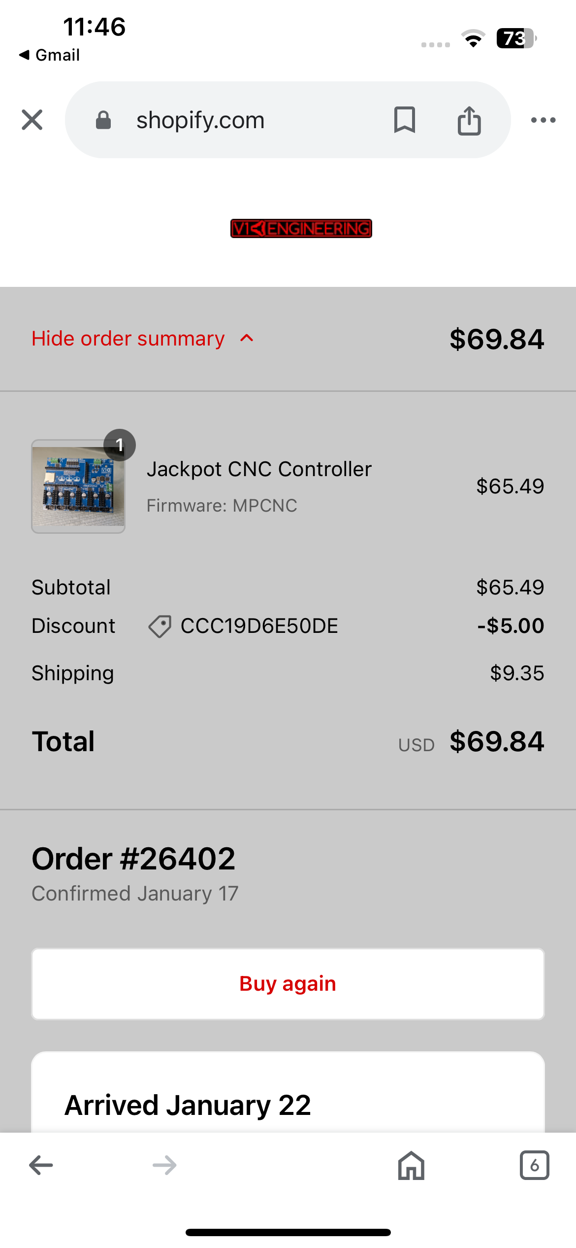

3-Did you buy this from me or Elecrow?
No
