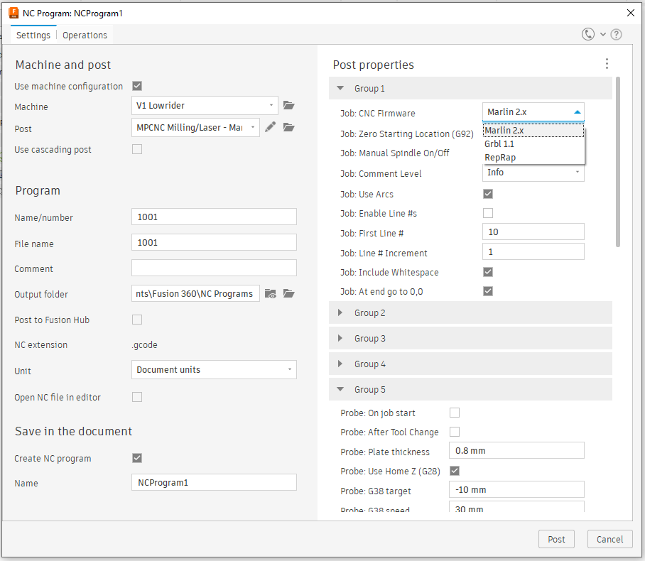

P.S : I have tried the Fusion Post processor (beta3 from Don) but in Fusion I can’t choose what firmware I’m using for this Post processor.
The flyfisher pp is the only one I’m aware of that’s been shared publicly.
Thanks!
But in Fusion, how can I choose between Marlin and Grbl, when I install the pp? How can I tell to fusion what firmware am I using?
From the documentation:
Use the Job: CNC Firmware property to select between Marlin 2.x, Grbl 1.1 and RepRap firmware
Disclaimer: I don’t use Fusion cam so no idea if this works
