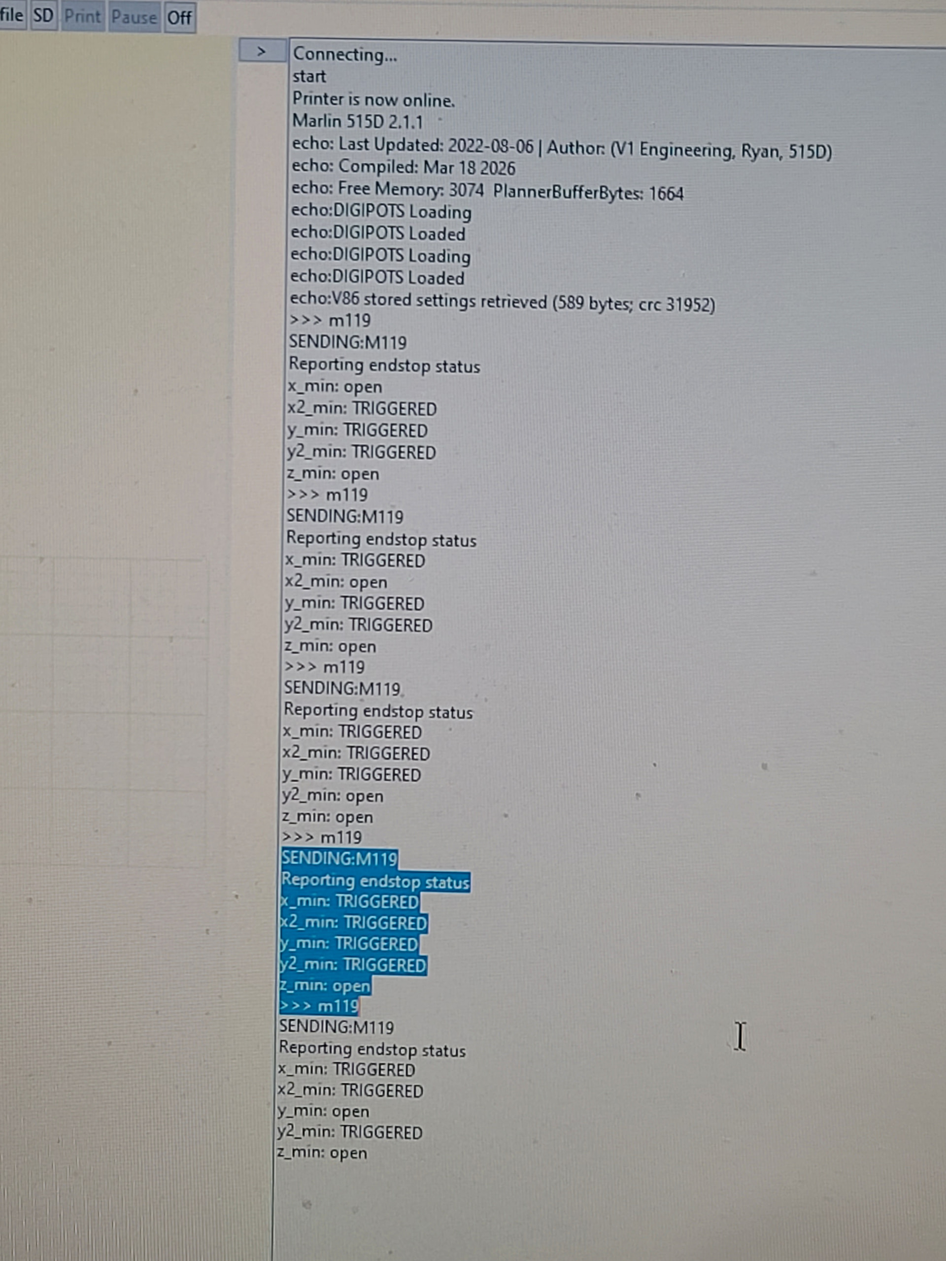

What I’m unsure of is triggering just one, and how to do it.
Physically press the arm on the limit switch until you hear the click, then hold it there while you run M119 again
Oh, sorry. I thought you weren’t sure what flipping state meant.
Just use your finger to press the limit switch arm.

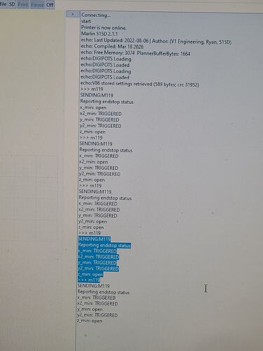

I fially had some time to get this done. Ignore the highlighted section. My switch restraint slipped off.
Here’s the results:
Looks like when you press a switch it goes from TRIGGERED to open. That means either your firmware is defined wrong (NO) - or you limit switches are wired NO instead of the NC we expect.
I thought we had verified the wiring with a DMM, but if we haven’t now is a good time to power off the machine, pull an endstop wire connector at the Rambo, and probe the connector with a DMM.
I expect the switches to be wired NC, so you should see a short until you press the switch and then it goes open.
Your machine is 100% behaving (and reporting) that your endstops are wired opposite from what it expects.

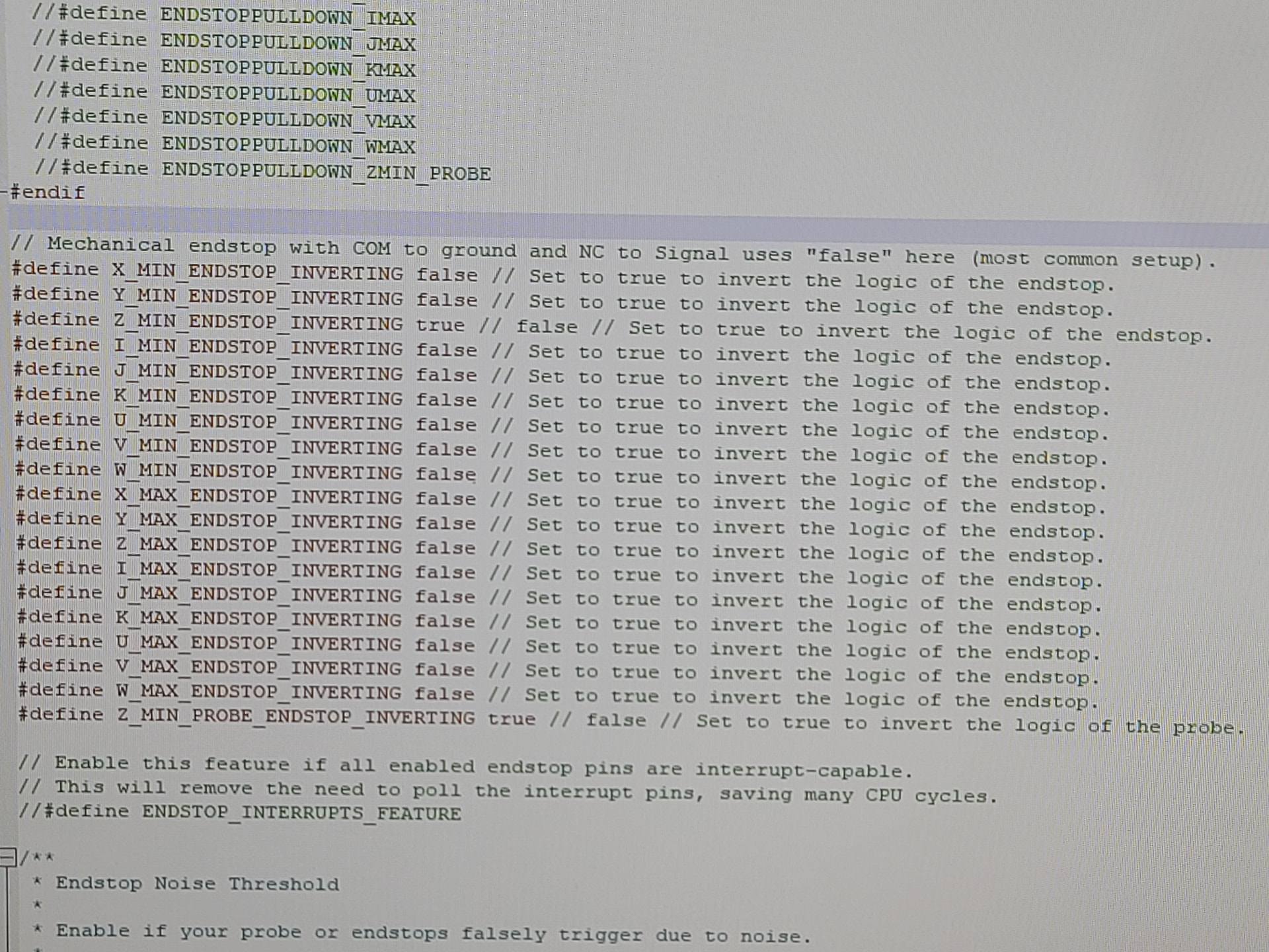

I’m pretty sure I’ve done the switch test a couple times already, so let’s look at the firmware 1st. If I’m reading this correctly, it’s telling me it’s set for NC?
That looks correct to me. Can you post a picture of how your endstops are wired? Wires should be on the outside 2 terminals and nothing on the middle one.
