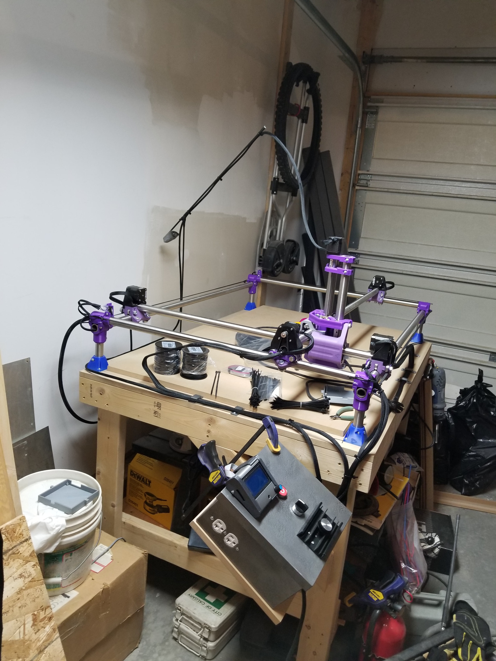

MPCNC original model from 2019 firmware
Hi Tom … Thanks for the input. I reconnected the board after flashing and now have all steppers running. (Bonus) That said, I have a small problem in that the X axis is running the wrong direction. It should be a small fix in config.h. I believe It’s just reversing the direction. In writing this, the section name eludes me as it is late here, but I did find it. I’ll reflash and try again. I failed to realize this sets the axis coordinates as if it were a 3D printer, as opposed to the way I want it to home.

I’m happy to say the main problems I was facing are now solved. All steppers are now moving, and in the correct direction. I imagine with a little research I can figure out how to set home position for X, and Y. At the moment, when I select auto home, each axis moves about 20mm and then stops. I’m thinking it needs to be told where absolute home is. Am I on the right track?

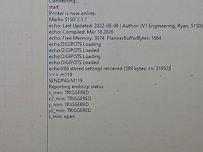

Turn off your machine, Move the machine SLOWLY by hand to roughly center in X and Y.
Turn on the machine, send an M119 in the terminal. What result do you get?
Sounds like your end stops might be wired incorrectly. It thinks it is homed everywhere and is backing off to do the final position but the end stop triggers dont change. Did you wire to the NO pin or the NC pin on the endstop switches?
Exactly. That’s why I asked for an M119- to see what Marlin is reporting for endstop condition.
It’s wired NC. All connections are correct. This I do know for sure.
I’ll give this a try, however all endstop limit switches are wired correctly via the NC position. I’ll see if I can get my old laptop to cooperate, which may take some work. I just can’t justify taking a high end laptop to my disastrous garage.
That would be a good result if you can.
It doesn’t just matter what you measure, it matters what the controller interprets things as.
You motion is behaving as if the controller sees the endstops as triggered.
It could still be a firmware problem, so that’s why we need the M119 report from the machine.
X, and Y both return as Triggered. Including a pic of the screen.
All four returned triggered.
If you press one manually and re-send the M119, does one flip states?
I’m not sure I understand what you mean?
If it flips state it would say open instead of triggered.
