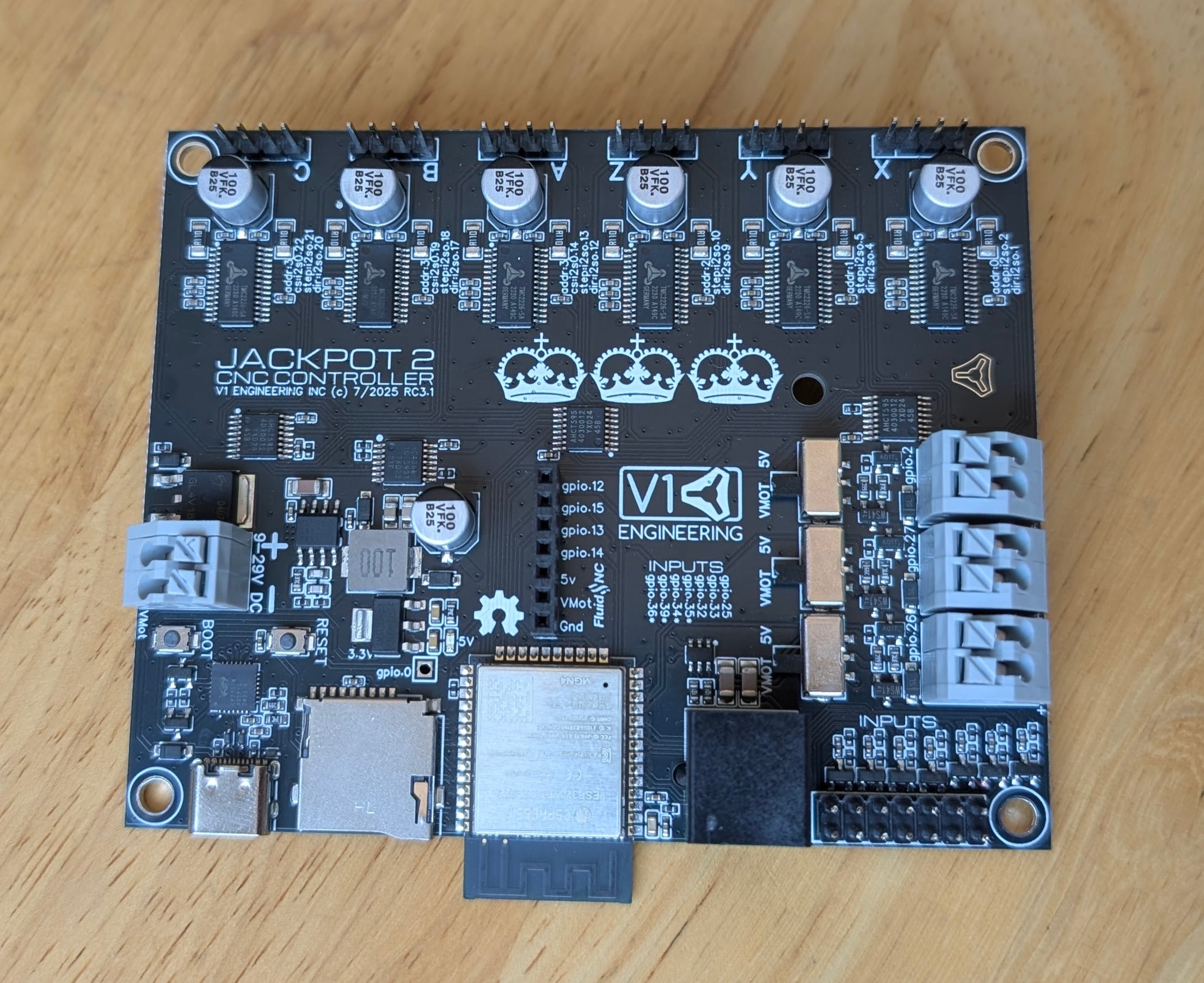

I had a Burly with a miniRambo board. I have upgraded it to a Primo and also upgraded my control board to a Jackpot because of the ease of changing configurations. No recompiling with the Jackpot. All you have to do is edit one config file! If you don’t think you’ll use a laser or spindle you can get a Jackpot V2 on sale. If you think you might add a laser, like I did, you should get the Jackpot V3.
I am very happy with both upgrades!!!

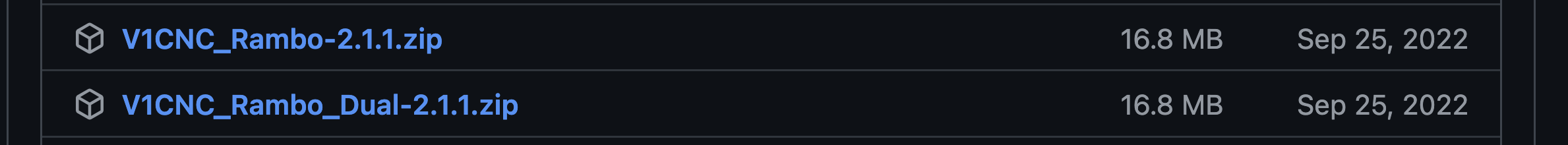

That’s OK, you can still try the V1 firmware for the boards. Look here:
I THINK the ones that might work for you on a Rambo would be:
V1CNC_Rambo would be an original MPCNC without dual endstops
V1CNC_Rambo_Dual would be an MPCNC with dual endstops
Depending on whether you want to try and set up dual endstops these would be where I’d start with firmware.
Primo and Burly aren’t different enough to need different firmware as far as I know.
