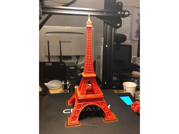

Now my goal it to tune it so it could print lattice structures. None of my printers were ever good at doing that, I always sucked at tuning them for this kind of task. My goal is to print a giant Eiffel tower, it would be awesome if it was precise and reliable enough to do it, I think this would be the ultimate test to pass since it would be both super difficult and also a really long print (I estimate it to take around 40 hours)
I’m thinking this one, but I would at least double its size to make it 500mm heigh at least.
Any tips of good practices when printing this kind of structures would be very much appreciated, that’s something I never quite managed to get right so far.

That will be awesome. I just had some nasty failures on a similar problem. This was vent holes for an electronics case but they had very spiney plastic pieces that were nearly vertical. They ended up being garbage. I didn’t try to print it again because it worked fine without those pieces.
I suspect the trick is to cool down the hotend temp and slow down. Dial in the linear advance, maybe. Maybe @mordiev would have some good advice.

I agree to cool down the nozzle if you can but be careful with slowing down the print speed. Only do that near the top where the layers don’t have enough time to cool. You may want to test print the top 50 mm first to get the heat and speeds tuned before printing the full 40 hours.
As for the lattice work. The nozzle will radiate heat that can cause over hang on previous layers to deform. With that tower you will probably have a lot of that kind of lattice work overhang. So rather than printing the whole thing slower it will probably be better to print with thicker layers (At least 0.2 mm in my opinion). Here is a link to a video where he explains it better than I ever could. At the 2:05 mark. The entire video has some great tips but this is probably the most helpful.
Slic3r has an option where it will slow the printer down if the layer won’t take a minimum amount of time. I don’t know what slicer you’re using, but there may be a similar setting.

Oh, that’s a really good suggestion. I’ll try that, thanks!
Not really, that’s one of the reasons I chose to go with blower fans, they are usually a bit quieter. You can definitely hear them, but not to the point that it’s extremely bothering. So far they seem to work quite well, I was a bit concerned about this part of the printhead melting or being damaged during the print, but so far so good!
I’m using Kisslicer and it has this option, I activated it for any layer taking less than 5 seconds, since apparently my fans are able to cool down things during that time. I might go for a bit more just for good measure.

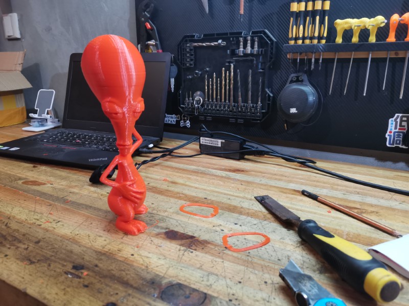

A sexy Alien visited my shop last evening:

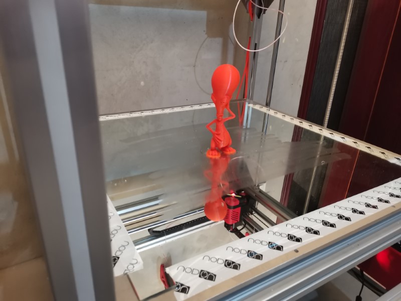

It took a while to print (bit less than 4 hours) because it was quite big (250mm height) and the result wasn’t great at all, but that’s mostly due to the original 3D file being really bad. The mesh was completely out of whack, which apparently confused the slicer, making some weird useless paths all around which both took longer to print and gave really bad results.
The other reason is that my extrusion isn’t really well tuned, those holes shouldn’t exist if the extrusion was perfectly set up.
Also had a bit of layer shifting on the head (happened two times). Not sure yet why this happened, might be the machine skipped step, but might be also that the print head bumped in Roger’s head, moving it sightly, since the neck is thin so it was not a very solid model. I hope that’s the reason.
Weirdly enough, the part I was most concerned about on the model turned out to be the cleanest by far: the arms turned out amazing despite their small sections and long overhangs. That’s great!

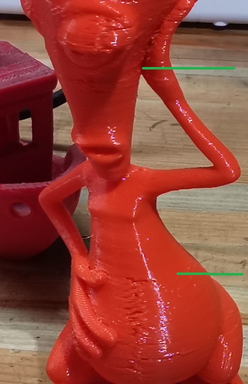

It did print entirely, so that’s nice, but this print quality was real bad as you can see better here some spots turned out horrible (but those wouldn’t exist if the 3D model wasn’t that bad in the first place):
It printed almost perfectly between the two green lines, because those were the only part of the model which didn’t have mesh issues…

Lol! Love the sexy alien.
Yeah the mesh problems seem like a real problem. I am curious if your slicer has a “resolution” setting. That might help clean up some of the mesh issues and some of the “zits”. Don’t use to high of a number or it could make the problem worse. Again a video that explains what I mean better than I can.
Ah yeay I saw this video a few months back (great 3d printing channel BTW). Actually that wasn’t this problem here, it was a very weird issue that I never had before. the model had some external geometries that were crossing themselves, going from the inside to the outside of the model. The slicer followed those and so it was making some perimeters inside the model instead of infill, and some of the external perimeters were basically becoming some tiny islands instead of continuous paths. It was a real mess.
I don’t know if there is any resolution setting to kisslicer, but in this particular case it wouldnt have solved it :frowning:
Usually it does a great job at repairing the mesh automatically, but this time, for some reason, it didn’t work either.

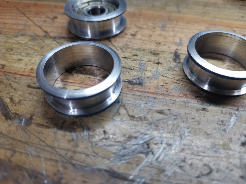

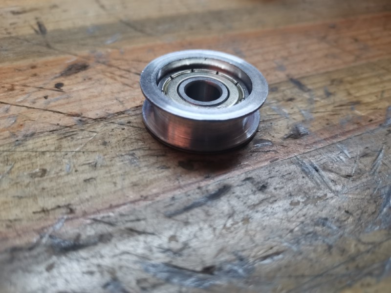

Problem 2 is still under investigation. I know that X and Y movement weren’t perfectly smooth due to the belts rubbing sometimes on the roller parts. So I spent my sunday working on the lathe and came with those little aluminum belt guides that I pressed on the bearings:
Installed them on the rollers, the movement is now much, much smoother than before.

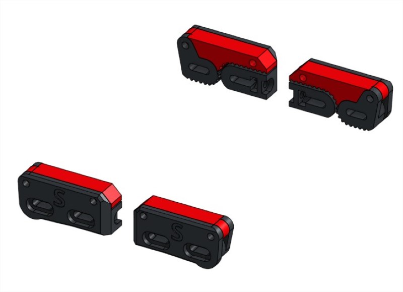

I also came with a new belt tensionning system which is very easy to use:
I forgot to take pictures of this system installed on the printer, but basically you open the little red lever, slide the belt in the black part, close the lever and secure it with a screw which locks the belt in place and then finally tighten the screw at the back to tension the belt and trim up the excess. Looks clean, works great.
Hopefully these hardware updates will solve the layer shifts issues. The next possible culprit would be the USB wires not working properly, in which case I’ll replace them with something more reliable. Would be a bummer, but what matters is what works.
Well that’s just great. I’ve been putting off getting a lathe, and now I think I need one.
