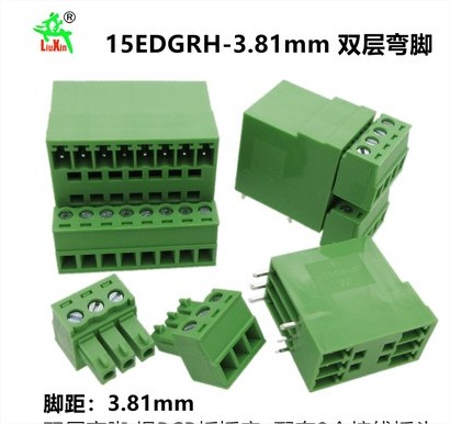

-Full silicon insulated wiring, so that they are as flexible as possible. I took different gauges, signal wires will mostly be 28AWG, power wires will either be 24 or 28 depending on what they’ll power.
-the classic green screw terminal connectors, in smaller form factors (3.81mm). They are big and ugly, but they are great when it comes to maintaining the system because you don’t need to solder anything. So adding a new feature or changing a defective device will be much easier than with any other system I can think of.

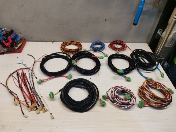

So here is the whole new harness, it’s entirely made of silicone insulated wires, they are insanely flexible so that’s great. The point was for them to bend as easily as possible, to hopefully avoid any effort on the cable chains, which should result in a slightly better movement on the motor carriages, at least for the ones that were running the HDMI cable, which was quite rigid.
IMG_20201018_233028_1
I’ve built separate harnesses for each function: one for each motor, one for the BLtouch, one for the hotend, one for the fans, etc. This way it should be easier to maintain and easier to add or remove functions. I’ve already planned a connector and made a harness for the laser diode, and I’ve left a few spare connectors on the new version of the electronic box that I’m currently designing.
So now it’s time to finish the design of the electronic box, which will be fairly complex, and also start designing some components to attach the wires on the other sides (motors and hotend). So still a lot of work.

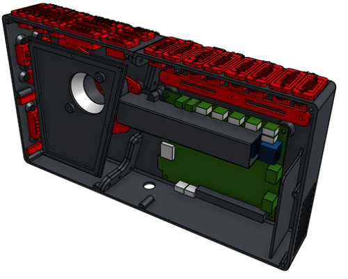

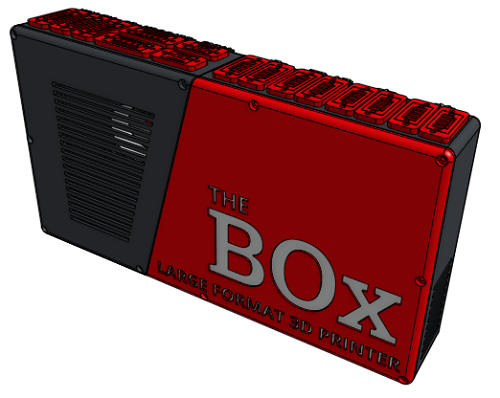

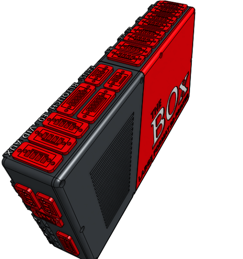

The design for the new electronic enclosure is ready, now its time to get it printed!
It will be too big for my printer so I had to split it in half. I used the same kind of design as my screen enclosure, to both make it fit the printer and make it look nicer

I was unable to find red connectors, it seems like they only exist in green for some weird reason. Probably that the guy who invented those was Irish and they were afraid to piss him off so they never even tried to change the color.
So I guess I’ll try to paint them red, but if it doesn’t work or if some Irish dude shows up, then I’ll just leave them green to avoid any trouble.
The enclosure features active cooling through a dust filter. This time I included some chicanes so that there is no direct path to the fan, hopefully that should make it a bit quieter. I also included a few stuff for cable management so it should look clean.
I’ll still use USB ports for all the limit switches.
