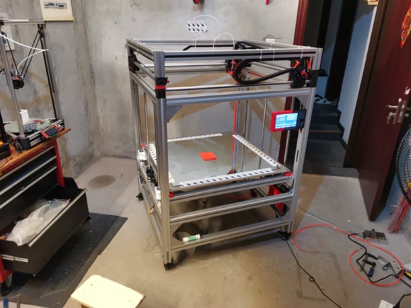

Anyway, on a side note, I made the first print attempt yesterday on the BOx, and everything seems to work fine so far! I haven’t installed the glass plate so It wasn’t sticking at all on the aluminum, but it was moving the right way while extruding something that looked like what was expected.
So I have nothing to show for yet, but it’ll be very, very soon.
First I had to tune up my slicer so I created a new printer profile. First attempt of printing was a weird fail, the print head was moving super slowly while the extruder motor was spining crazy fast. I solved it by chosing the option “5D Relative Extruder” in my slicer, which is weird because all my other printers are using absolute mode.
Anyway, it worked, Now I need to find a way to secure the glass plate on the bed, make a support for a filament spool and that should be enough for a first test print, yay!
By the way, the Duet Web interface is really great. You just slice your design the regular way with your slicer, save it somewhere on your computer’s hard disk drive, then you click on “upload and start”, Boom, it starts printing right away.
You can babystep if necessary, adjust speed, whatever. Also, if you lose the network connection it doesn’t matter since your print is instantly transfered onto the duet board sd card anyway. Great stuff.
Only thing I find a little bit disappointing is the touchscreen. It is real nice and high quality, but it could have a bit more functions, like for instance I haven’t seen a button to enable the part fan. Not a huge proble, but I think a bit of potential is wasted here since the screen interface isn’t used to its full potential. Also the skins colors aren’t too bad but they could look better. I wonder if there are some mods for it actually.

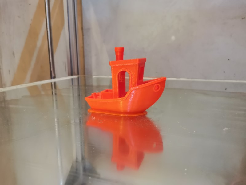

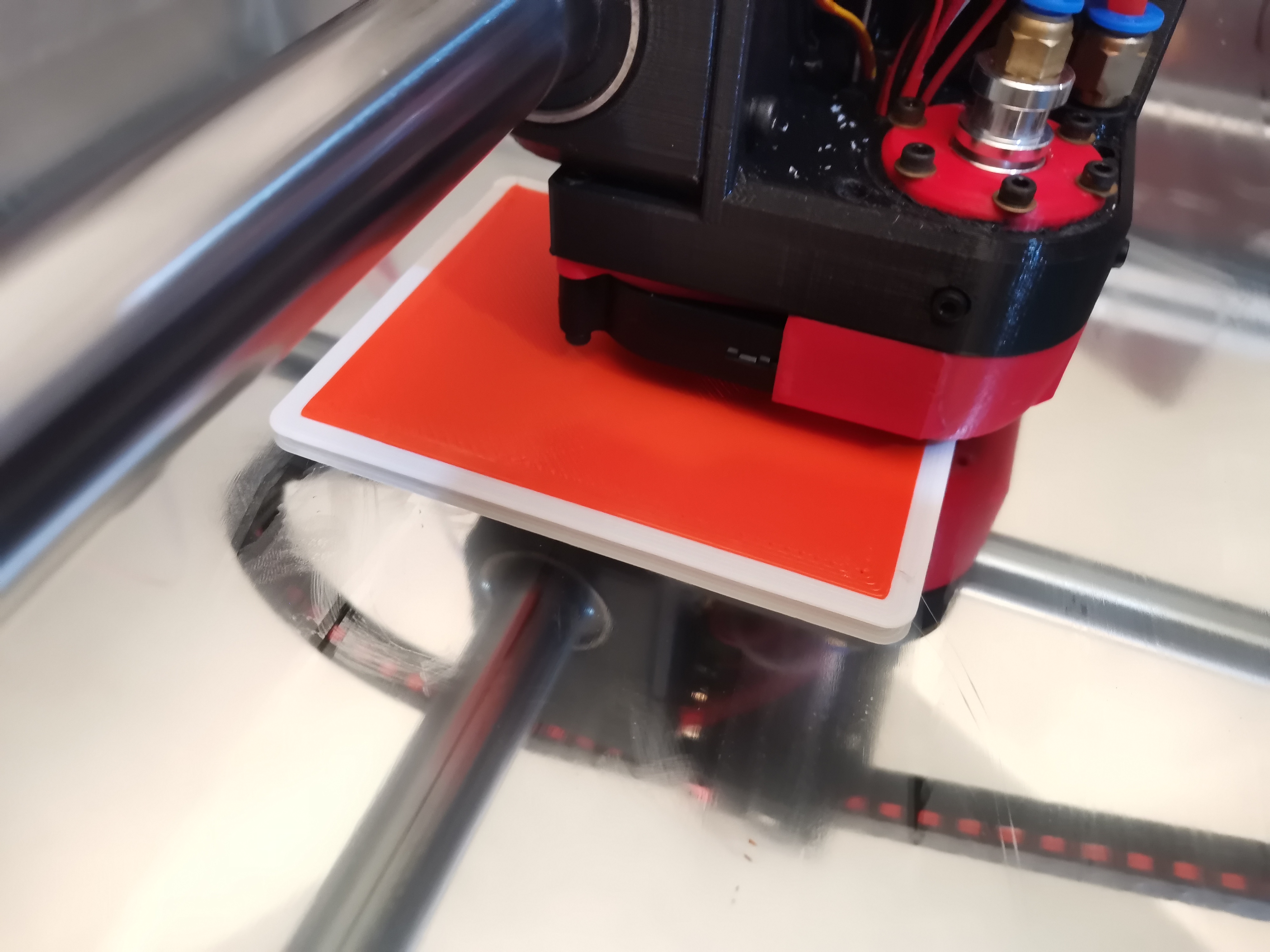

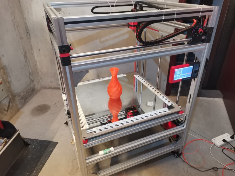

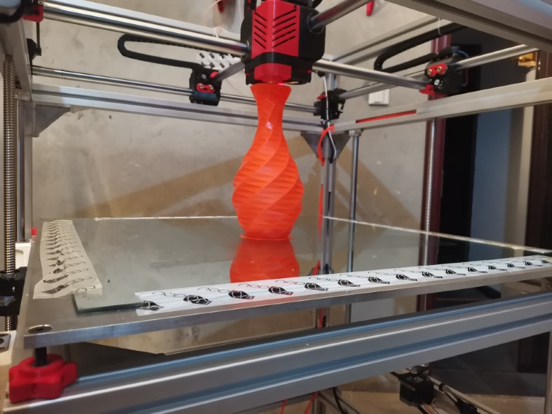

First actual test print yesterday… And great success!
I just attached my mirror temporary with tape, and lauched the print directly,
TaDaaaaaa…
First layer adhesion was poor because I was babystepping to find the correct offset, so I had warping which at some point became too important. I just killed the print before completion cuz I was afraid to damage something, the head started bumping into the corner a little. But it doesn’t matter, this part was just a test anyway, didn’t need it to get through.
So, first impressions:
-I didn’t see any water leaks and nothing melted aside from the filament, so the watercooling seems to work fine so far.
-Temperatures are super stable and extrusion seemed very consistent, I guess this might have to do with the full copper volcano heat block and the aerogel insulation, so that’s great
-The print head is far more rigid than before. So whenever it hits a blob of plastic it doesn’t deflect much, which is a bit more violent but leaves a much better finish on the outside layer. That was one of the goals I wanted to achieve so that’s great to see.
-I kept printing speeds slow, but I haven’t paid attention to my travel speeds… and well, they were pretty scary fast !
-Bed leveling worked fine, warping was just due to the first layer being too high, but it was pretty consistent
-Part cooling fans are really powerful and blow air at 360 degree around the nozzle so no blind spots, I think they will work well
-The printer is very silent only thing I can hear are the fans and the Z axis
-The printer frame is sturdy, but not as much as my wooden frame seemed to be. But I haven’t tightened the tubes down yet, all the corners are loose. Once tightened that will make a huge difference so I guess in the end it’ll be stiffer than the wooden one. Also my belts aren’t tightened either, they were very loose.
-The print itself was very clean for a first print, I didn’t see much artifacts despite many things not being tightened down.

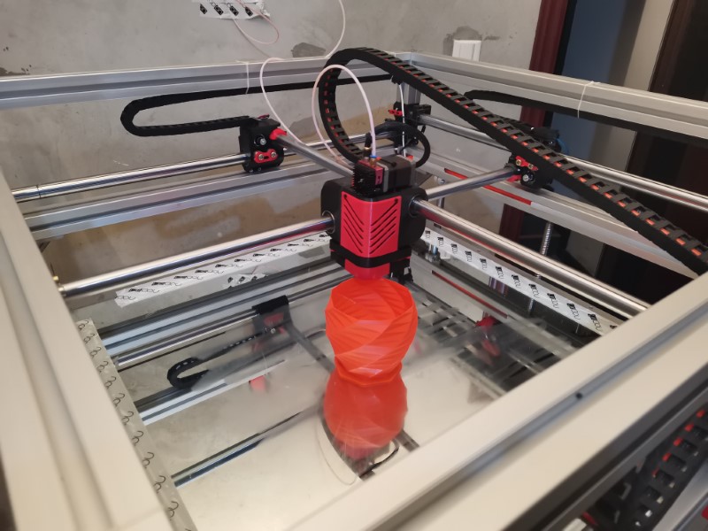

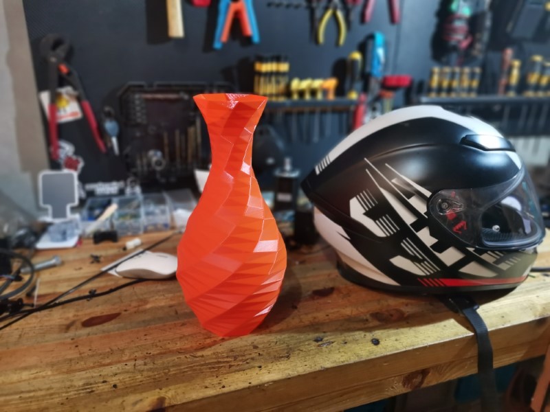

Made a few test prints this weekend.
First one was a big vase, just to check that everything was working properly mechanically speaking (I was especially curious about how the Z axis would behave).
I upscaled the vase to 300mm height. Unfortunately I’m still using an old version of Kisslicer which doesn’t have the spiral vase function, and my extruder wasn’t tuned at all at that time so I’ve got lots of holes at the beginning of each line. But the point of this test wasn’t to get a watertight print anyway, so that doesn’t matter.
It took only 1 and a half hour to print, and I think the result is really great. Only issue I’ve spotted were the holes, obviously, and at some point the extruded filament didn’t have enough time to cool down since on the top of the print each layer was taking less than 4 seconds, so I lowered down the speed a little and everything went back to normal.
The Z is very consistent so that’s great, and I didn’t see much ringing or artifacts so that’s great news too.
And as a bonus it impressed the wife, so that’s a win too :wink:
So, this was very successful.
I then calibrated a bit better my extruder, which was over extruding quite a bit, and tried to limit oozing by adjusting retractions, which is now much better but still a work in progress.

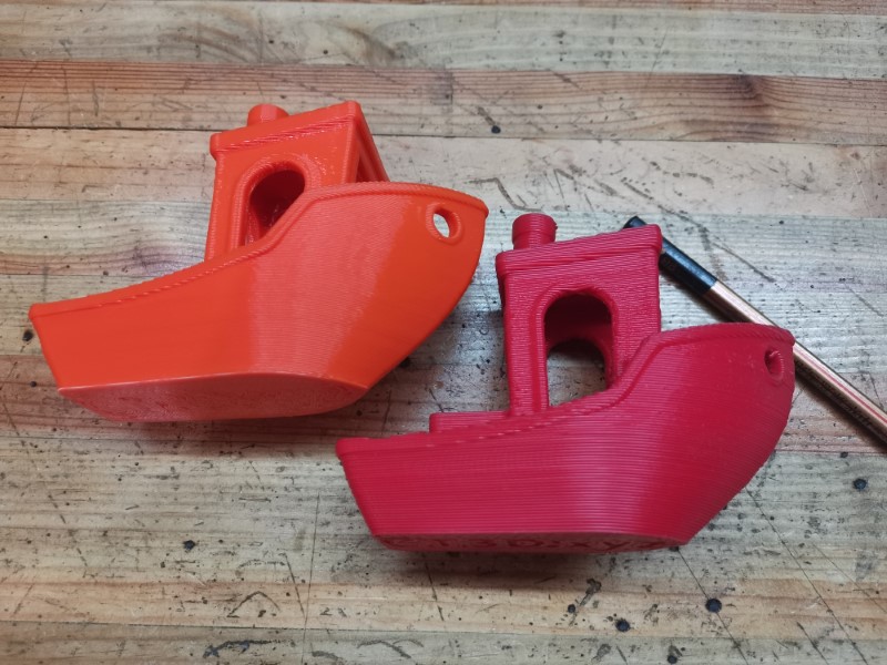

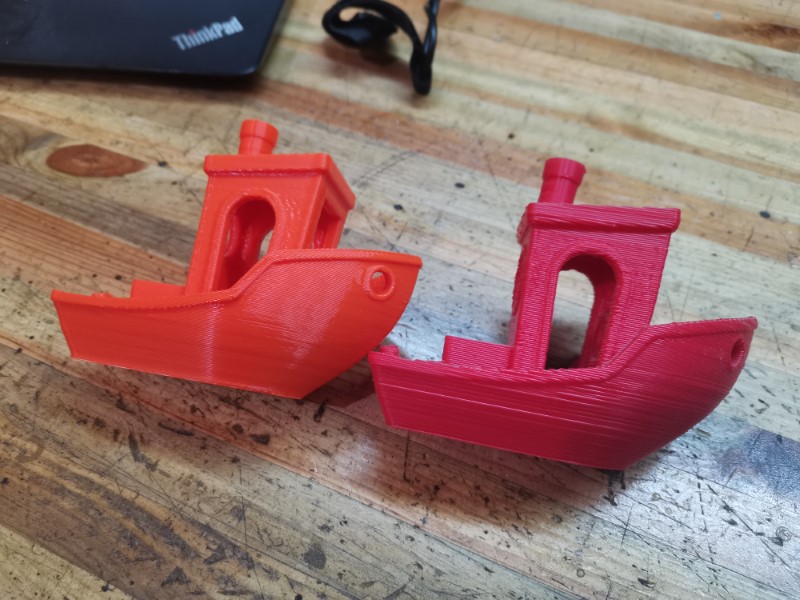

At that point, I was curious to see how it would compare already with my old MPCNC print quality, so I decided to launch an other big benchy (twice the size of a regular benchy), to compare it with the one I printed a few years ago. Red Benchy is the one I printed with my old MPCNC, orange has been printed with the BOx:
Well, it turned out amazing, that’s one of the very best benchy I ever got, it’s on par with the ones I get from my ultimaker !
One thing to be noted is that the red benchy was printed with a 1.2mm nozzle while the orange was printed in 0.8mm nozzle, so of course it is expected to be a bit better. But you can see that the hull is much cleaner on the orange one anyways.
In my opinion, all the remaining defects are due to the slicer settings. I need to tweak retraction and linear advance to get better path starts as well as better corners, but aside from this it works perfectly.
The fact that I got a better print quality at my second print attempt than whatever I was being able to obtain with my best settings on my previous rig is a great victory, shows that I haven’t gone through all that effort for nothing!
