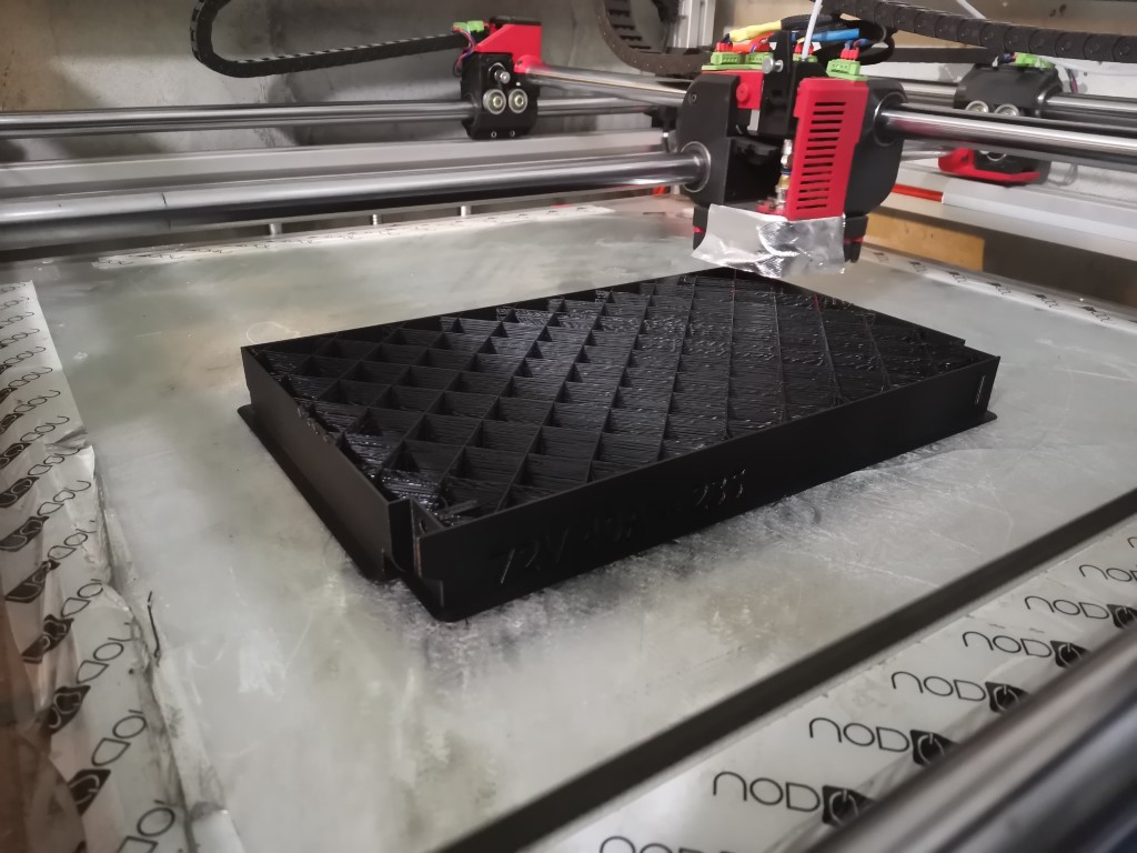

I spent some time last spring 3d printing some holders for the tooling for my mill. I need to design/print some more.
I found another flexible filament seat:

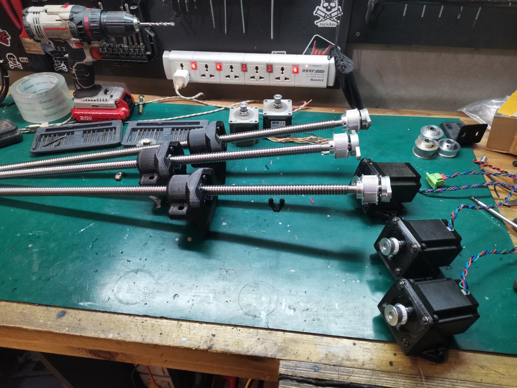

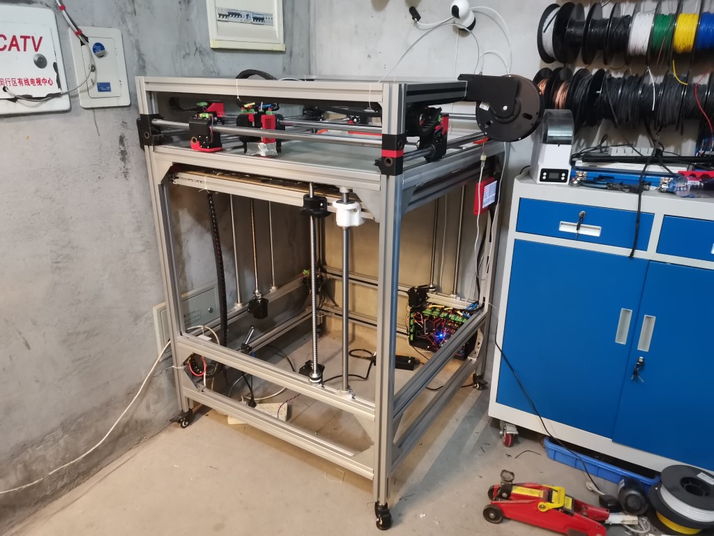

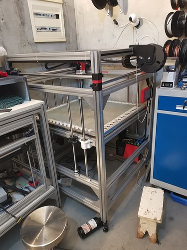

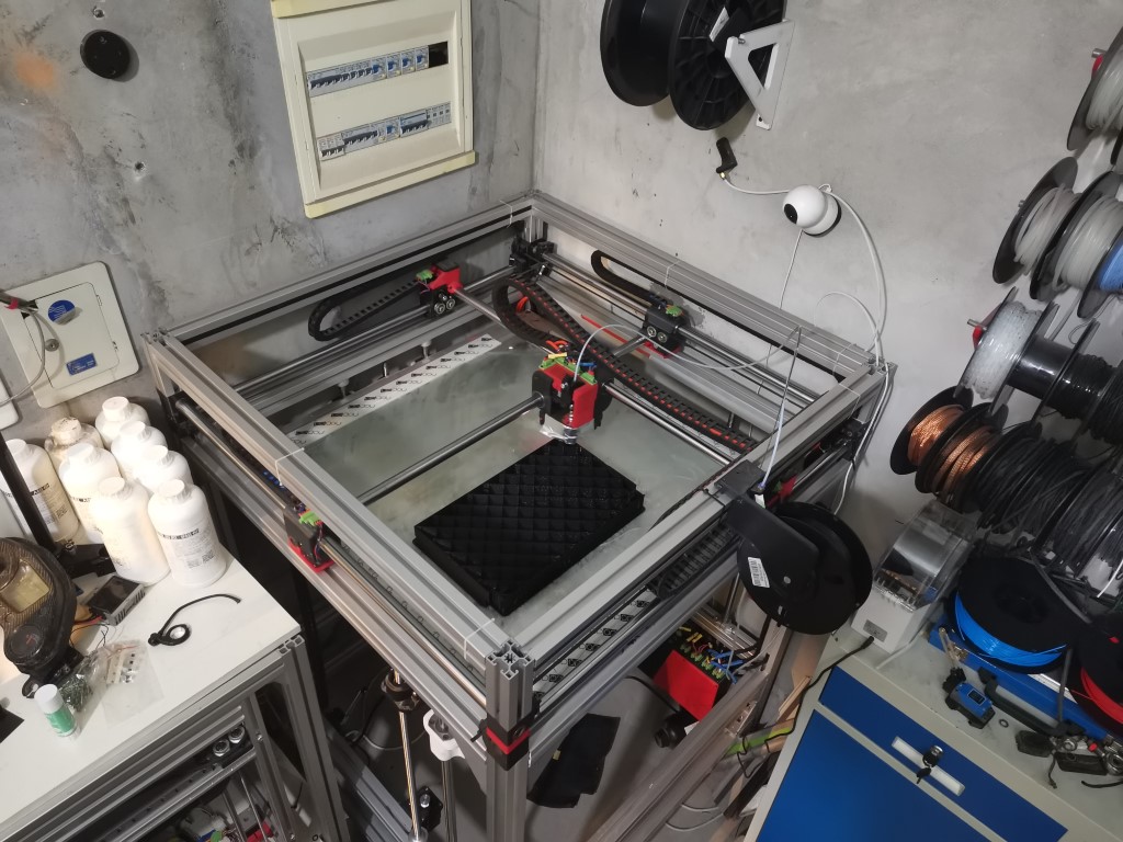

Some new mods on the BOx this weekend: I finally went to triple Z axis!

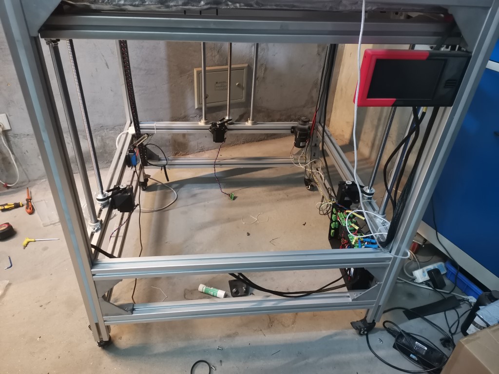

I had to get 3 new motors, I already had two but I was unable to find the exact same model for the 3rd one. Could have gone for a different one but I wanted to have 3 identical motors to rule out any potential issue. I also changed the belt reduction from 20/60 to 30/60, those motors are bigger and there are now 3 of them instead of two, so going for lower reduction allowed me to increase the bed speed.
I had to move the existing ball screws towards the front to equalize the load, then I removed the rear linear guides to install them around the 3rd axis. I took extra care to get very precise spacing so that everything moves freely. It took a while, wasn’t very complicated but it’s a bit tedious to do.
Then I had to modify all my wiring and edit the firmware. It took a while and I had to redo everything a few times because for some reason the Duet board refused to have external drivers running at 4x microstepping. After changing my strategy and going for external drivers to control the extruder instead of Z it started working just fine.
Finally I had to set up the true leveling feature, which worked after a few failed attempts due to some wrong configuration.
Well so far everything works fine, I made two successful prints.
The goal of this mod was to solve one of the very few issues I had with the printer: sometimes after powering off the motors, the bed was slowly falling down on one side, due to the low friction resistance of the ball screws. In which case, sometimes the printer was unable to level the bed, because there was too much angle to correct. Also, the bed was inconsistently tilting from front to back from one print to another and I had to manually adjust it with a spirit level from time to time. This was the only annoying issue I still had sometimes with the machine. It wasn’t often, maybe one time out of ten prints, but it was still quite annoying when it happened.
Now I just hit print and it does its thing, I don’t have to care at all about the initial bed start position.
Also, it is now much more powerful, so the bed rises and lowers a lot faster. It wasn’t slow to begin with, but now raising the bed takes only around 15 seconds, it is actually faster than most regular printers I’ve seen, despite covering a much longer travel distance.
One other nice point is that now that the bed is truly leveled, the mesh leveling has to apply a lot less corrections during the print, making the printer a bit more silent. Most of the noise of this printer actually came from the Z axis, because it is running at 4x microstepping.
I’ll see on the long run but so far it seems like a really nice mod to increase the printer’s reliability and ease of use. Should have done it sooner.

Do you know how much angle you can correct for? I went with 10 degrees, there is room for more but it just makes the mesh leveling take to long from the excessive retracts. I just took a shot in the dark seems like plenty though. On the repeat I have it home to max and that corrects it to a few degrees first anyway.
I don’t know it in terms of degrees, only in terms of differences in mm. In my case I’ve set it up to a maximum deviation of 10mm so that would be something like 1 or 2 degree i guess. I don’t see any case where I would need more than that, it is already plenty.
10 degree sounds really excessive, in my opinion if your bed is tilted by that much it probably means that you have something seriously wrong with the mechanics that needs to be fixed.
In my case 10mm was a good compromize between correction range and time for the mesh leveling routine. But my bed is really huge so I would put a much lower height correction if I were to do that on a smaller printer, maybe something like 3-5mm. Realistically there is very little chance that your bed will be off by more than this amount.
Also, I’m running the true leveling 3 times in a row before every print, it doesn’t make a difference if the bed is close to level, but it does make a huge difference when the bed is far off to begin with. On my worst cases attempts two levelings weren’t enough to completely correct the misalignments.
Doesn’t take long anyway, since my bed is now quicker it takes me the same time as before to probe 3 times and then have the 25 point bilinear mesh leveling before every print.

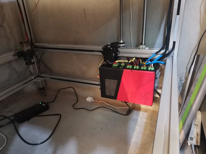

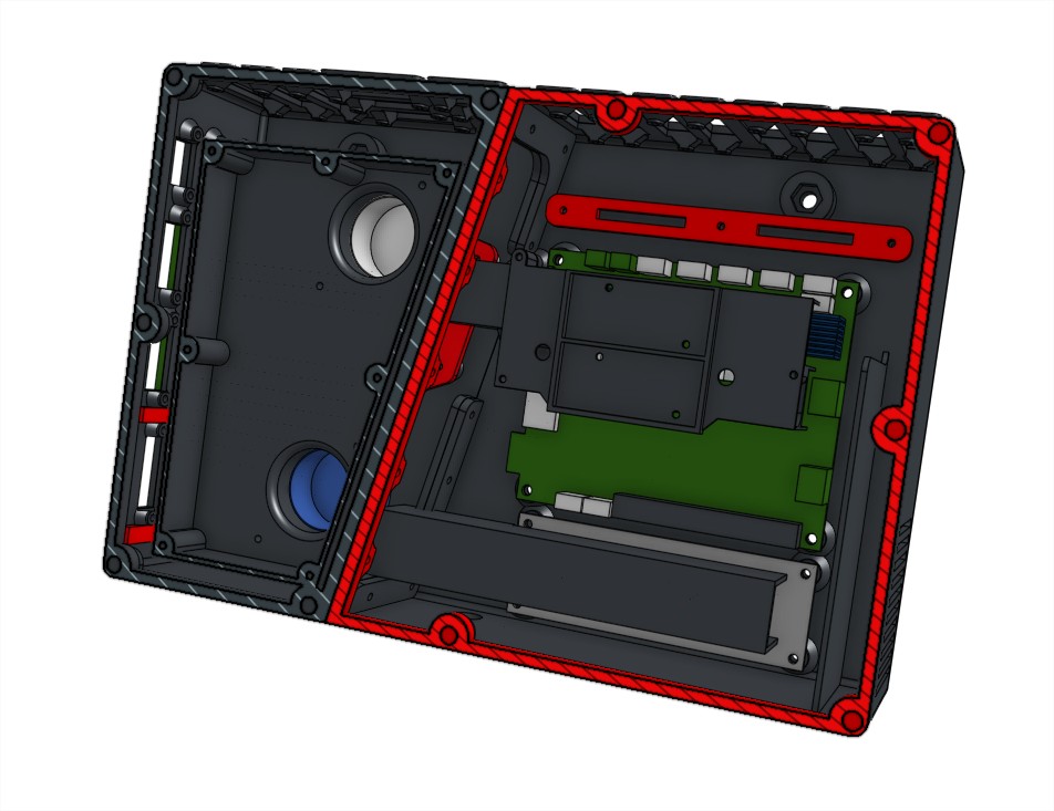

Now that I added new drivers it turned out I needed more cooling. Otherwise the extruder driver was getting too hot and stopped extruding due to thermal runaway.
So I designed a new cooling channel system in the electronics box, this time I have two 24V blower fans pushing air on all the drivers, and a big empty space before the fans to put some air filters and noise dampers.
This is how it looks like :
It was a good opportunity to finally tidy up all the wiring, now it looks really nice and clean:
The fans are pretty quiet at idle and can be quite noisy once going full speed, but they do move A LOT of air. I tried a few prints and now the extruder doesnt’ throttle down anymore, everything works as it should.
Pretty satisfied with how this enclosure turned out so far!

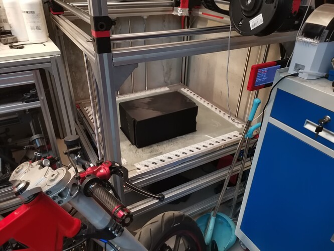

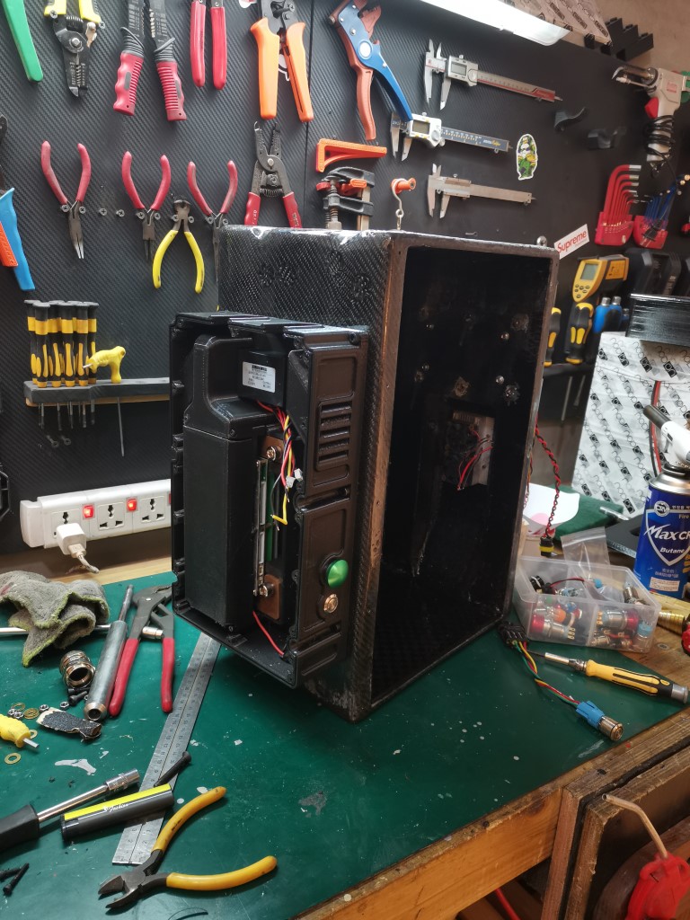

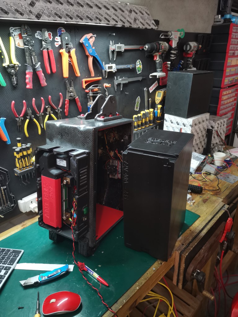

Made another big print yesterday: a mockup battery for my motorbike.
I’m currently working on my black electric sports motorcycle, basically rebuilding it entirely from scratch to improve its quality and make it very reliable, while tripling its power (should be around 50KW after I’m done hopefully, it will be a fun ride that’s for sure).
Anyway, I was working on my battery box and I need to make everything fit perfectly since there’s very little spare space. The real battery weights 25 kilos so that’s very unconvenient to have it go in and out dozens of times.
So I had two choices:
-Take a subscription to a gym club
-Make it lighter
I didn’t hesitate for one second. First opened a beer, then decided gym wasn’t for me.
Anyway, I designed the battery according to the real one, just added a couple mm here and there to make sure it would be a tad easier to fit the real battery than the mockup. Designed all the attaching points for the wiring and stuff, this way I can also build my power wiring accordingly.
Printed it with my 0.8mm nozzle, two perimeters and relatively low infill, just enough so it can print the top layers.
It took about 17 hours to complete and just about a kilo of plastic. I think it’s the fastest spool I’ve eaten yet, and it could have been much faster if I had been more aggressive on the perimeters speeds, I could probably gain an hour or two.
After cooling down it popped off the bed right away. That thing is fairly solid. Sure it’s only two perimeters, but each perimeter being 0.8mm it’s still a 1.6mm thick shell. So yeah, pretty tough.
Now I can keep working on my battery box, it should make things much easier.
