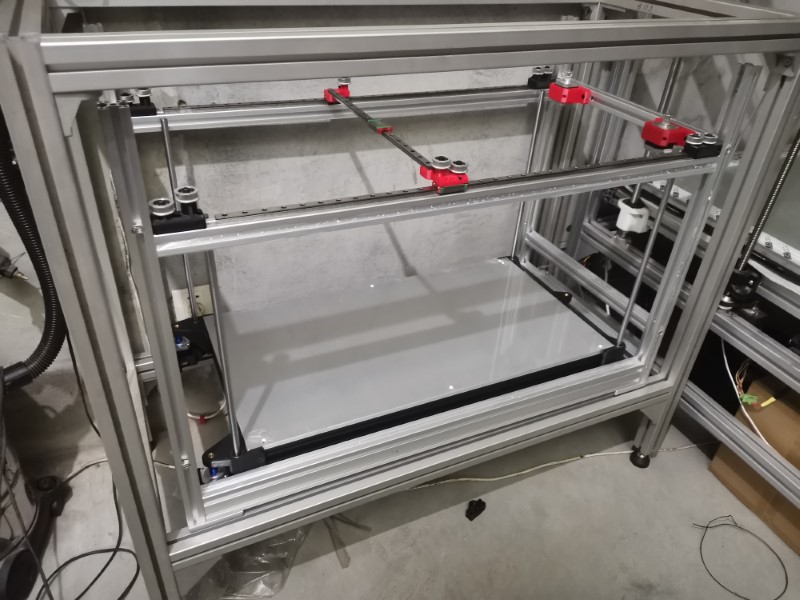

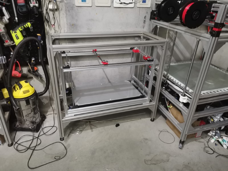

Anyway, I started the build:
The design is not finalized, I’m kinda building it by trial and error this time. But so far it seems ok.
Only thing I’m afraid of is that I went for a very beefy bed (a 10mm aluminum plate), which weights 9 kilos. I’m not sure those tiny steppers will be able to lift it without any kind of gearing down. Guess we’ll see, if it doesn’t work right away I’ll do the same thing I did on my other printer: using pulleys and a belt to change the ratio.
I had no space in the shop for it, so I’m also building a new bench. The printer will sit inside it, I should be able to use the bench to enclose the printer with acrylic sheet later if I want to.
It’s not as huge as the BOx, but for a coreXY it’s pretty darn big.
Anyway, still building!

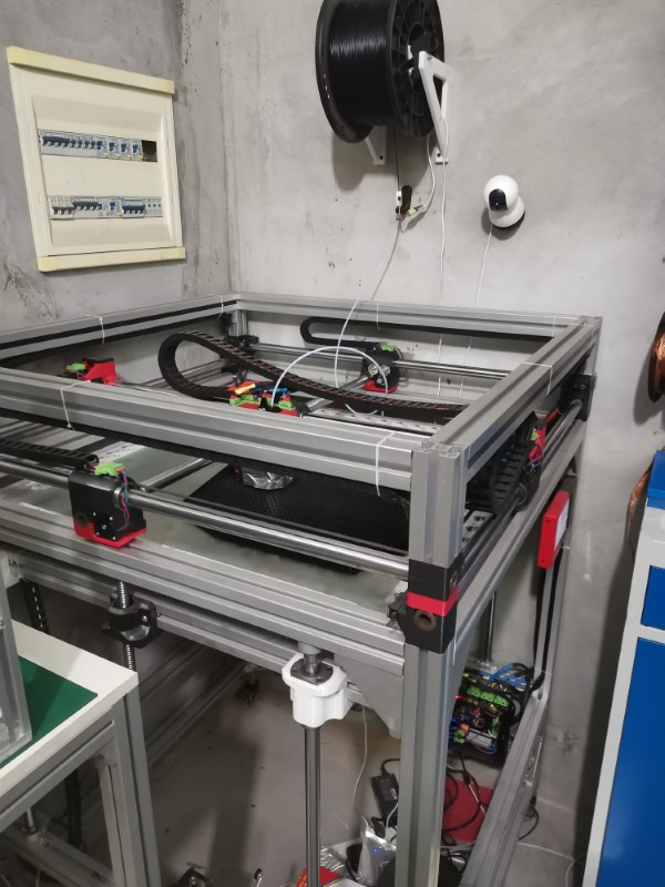

First, during the last week I took apart most of the BOx printer in order to upgrade a few components. The roller parts had melted pretty seriously because of the stepper’s heat, and I had some cracked parts here and there since the beginning.
I forgot to take pictures of all that unfortunately, it took me a whole day from early moring up to very late at night.
But now it’s back together and printing better than ever, all good!

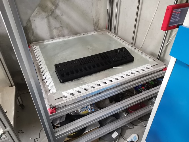

Some parts I printed for work this weekend (the weird bi color scheme is only because I didn’t have black filament anymore). Took about 4-5 hours to print these. I printed a full kilo on saturday with many big parts

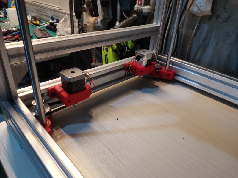

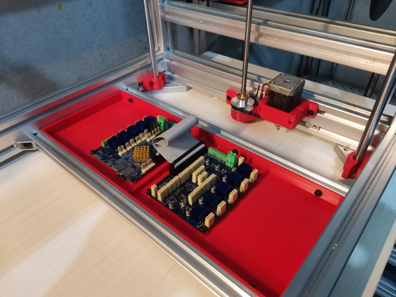

Anyway, also made some progress on the CoreXY. It’s moving on all axis now.
Installed the Duet2Wifi and the DueX5 boards. This big red tray was printed on the BOx (took a bit more than two hours):
Made a first version of the Z lifting system, very basic but so far it works well:
The Z axis is a bit slow due to the very heavy bed plate (about 10 kilos) and the high demultiplication (I’m using big pulleys and also 1mm pitch lead screws), but it lifts the bed without any trouble and I can tweak the belt ratio later to get more speed if I need it, or go for a lower microstepping rate.
The X and Y axis are lighting fast though, these moves were done at 800mm/s and 20k mm.s2 accelerations.
This seems to be the maimum top speed it can reach reliably at this microstepping rate, but the accelerations could go higher.

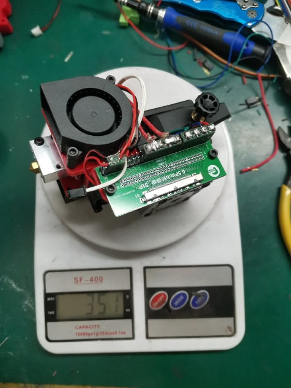

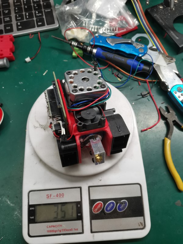

But this isn’t really meaningful until I got the print head installed, because it’s mass will determine what kind of accelerations I can realistically go for. I aim for about 10k mm.s2, that would be a nice achievement already.

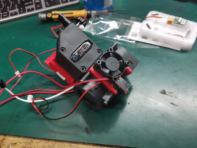

I’m currently working on it, I try go get it as lightweight and compact as possible but still packing the most cooling I possibly can (because cooling is key at high speeds)
I’m using a volcano nozzle, this time it will be air cooled because of weight concerns, and I’ll use a PT100 sensor to get more accurate temp reads. Some big blower fans on each side for part cooling, I’ll make some kind of shroud to direct the air in the proper places. A plastic dual gear extruder since you guys totally convinced me that those are the bomb, I never had any extrusion problem since I installed one on the BOx. Using one of the smallest steppers I could find to lower the mass (20mm thick). Last but not least, it will have a BL touch for bed leveling. So far the weight is a little bit under 300grams, I don’t think I can make it any lighter than that with regular 42mm steppers. Hopefully this won’t be too heavy…

Yes that’s the total weight including the stepper motor, the bondtech extruder, the hotend, hotend cooling fan and shroud, part cooling, wires and brackets. That doesn’t include the BLtouch since I haven’t installed it yet.
But It will be heavier, I still have to make a shroud to direct the air for part cooling, to add insulation on the hotend, and to add a little PCB… which should be the first part of an interesting journey too: I want to have the wires as light and free as possible, meaning I want to get rid of any drag chains.

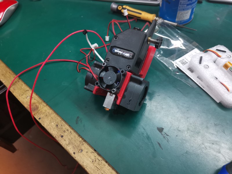

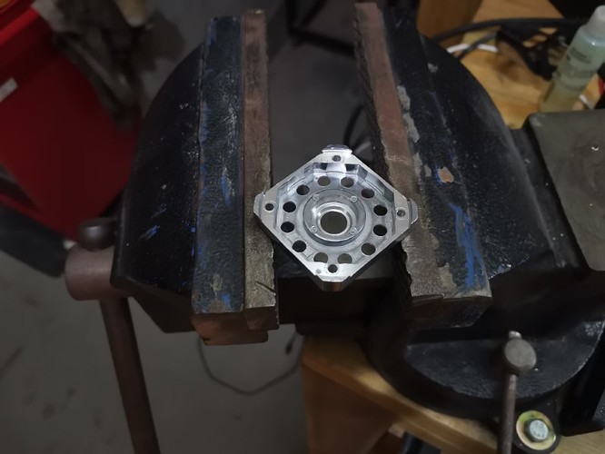

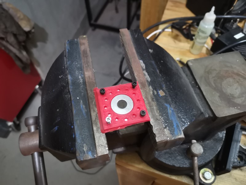

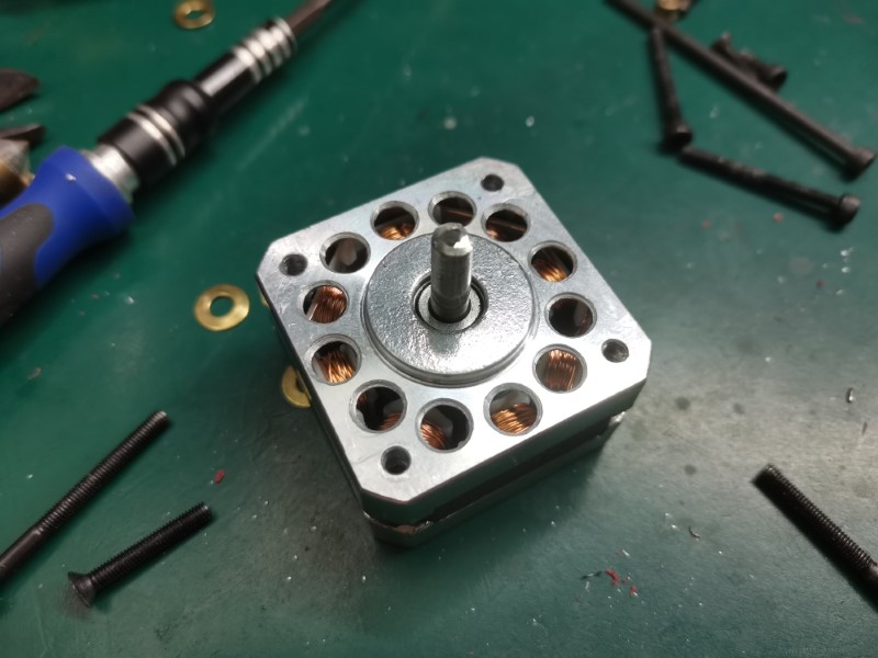

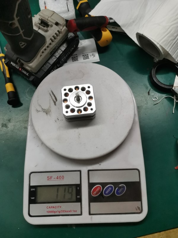

Still working on my print head, making some fun experiments to reduce the weight.
I took a 20mm pankake motor:
3D printed a smal template, then drilled holes all over it:
And tadaa, 6 grams are gone XD:
I suppose it might help also cooling slightly, but obviously the most important point is that it looks much cooler :stuck_out_tongue_closed_eyes:
I also received my flex cable connector breakout board and installed it on the printer. Now the print head is almost completed, I’ll just have to add the BLtouch and the fan shroud:
So far that’s not too heavy, and I think I can lower a little bit the weight by removing material here and there. But that’ll be for later.

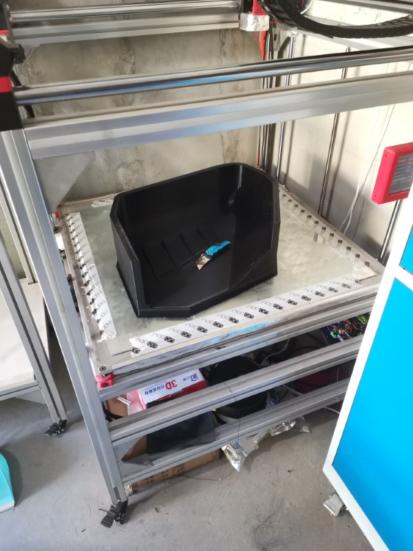

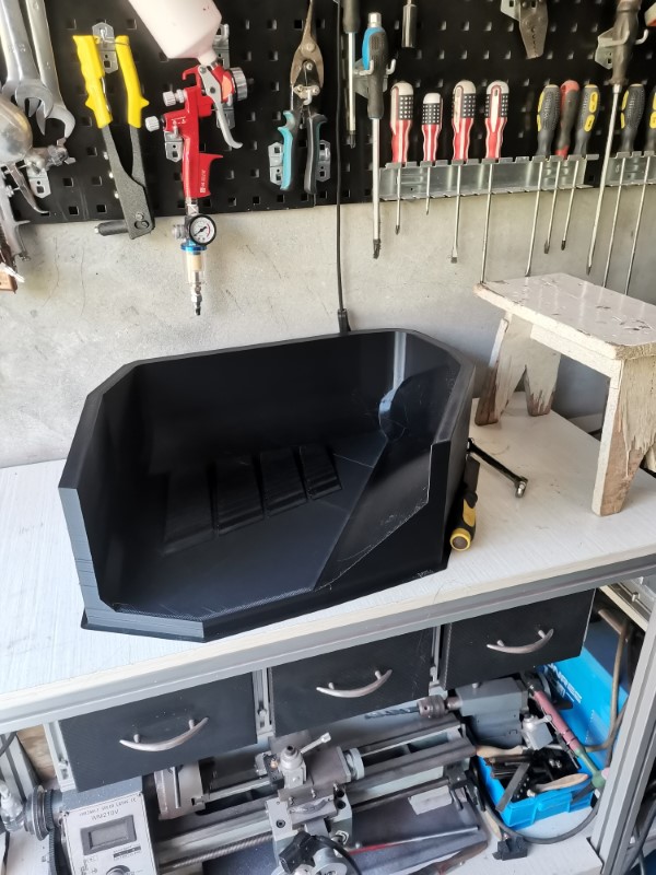

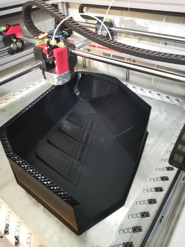

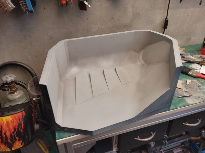

But meanwhile, I printed the biggest stuff yet on the BOx, it is a big mould in order to hopefully make some carbon fairings for my motorbike:
It was my biggest print by far, about 2,5kilos of filament
Got myself a huge 5kg spool for the occasion:
I had a little issue on some layers, because I hadn’t tightened the extruder screw properly (stupid mistake…), so the filament was sliding on the gears. I solved the issue mid print and from then the rest of the print went perfectly.
The total print time was just a little bit under 40 hours. This thing is freaking huge.
Had no trouble to remove it from the glass after it cooled down. Also, no warping whatsoever. The result is exactly what I was expecting.
A bit of sanding, some filler, some primer and it’s almost ready now. I just have to find some kind of gel coat and it will be done.

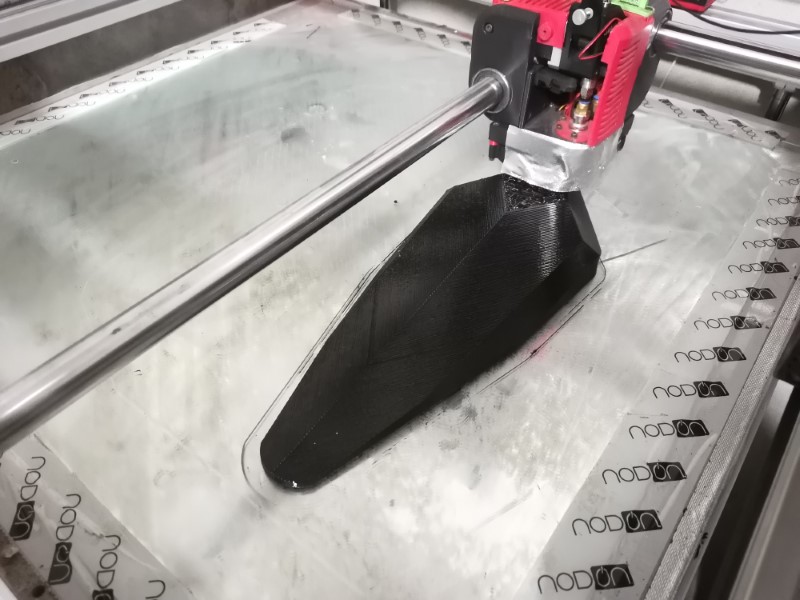

Also made a relatively big print out of flexible TPU filament: it is a test saddle for the motorbike.
TPU is a bit tricky to print, I had mostly successes but sometimes it fails because the nozzle clogs. I haven’t found printing parameters that guarantee me success everytime, still need to work on that. But when it doesn’t clog it works pretty well and it is not too slow. This part took about 13 hours to print, it’s longer than PLA for sure but it isn’t that bad considering its size.
This saddle is much more comfortable than the one I made out of PLA, but I will experiment with different infills shapes and thicknesses to make it as comfortable as possible.

But I kept printing stuff with the BOx anyway, and after I tried a few different infill patterns and thicknesses, I came out with this saddle made of elastic TPU which is almost the final design.
Well, this is perfect, I’m super happy with this. It feels just like a regular motorbike saddle, you can’t tell there’s anything special about it while sitting on it, it’s no different from a saddle made of foam. The TPU seems to be very well adapted to this application so far. Tha’ts a great win for me because the saddle has always been my worst fear on this project, I wasn’t sure I would be able to make it comfortable while keeping it reasonably small.
So now I just have to find a way to cover it in leather, which shouldn’t be too hard hopefully. The best part about all that is that I can very well design and print as many saddle shapes as I want if I ever get tired of this design!

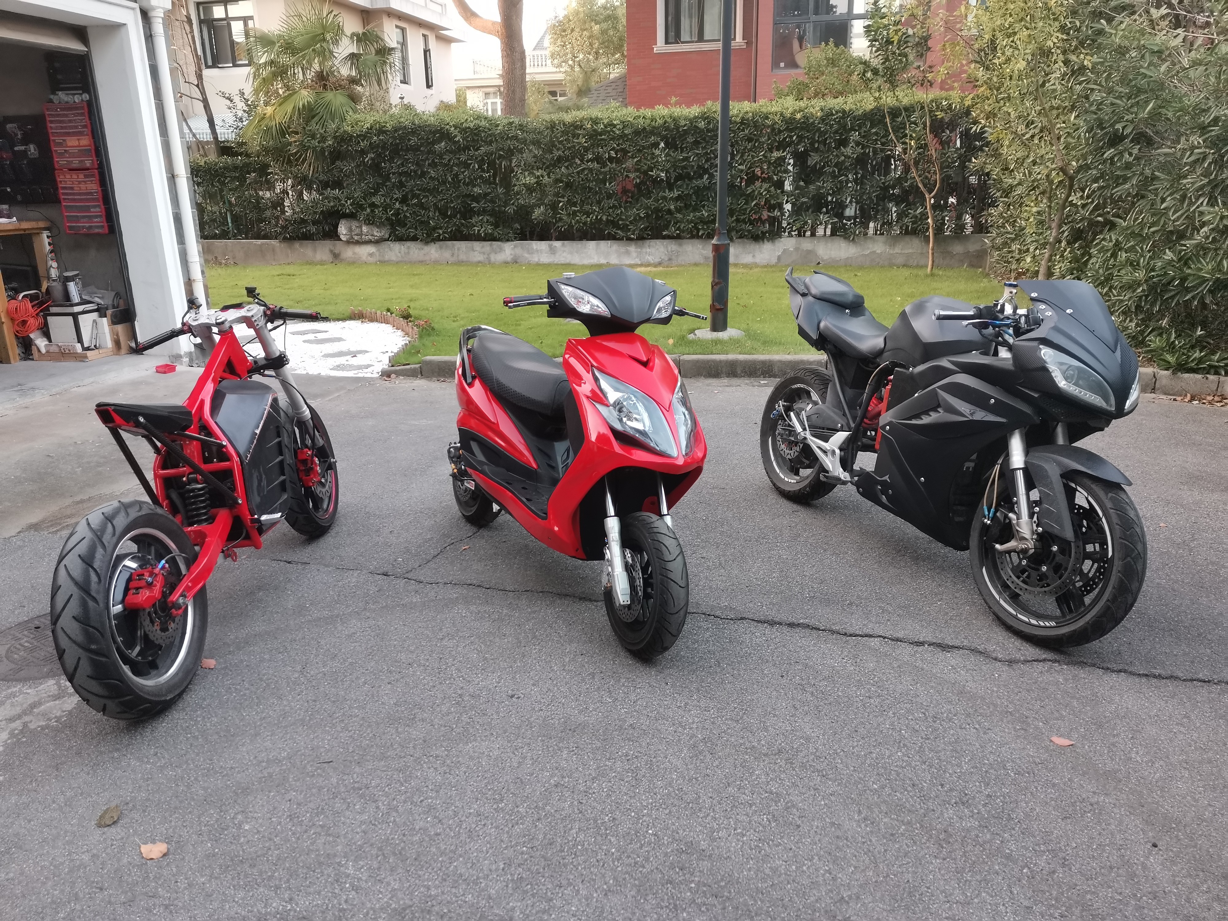

So yeah, now I’ve got 3 electric vehicles… :sweat_smile:

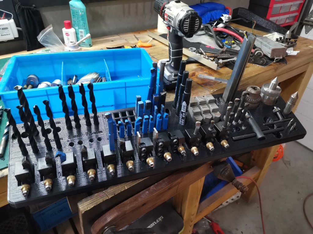

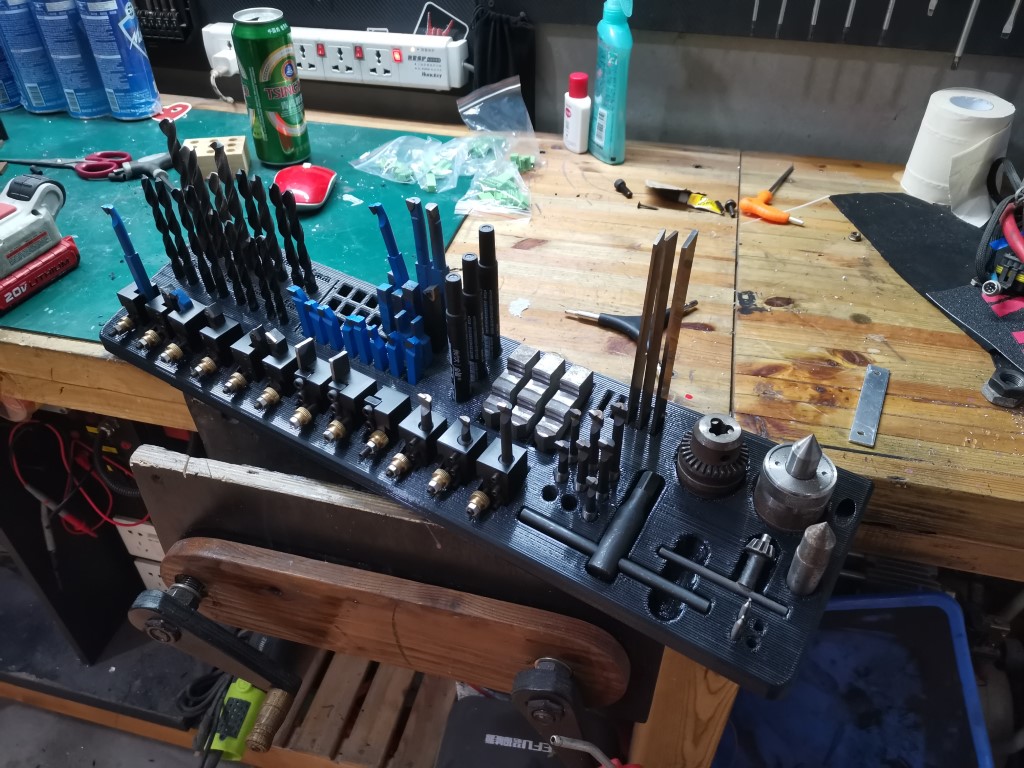

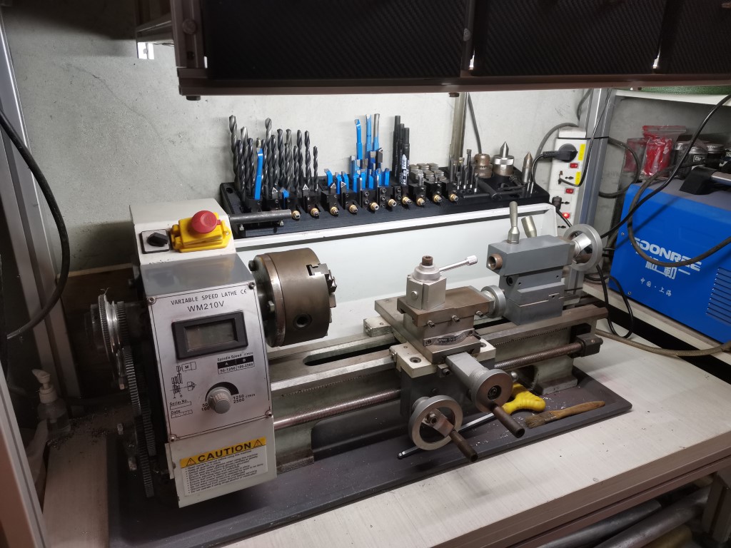

My little project of this weekend: making some kind of tray to better organize my lathe tools:
The part is 600mm long and about 150mm wide. It took a long time to print because there were lots of holes and many features, in total about 29 hours and more than 1 kg of plastic.
Worked just fine though, no problem!
I made a few little dimensional errors in my design so I had to massage a bit for some parts to fit well, but no biggie.
Eventuelly everything fitted just right.
I use to have all this stuff in a drawer, it wasn’t very convenient because I had to search for things forever. Now everything can be reached instantly. Plus I think it looks way nicer.
Funny thing is, I started this whole thing in order to properly store my reamer bits… and well, forgot to design a spot for them, so everything is there except for the reamers. :stuck_out_tongue_closed_eyes:
