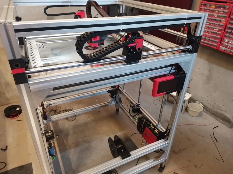

So, as it turns out, during the past days, at least 90% of my issues were coming from the filament spool system. The spool was just stored on the wall and it did bind a few times, causing some issues and even sometimes the filament broke during printing.
so I’m working on a solution for filament storage and safe delivery to the extruder.
My goal is to have a convenient system, similar to a cartridge that I can take off the machine and replace easily. This way I can change the filament outside of the machine, add or remove cartridges however I need, and have everything contained within the printer’s frame.
All of this isn’t really important with just one nozzle, but it might come in handy if I add some more extruders later.
I also want to have a clean path for the filament up to the extruder, so I’d like to run it through the cable chains. This is the major concern right now for me, I don’t know if it can work reliably since cable chains move all the time, they have some short turning radiuses and, even though it if really beefy and powerful, there might be too much friction for the extruder motor to overcome.

I tested if it was clamping fine and it did! Easy to put in with a bit of force and easy to remove. Plus it doesn’t wiggle around. Very happy with this design, I think this was a great idea (but let’s see how it works, history showed us that what seemed like great ideas at first aren’t necessarily all that great after actually using the thing :yum:
So far so good. Now my only concern it: will it be ok to pass the filament through the cable chains? I will need a very long bowden tube and also some radiuses migh be a bit tight. I just hope it won’t be too much strain on the extruder motor. I guess we’ll see, but I really hope it will work cuz that would make things so clean!
If it was in a ptfe tube I would guess there wouldn’t be much resistance. I would worry about it breaking when taking small turns, but I have a hard time understanding the scale of the turns on this BOx.
I think Ivan Miranda’s solution was pretty good, supporting the filament with a flexible arch that stayed in the air. With a fixed length like a bowden tube or cable chain, it should prevent tugging when the head moves quickly in X and Y.

Yeah but I don’t want anything going oustide of the limits of the frame, in case I want to enclose it later.
Hmmm that’s going to limit the possible bend radius. Unless you put the cable chain horizontal, but even then in some corners of the workspace you will probably need a tight bend radius.
I’ve always been a fan of the filament being above the extruder. You’d have to extend the top of your build to do this and have it enclosed, but it gives a straight path for the filament to go.
I agree with David, especially on models where the bed moves in the z axis. Seems like having the filament above is the shortest most direct route with the least potential for problems.

Only annoying thing is to pass the filament through such a long bowden tube by hand to load it, it takes forever. If this solution proves to work fine I’ll build a little device to help push the filament faster, using the old extruding system I had and a hand crank.
So far it seems to work fine, the filament is not very easy to push by hand, there is indeed some friction, but the extruder motor is really very powerful, and I’m not even close to the maximum power the drivers can deliver. (1.5Amps currently, but the drivers can go to 2.4).

Good news: the printer has been totally reliable for three days in a row. All my prints were successful and the printer was basically a no brainer, hit print and go do something else. I went through a new spool of PLA during the past two days and all worked great.
So that mean my spool system stays the way it is, it works!
