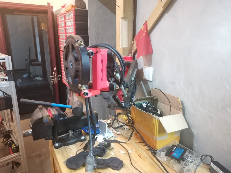

I’ll try also to make the autopsy of the old wiring this weekend to see what has gone wrong. I checked the outside insulation yesterday and didn’t see anything special about it, seemed totally fine, no pinch, no nick, no nothing.
Thanks for your support guys, it’s real nice to see those kind comments :slight_smile:
Well it looks like the problem is solved, I didn’t have any issue with the motors so far.

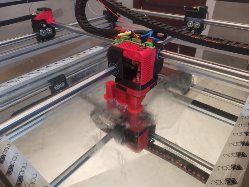

So, that was a nice and productive weekend. I printed almost one kilo of PLA with almost no issue.
Only real issue I had was because I was a little bit stupid: I changed all my wiring except for the extruder motor… well, obviously the same thing happened and I had extrusion cuts for half of a print.
So, I just replaced this wire and after everything went well after that!
Other issue I’ll have to address is the extruding system: as you guys said it’s not great and I had a few issues with it binding sometimes at the very beginning of some prints. And also it’s not really easy to maintain, each time I had an issue I had to remove the print head, disassemble stuff, reassemble, etc. Takes 5-10 minutes but it’s tedious.
So I’ll look into the other systems that were mentionned and later update a little my design to make it more maintenance friendly.

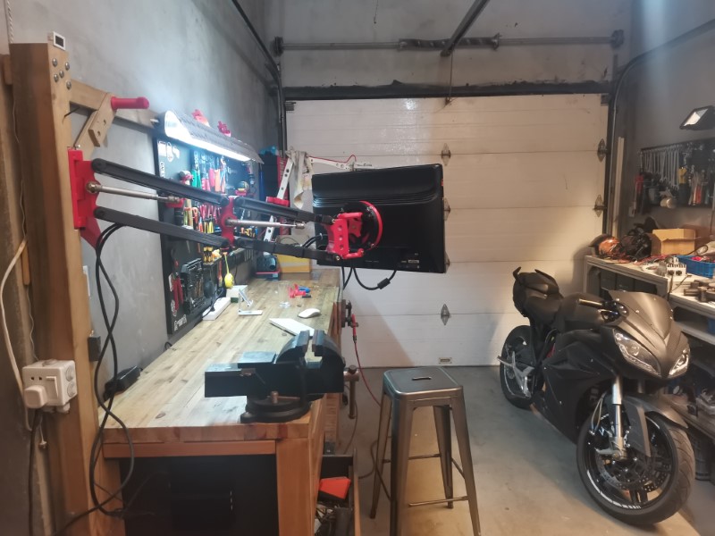

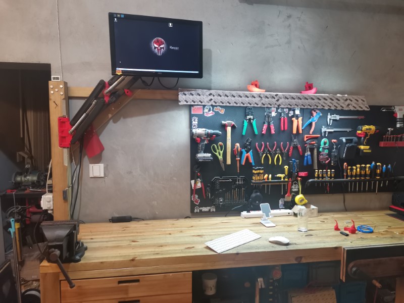

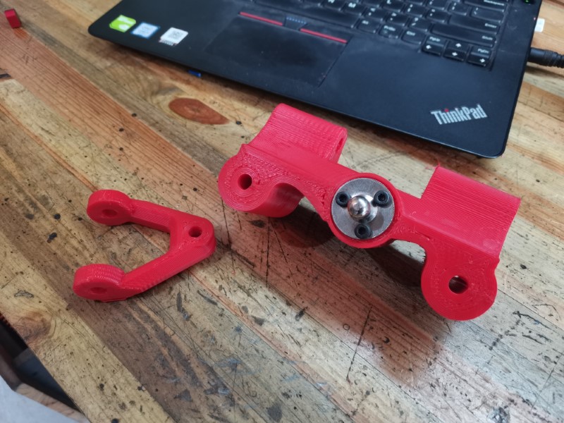

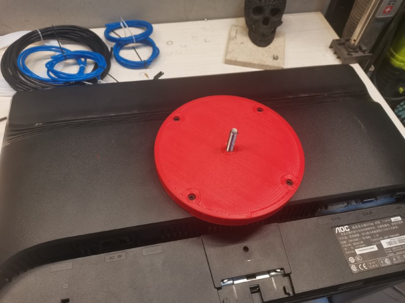

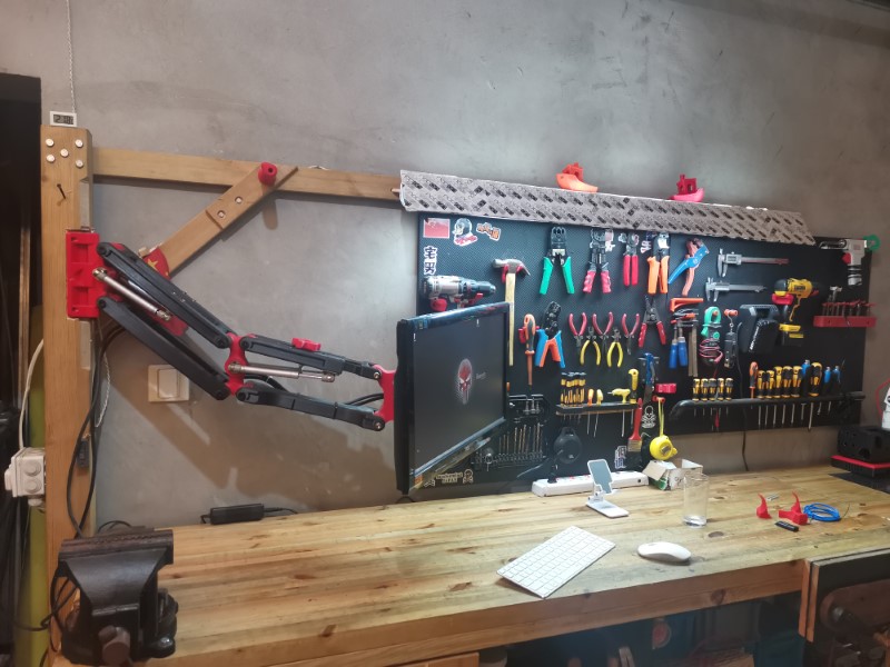

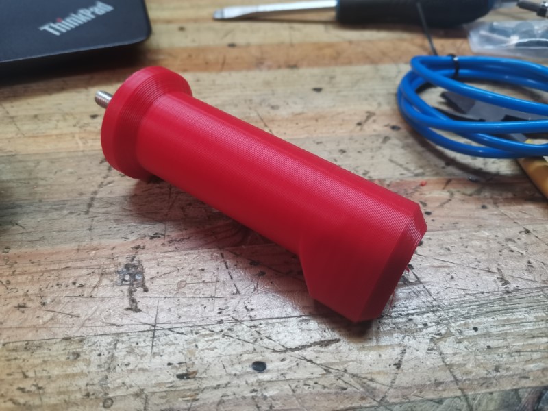

Anyway, I have designed and printed this articulated arm for my laptop a few years ago. But since then, some parts broke (because I printed them too weak, just two layers and 25% infill) and I don’t want to keep using my laptop in the workshop.
My plan was to use a fanless mini PC, because that’s perfect in a very dusty environment, and so I just needed to convert my arm from laptop support to screen support.

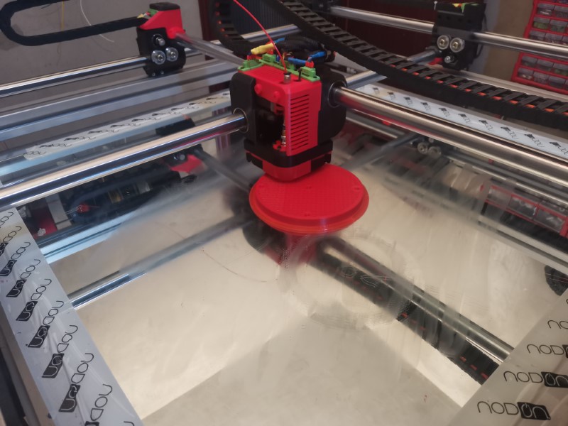

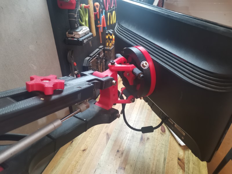

So I printed a few parts, this time with 6 perimeters and 50% infill so they are really, really stong:
I’ve got no visible Z wobbling, the layer consistency and alignment is perfect so that’s really great
Then I put everthing back together:
The screen can be oriented in any position and can even rotate so I can put it in portrait mode if I need to. Sometimes it’s useful for coding, even though I rarely code.
It can be extended quite far:
I can read my favorite forum while keeping an eye on my machine:
And when I don’t use it, I just park it on the high position, so that I have all the work surface available on my workbench.
Super happy with it, it looks great, it feels sturdy and it’s really convenient. The Mini PC works really well too. It’s not a very powerful one but since I’m using it mostly to remote desktop on my server, I have all the server’s power available and all I ask from the mini PC is to be able to start quickly, which it does in less than 15 secs thanks to its nvme disk. Also I won’t ever have to be afraid of dust and it’s entirely silent.

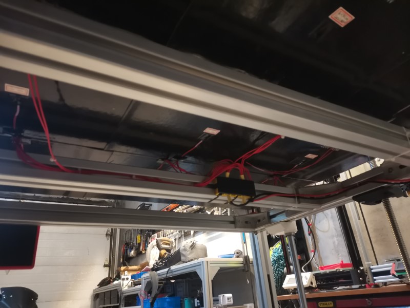

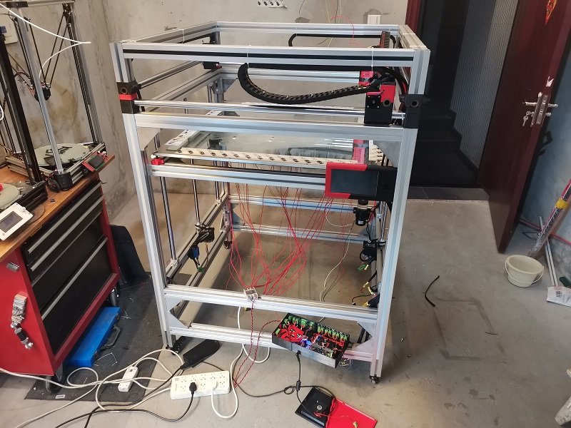

Right now I’m working on the Bed heating… Just done the first test and it seems to work really well.
Only issue I got is that some heating pads heat more than others, because they probably don’t have exactly the same resistance so the lazy pixies go wherever there’s less resistance, hence giving more power to some of the silicon pads. I don’t think it matters much, uneven heat is still much better than no heat at all!
It heats pretty fast, I think it reaches 40-50 degree in less than 5 minutes, I havent really measured yet.
Now it’s time to tidy up this mess.

Yeah, 220V AC pads, 300 x 300 each, 300W each and nine of them in total.
I’d like to avoid having to build a complicated custom board to manage temps, so I’ll first try it this way and see how it goes. Unless someone knows something off the shelf that could manage this kind of application?
Not sure what I’ll do yet, first thing I really want to do is to have bed tilt compensation, then I tend to lean towards the multi material/multi color mod, because a tool changer takes space and I haven’t really accounted for that in my design in the first place. But both are doable so I’m not really decided yet.
i think for a low cost solution you would want to get somthing like this: https://www.amazon.com/dp/B07NP41Z9V/ref=sspa_dk_detail_5?psc=1&spLa=ZW5jcnlwdGVkUXVhbGlmaWVyPUExUlFRVVJTMlRWVDJRJmVuY3J5cHRlZElkPUExMDI2MjA2MVAwS1VOTkMzTzJQTSZlbmNyeXB0ZWRBZElkPUEwMzE5NzA5UlM1RUhXMTFGNzRNJndpZGdldE5hbWU9c3BfZGV0YWlsMiZhY3Rpb249Y2xpY2tSZWRpcmVjdCZkb05vdExvZ0NsaWNrPXRydWU=
then hack it to do what you want.
The simplest would be to buy a stack of the Inkbird temperature controllers. One for each pad. But then you’d have to manually set the temperature before the print starts.
In reality, if you’re using an aluminum sheet as a heat spreader between the pads and the build plate, I can’t see where a hot spot shouldn’t dissipate across the plate. It might be 1 degree hotter or colder in places, but I think I usually adjust my heat plate in 5-10C increments. I don’t think a 1C difference will matter.
Actually I think I have much bigger differences than this, maybe 10 degree C or more. I’ll see if this is actually a problem later.
Now everything is wired and I just ran a first test print: only 4 minutes to reach 55 degree C from 20 degree C, this thing is fast!!
Almost the same time as a regular printer, even faster than some I used… but in this case it’s a roughly one square meter, 25 kilos plate :sweat_smile:
Only Issue I saw so far was that my extension chord got hot during the bed initial warm up, so I’ll have to find a beefier one, but i was expecting that so no biggie.
Bed adhesion seems to have improved, but I only ran a small print so I’ll see with a bigger one.
I’m very happy with that, apparently my calculations were spot on.

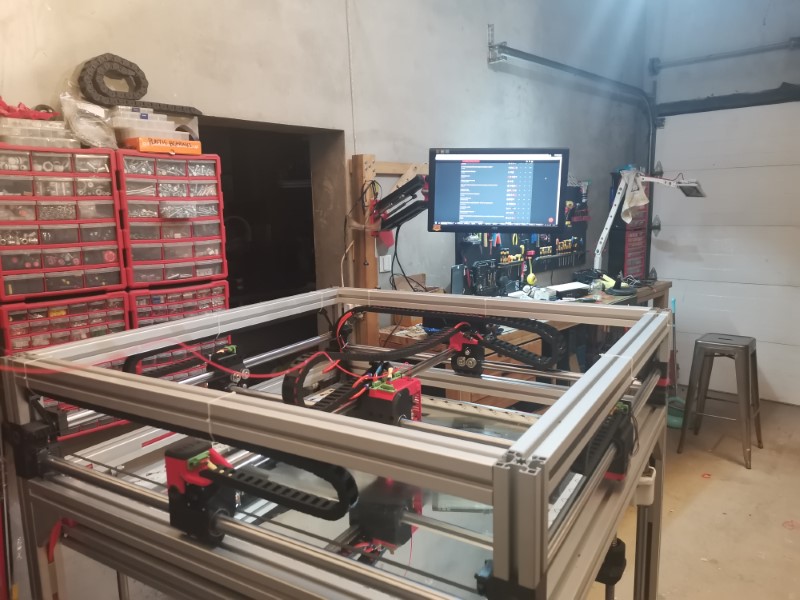

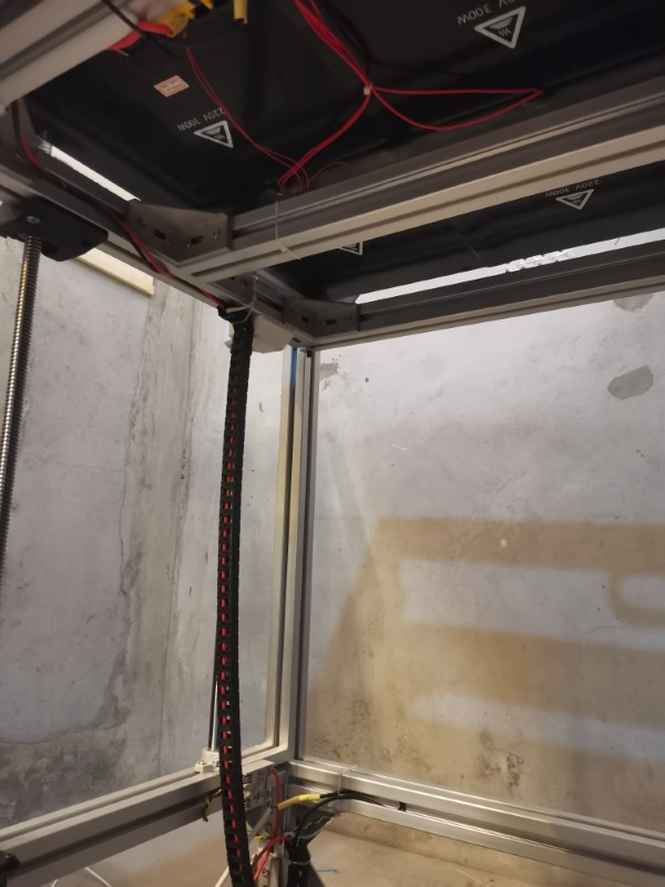

Meanwhile, I cleaned my bed’s wiring so now it’s all nice and hidden. Only things left are to add a earth wire for safety, and to design some kind of enclosure to hide the solid state relay as well as provide support for a mains plug.
Everything works just fine, the bed heats really fast, the temp sensor works and the relay doesn’t seem to heat (I went totally overkill and installed a 40Amps relay so I don’t think it will heat anytime soon).
Now the printer is almost entirely finished, just a few details to be done and then I’ll test, test and test again until I fix every single issue. The goal is to have it totally reliable, I want to be certain that everytime I hit print on this machine I will get a successful print without the need to stay around and babysit.
