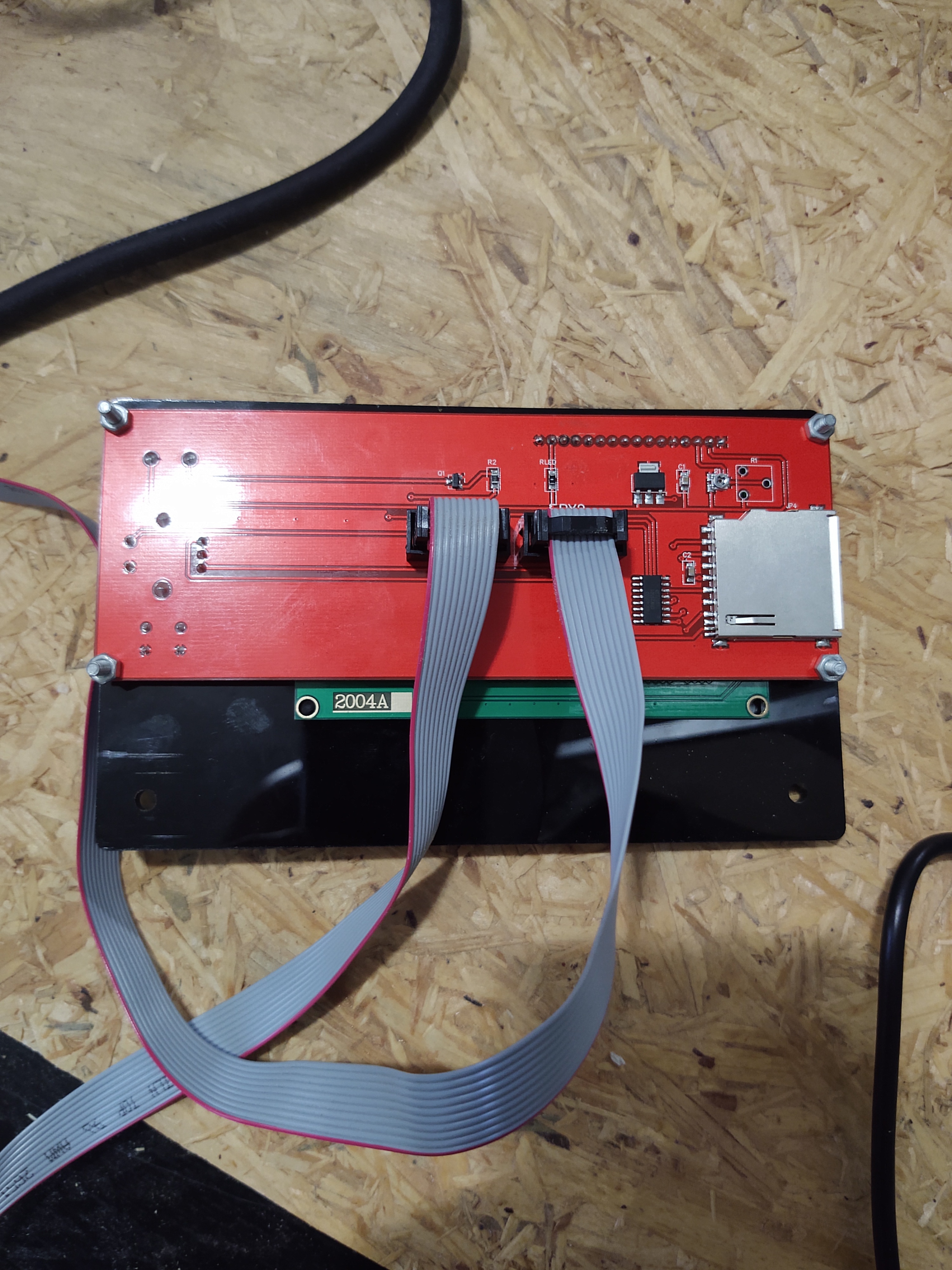

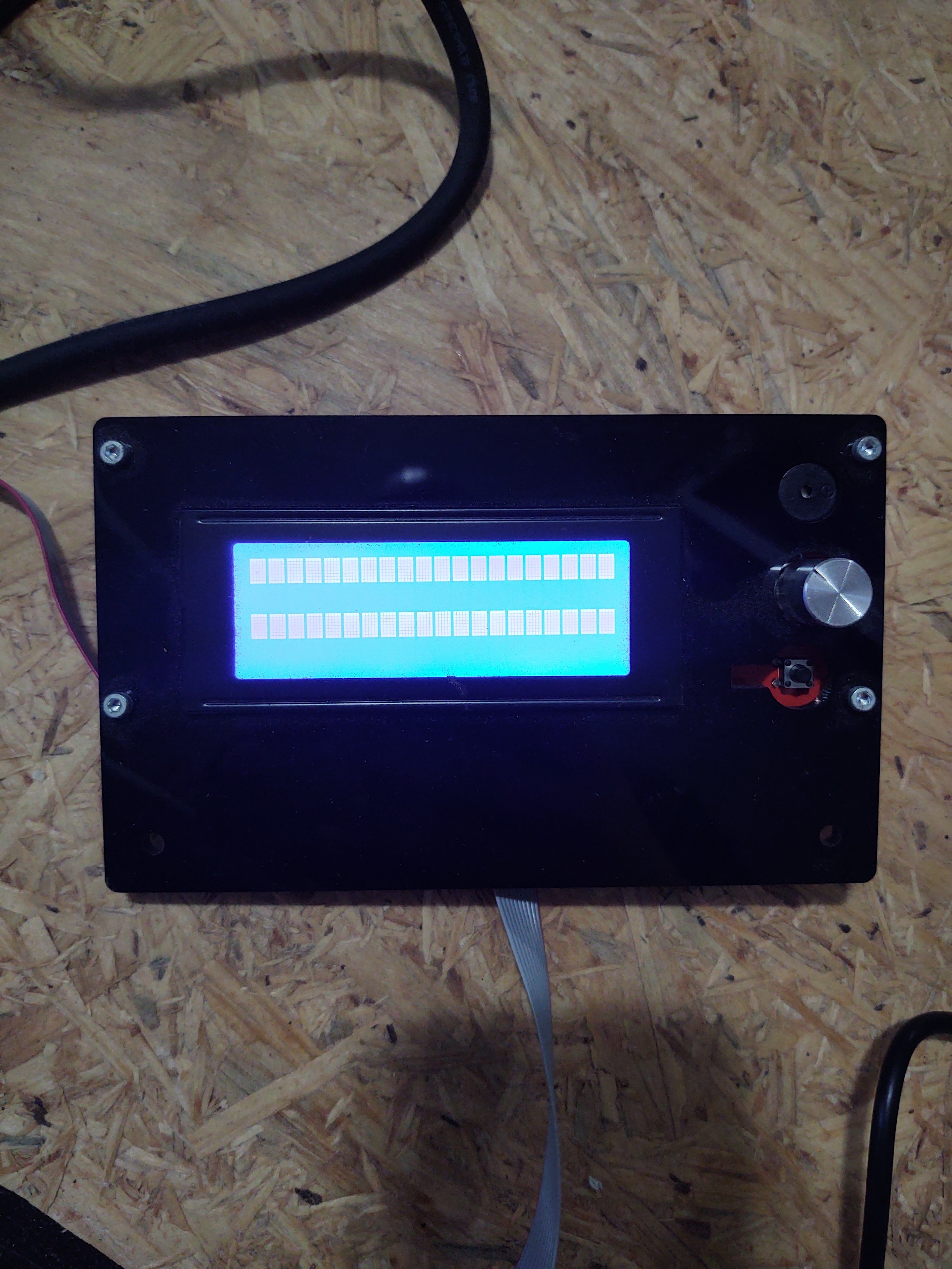

Honestly at this time I have tried so many different things I don’t really know if I have the standard build or the endstops. I am using the Marlin 2.0 I did not add anything in either of the configuration at all. Also in the tools board I have tried using Rambo and Arduino mega or mega 2560. Neither one of them work. At this time I would rather just start from scratch and I just need step by step procedure to get it started. I am completely new to this whole programing thing. I did attached a pic of my board and screen. What you can’t see in the screen is two rows of boxes on the screen.
OK, it looks like you have a standard setup. Three drivers are connected, with the X and Y wired in series to power both motors. No endstops. I’m not as familiar with the LCDs, is that the graphical one, or the four-line character LCD?

Here is what the front looks like
It shows in the back it is a 2004a
Yeah, that’s the four-line character display. I have one. See my edits above. The first change is right at the top of the configuration file, the others are further down. It’s easier to search for the names.

My cnc machine works but my screen still looks the same.
The screen may have a knob to adjust the contrast.
If you look at my picture that I have displayed above there are two sets of boxes going all the way across the screen. Right now I can run the program on repetier host. I am also wonder if there is any other good programs out there that any one else use. Does anyone know any good program to transfer jpeg to gcod? I am just starting off with this whole programming stuff and need a lot of help to get this cnc machine running.

For that, all I can suggest is flipping the connectors, and try it with the cables in the different positions. You can’t hurt the display (or the board), and one of the configurations is going to work.
I have flipped the connectors around and still all i get is screen off or the boxes all the way across the screen.
you mentioned this I am just trying to get clearer guidance on it is all.
Oh… Did you make the changes I detailed before? Those three before/after edits?
That should do it.
Well, that and rebuilding/reflashing it… :wink:
Yes I made the changes it worked for a little bit. But the lcd screen still looks the same as the previous picture. I did get it to manually move a few times on repetier host then it stopped working. I have also got it connected to estlcam but I can not run it. Any solutions on any of those programs?
