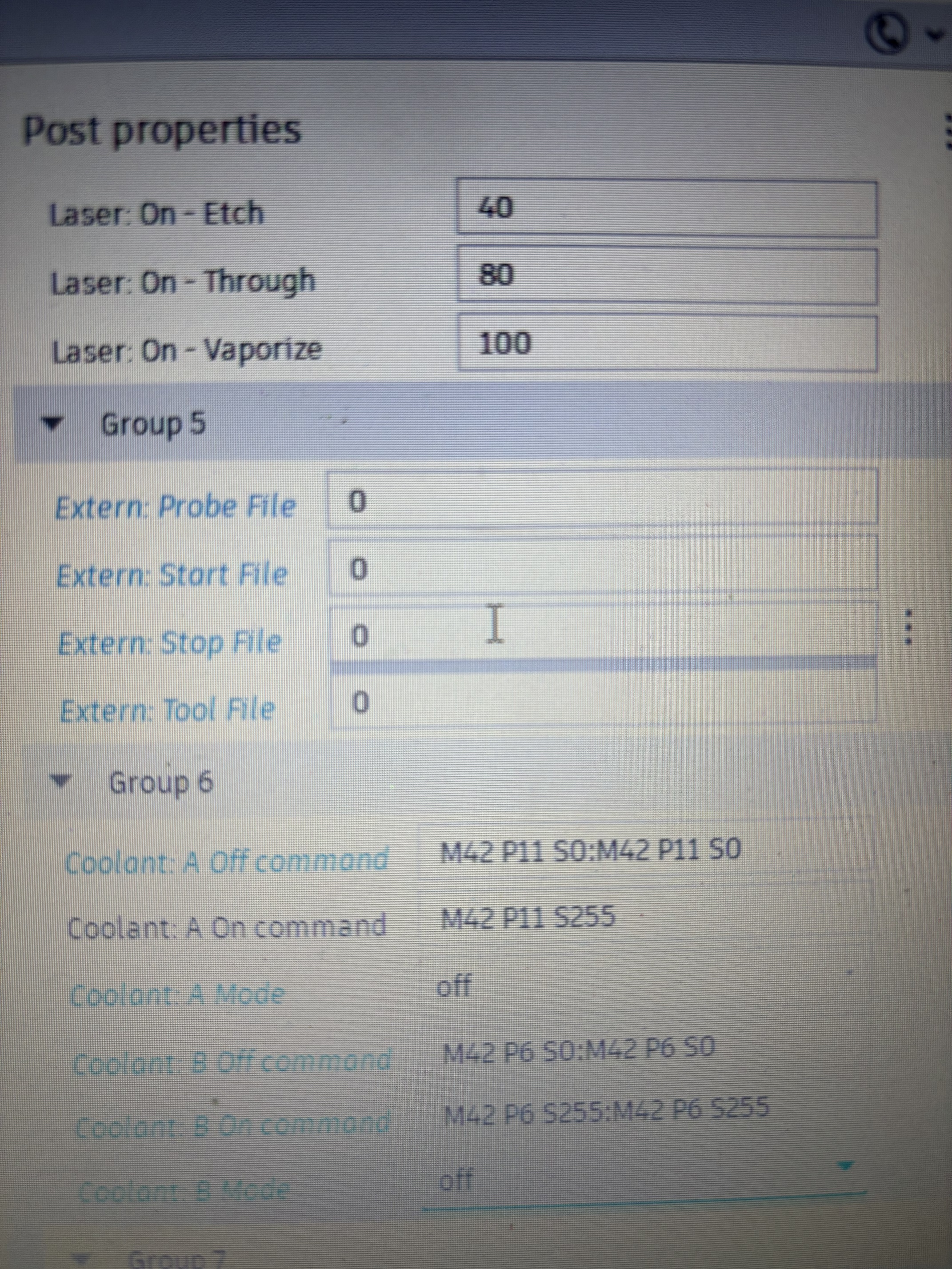

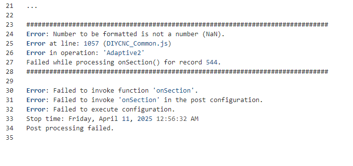

Anyways i am setting up my mpcnc marlin setup in f360, i do not know what i am supposed to put in these boxes. Due to leaving them default (/metric?) or blank i get the error code is Vs code at the end of my file path /metric? Failed to open…
I am looking for (i think lol) External probe file, External start file, External stop file, External tool file
Check this topic:
this does not tell me what to put in those boxes in the center of my picture.

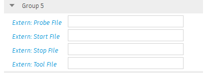

The boxes are optional if you want to add custom start or end code. You need to add the filename of your code. It should not trigger any errors if it is blank

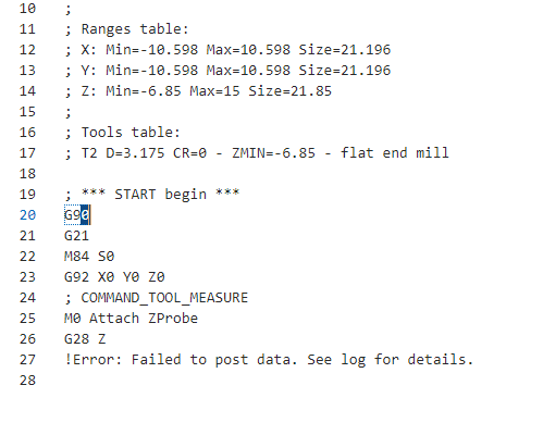

this is what happens when i leave it blank.
i just downloaded beta 3.0 and it worked perfect LOL
:wink: that’s why there was a 3.0
