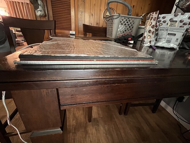

Waiting on new calipers to come from Amazon. Old pair didn’t like the fall from the LR3 table the other day. But I did just take the level and go along each of the 4 sides of the plate and I can see it on the x+y+ corner is low. Ok so what do I need to change to not have this problem with the next plate??

Are you sure there is nothing between the plate and the magnet? I can’t believe that backside is so twisted. Way more than I have ever seen.
This suggests you might be squishing your insulation. Ate your bed to plate screws in so far your insulation is touching the mounting plate? I am looking at that front bulge, two low corner touchpoints and a bulge in the middle as if something is pushing up.
Also, is your bed free to move on the mounting plate or do you have it rigidly mounted as the thermal expansion is buckling the bed?
That also actually explains why your 3 leveling points are negative. After physical leveling it rehomes Z and on yours the middle of your bed is about 0.1mm higher.
This could be. It was down on the insulation. I used the longest M3 screws i could find but i think they really need to be longer. And probably double up or get stiffer springs. This bed isnt light
I didnt have it pulled down super tight. But it still may have been too much. I dont think anywhere in town will have longer M3 screws so ill have to order some and give that a try. While im at it would stiffer springs be a good idea since this bed is so heavy?

I took the plate off and put it on the kitchen table. Not precision flat by any means but it’s what I have lol. No wobble at all from any corner.

As far as the green arrow it did not have much room for movement due to it being pulled down on the insulation due to screw length…or lack there of
Three longer screws might just fix the issue. Your insulation should not touch the mount plate. That include the bulge from the wires which can casue a twist.
I used M3 screws. Is that the recommended size or should I step up to a M5? I will have to move the mounting hole away from the edge to do that but that’s not a huge deal. I have a new 310x310 PEI sheet here that I can install.
