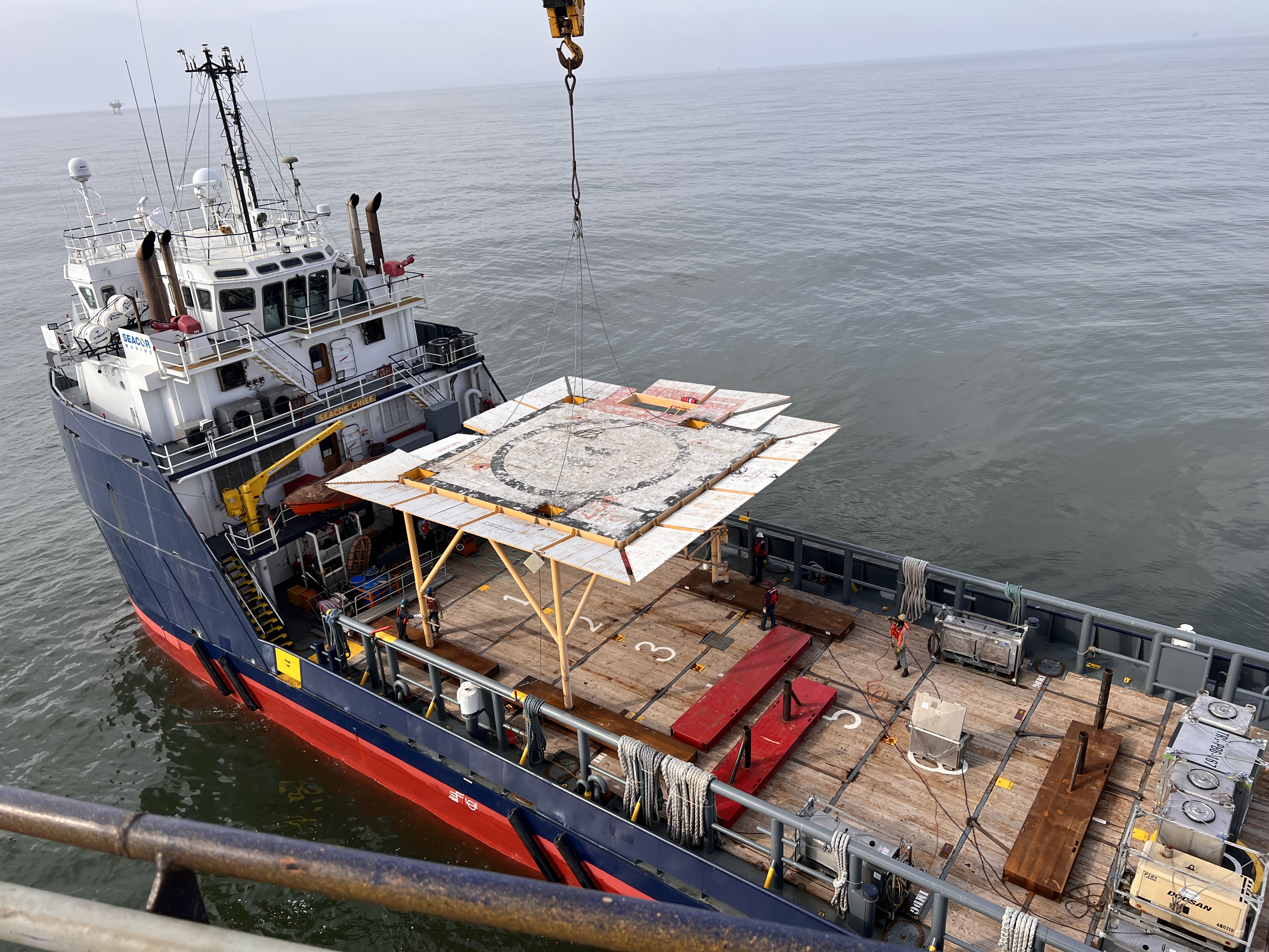

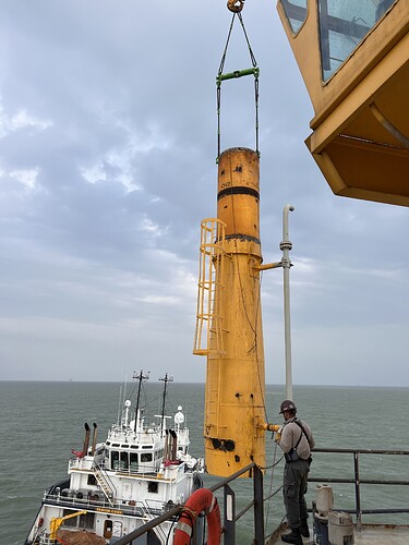

Platform removal…

That is so crazy!
There’s you a crazy one. 8’ from the platform. Parked at night. 30 mph winds. Hell of a cross current and this boat is all manual control. No computer/dynamic positioning here lol. Also that platform deck is 53’ in the air.
That sounds impossible
Lol. You can do a lot with 3,000 hp
