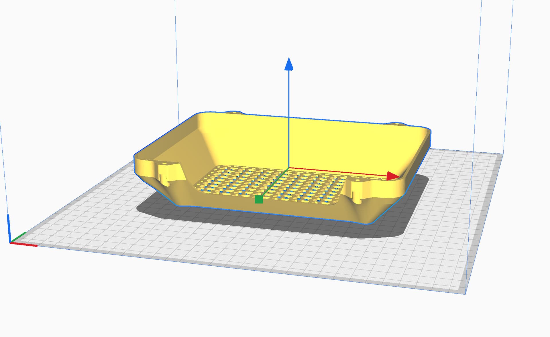

Now i have to figure out the orientation to print the lid LOL
I’m assuming like this…
But it looks like it will have to have support for the 4 bolt holes. But support isn’t your thing so I’m not real sure about that lol
They are sloped towards the holes and there is minimal bridging, you should be able to do it easily. :slight_smile:

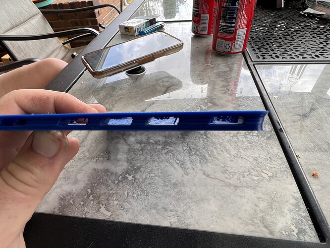

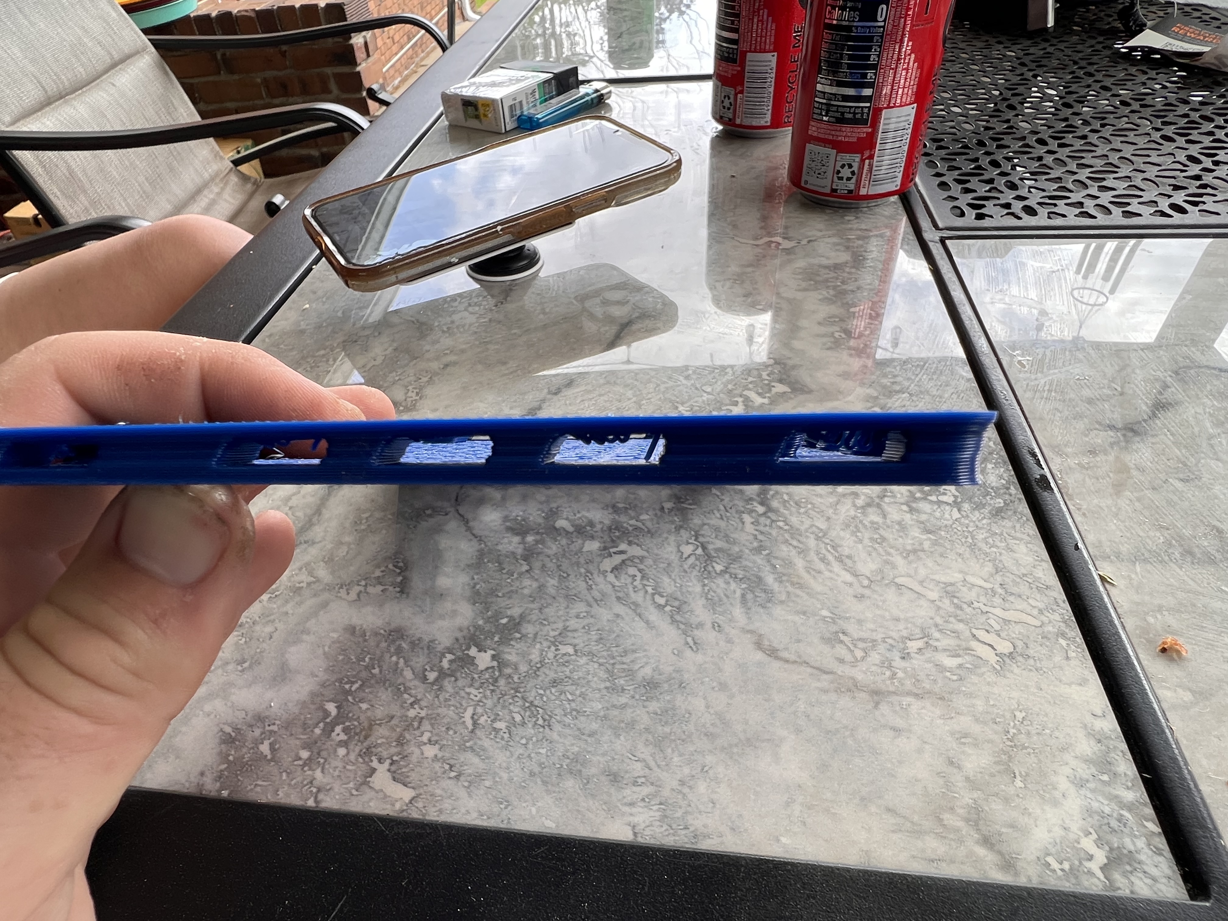

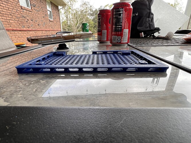

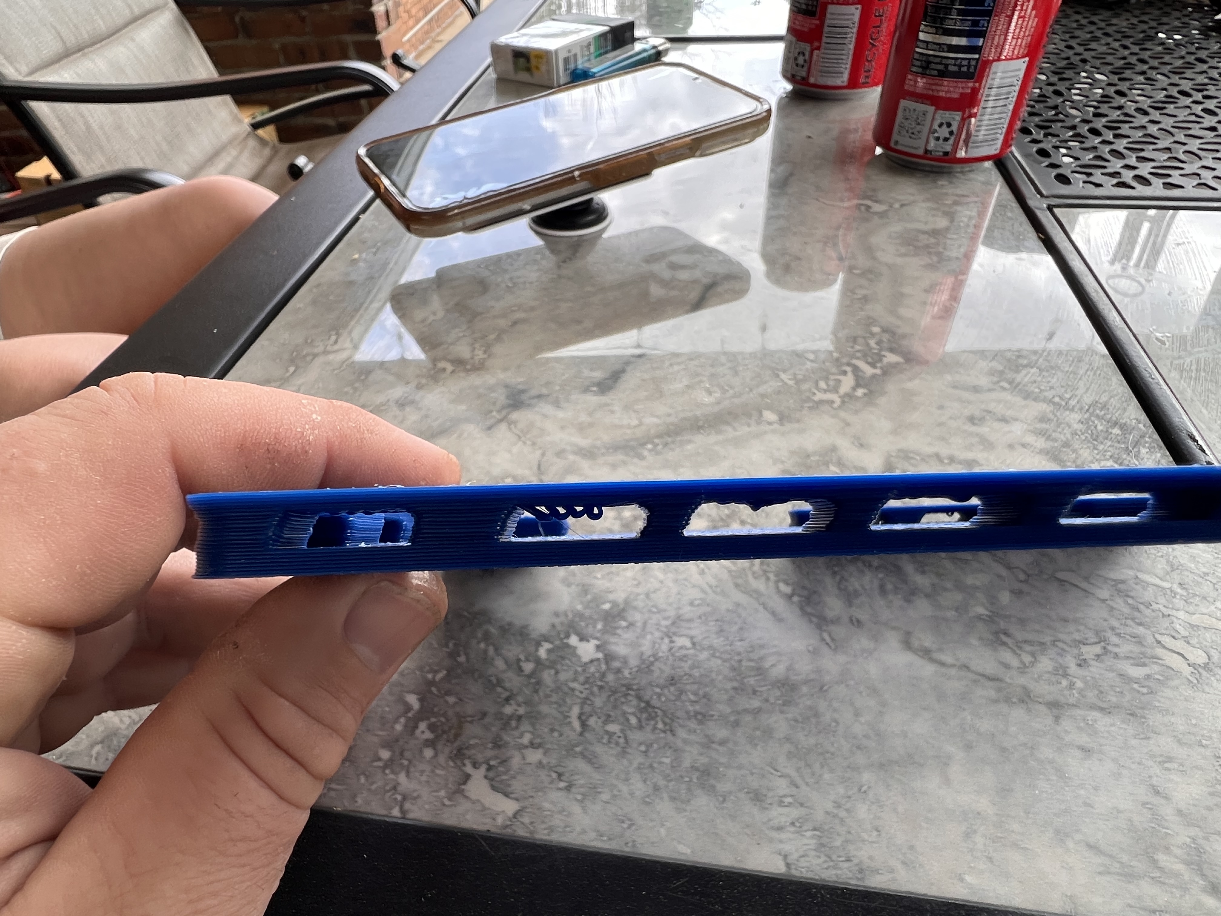

The base just finished. Looks like I have some tuning to do…
What’s crazy is it didn’t layer shift until after the bottom was completely finished. All those tight turns and it did just fine. Part cooling was at 100% so not sure why I got the droopy bridge

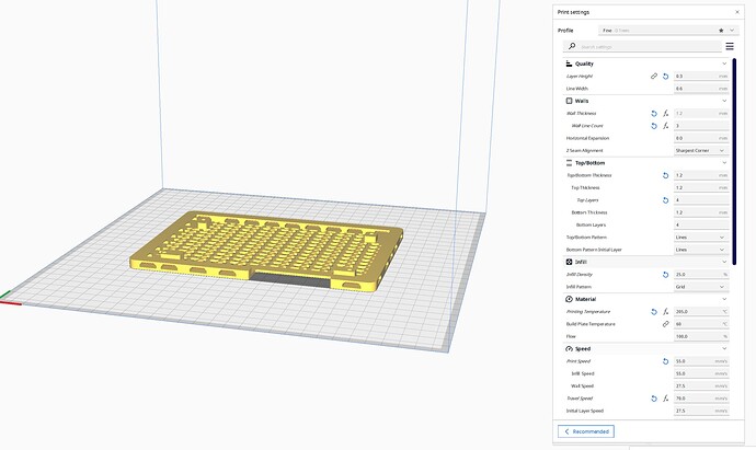

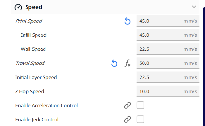

Print settings…

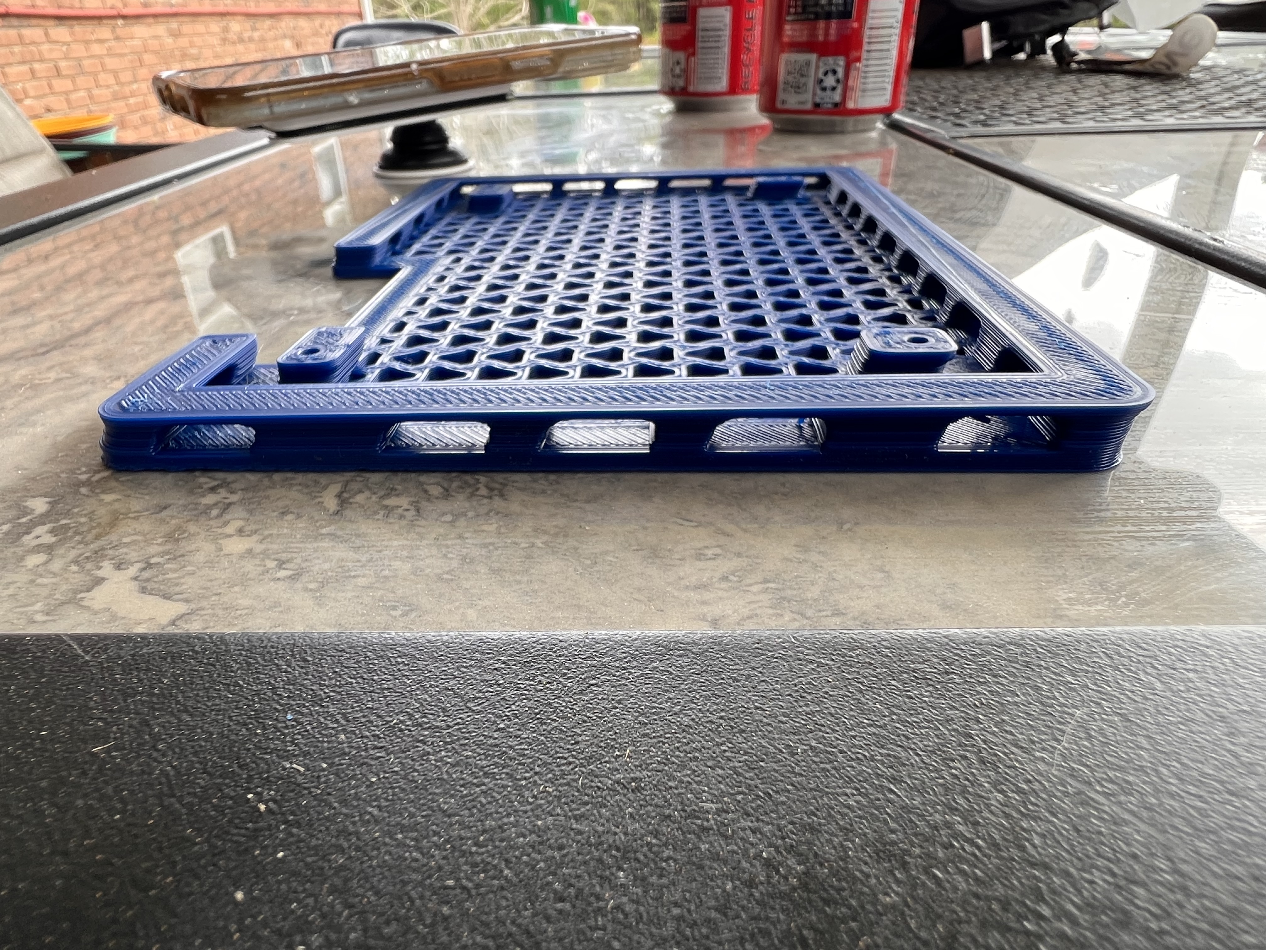

Its warming up to try again. I slowed it down just a little. Also loosed the belts just a touch. The X motor was a little tighter than the Y. They are now as close as I can tell by hand. Also bumped the current from 725 to 800mA. After 2 hrs of printing earlier they were barely warm.

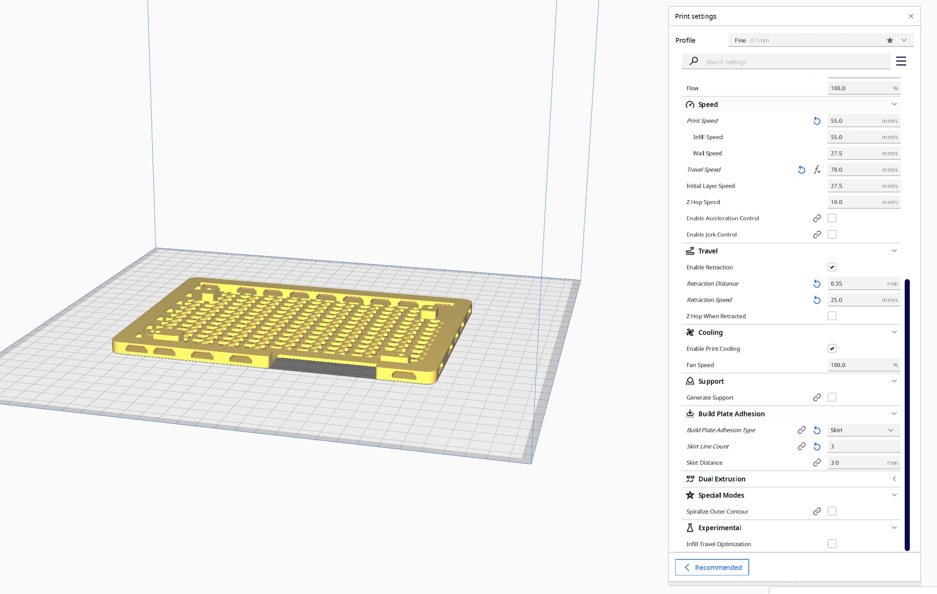

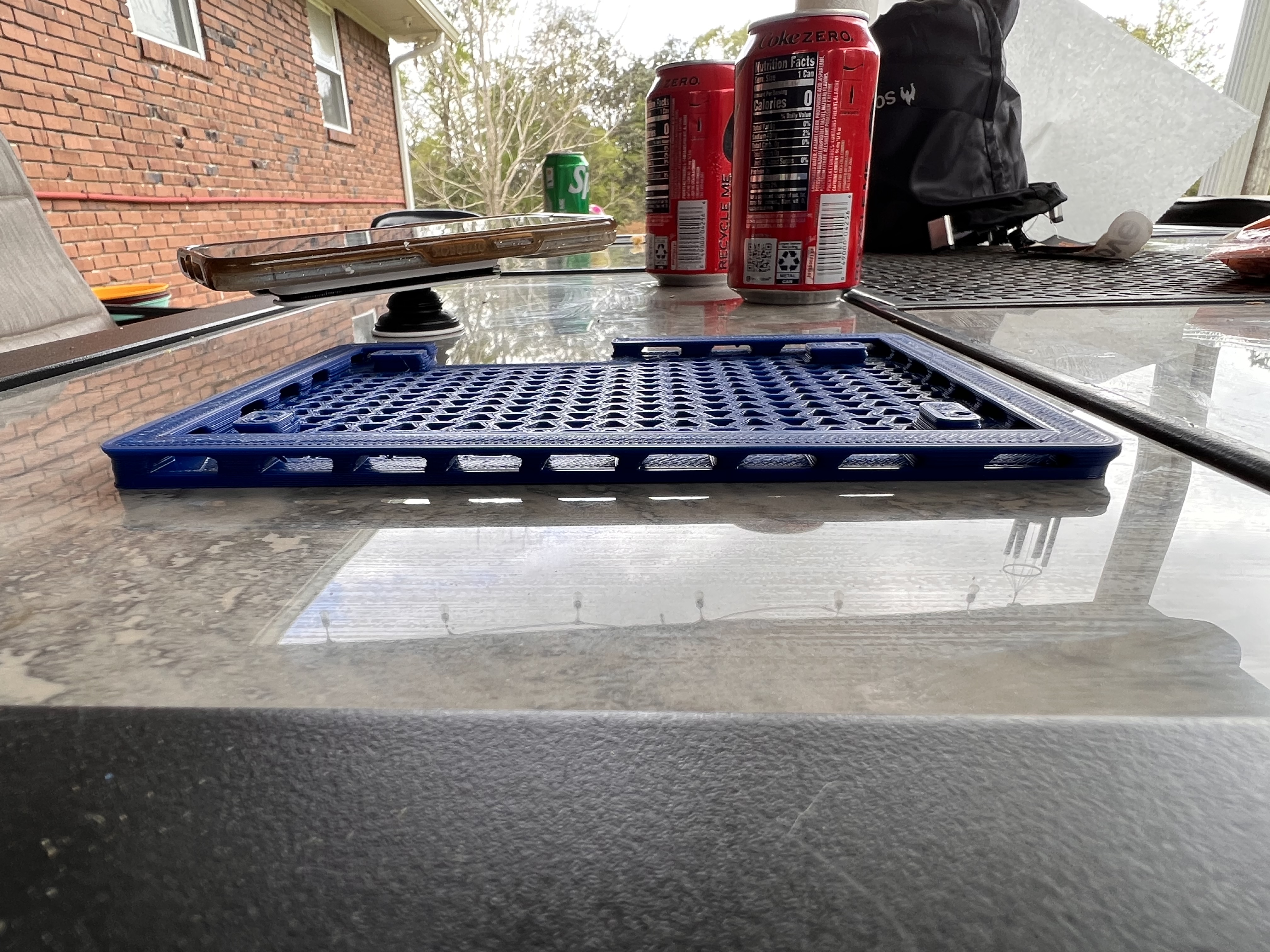

New print settings…
How did you get a reverse elephant’s foot?
I would do some calibration prints. I first test and sexy XY square, then I test ZX and ZY square/tram/perpendicularity. But it actually looks like you might have some other extrusion issues as well.
Not sure I’m seeing what you are on the reverse elephant’s foot. I see a pretty defined one. Need to bring the offset up just a touch. The layer shift was what I was mostly looking and and trying to correct. But I agree I do need to do some calibration prints for sure. I will work on that after this second wire tie finishes. Hopefully successfully this time lol
Is your mesh really out of whack? I think the firmware has that fade out parameter set. If it was really wonky, it would squash it (without the fade out, it would be a parallelogram, so not the fade outs fault).
I don’t believe it’s that far out. It looked like layer shift to me. It was at a 45° angle from x and y
