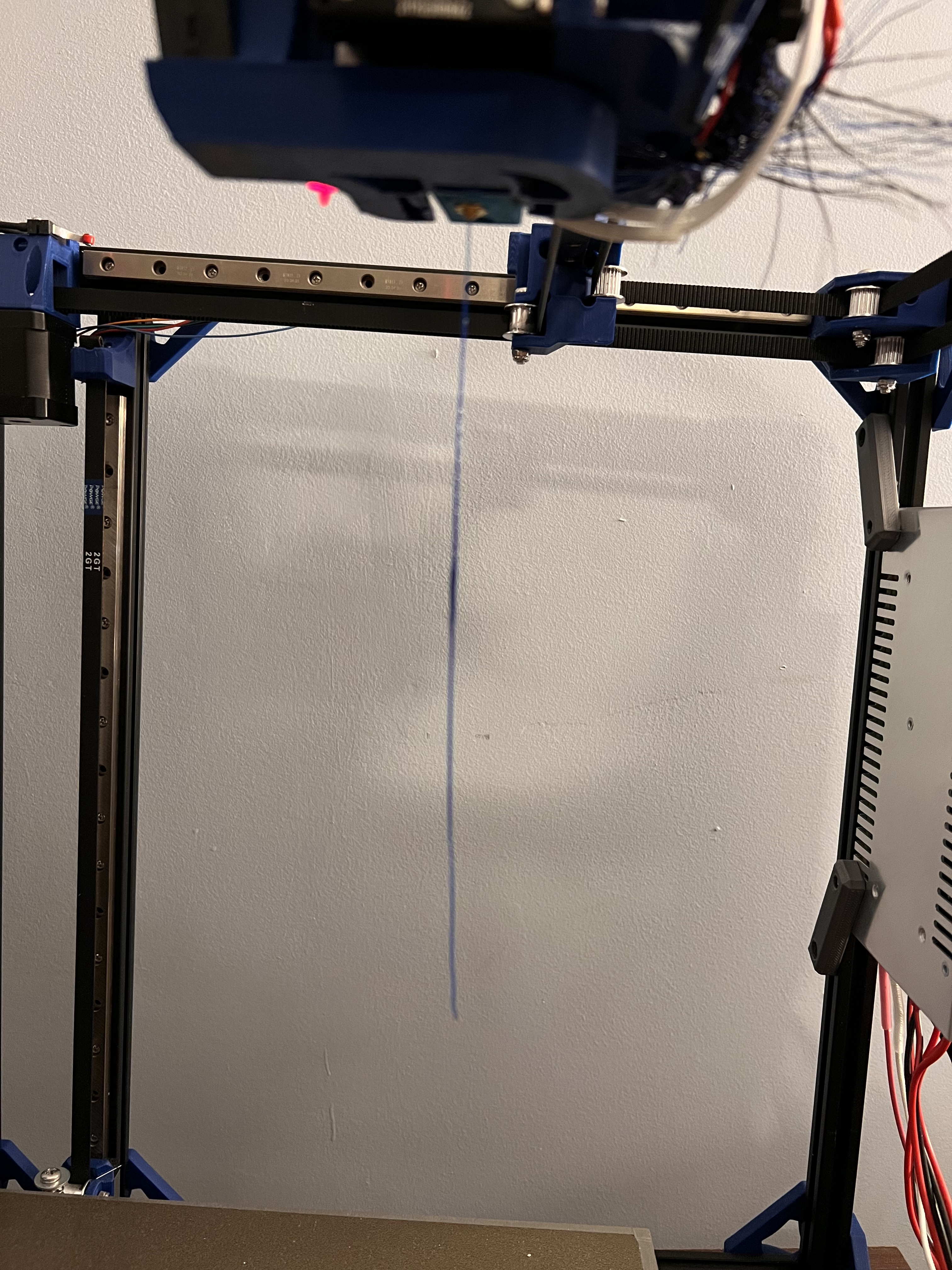

Woah. The sudden bed drop at the end was bit of a shock.
Someone already found a TPU self inflating whoopie cushion on Printables? Or mechanically attached counter weight(s)?
Yeah it doesn’t like to error lol. I cant remember who but some have installed springs to help in the event it falls like that.
Maybe some tennis balls underneath it :slight_smile:
I wonder if we could convince Marlin to not disable the Z motors on an error. Because there will be occasional other errors.
Maybe there is some kind of eddy current braking system with some setting magnets and some iron rails. It will only slow down if it is moving fast.

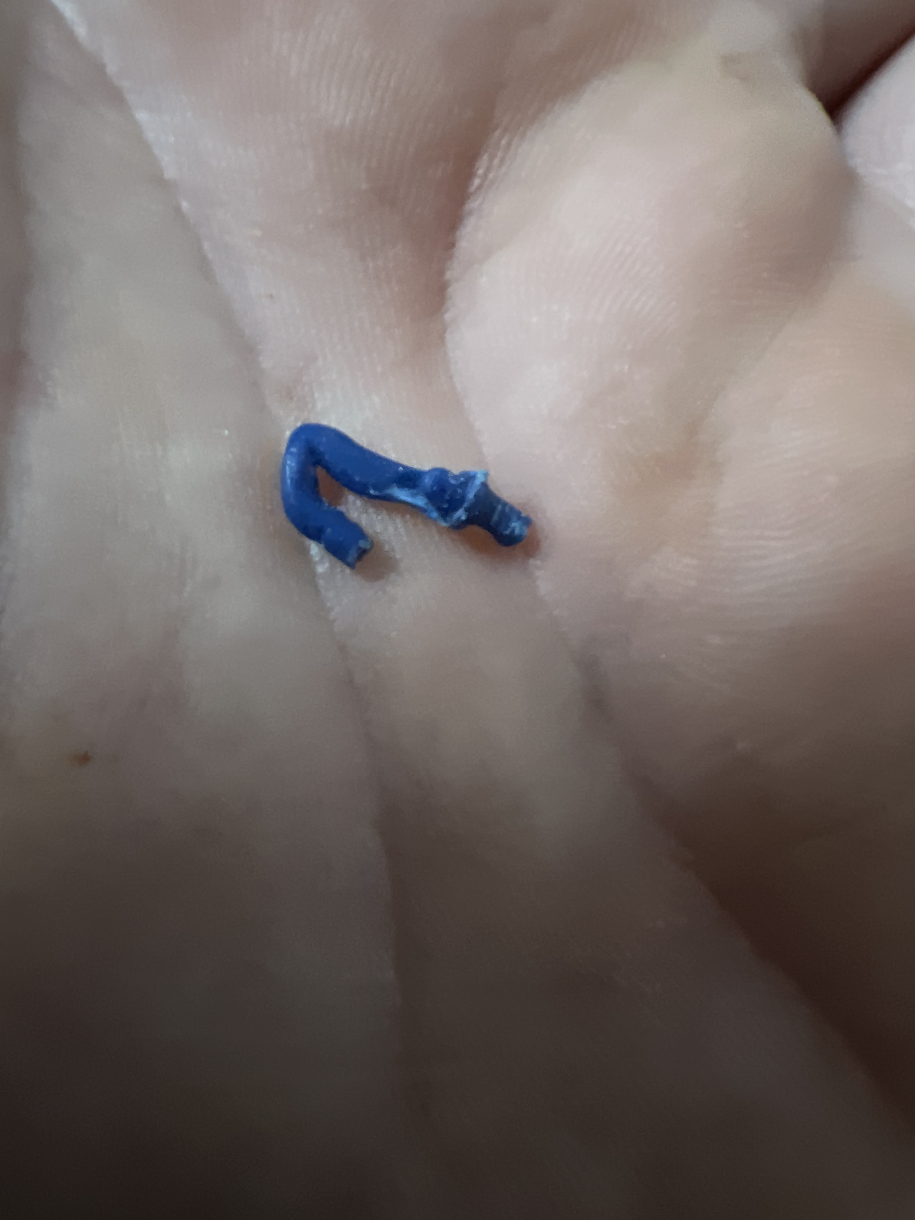

Found the jam…
Had to disassemble the extruder to get to it. Not a bad job really. Just a little intimidating since I have never done it before and this is the most expensive extruder I have ever owned lol
She is extruding again!!

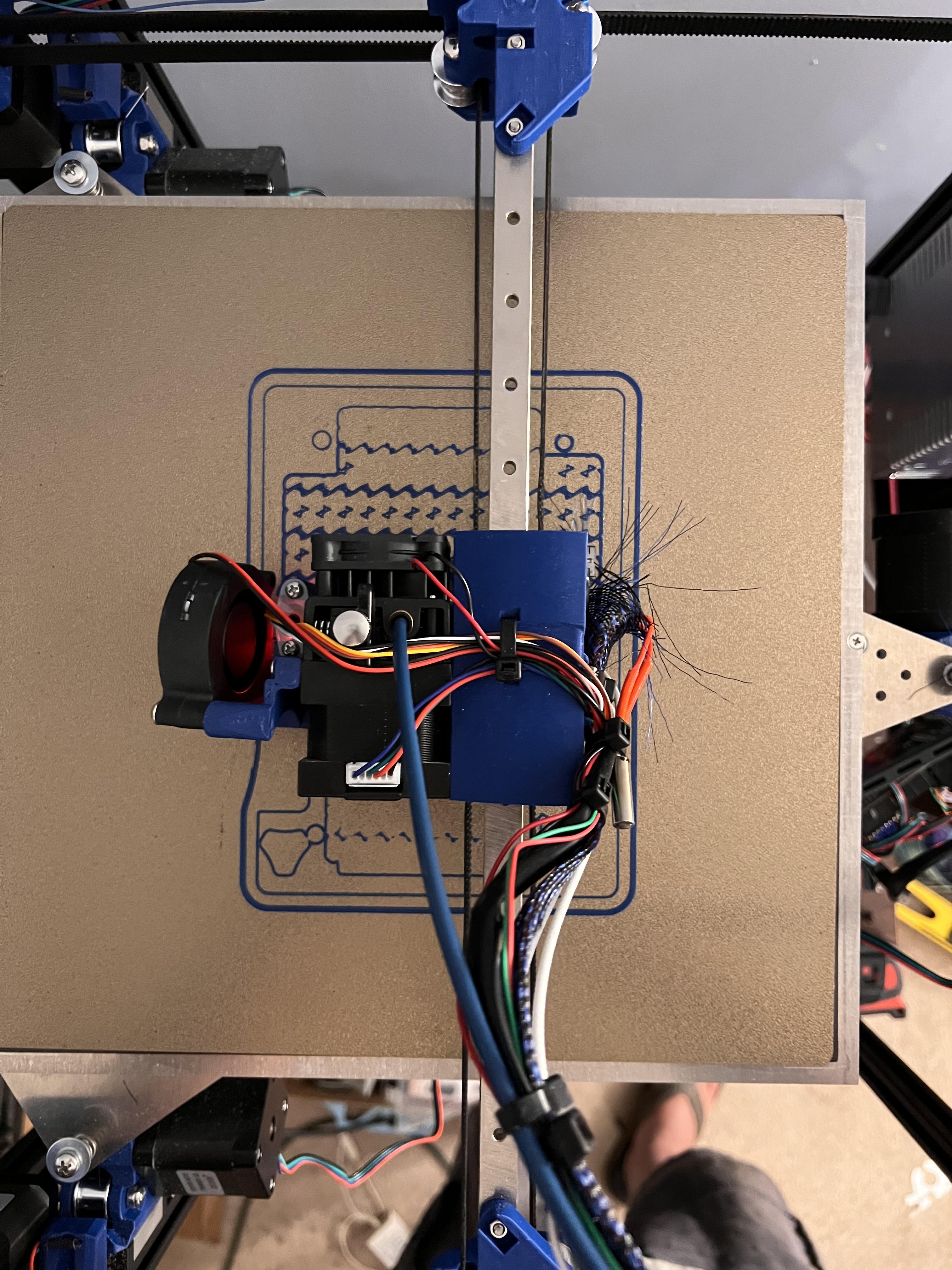

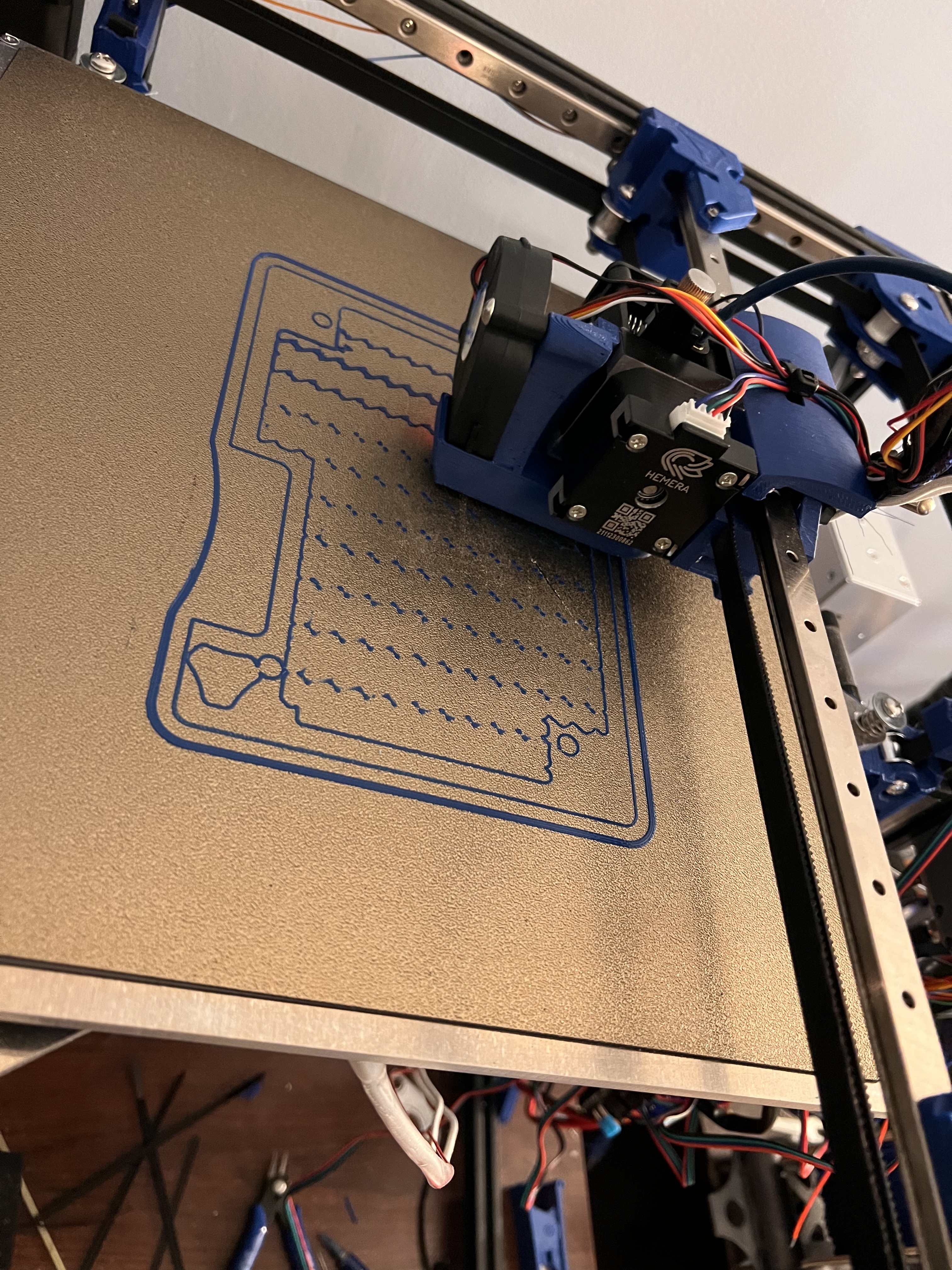

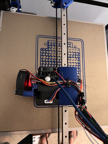

Leveling for a print now. Wish me luck!!
Little first layer porn…
You jumped in with the most insane first layer part I have ever made…just saying. I think that proves your leveling is spot on.

This looks a little suspicious, your ptfe might be a touch short and leaving a little gap for soft filament to flow into. If you get any more clogs swap that out for a tighter fit.
