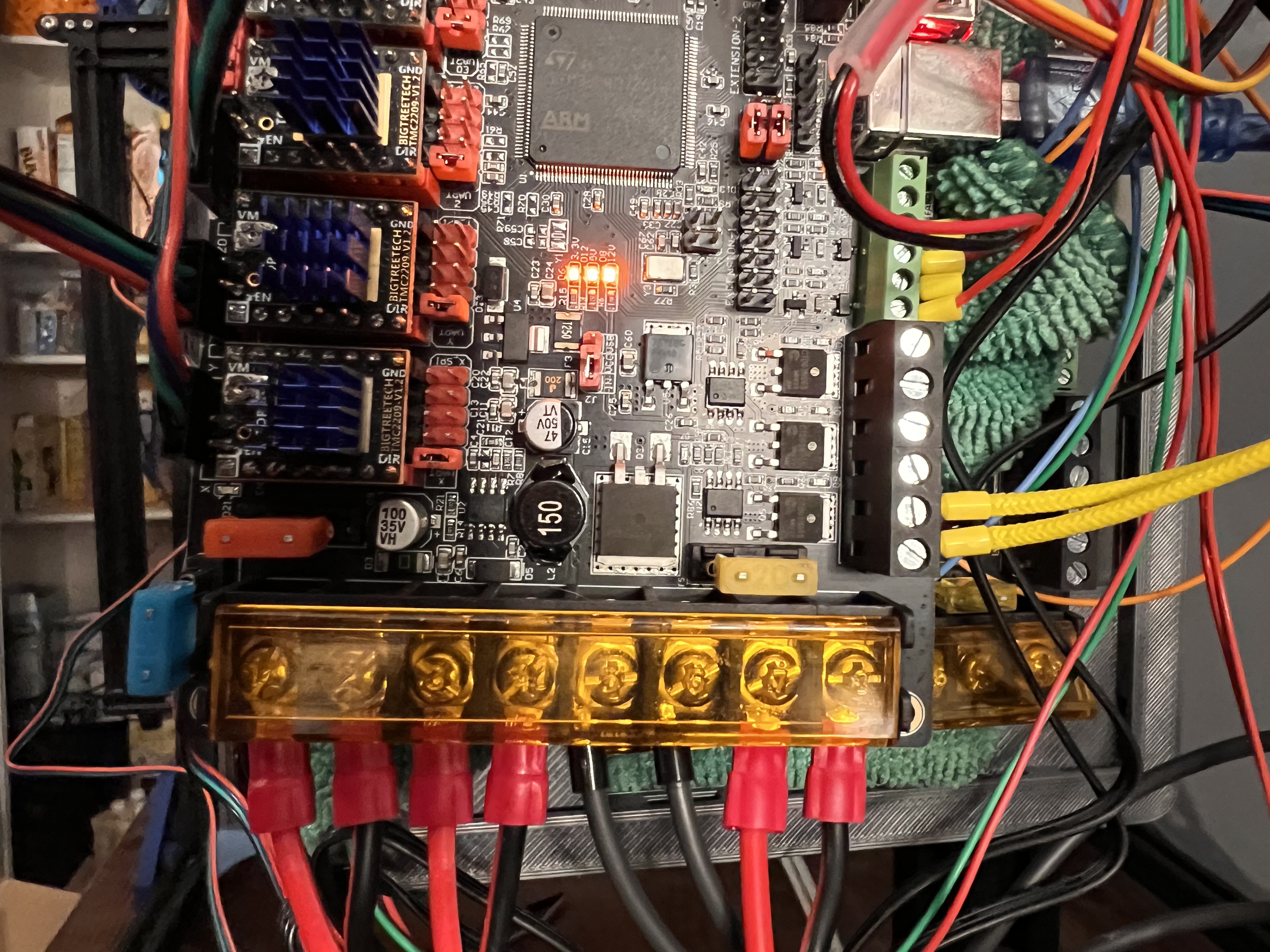

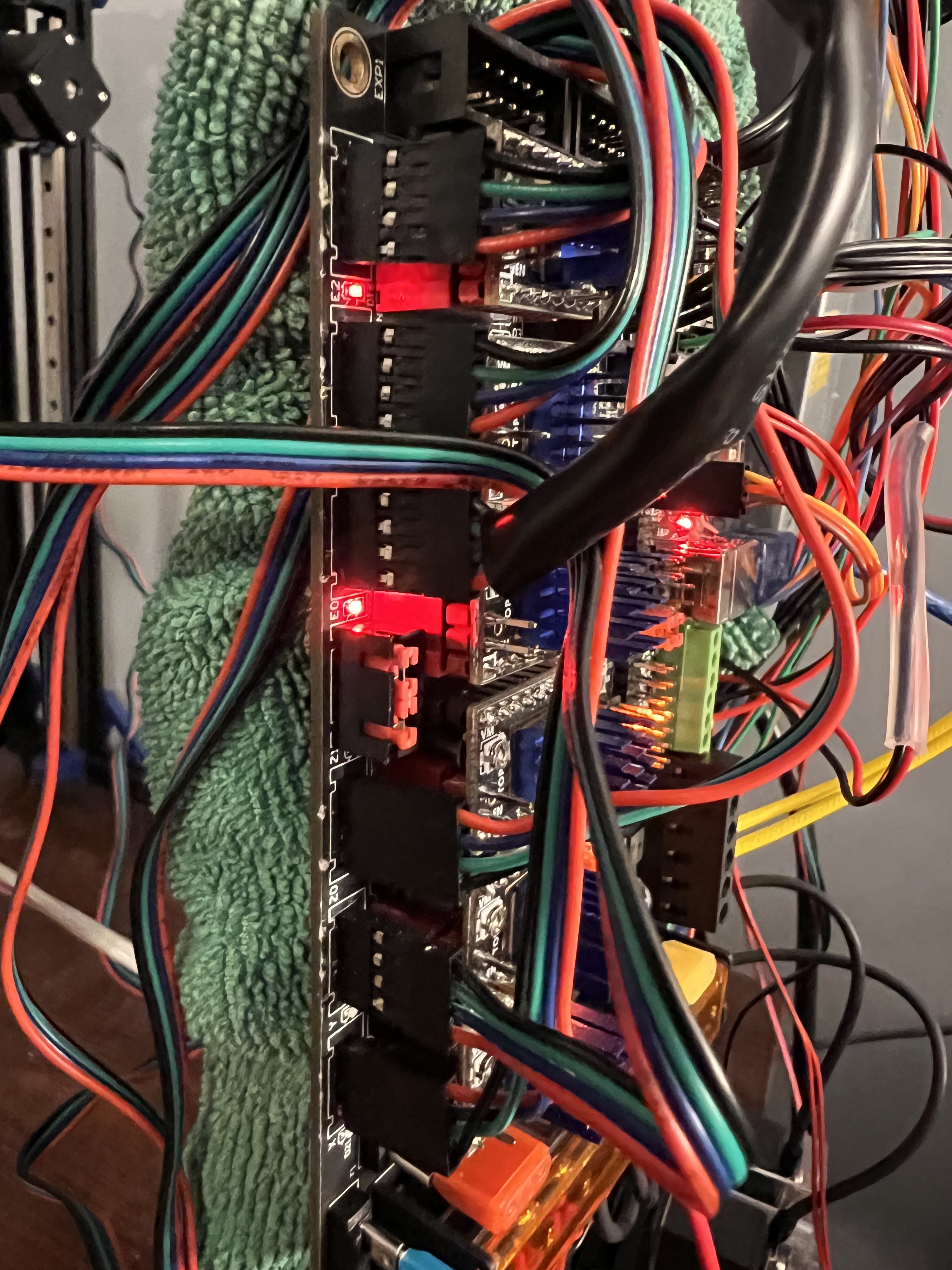

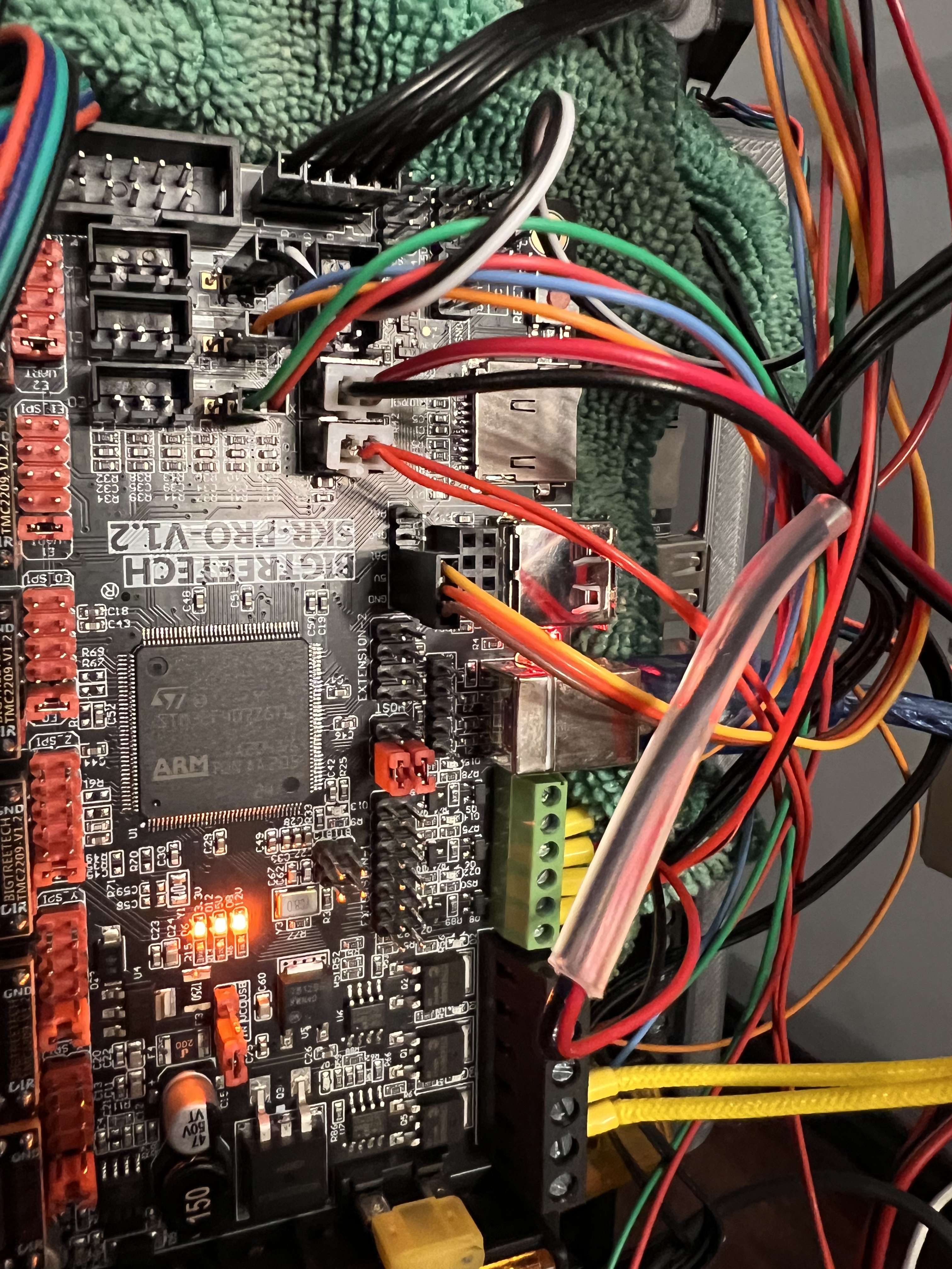

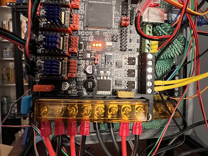

Its running a mesh now. The mesh is going differently than it did on the other firmware. much much slower. I’m thinking about putting the 515 on it and see if that changes anything. I’m going to warn you I’m not proud of the wiring at all but I will snap a few pics and edit and add here

All the plastic deals were removed from the board. I know its not mounted…one of the first things i hope to print is the new case design and in my haste to see if it would work I didn’t take the time. But none of the wires are loose. Everything turns the correct direction. Only thing that could be off I suppose is a Z stepper in the wrong position but I will triple check that right now.
Yep… They are correct
