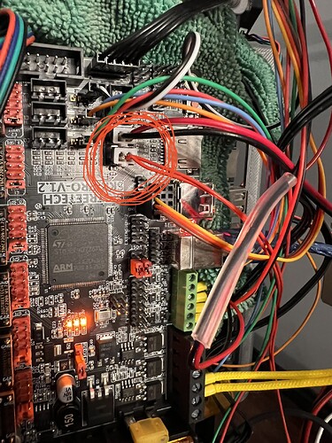

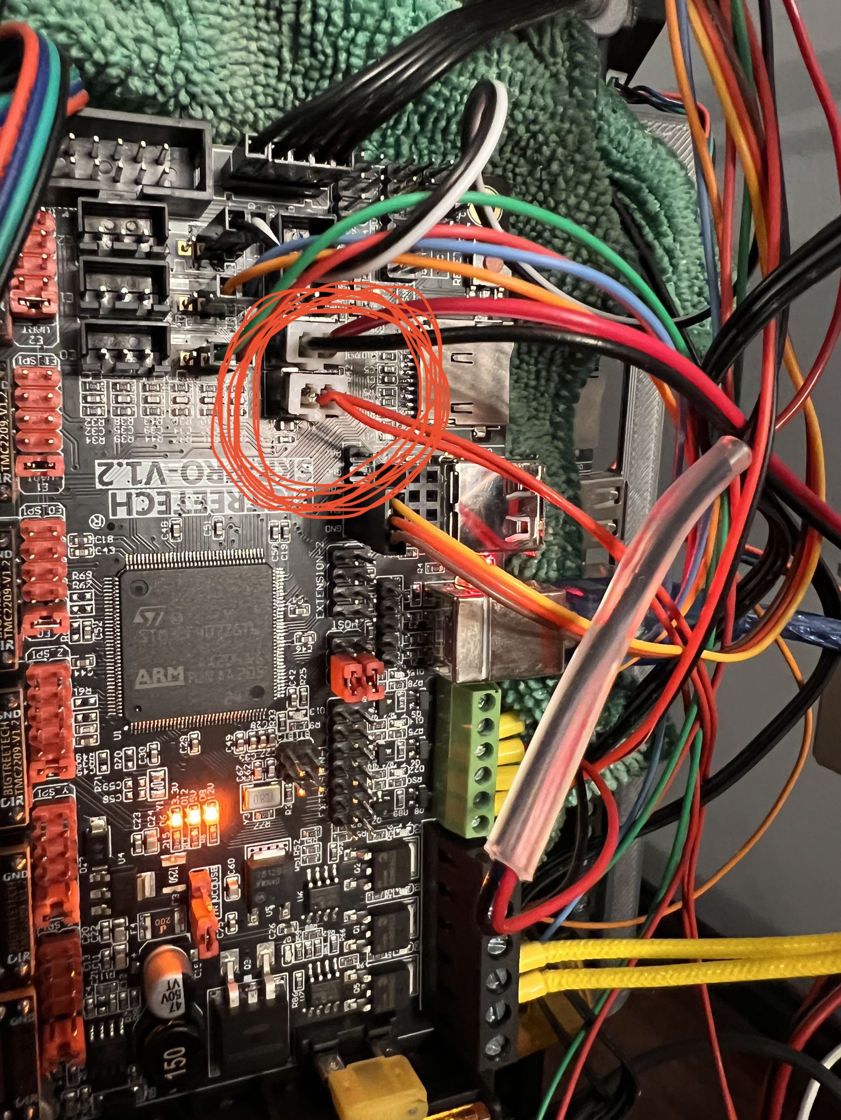

Are your thermistors showing temps for the bed and nozzle?
I am running that gcode right now, it works.
Make sure your bed is the bed therm etc.
I totally missed that earlier

New issue now. Hot end doesn’t want to heat up. It was heating for several min and only made it to 138° before it errored out. I’m going to check the wires and all. Might have mangled something fixing the hot end the other day and didn’t see it. I have spare thermistors and heater cartridge’s at least lol. always something. Will report back ASAP
Make sure the thermistors are right. If it was actually the bed that would make sense.
Bed in 1 hotend in 2

Everything looks fine but I’m putting new in anyways. I had ordered them when I hooked the thermistor up to the fan port when I originally built it lol. It looks exactly the same as what I took out and on the listing said it worked with the Hemera

Make sure they are not just loose first. Sometimes that happens.
They were not loose at all. Idk what happened. But its been replaced now. Idk what’s going on with it though. took 2 tries to get the hot end to temp and now its erroring before the bed heats up. I’m going to unplug it and plug it back in and try again lol. Would be nice if this would just start working at some point.
ok i got the heat issue fixed. I cant believe what it ended up being. My power supply was only putting out 23v. I bumped it up to 24.5 and it heated up like normal.
