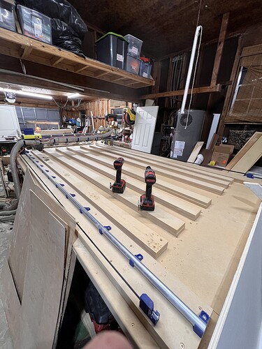

Finally getting the spoil board right on the LR3
