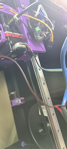

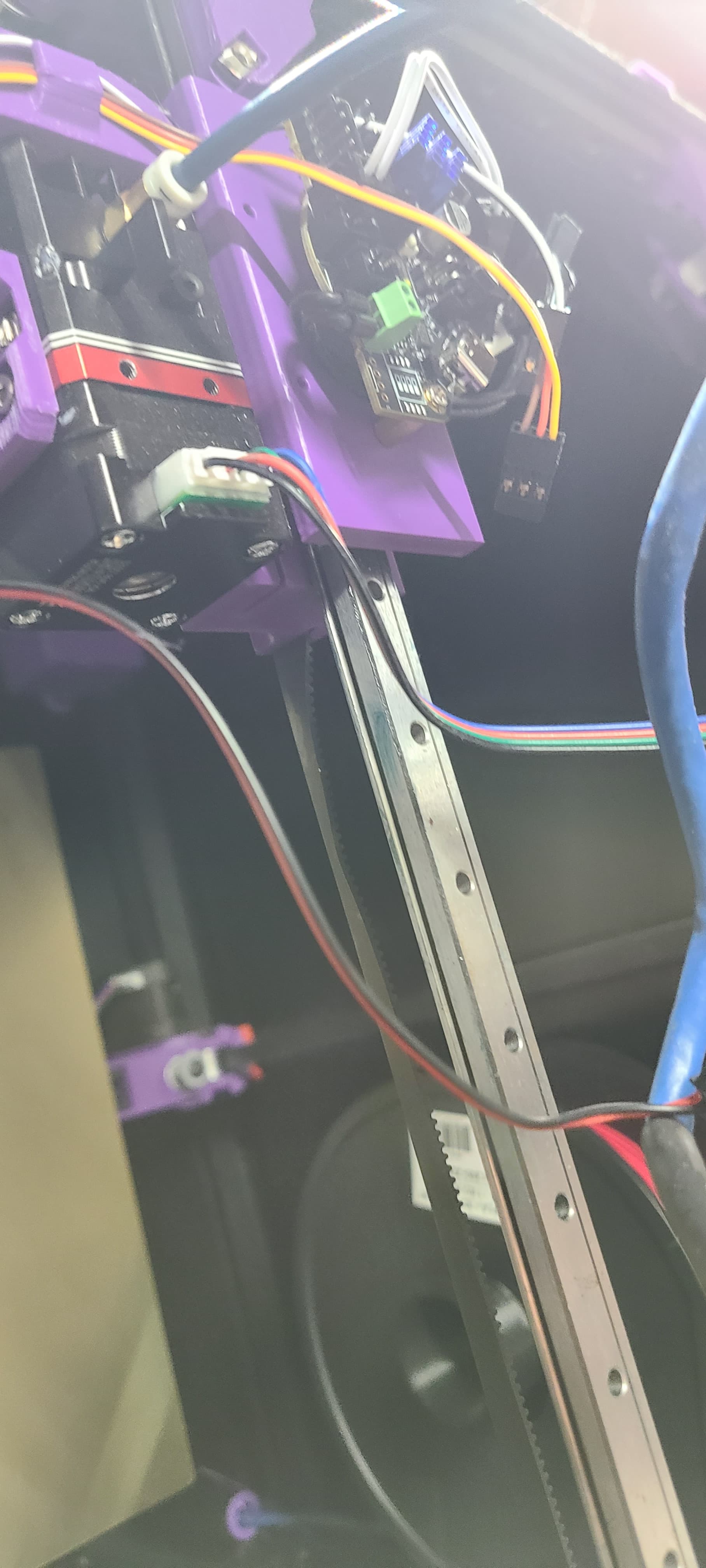

First test fit on my new Revo H2 mount. This is the point when I am glad I have more than one printer.
It all seems to be perfect and then you discover that measurement you missed!
Adjusted the model and printing on my Ender 3. Happy I did the KevinAkaSam belted Z mod on it!

Cheers for sharing progress on your X Carrier mod, and for mentioning KevinAkaSam belted Z mod, that looks like a neat way to improve Ender quality.
@azab2c itbisbpretty neat. Much more stable. Having an issue with a repetitive band right now. Something is hanging ot up and it steps.
@azab2c Here you go!

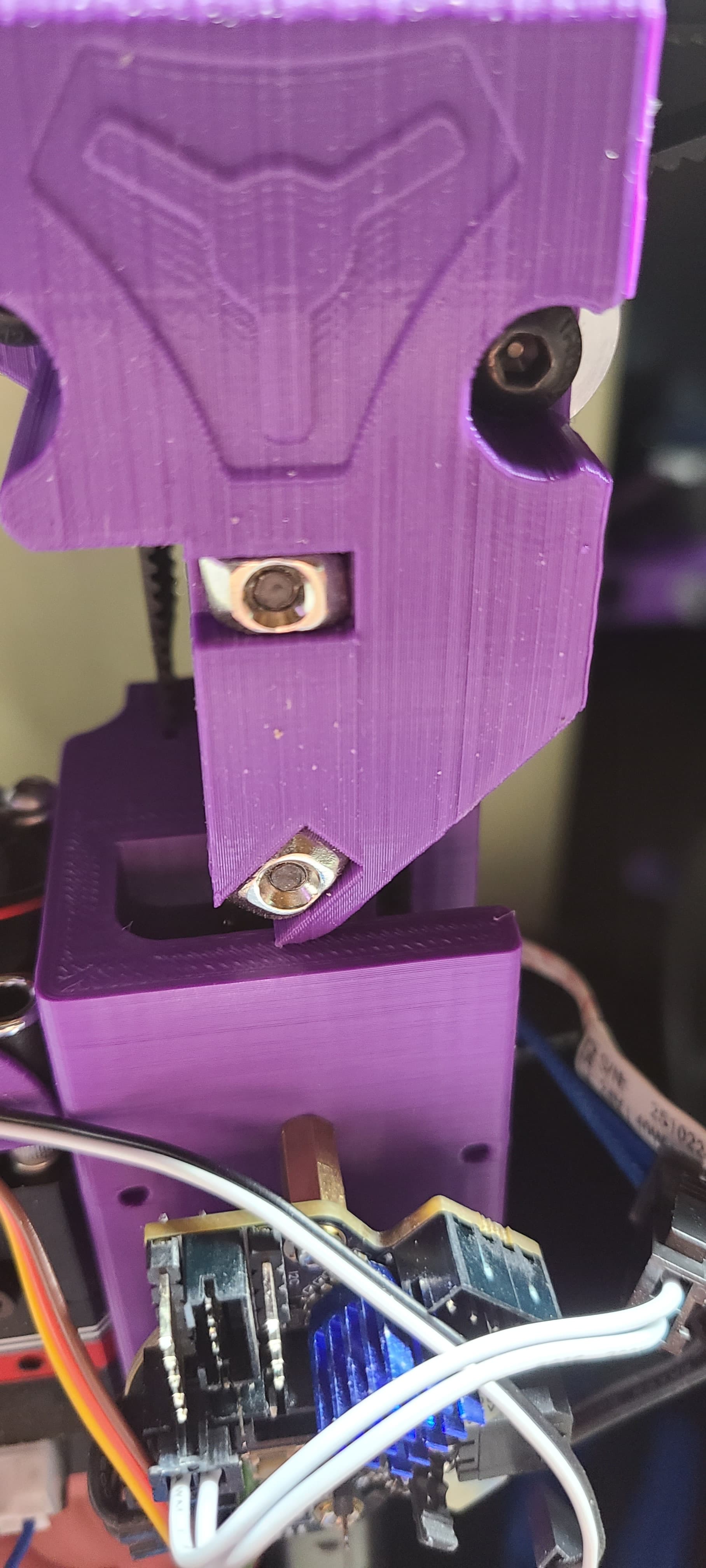

@probrwr Do you have the file for your fan mount? And do you think it will work on a non revo H2? I just printed your core mount for it and it came out great. I see your fan mount in the Pic but didn’t see a file for it. Thanks
I thought I had linked the file somewhere but this is where it came from.
Edit: Link
MP3DP “Repeat” Toolhead, BIQU H2 by inoxdragoon - Thingiverse
You may have. I was lazy and didn’t read through. Thank you! Didn’t think to check thingiverse
oh… and that duct is designed for the normal H2. It works well with the H2 Revo also.
I’m using the @probrwr mount. it is here.
Yes that is the mount I printed. The fan/duct is the part I am printing now and will see if it works. Crazy this thing mounts with only 2 screws. I will say it is Light. guess that’s why its the H2 V2S LITE lol

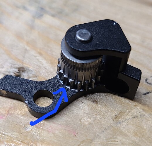

My Revo H2 started making a grinding noise today. Took it apart and amid the metal dust I found this. Just a heads up to any of you using the Revo version. I don’t believe this part exists in the normal H2 as it does not have adjustable tension (looking at the 2 I have on other printers)
I sent an email off to BIQU support so see if I can get this part.
