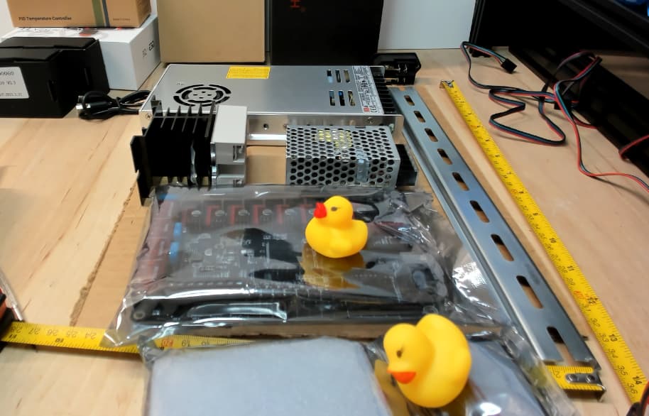

Thoughts on electronics box underneath? Less vibrations, and easier to repurpose/service? For 250x250 usable am noticing lots of space (260mm wide x 340mm deep x 80mm high) between the Z steppers.
That cavernous void is before adding feet, or, the excessive 100mm stilts I added.
Leaning towards separate box, WAGO’d to barely work for now, but upgrade with some screw/spring terminal plugs for quick connect. Not aviation connectors, since that requires soldering and am trying to keep this approachable. Still stealing ideas from Voron for component layout.
Display(s) and controls attached to front of electronics box, pitched 45 degrees.
Even at the minimum height, there is tons of room down there. You can fit your electronics and a spare spool.
If you are putting the electronics down there, are you going to put your spool inside on the left? Maybe on a door that opens in that panel?
I haven’t thought about putting a spool inside the printer. I need to go look at this again.
That is an interesting idea! With adding outside panels I have been looking at ways to rout the CAN Bus wires and the reverse bowden. Doesnt seem like enough room to route behind the back belts Is there room in fron of them to be able to make a bracket?
There is not much room less than 10mm or so behind the belts but it is very wide. I have ran all my wires and things behind the belts very easily. I think I even added the printed part I use to the CAD, if not I can do that.
  • Inkbird Solid State Relay 40A is a bit too chonky. Planning to use 500W 235x235 heated bed, but even if 750W 300x300 heated bed was used, am thinking 8A relay would be enough (750W / 120V) + 20% buffer. Looking for slimmer SSR…
  • Was looking for an excuse to use DIN rail, but it’s not needed if enclosure is partially/completely folded sheet metal, design cut with LR3. Will CNC/3D-print front/exposed face(s).
